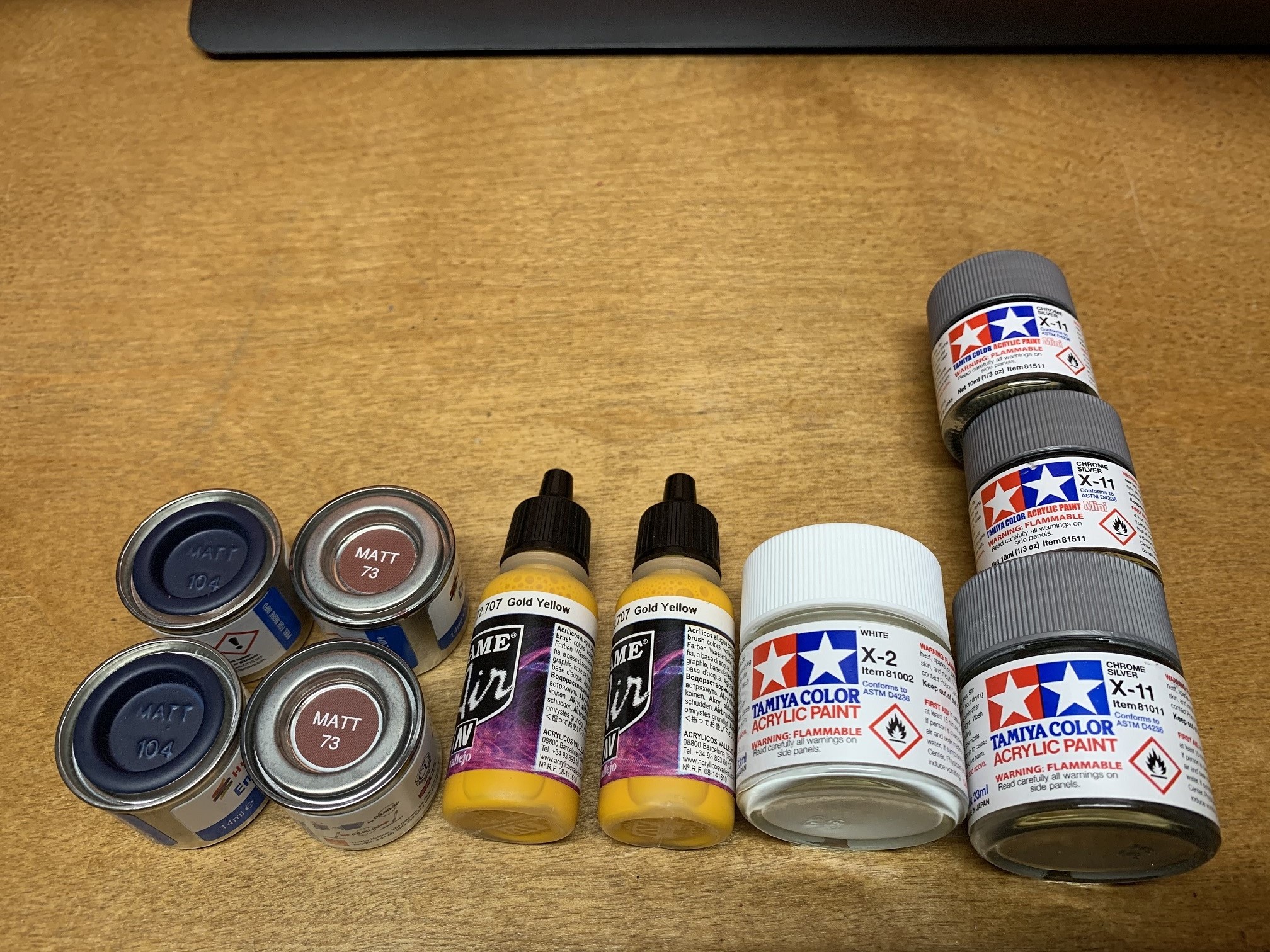

I'm a going with your recommendation of Humbrol 73. Here's what I got while out at the hobby store.
Tamiya X-11 - Chrome Silver
Tamiya X-2 - White
Humbrol - #73 (Wine)
Humbrol - #104 (Oxford Blue)
Vallejo - Game Air 72.707 (Gold Yellow)
I'm hoping this'll be sufficient for my needs. #FingersCrossed

Looks like quite the loot you got there! The wine color looks very maroon on the little tin, but it’s more red when sprayed for sure!
Best of luck - pick up some of that frog tape delicate surface for taping off painted sections (the yellow frog tape). Don’t do what I did...

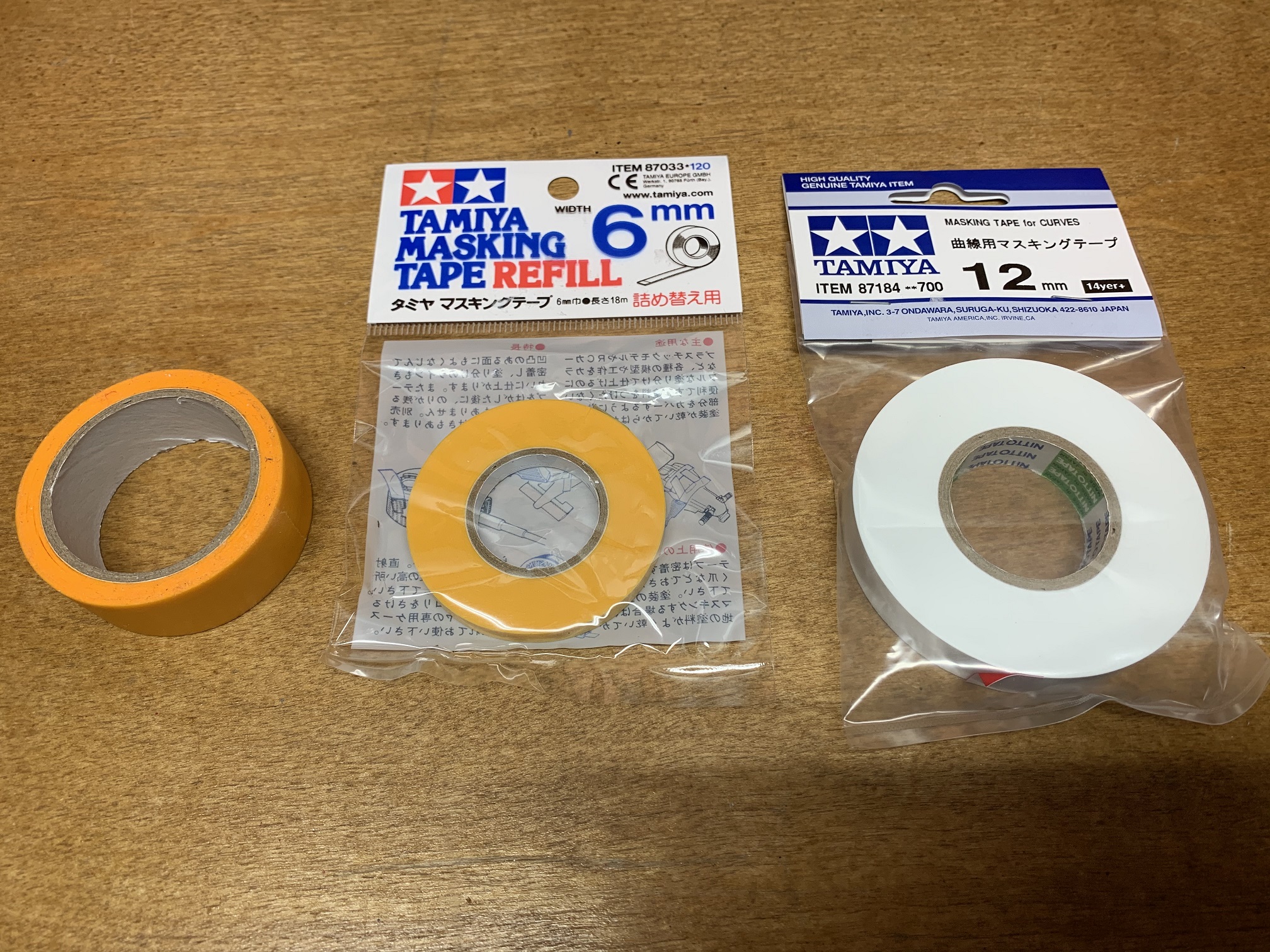

Also picked up some "Hobby" masking tape. I'm NOT looking to ruin any work here if I can help it. So yeah, definitely NOT gonna use Scotch Blue Masking tape for ANY of my Boba Build! ;) For that....I got me some Tamiya tapes that'll do the job. Already used some of that tape on my Gauntlets and worked great! Especially where you had to kinda curve out those four corners of that black spot on the right gauntlet. I picked up that white tape at the end there cause it said it was capable of doing Curves. Which be helpful when doing the helmet cheeks areas.

I used the Scotch delicate surface for my masking needs where I had just painted. If I was masking over paper of an area that didn't matter I used the less expensive blue painters tape. Just trying to save a few bucks. You will go through huge amounts of tape.

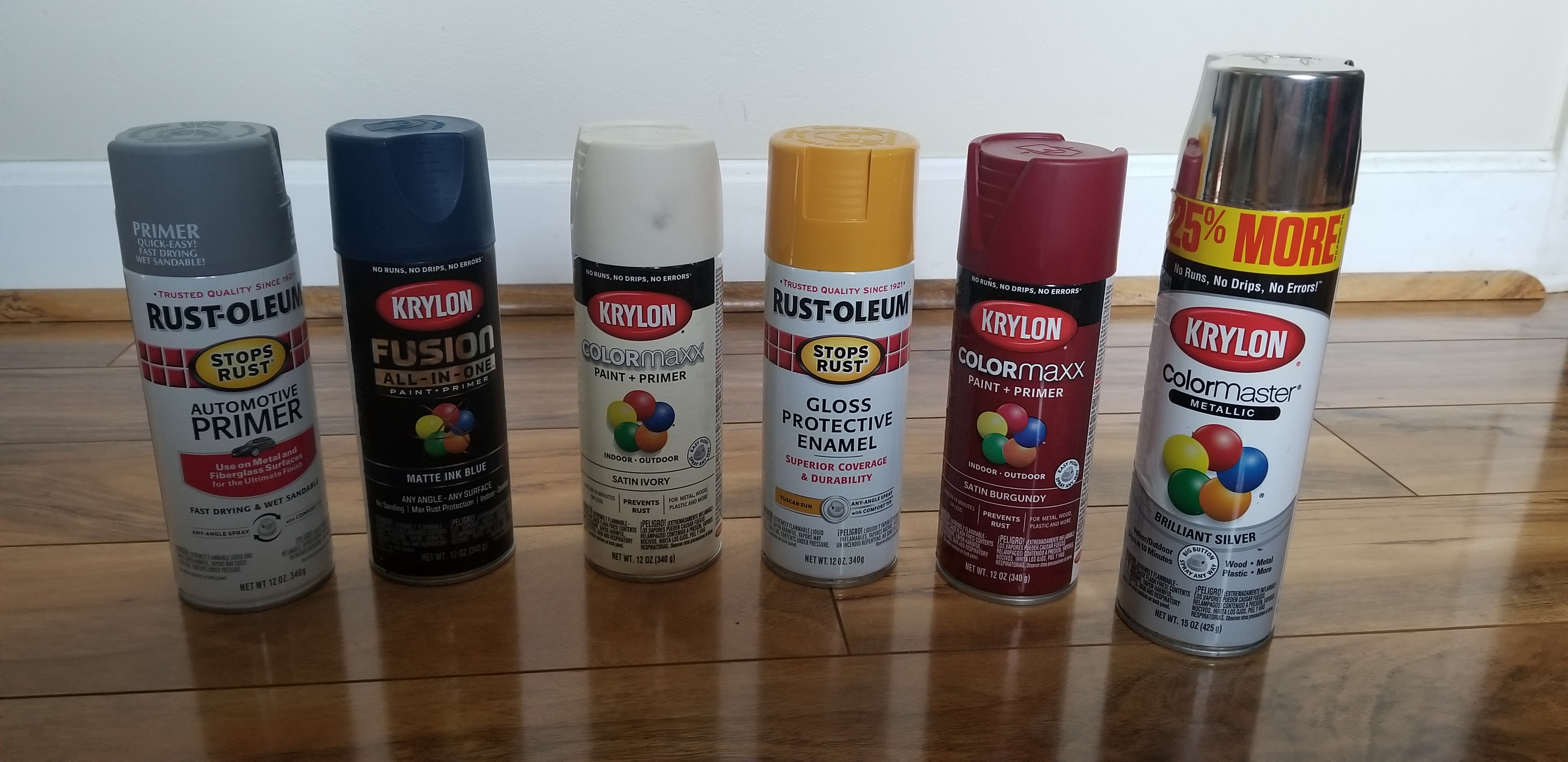

Here are the paints I used on my pack. The metallic brilliant silver is a really good base. It goes on even and looks amazing.
