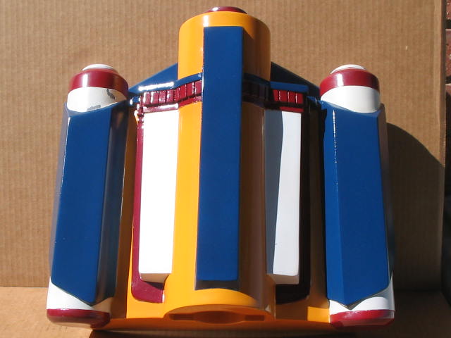

For The Body
Start with a base coat with the Aluminum
Mask off the areas you don't want painted.
I did them in this order;
White, red, yellow, blue
make sure all areas that aren't to be painted are covered.
The "white" is a base of Almond with white misted over it .
I didn't want the white to be blinding.
The "yellow" is a base of equip yellow with orange misted into the corners.
The red & the Blue are straight out of the can.

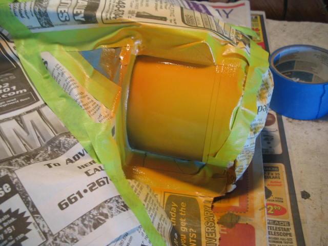

I had some problems with the yellow peeling back off.
The Tape was not on the yellow itself, but was masking the other colors.
When I peeled the tape off after painting the yellow, the yellow peeled up around the edges.
Here's what i did to fix it;
I used the masking tape to peel all of the yellow back off
(that's right ALL of it)
I then sanded the silver & painted itwith the Sun Yellow as a base.
Then a coat of The Equip Yellow .
Then misted the Orange.
After it was painted, I used an X-acto knife to score along the edges of the tape to prevent any other peeling.
no problems after that.

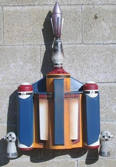

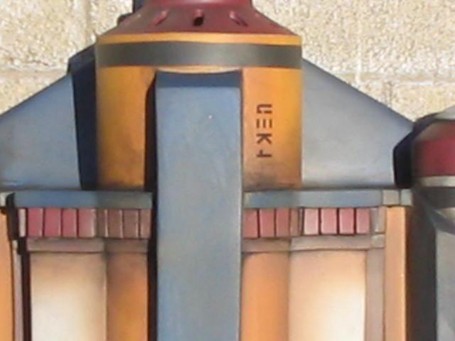

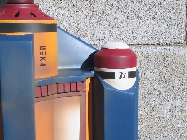

Ok folks,
here's we it sits as of today.
I put on the decals (thanx Alan)
Airbrushed the tan "dirt" on the body & thrusters (Tamiya "Flat Earth" # XF-52)
Then did a wash of el cheapo black acrylic craft paint mixed with windshield washer fluid.
The wash was a horrible mess.
I discovered something while doing it (well it's new to me);
Inevitably , you will get balck streaks from the wash running were it's not wanted. I found that if you spray Windex on a rag & rub it in, the streaks will blend out. You may have to re-wash that area, but at least there won't be any runs.
here's some progress shots,
first just the flat earth, then the wash

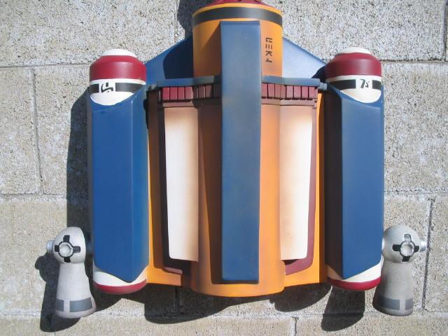

Ok
I'm a Jackass!
I didn't follow wizaroflight's instructions & put the wrong decal on.
I then tried to remove it & screwed up the paintjob.
then, I masked it & tried repainting it.
Got impatient, tried the heat gun to help the paint dry faster.
Got too close & bubbled the paint.
Here it is after I fixed the bubbles & painted AGAIN.
first pic, wrong decal.
second pic , repaint
here's after the new decal & new wash
not as good as before, but ok.
I also included the bottom shot
