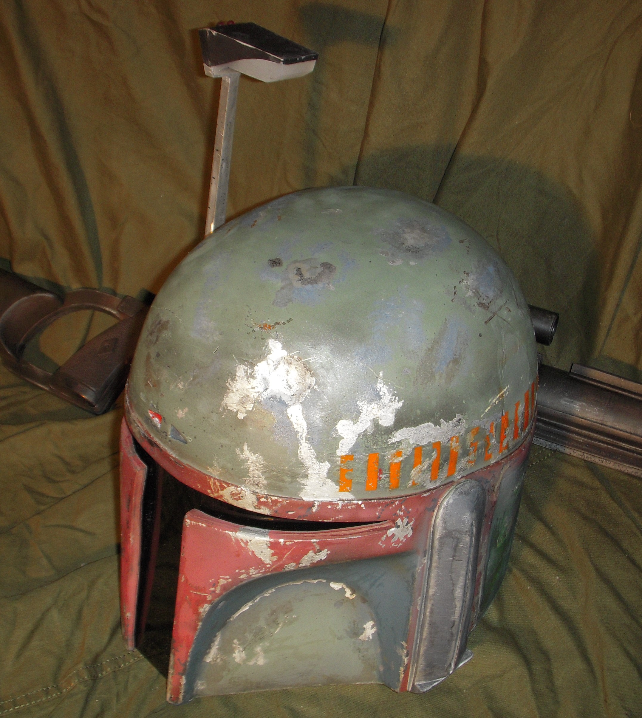

The Mercs wanted to give Daniel Logan a complete ROTJ suit (at his request) and were looking to have the parts and labor donated. I took on a few pieces, including the helmet. The rest of the kit fell through as we couldn't get it together in time, but they still wanted to give him the helmet. I had a few other kits to pump out for C7, so I didn't have time to take inbetween steps pics on the paintup. Presented by Solus Ram, FL clan Alor'ad.
This was the result...
10906403_1037710319591116_4958661242100664453_n.jpgScreenshot_2015-04-19-12-16-27-1_zpsvsfhz5pp.PNG1DSCN3871 (2) - Copy.JPG1DSCN3872 (2) - Copy.JPG1DSCN3889 (2).JPGDSCN3869 (2).JPGDSCN3874 (2).JPGDSCN3875 (2) - Copy.JPG
I didn't have time to get shots in the daylight. I had to box it up and overnight it to Anaheim.

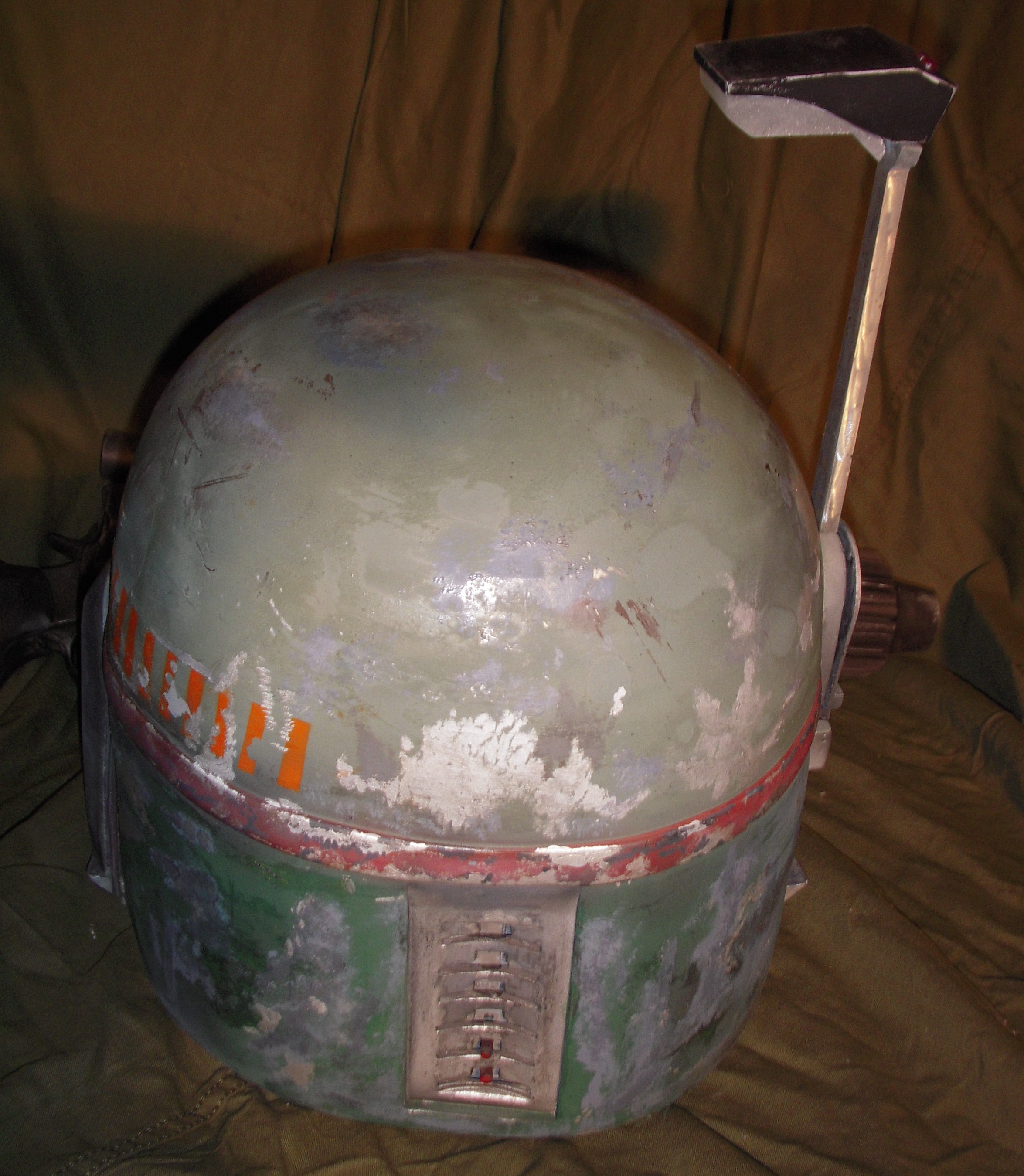

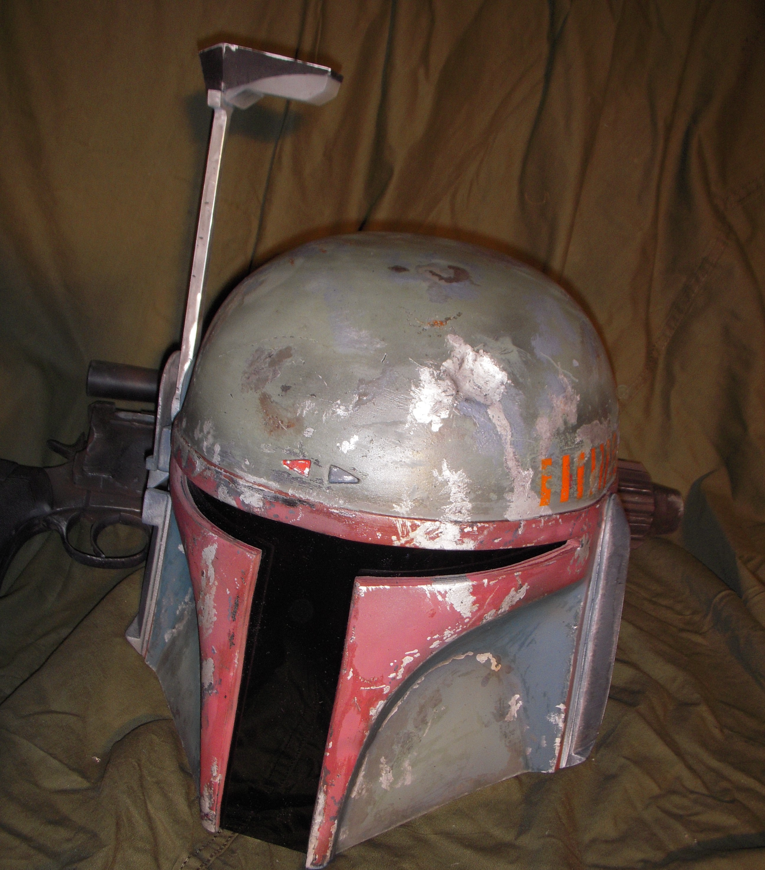

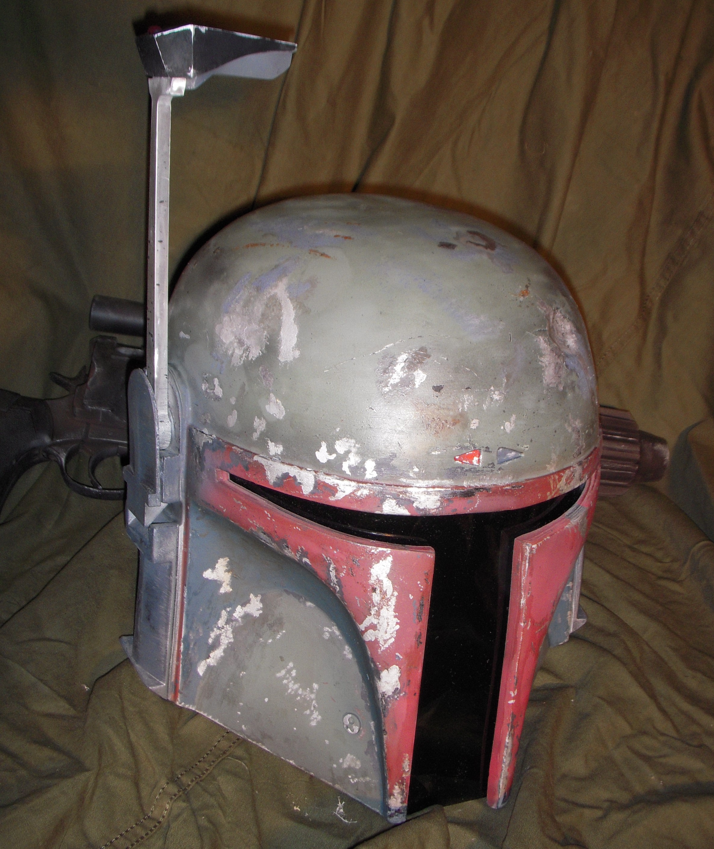

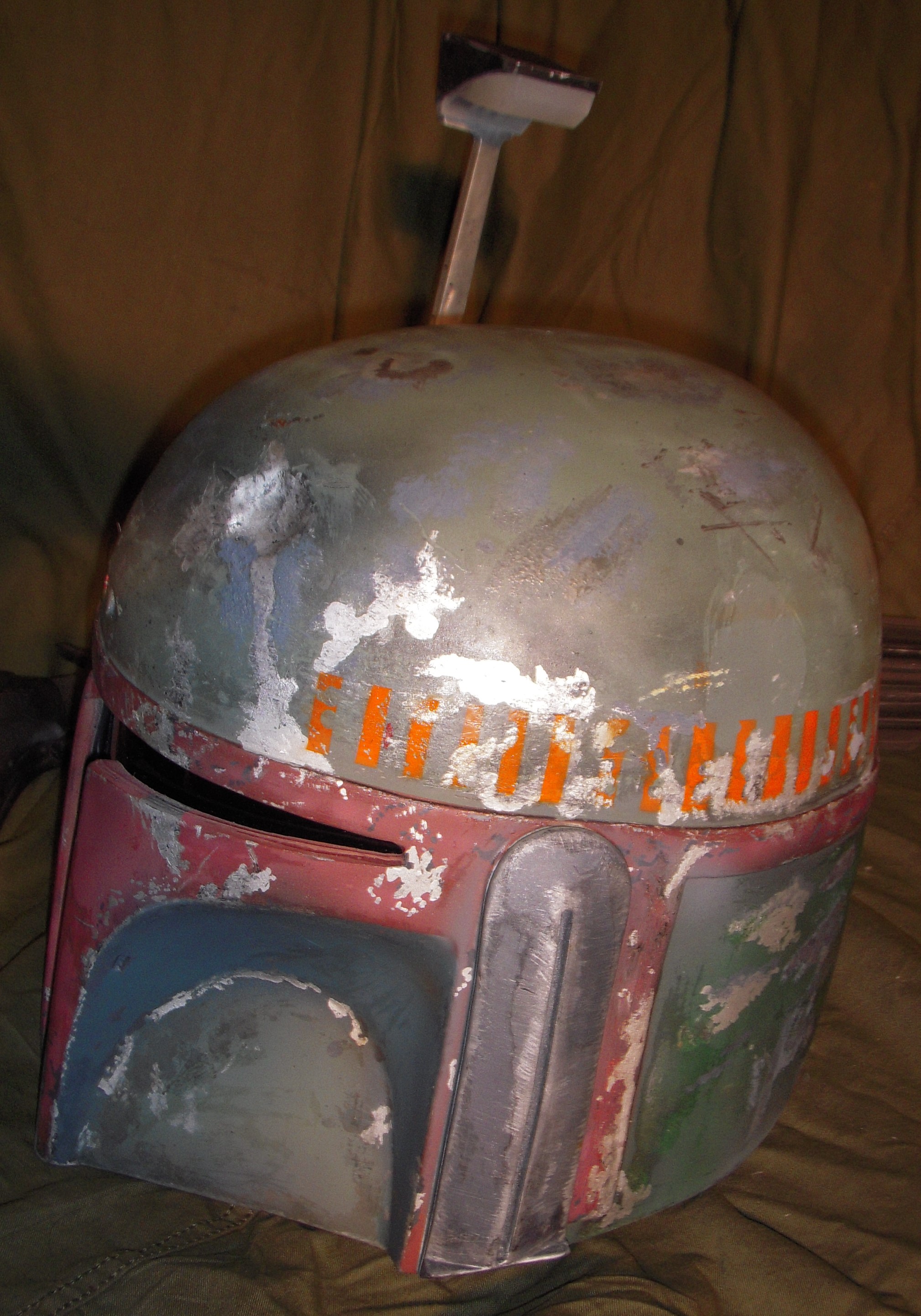

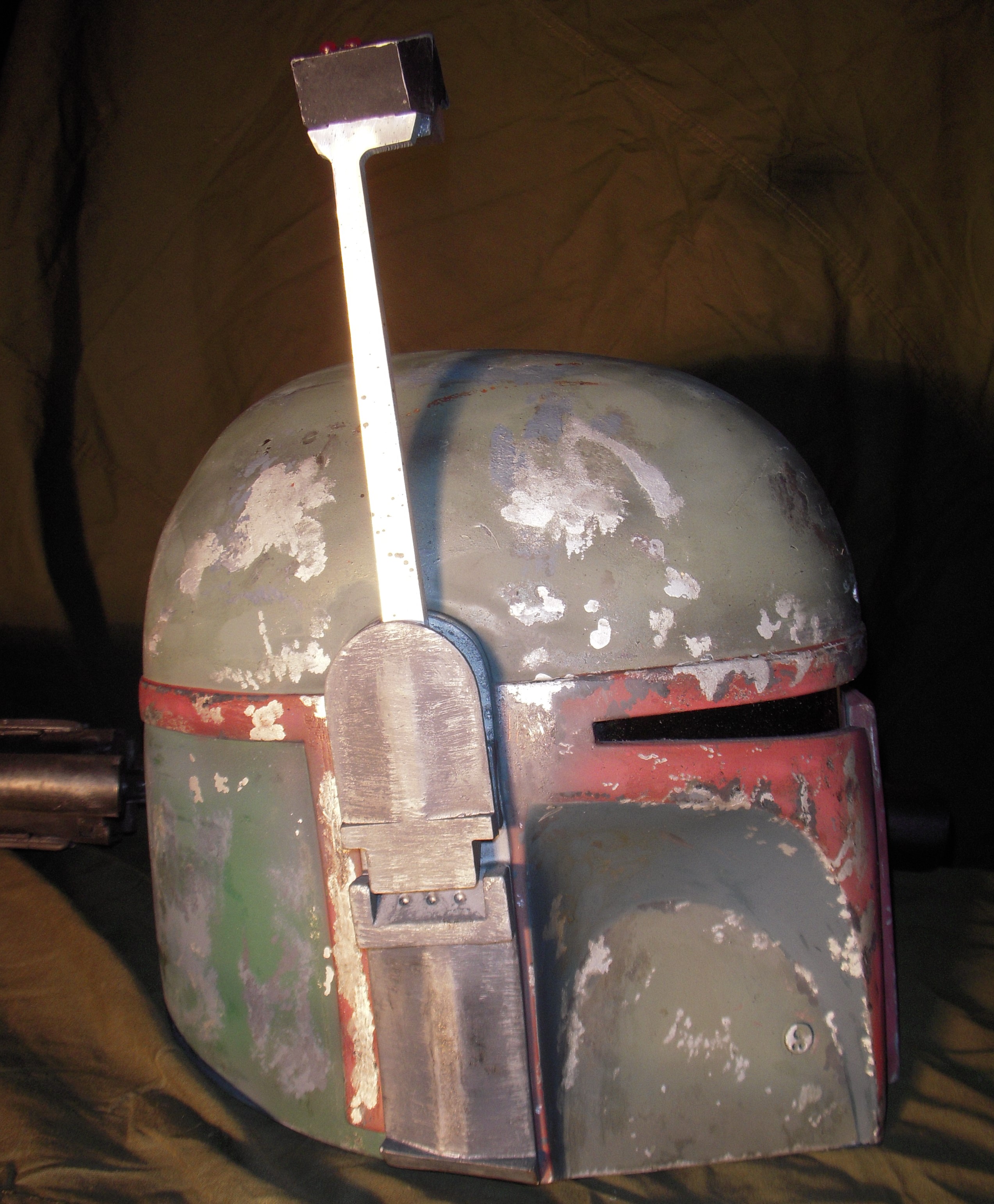

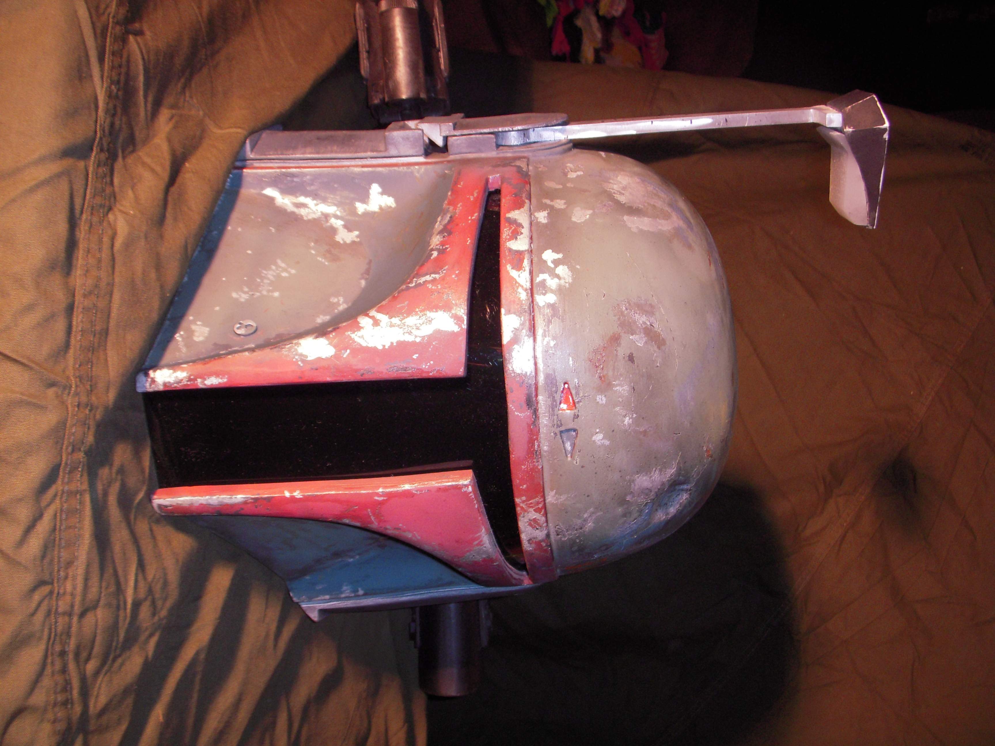

Mixture of layered and topical damage. Lots of dry brushing.
I used the helmet I cast, which is Jinto mold purchased from James.
Dome & cheeks were a mix of Humbrol 78 & 87.
Visor surround was a mix of caboose and humbrol 73
Mandibles were humbrol 77
Back panels were a mix of humbrol 76 and a model masters green I had on hand.
Humbrol 82 killstripes
Model master, floquil and humbrol paint were used for the weathering and distressing.
Aluminum stalk and magnetic earcap.
