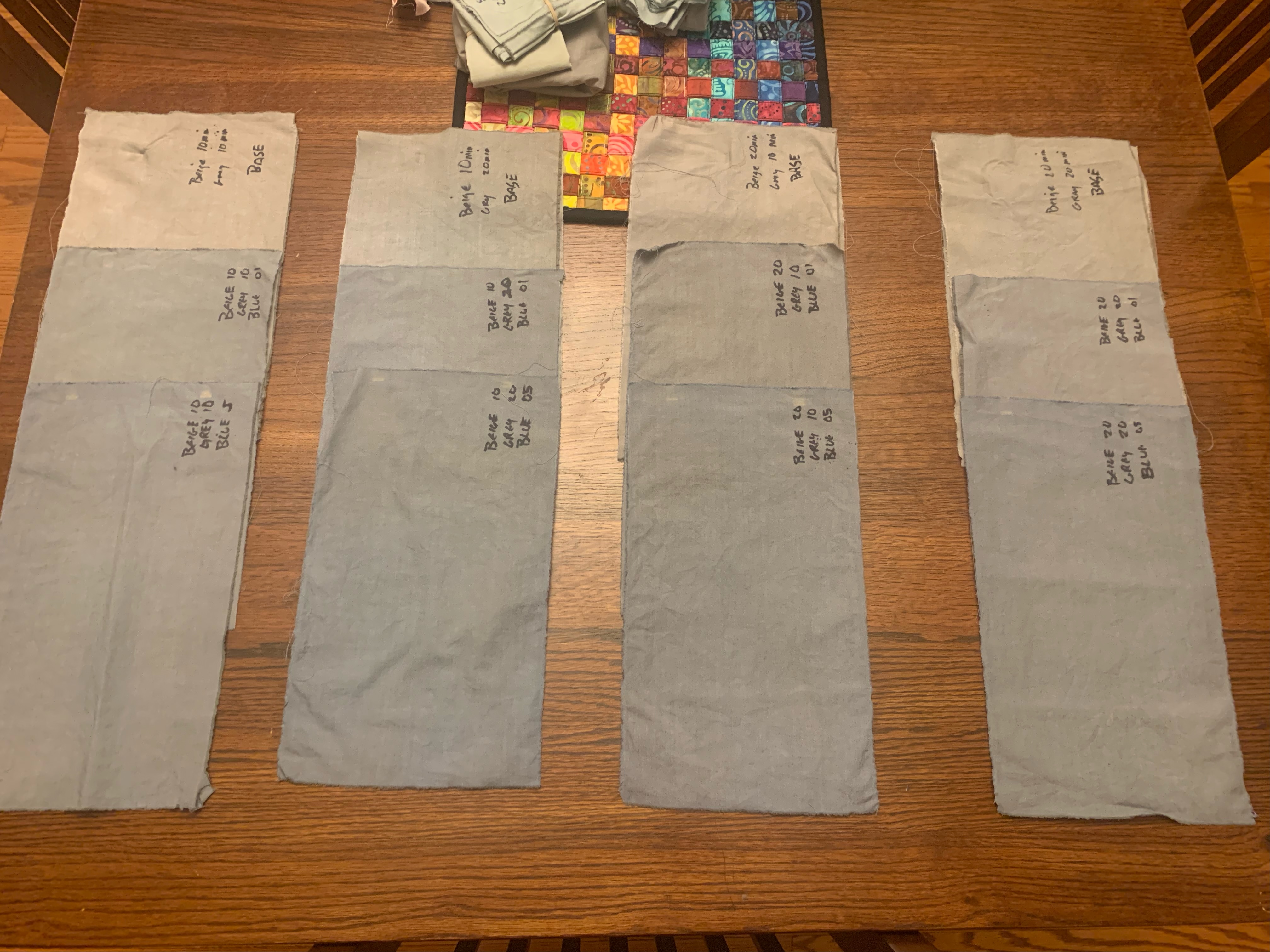

I made a variety of swaths, each with the times (minutes) I soaked each one starting with the Beige (10 and 20 min)/dry, then the Pearl Grey (10 and 20 min)/dry, and then Evening Blue (at 50%) (1 and 5 min)/dry. I can't figure out which one is closest, but I can tell that the ones that had 5 min of Evening Blue are more ESB tint and RotJ tint and I am wanting RotJ. Also, used a leftover cotton bedsheet for the swaths since my jumpsuit is cotton (mostly).

Nice! Which one did you go with? Personally I think I’d lean towards the two right ones in the middle row

I haven’t yet. They are still taking up space on the dining room table. I can’t decide which one to go with since the ones without the blue tinting I think are are too blue and I know I need to add some bit of blue. Will decide soon.
