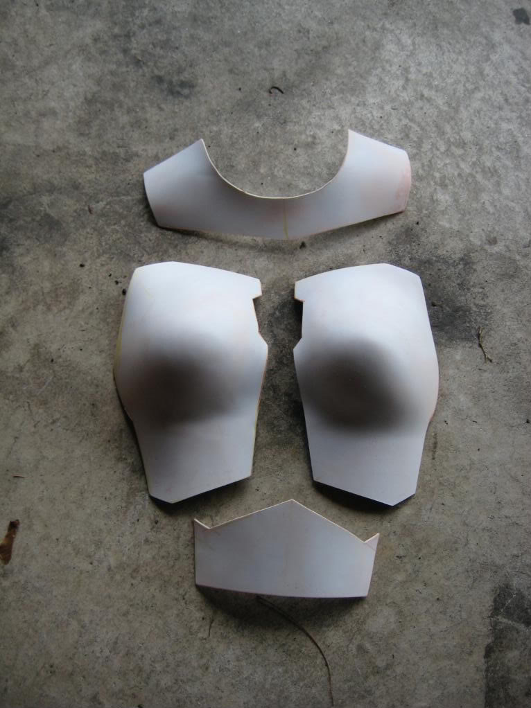

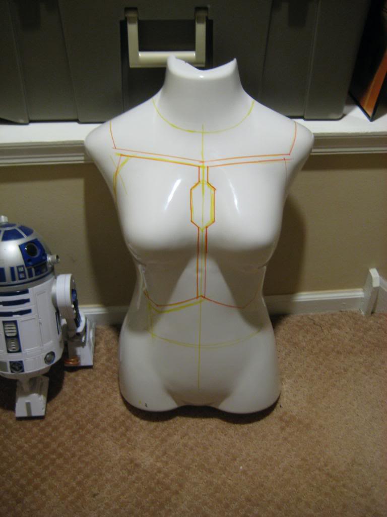

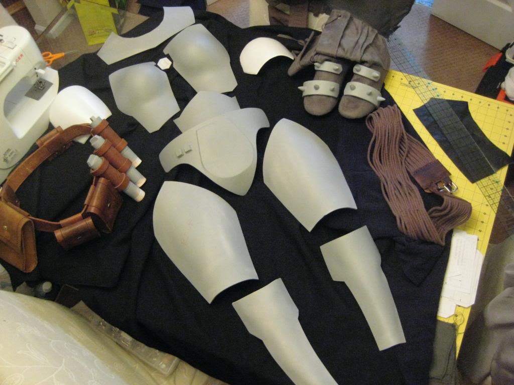

First the armor- I racked my brain to figure out how to do it, decided it wasn't worth sculpting and casting my own, wasn't completely thrilled with what I saw out there and then had a flash of genius. Bought a plastic mannequin half torso of ebay that wasn't too "realistically sexy" in its sculpt:lol: and that would accommodate my girl's form. Drew the armor on the torso, sat down with an xacto and there you have it. Best part: $30 bucks shipped and just a little time with a marker, ruler, and xacto.

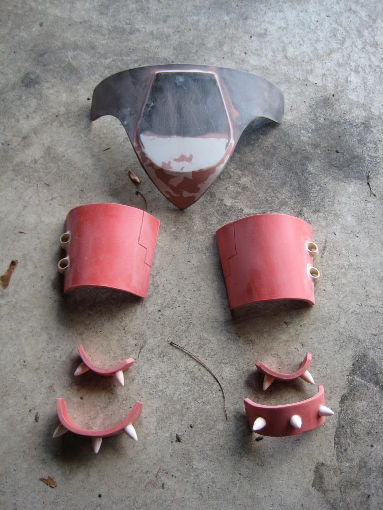

Cod is one of those cheapo sintra ones I mistakenly got off ebay awhile ago, but its the right size proportionately for her, so a little TLC to sculpt up so it looked more like a fett cod and it was good to go. The Knee and foot armor is .25" sintra cut out and heat bent into a curve. Some PVC tube pieces were blended onto the outside of the knees and will have fett style darts put inside them.

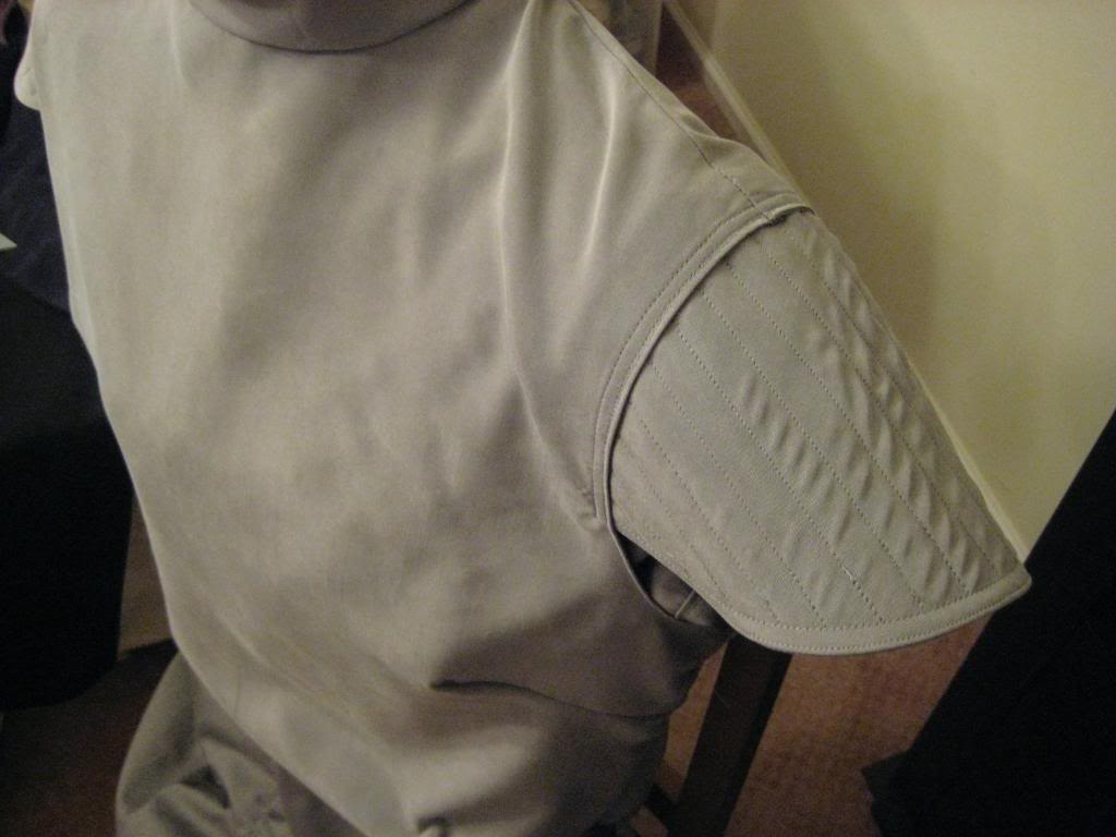

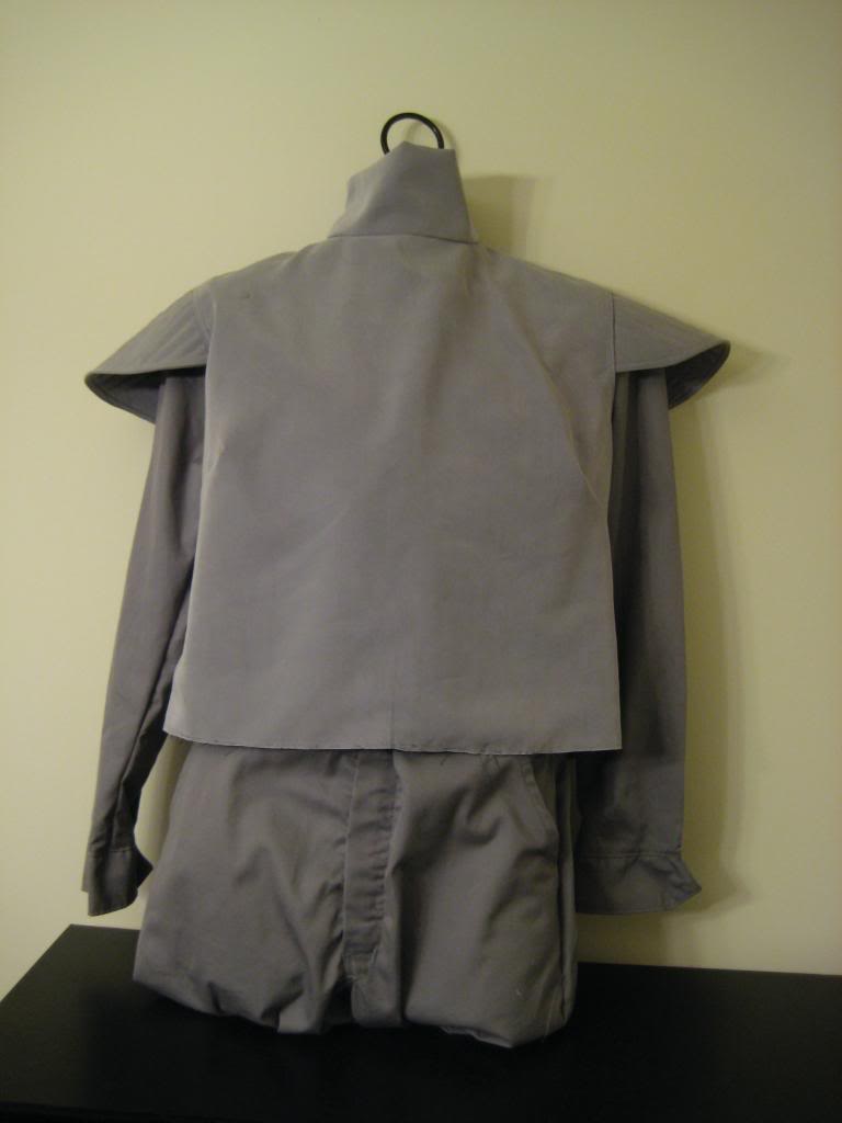

Flightsuit was a generic flight suit/ coverall she found for cheap at some point. Removed all the pockets and took it in since it was a little baggy. Pocket material will be used to make the arm pouch. Armor vest is made from fabric we found at Wally world for cheap. We decided we wanted to have a Fett style armor vest, since it would look best and fit with the typical mando armor set up. We looked for a fabric that was a similar grey but possibly a little different in material and shade (just like fett in ROTJ). This stuff works great. There is no existing ref for the pattern, but I decided to throw in the fett style shoulder stitch lines, just to add more detail.

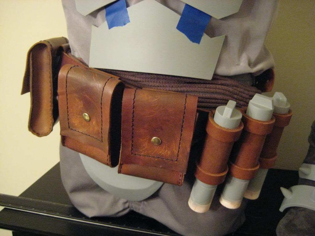

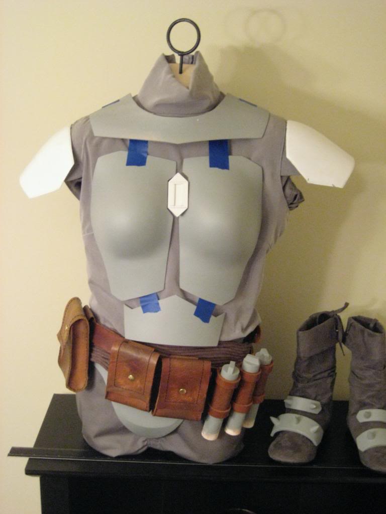

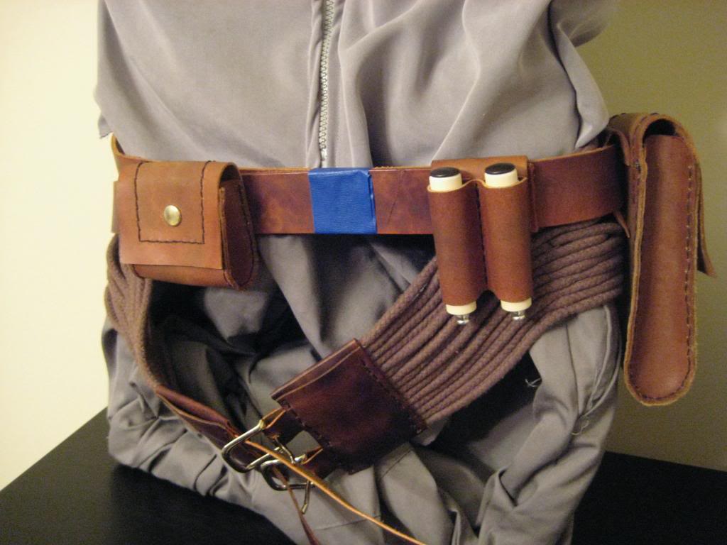

Here's the armor as it stands taped up to a another mannequin she had. The girth belt is hand made, used cotton clothesline from walmart dyed brownish grey, I dyed some leather and made some ends to it that have buckles with leather straps. The Ammo belt is entirely hand made by me. I made patterns and dyed the leather and hand stitched the pouches together. They're all functional as well. The little back cylinders are just pvc pipe filled with resin, and capped with a snap dome and a resistor sticking out the other end. The large cylinders are R2 ankle cylinders with one tab cut off. I did this for to reasons- 1. I had a Ankle cylinder I had made from PVC pipe so why not mold it and cast a few and 2. It fits in the star wars universe design style. Detail pieces were used in multiple places all the time. So they look like they belong, and there's extra detail with the scribed lines and tabs on the end that isn't in the artwork.
And here's most of the parts laid out on the cape rectangle. It's a wool outside (just an interesting weave that was on the cheap remnants table at Joann's) with a wrinkly cotton lining (same source). You can also see I added some tabs on the cod piece- probably won't be seen but it just brings it more into the reality that Fett's armor existed in, right? Its all about adding in the layers of detail.

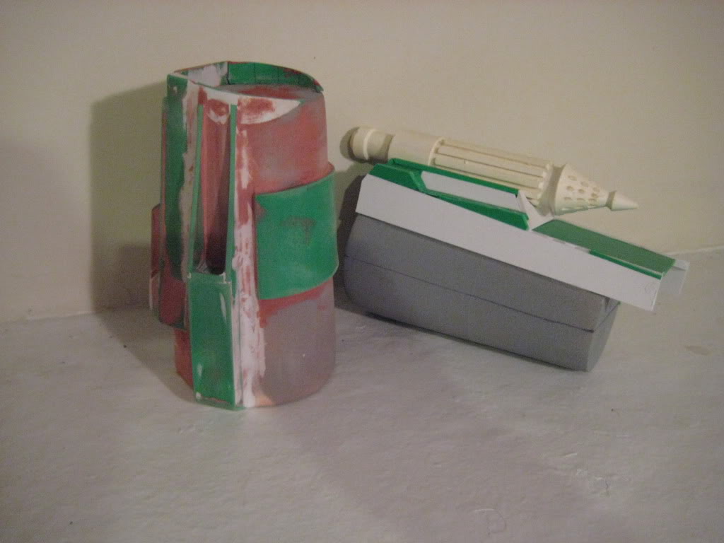

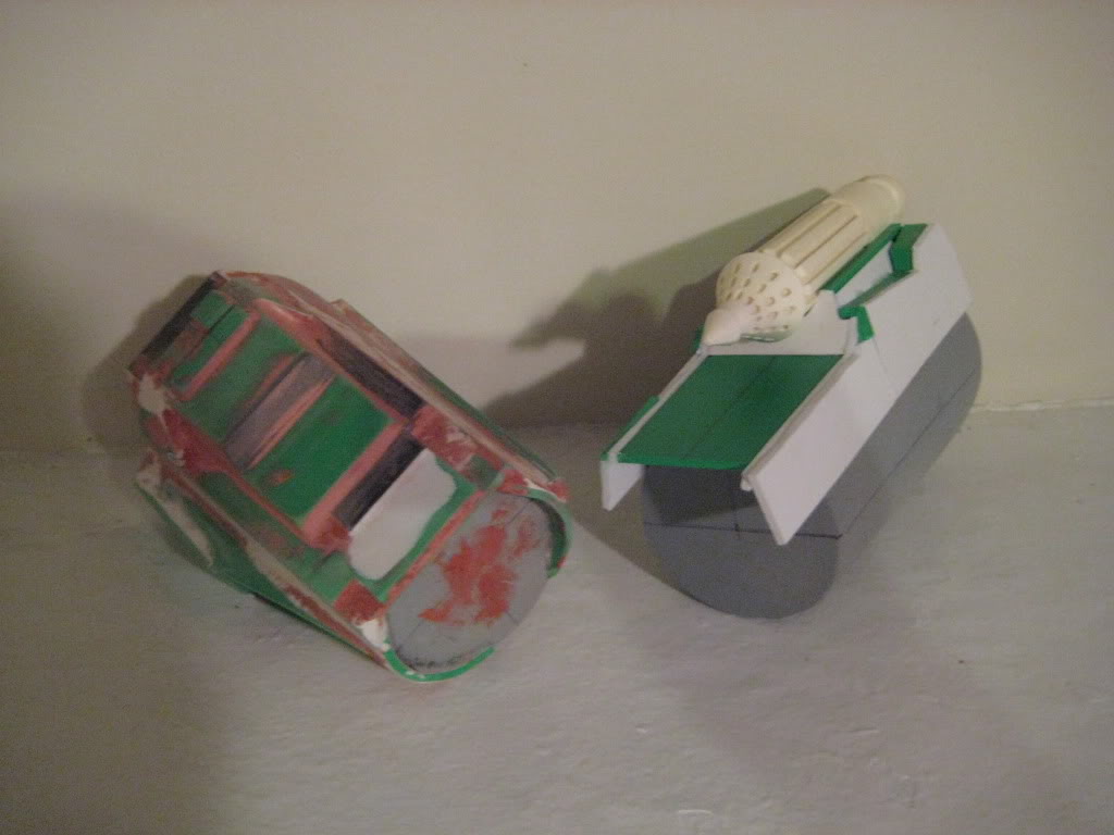

And this is a blank cylinder of polyurethane foam. I shaped two of them into a tapered cylinder and will be sculpting up the gauntlet details on top of them. I'm going to go for an overall Fett style gauntlet like the figure, but with some of the little details worked in from the comic reference images. Plan is to make a mold of the sculpts and cast them in resin (so who know's there may be some for sale in the future);)

mannaquin torso...brilliant...why didn't I think of that??? :p I'm liking the spikey boot plate things...spikes are always good...:thumbsup::thumbsup:

Using a mannequin for chest plates was just complete genius. =)

I have been doing small things with it. I made some progress on the gauntlet sculpts. I'd say they're a third of the way there. The right just needs to be sanded some more, more filler putty, sanded, and coated in primer. I need to finish building up the left gauntlet and then fill it and sand it.
Again, for those just joining us;); I'm not going for any specific piece of reference on this character. I'm sticking closer to the action figure for the most part as it is a constant in its details, whereas the comic illustrations vary. And I like the idea of making things that look like they belong in the same family of form as the Fetts (thus the Boba style armor vest) So you could say I'm doing an idealized version of the action figure, but I am working in some details of the comic art. You may be ably to pick out some of the extra box or panels on the gaunt that are inspired by the comic art. On to the pics!
