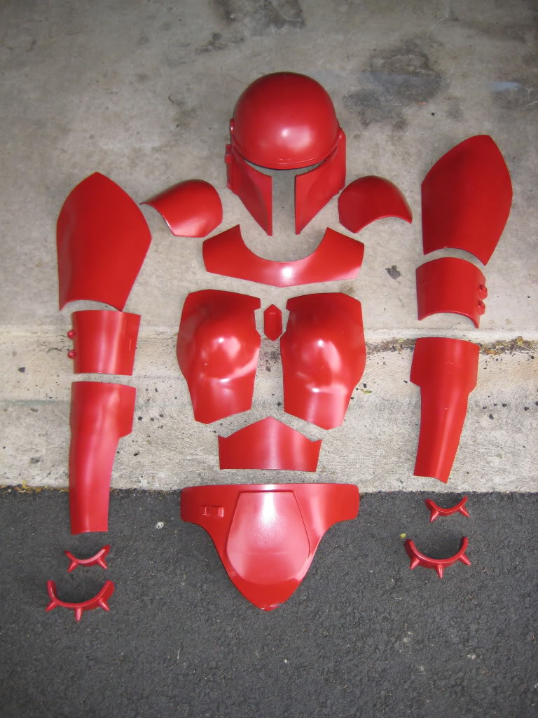

So over the weekend I drove back home to Cincinnati for Cadet's college graduation party, but Tk-2257 came with me and I brought her armor with me to work on. I got the red main paint coat down on the armor. Here's a little pic:

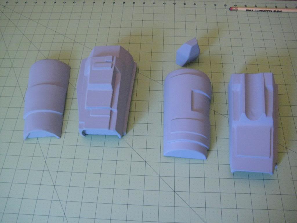

Tonight I primered and spread some more spot glaze putty on the gauntlet sculpt.
I'm working some more on doing another round of sanding on the gauntlet sculpt. I'm also putting some epoxy putty filling on the pistols. I had to take some old earcaps I had sitting around and fit them to the helmet. We had misplaced the earcaps that came with the helmet. So that's some more filling and sanding on the helmet before I can paint the grey on the helmet. I also have to fabricate the rangefinder stalks.

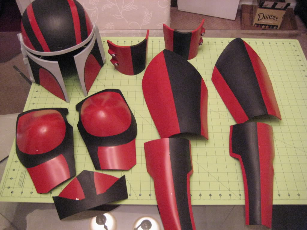

Little update. Got the basic colors painted on most of the armor. Got the black and the gray on the armor parts that get it. Been working some more on the gauntlet sculpt, and I'd say that they have to be sanded one more time, then primered, and they'll be ready for silicone. Started working on the pistols a little more too.

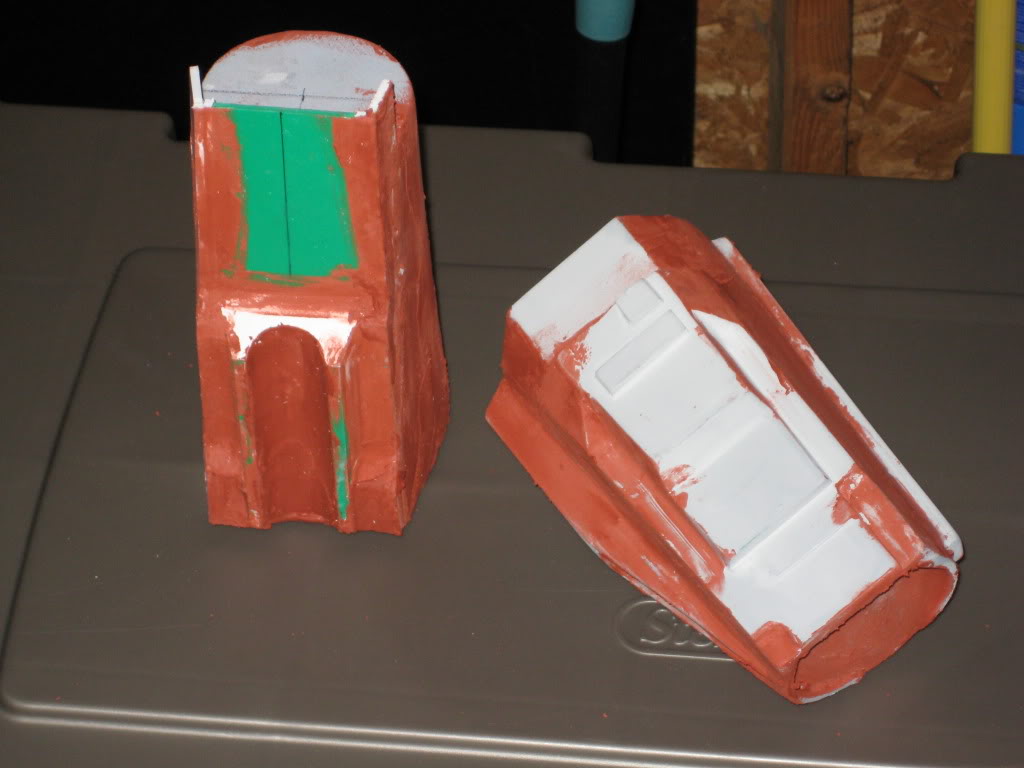

About time for another update to this build, and its a biggish one. I just got done pulling the maiden set of casts of the gauntlets from their molds tonight. Not too bad overall, will need a little bit of clean up here and there. I modified the one mold a little to make the next casting a little better. I didn't get pics of me making the molds themselves, because my hands were really sticky from the mold rubber, and I did not feel like ruining my camera. But here's a quick description of what I did; I made a mold of the outside of the gauntlet pieces, turned that upside down and spread clay into it the thickness I wanted the gauntlets to be, then made the other side of the mold over this. This left me with a complete mold with a void that was the gauntlet. I didn't feel like slush casting it, so this will give me a consistent thickness in one shot. I also extended my new mold rubber supply by chopping up some old useless molds into itty bitty pieces and mixing that in to it.

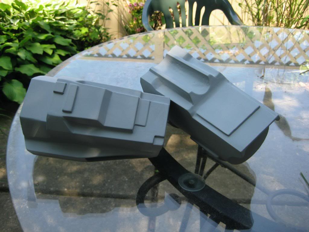

Here's the master sculpts in their final clened up form:

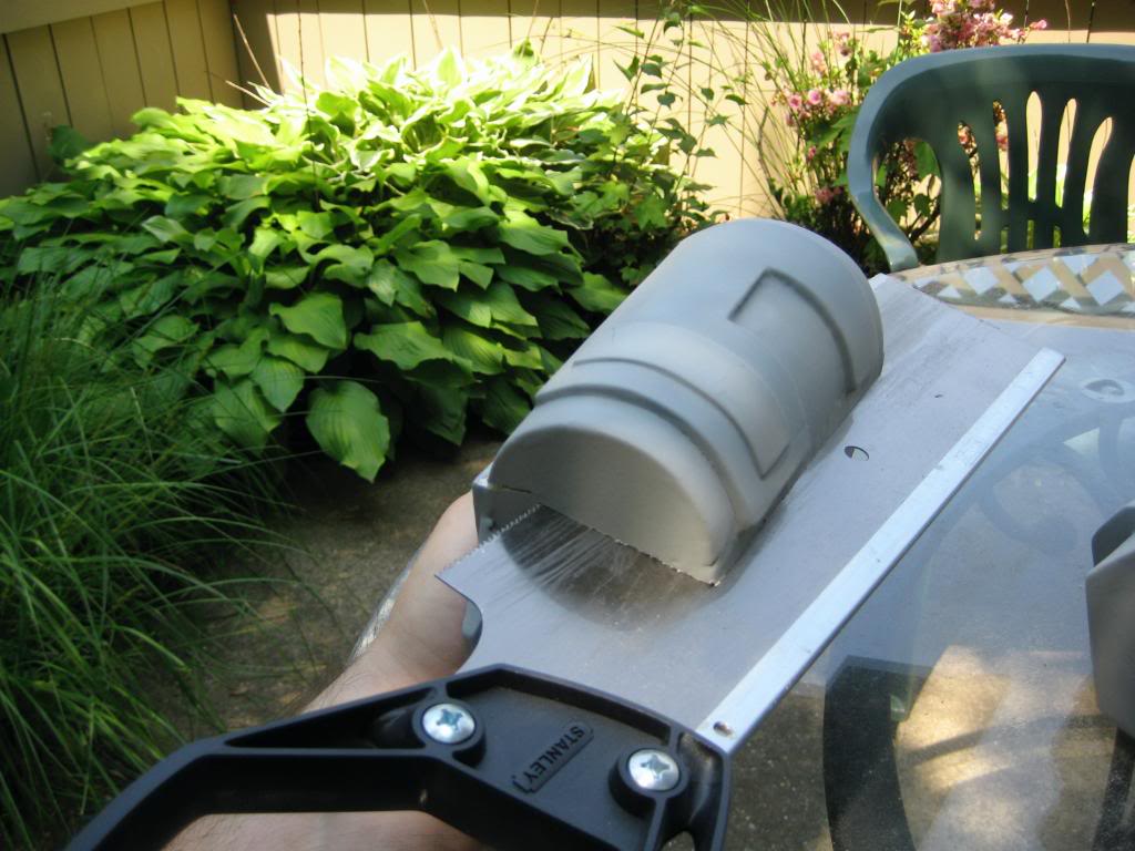

Sawing them in half to be able to mold each piece of them individually:

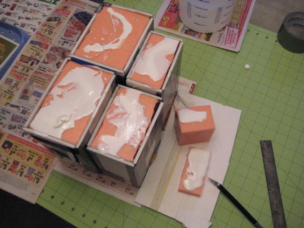

And the resin setting up in the completed molds:

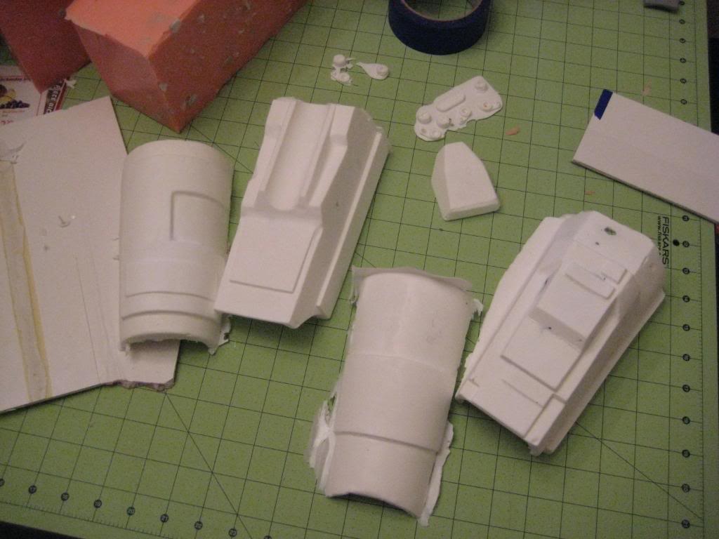

First pieces rough out of the mold:

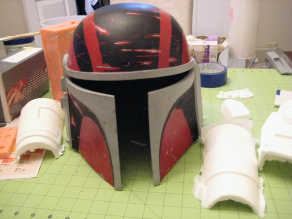

The helmet in its initial stages of weathering. The scratches are done, now its just time to do washes over it and the armor to dirty it up. The rest of the armor is currently at the same point as the helmet, I'll try to get pics up in the next day or two.
