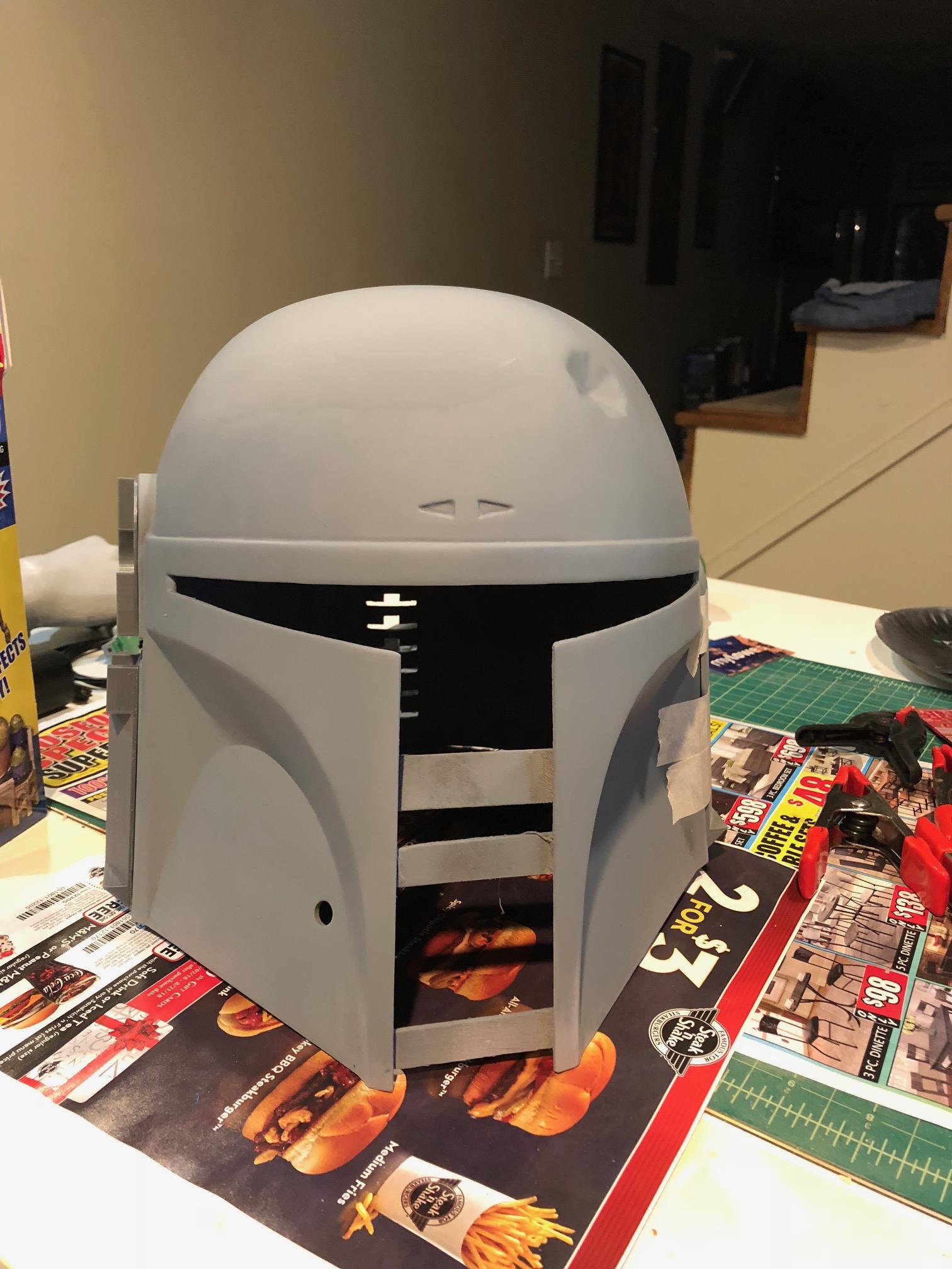

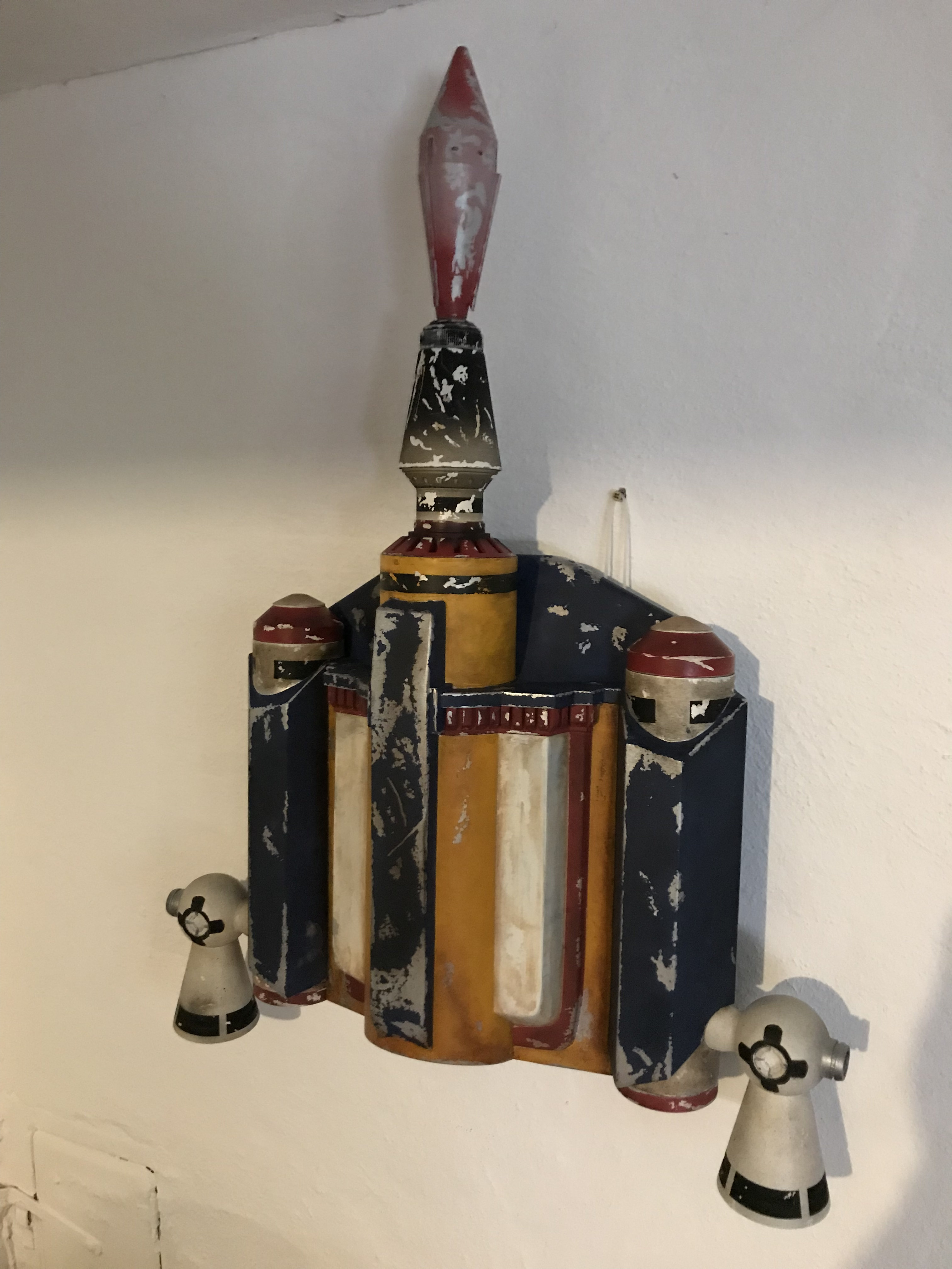

The files printed with a ton of hard lines that I removed using a auto body file that was a hand me down tool from my father.
This looks kind of like the file that is on mine.
https://www.amazon.com/Tool-Aid-897...rd_wg=BslCi&psc=1&refRID=5S6AP2JHJN233XX9DM85
Once I smoothed out the hard lines then used bondo to fill in the low spots, then primer/filler spray to clean it up.
I am still working on trying to increase the smoothness of RafalFett dented helmet file, as I would like to print another. But this is a learning challenge.

I used a Folgertech FT-5 to print the helmet in one piece. There are several large scale printers that work great, but it'll need to have at least a 300mmx300mm bed to do it (print in one piece).

The helmet looks very good in Sketchup (free), but the STL model has many hard lines.
Can you export the STL file from Sketchup in higher quality, or is the problem Shapeways?

The model is the same, as I used Sketchup to export it to STL. I might redo the model, but not in the near future.
NIce work.
thats a vixen file. You can get them cheap at the yard store. Used even cheaper. Works great on bondo, wood and soft metals too.
