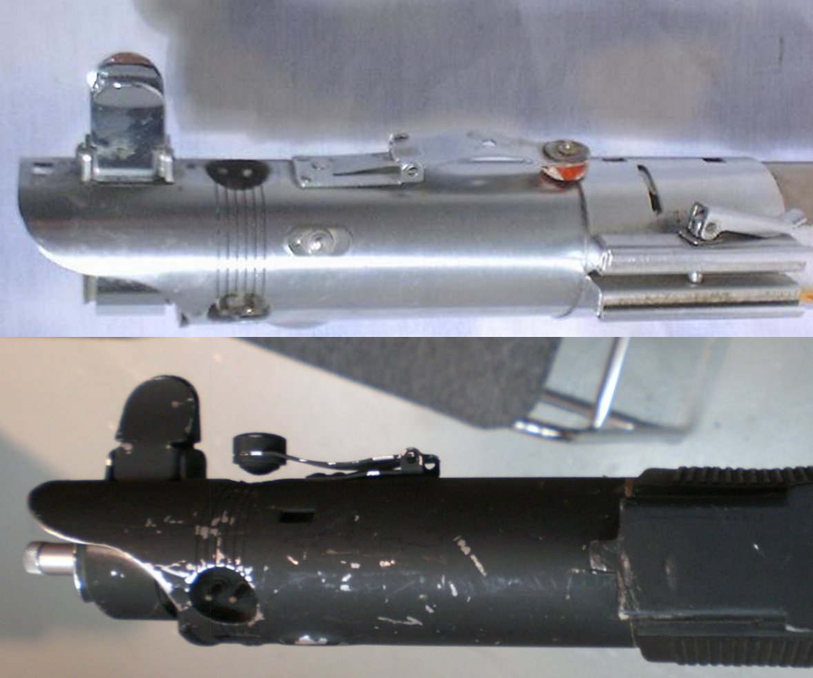

Well, in our case that RPF thread doesn't help too much, except this older variation of the Graflex flash tube (Graflex Variations: Facts and vs. Replica - Post #3), which seems to be the correct tube for the Supertrooper blaster:

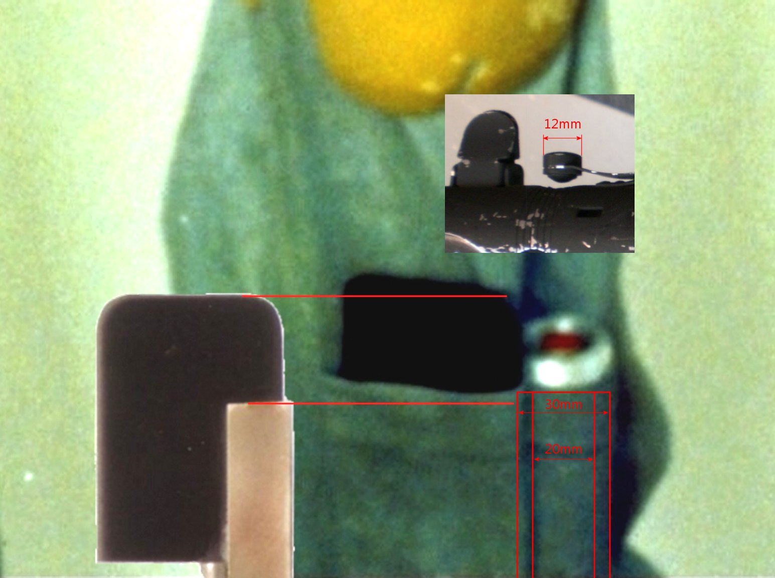

The great thing about this Graflex tube is that it has a different button, the so called 'telegraph' style button, which also has the correct diameter (around 12mm, the other posted in the first post had around 13mm) and it looks pretty close to the red thing in the Pre-Pro #1 4th shin tool:
