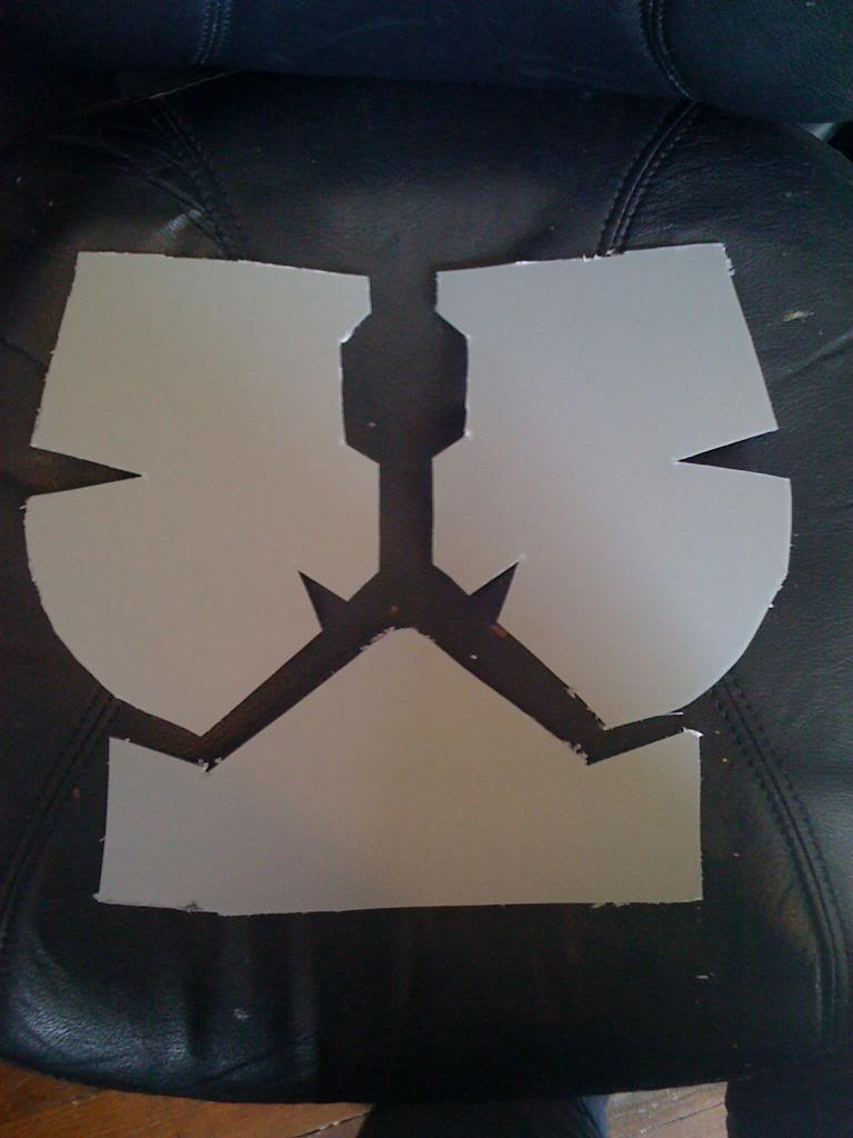

I've got a set of mando plates I've made out of a trash can.
The only problem is that I want a more female look for them and I have no idea how to accomplish that.

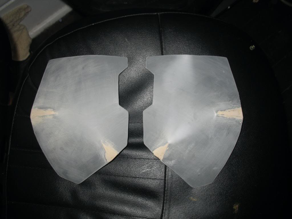

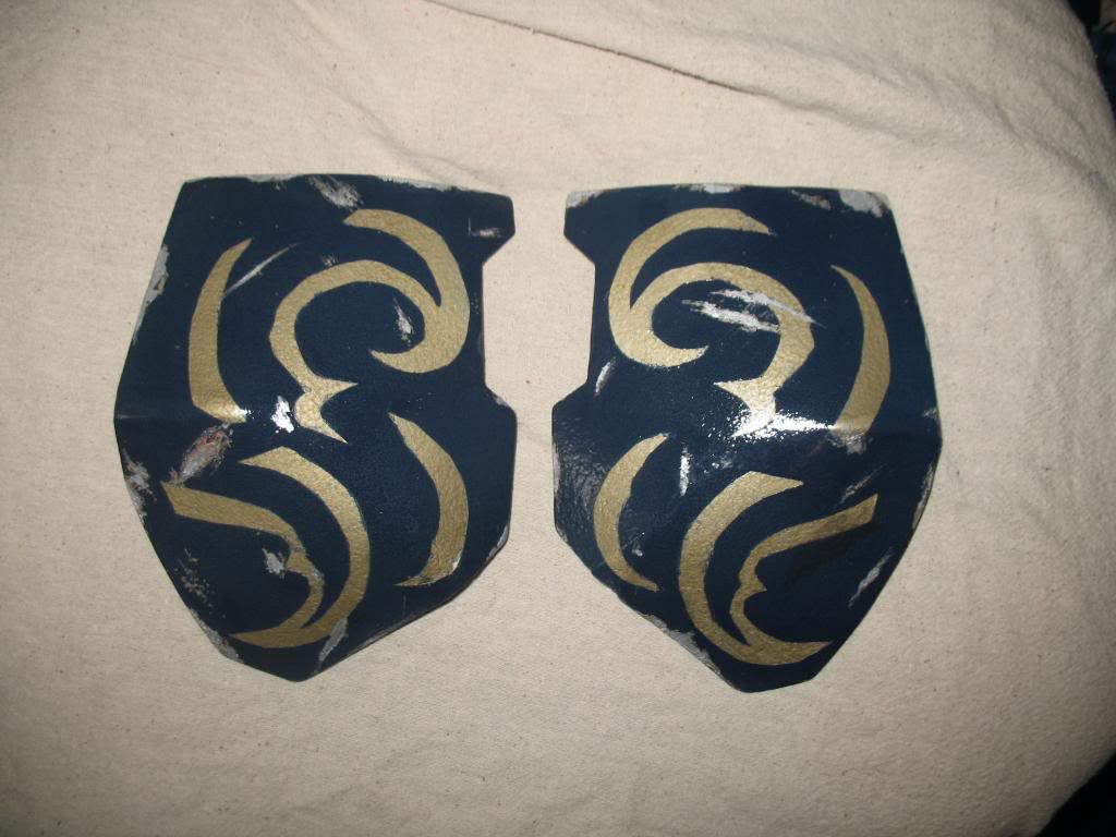

Something else you can try that doesn't involve using a whole lot of heat is putting darts in your armor.
Basically, you cut a long thin triangle in either the inner or outer side of the chest plate then bend the ends together. Since your using a trash can, PVC epoxy would work well to hold them together. That creates a nice cop effect and only requires the piece be heated enough to get those two ends together. Below are some pics from one of our ladie's armor over at Mercs.
Hope this helps.
