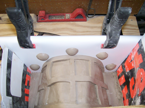

So I started the mold for the mini. I have a lot of pics, but I am feeling lazy and only uploaded 2 for now, more will follow.

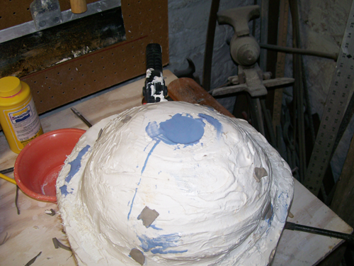

I couldn't find any burlap to reinforce my plaster, so I used some of the fiberglass mat and fiberglass cloth that I already have. Not the most economical choice, but it's what I had available.
Here is the dome on and registration groove built up too
Just have to lay the plaster on top then break the mold open and start pouring silicone. More to follow, maybe even by the end of today.

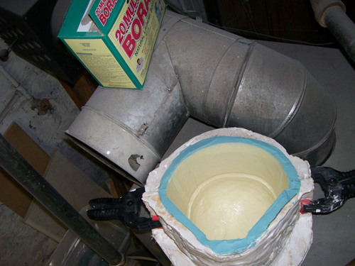

Finished the outermold and poured the first of three parts of silicone.
And that's where it sits for now, I am ordering a 5 gallon pail of silicone in the morning, hope to have it before next weekend.

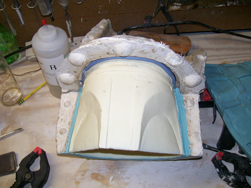

Got my silicone today, then finished pouring. This is where the 85% helmet mold sits now...
I am gonna leave it wet and let it cure over night then pour some polyurethane in the morning for my first test helmet.

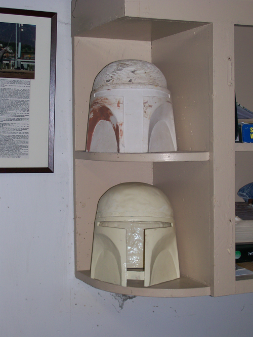

I have a lot of cleaning up to do then some bondo work. I will repour the silicone in the future too. I am totally new with the polyurethane resin so I have a bit of a learning curve to overcome, but as requested, the first pics of the first pull.
Here is the hydrocal original I started with in comparison.
It's not the prettiest, but I feel good so far and I am not even close to done, still got the fullsized to finish, mold and casting. Back to work in the basement for me...
