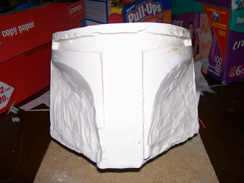

I actually started a couple weeks ago but figured I was happy enough with current progress to start a thread. I am making two buckets based on Alans (a genius) Templates. I started by building the sintra version of the WOF templates, then filled it with hydrocal white. It's hollow underneath to save materials and lighten it.
The first try wasn't the cleanest. The mandible collapsed partly and the overall shape was slightly distorted due to my own mistakes. I trimed it down initially while the plaster was still soft. I wasn't too worried about how rough it was since this is a base for a clay sculpt.

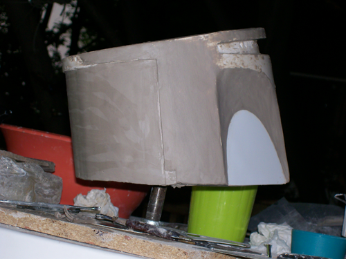

This is where the Sculpt sits now, after a couple more hours
I pressed the sintra cheek peices to clay and left them in place to reduce the surface I needed to work. Yeah, OK, I am a cheat.
I used water based clay even though I would have much prefered to use my chavant NSP. The wax/oil based clay wouldn't stick to the gypsum near as well as it stuck to my fingers. Wasn't thrilled about it, but so far I am pretty happy with the water based clay.
I will be starting the dome this week when I decide on a suitable base material to start with.

Did a rough shaping out with some of my heavier Rasps. There are a couple advantages to the rasps. One it that it doesn't create nearly as much dust, instead it makes fairly intact chips. the other being that it moves a lot of material. Hydrocal White is much harder than Plaster of Paris. I also want a rough surface so when I attach clay it sticks a lot easier.
I intentionally cut the outer diameter down about 3/8 of an inch from the actual design to leave room for the layer of clay.
Haven't had a lot of time this last week to progress much, I did get some hours detailing the face of the helm though, didn't get any great pics of that yet. It's in the background of the first pic though.

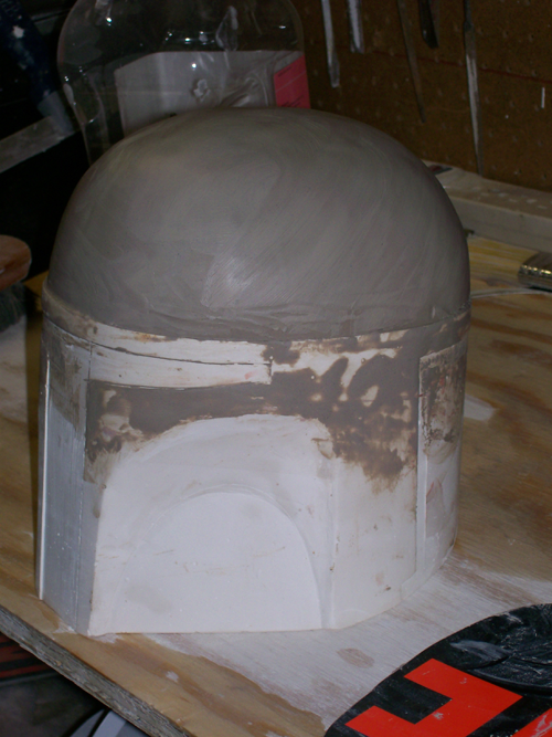

I had an hour this evening when I got home, so I cut some clay and shaped out the rough dome and was starting to fit it the the rest of the helm tonight. Progress as it sits now...
The right (left side as you face it) cheek/mandibles still need a lot of work so that will be next, I hope to have an initial mold made by the middle of June. I am sure that the first version will still require a lot of work, but this is where I am now...

I am pretty happy with the cheeks on the full size helm, the mini-mando (85%) one is a ways off in that respect. I agree, The full size one needs a dome soon, then I will have a better idea how far I am from pouring silicone. I am planing to do the mold in three pieces if I can swing it. One piece for the dome then one for the face and one for the back. Then I can switch out silicone pieces depending on which helmet I want to make. That might not make sense right now but it will later when I get to that point. Should be clear then.

Too shallow you think? Hmmmm... You could well be right. I think it's hard to tell with the lousy shots I have taken so far, the white washes out. I will try to take some better shots up, and from better angles. Thank you for the critical eye though. I was just not sure how deep they should go. I have never owned, or held for that matter, a boba or jango bucket.
