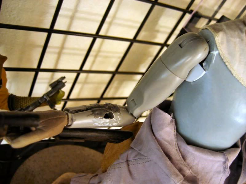

McHaley Art recommended using the legs from a 1/6 scale figure to use as Fett's new arms so they would have some articulation. The figure he used was an Art S. Buck poseable artist's figure, so that's what I used. I just picked one up on eBay. The legs have several points of articulation, which allows the arms to be repositioned as you like.
The PF Fett's original arms have to be cut off at the shoulder seam. I used a small hacksaw to cut them off, and filled the bottom half of the opening with some sheet styrene so the ball joints on the new arms would have something to rest against.
Here's what I mean.
To hold the arms into the body, I screwed a small eyehook into the end of each one and used a couple of strong rubber bands to link them through the torso. I just twisted the arms around several times till I got enough tension to keep them secure. I had to open each "ankle" opening a bit with a small Dremel grinding bit to get Fett's hands to fit in.
Also, I had to grind/sand down the "calf" so the gauntlets would fit correctly. This left a large opening on the right arm which I filled with JB Weld so the hand would be secure once inserted.
Here are both new arms in place and under tension.

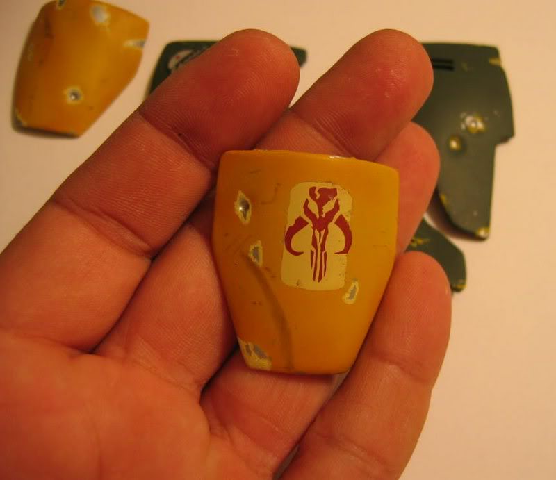

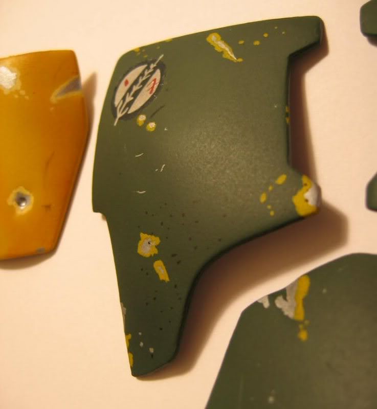

Reassembly was the reverse of what I described above. The undersuit was pulled back onto the torso and arms, then the vest and armor pieces were glued back on. Here are some of the individual armor pieces I repainted.
I used a couple very small dots of superglue to reattach them to the vest (just in case I ever had to take them off again.)
