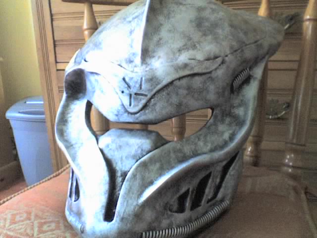

Hey Dan hows that Celtic coming along, Ive just painted up one of my Predator helmets I had lying around I'll get some pics up soon, I used the method I described and it worked nicely, I surprised myself!!!
Heres my custom bio helmet, about 75% done lots more weathering to do plus I need to add an eye mesh and a tri-laser unit
Ah hi there, yes im also a member here and have been for a few years now, thanks alot, more weathering to do and at some stage I'll be trying to get a nice undermask and some dreads for it :thumbsup:

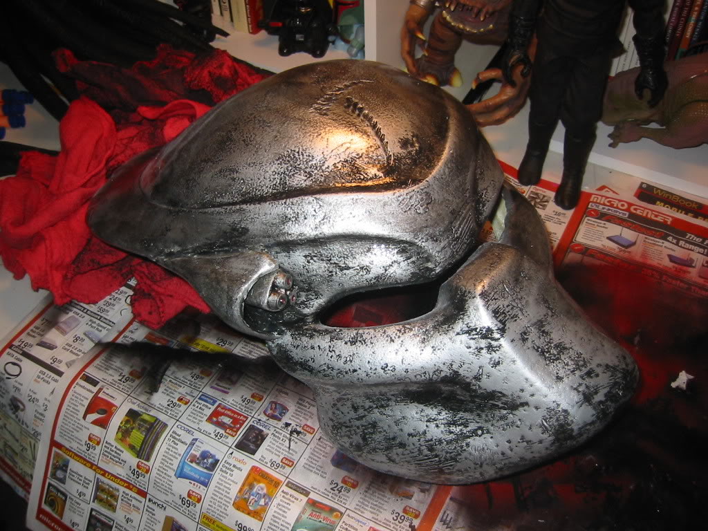

The process I used for mine was...
1. First layer of primer.
2. Second full layer of Hammered Metal Paint. This gives the helmet/armor the look of hammered metal versus smooth, dirty chrome. It pays off on the next step.
3. Black acrylic paint that is dried for a few seconds and wiped horizontally across the mask. The black paint stays in any grooves and imperfections and gives it the dirty look. You can wipe off as much as you want, and if you mess up, just add water and wipe away.
4. Once satisfied with the look you want, I always "finish" the piece with a nice layer of Clear Coat paint. This not only gets away from the painted look and protects the paint from elements, it gives the dirt an "oily" appearance which I liked better than just paint.

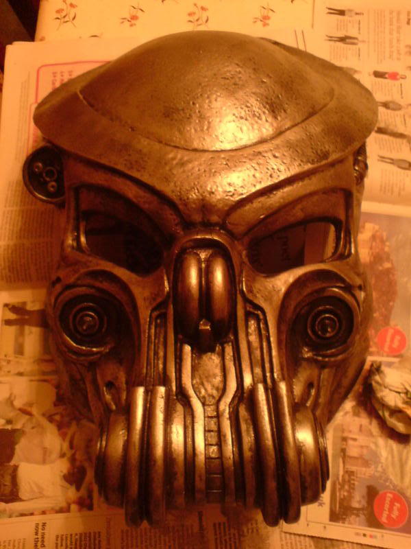

Here's my progress so far....
I primered it black, then put a base coat of some automotive metallic grey which was very dark.
I then used the light on dark approach and used a paper towel to dab a layer of lighter paint on top. I need to re-do a couple of areas where I went too heavy with the lighter coat and it has covered too much of the layer below...
One without and then one with flash
