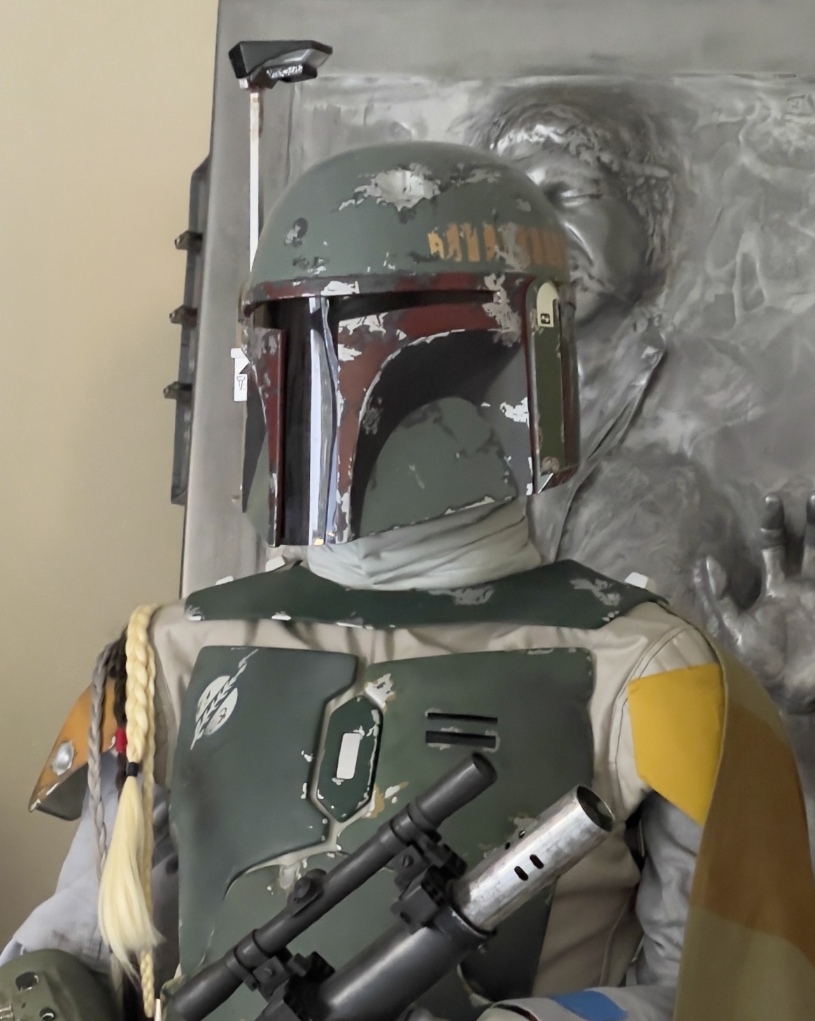

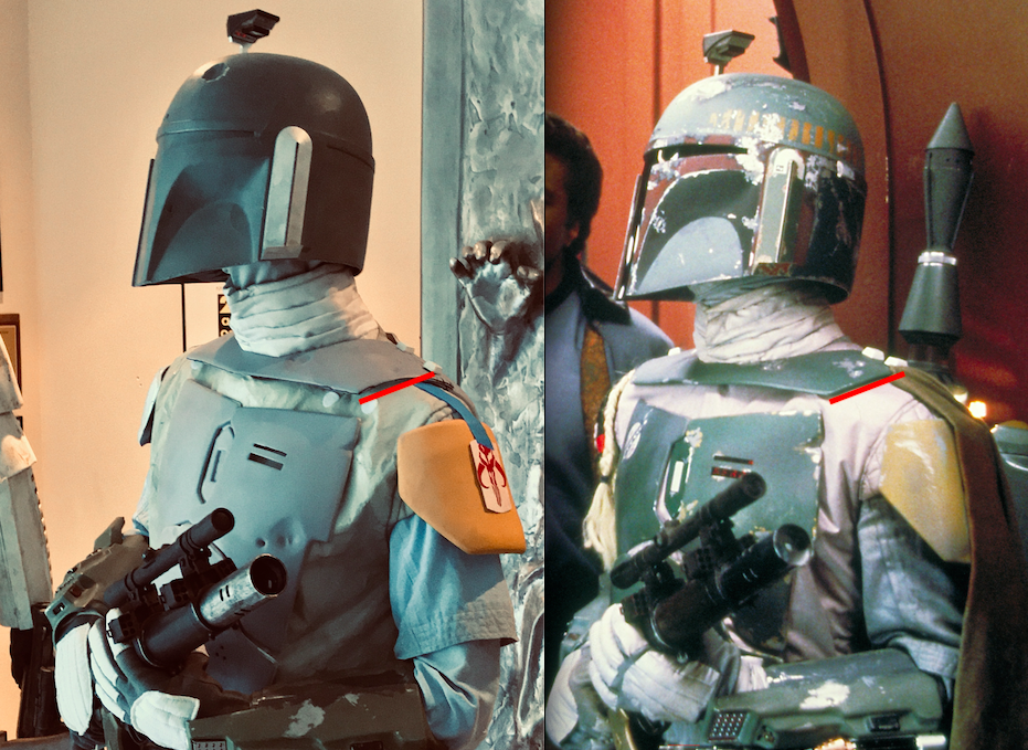

The day I posted this: Ord Mantell's ESB build was the day I realized the old FP armor just wasn't good enough for what I wanted to accomplish with this build. It all started with that pesky collar. The FP collar was wholly inadequate.
All praise to Janet Stevens.

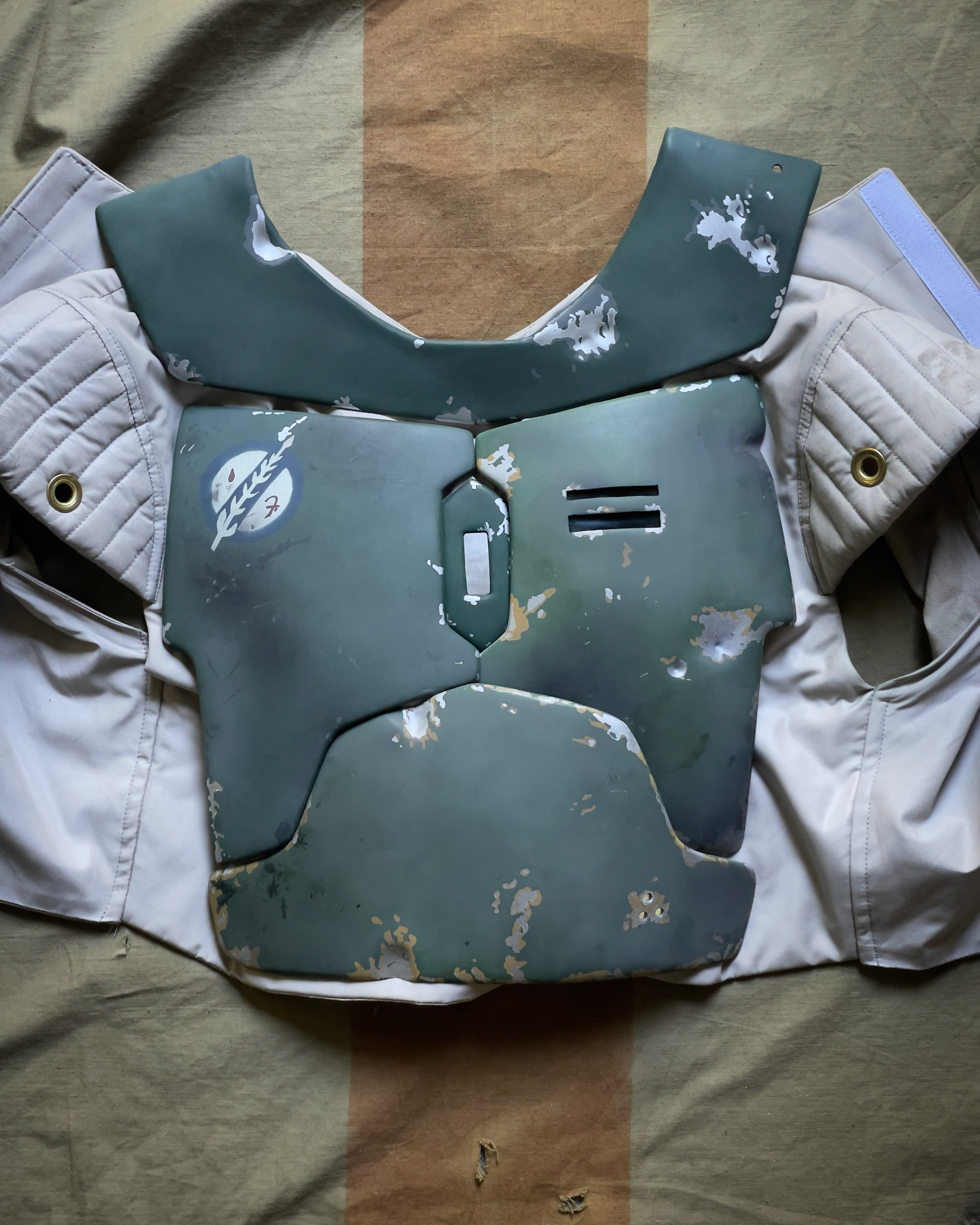

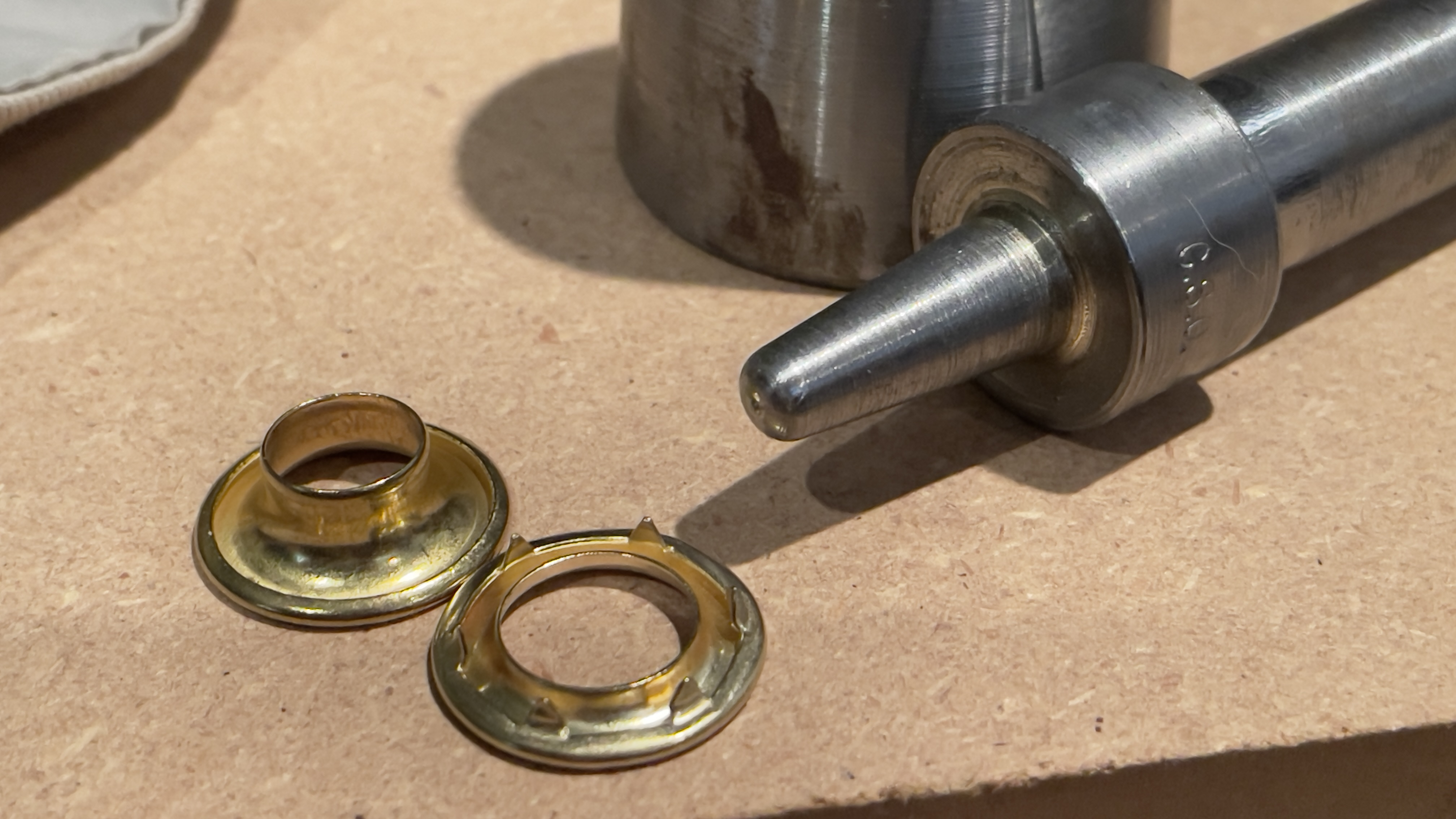

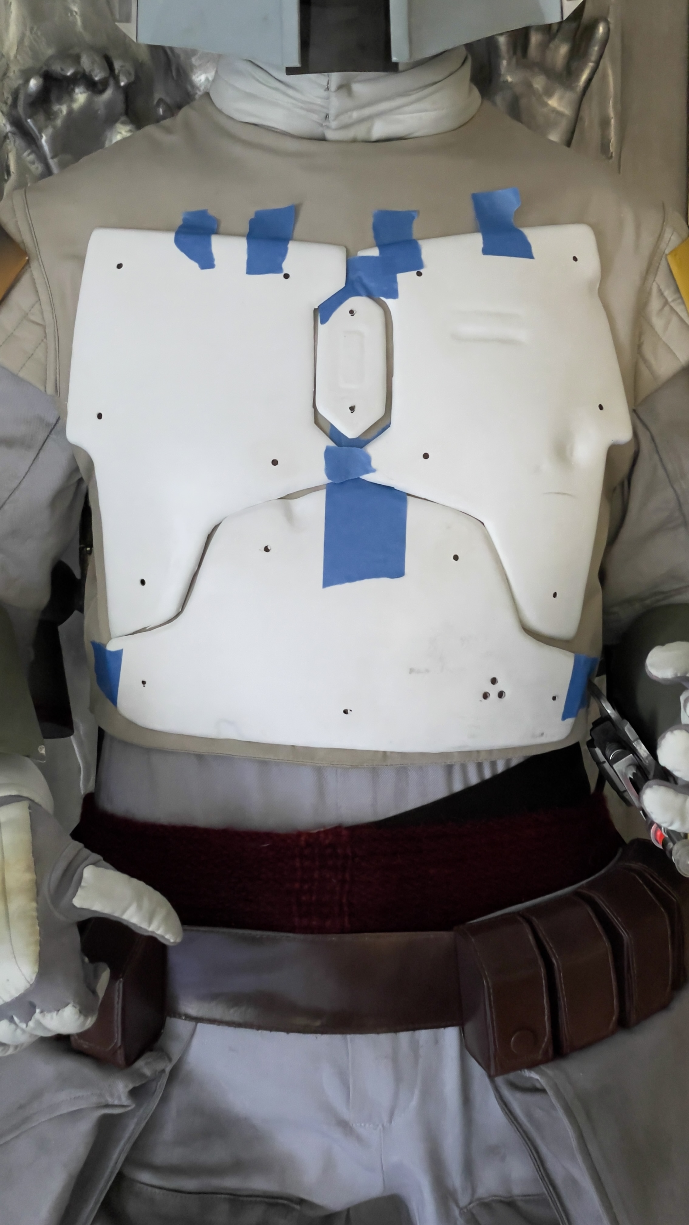

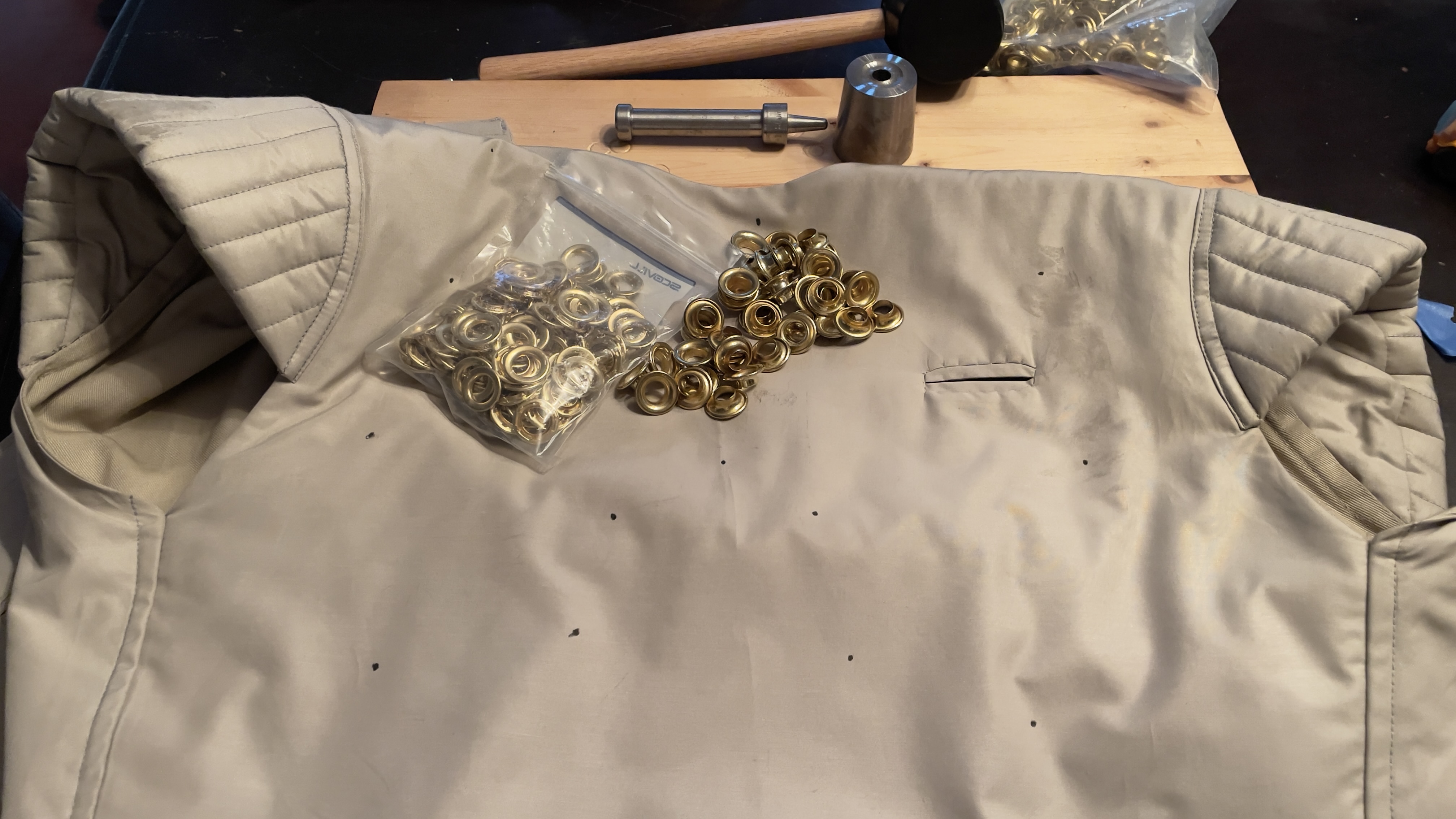

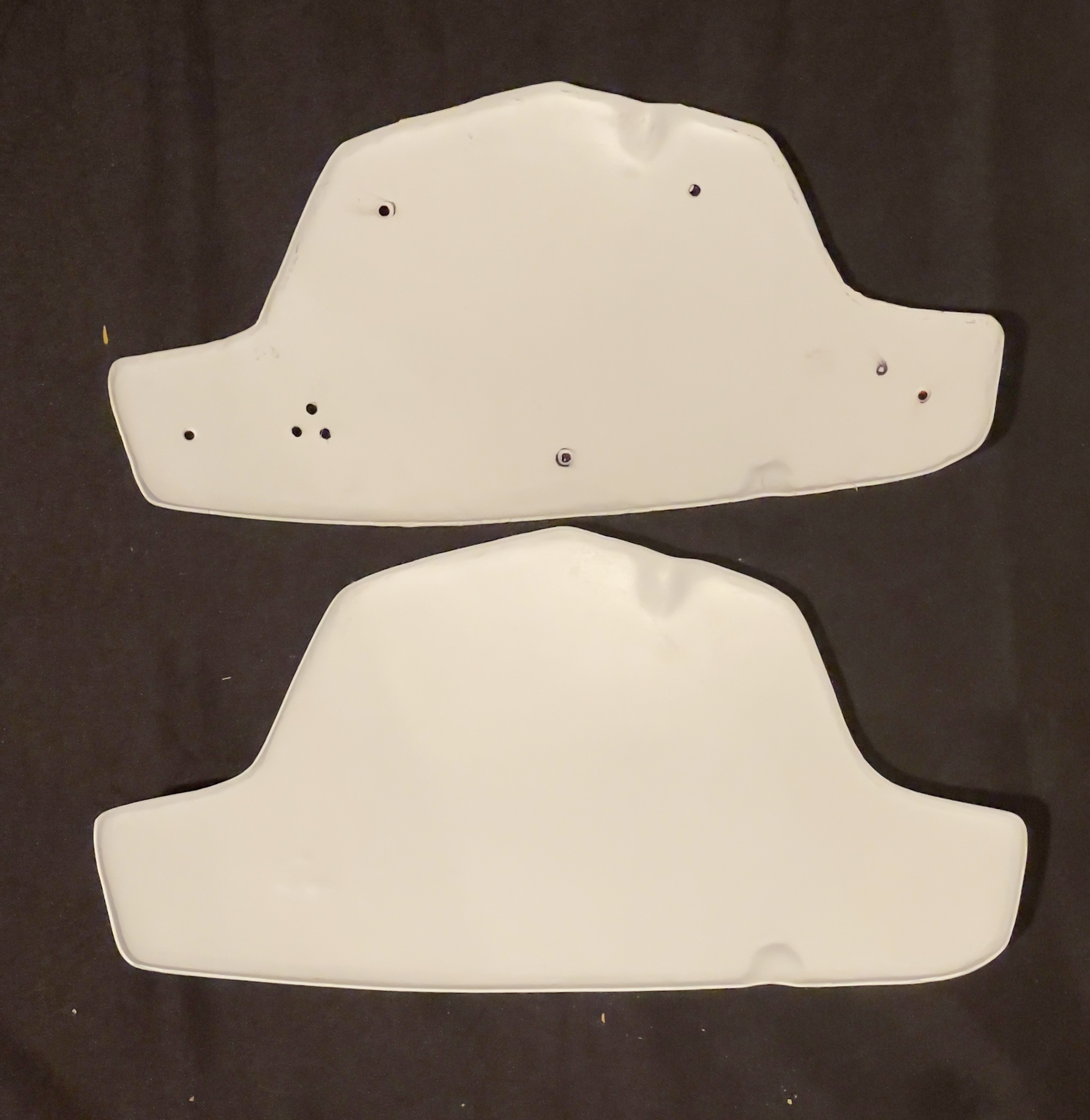

My process for mounting the armor on the vest begins with using an extra set of armor with holes drilled in where the posts and grommet holes should mate under the armor.
Place this on some kind of form, either yourself with the help of a friend or on a mannequin of some kind.
Mark where the holes are, and voila. That's where you punch holes in your vest.
Then punch holes.
View attachment 228319View attachment 228320

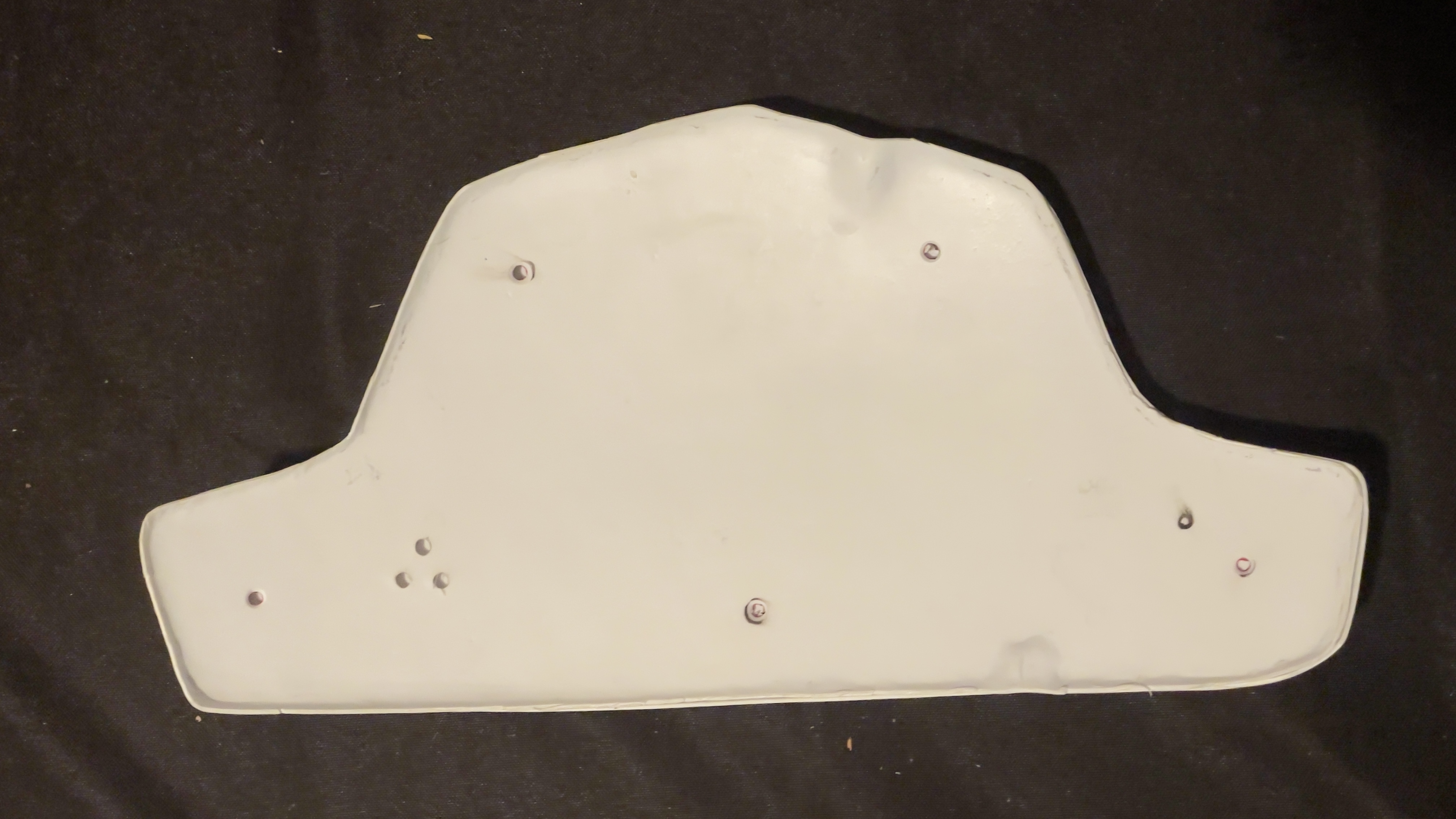

So how to get the post locations on the armor? Easy, use the same armor you used for the vest to mark the armor you will mount.
place the drilled armor on top.
Mark the holes.
That's where your posts go.
Initially I place them on with CA glue, but then you will still need to put the plastic cutouts on top to secure them better, and for that you can use more CA glue or what I think they used on the originals was sprue glue. Which is just the armor clippings melted in acetone and mixed to the consistency of glue. It's essentially liquid plastic that hardens in place like concrete. I'll take pics and show that part was well.
One thing I think is worth mentioning to people who can’t afford two sets of armor is you can make resin blanks from vacuformed armor
Using a good mold release spray , coat the inside of the armor and simply pour in your favorite casting resin. Let it dry and pop that sucker out. Clean the inside of the vacu formed armor with denatured alcohol. Then drill your holes in the thin resin casts. Voila!

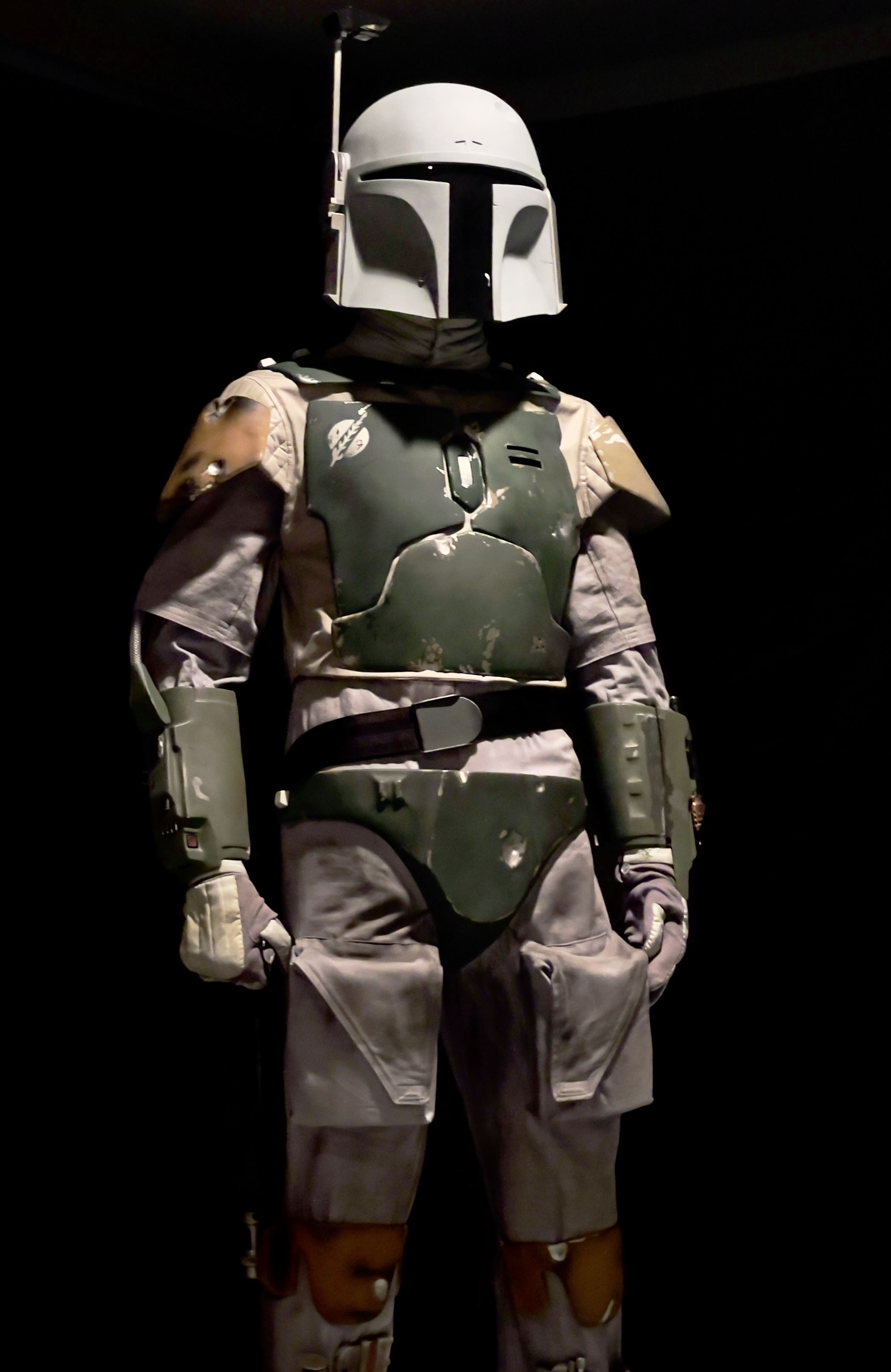

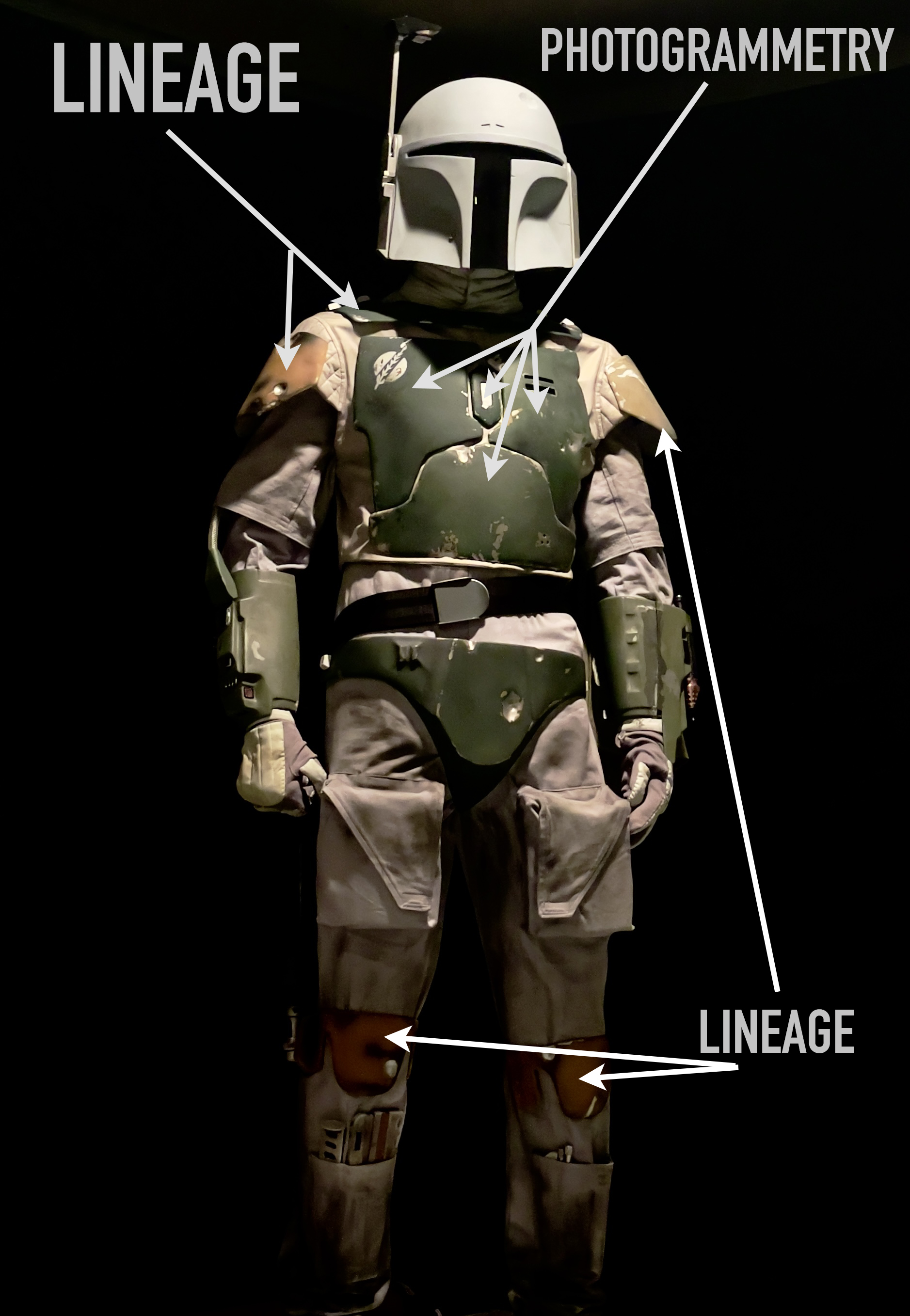

The new armor is a mix of lineage + photogrammetry. The results surpassed my expectations. I really don't think there will ever be a need to upgrade armor any further. In fact, I'm going to have to change my long-time avatar of my RotJ costume because I can't stand looking at the old armor anymore.

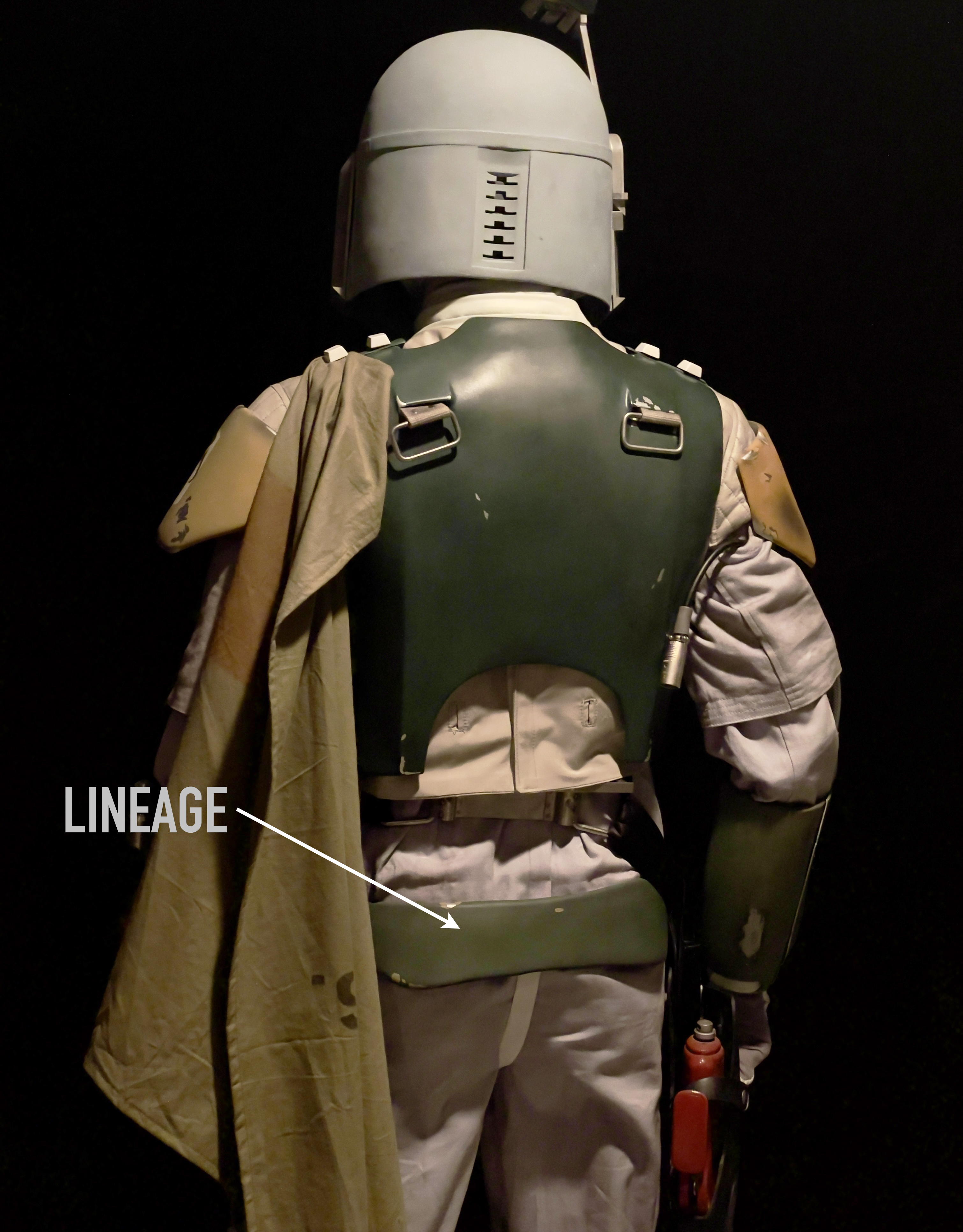

I’ve also recently tried wearing the jetpack harness without putting the crossbar through the flak vest. Did you do that on purpose here?
Yes. I'm setting this display up to be how John Morton wore it. There is plenty of evidence things were not fitting well on John, and one thing for sure, the jetpack was sitting lower, with the belt going lower on his waist which would've made it difficult for the slots to fit in the vest properly as intended. I'm going to have the vest redone, though, to correct some issues.
Indeed. I’ve found that balancing the placement of the jetpack, back armor, and harness to be the trickiest bit of wearing the whole costume.
The jetpack/harness needs to sit lower (on my body), but the "wings" of the backplate enforce some limits there and the length of the vest (when correct for armor on the front) easily becomes too short for the needs in the back! o_O
I’m glad I’m not the only one who has encountered this, even with the slits on my flak vest the (big Dane) harness tends to sit lower than the vest. It’s all very tricky once you start trying to lay it all on. It’s a wonder they didn’t come up with a simpler solution but I do see the genius of some of the build strategy. It is very much a reality that the Boba Fett costume( whichever version) is absolutely the most complex costume of the series and seems to have been made to a higher standard than say a stormtrooper or other armor
