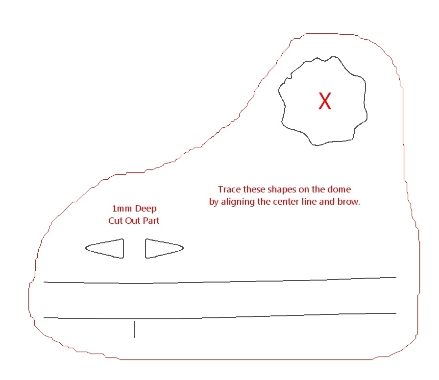

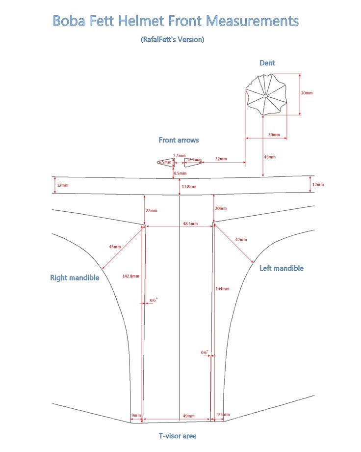

I found this template online, I believe that it's rafalfett's but I'm not positive

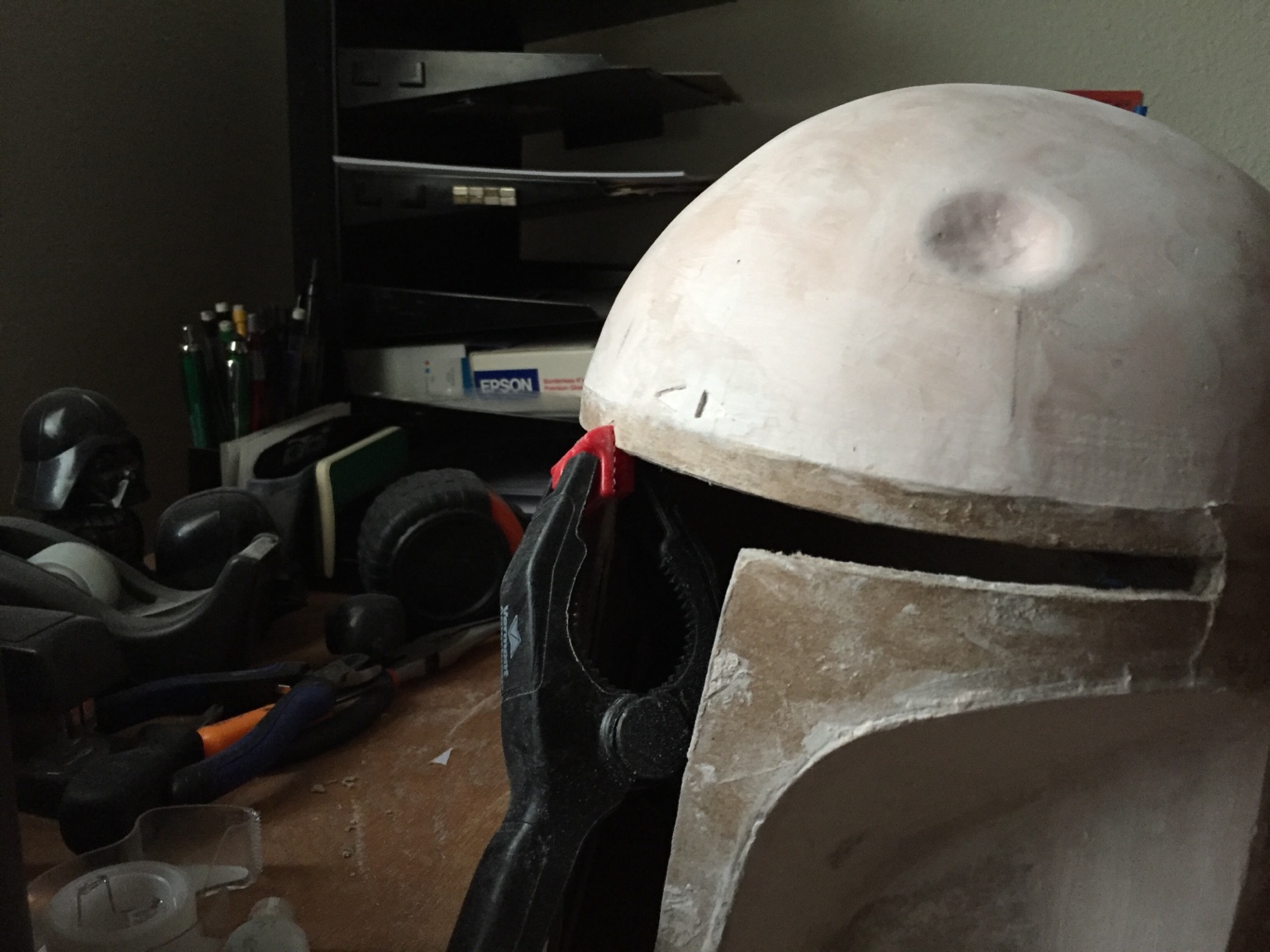

I put it on my lid to see the arrow and dent placement, but I had it sized wrong! :(
So once I noticed this, I filled the arrows and dent and used this template instead, by just measuring it
This was what I came up with

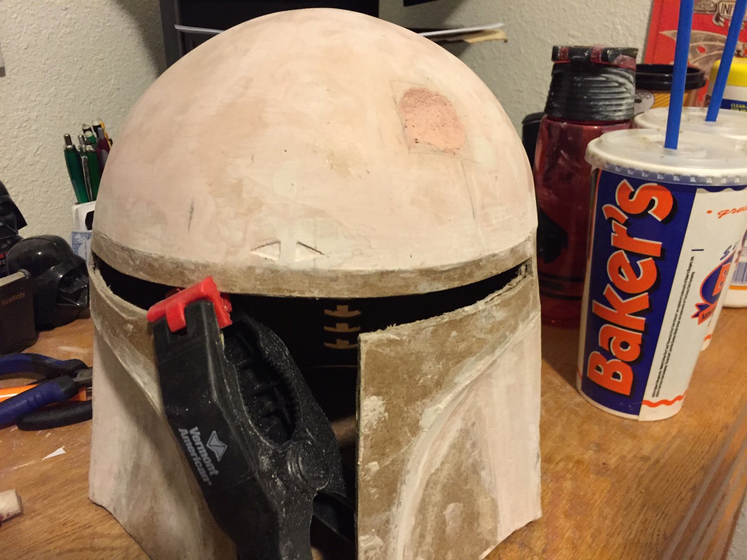

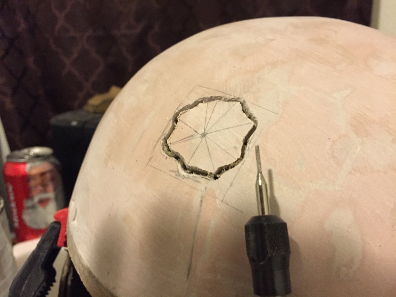

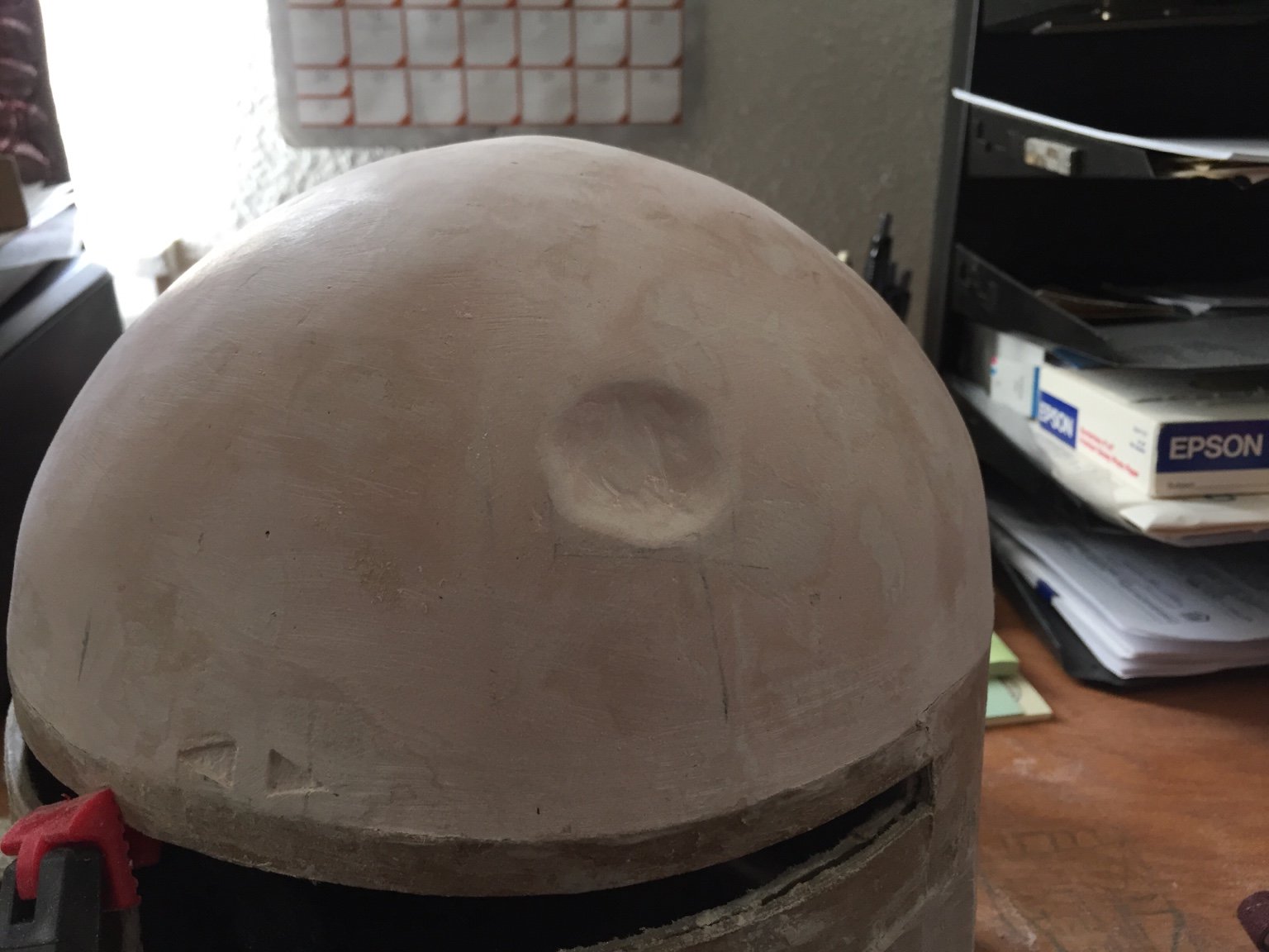

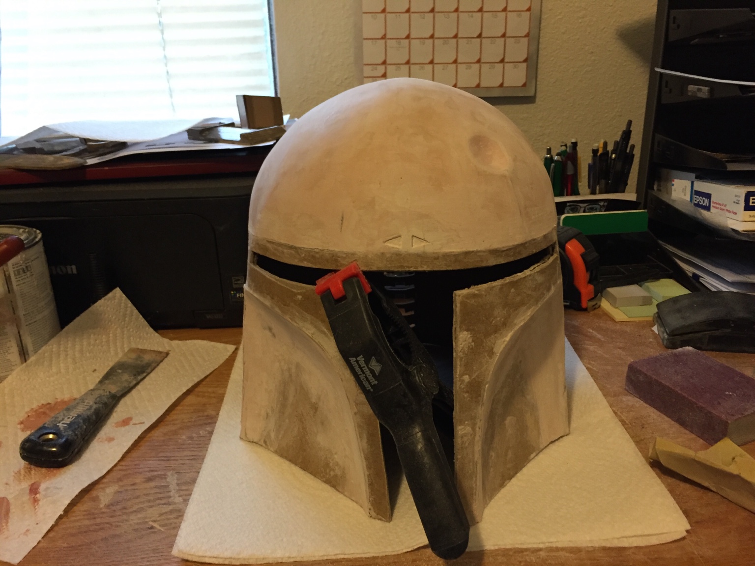

The clamp is just to keep the t-visit area from deforming while I worked on the dent

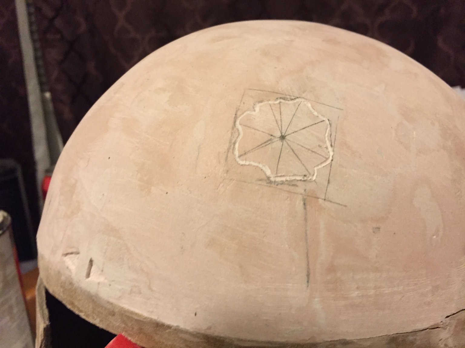

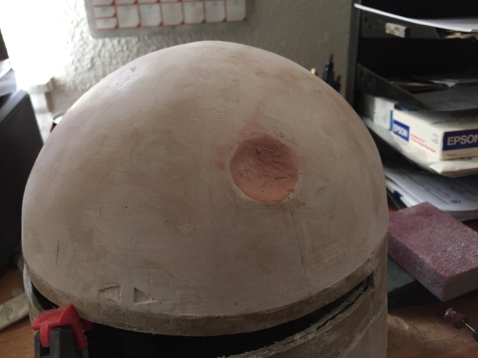

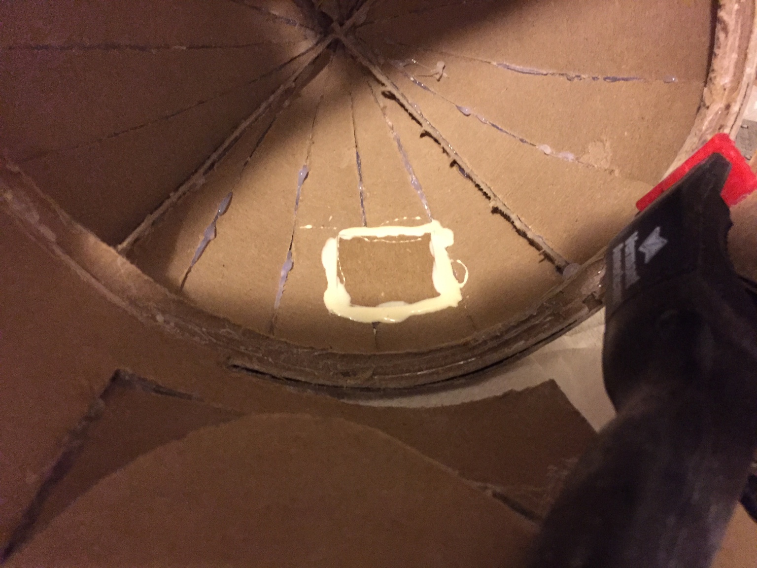

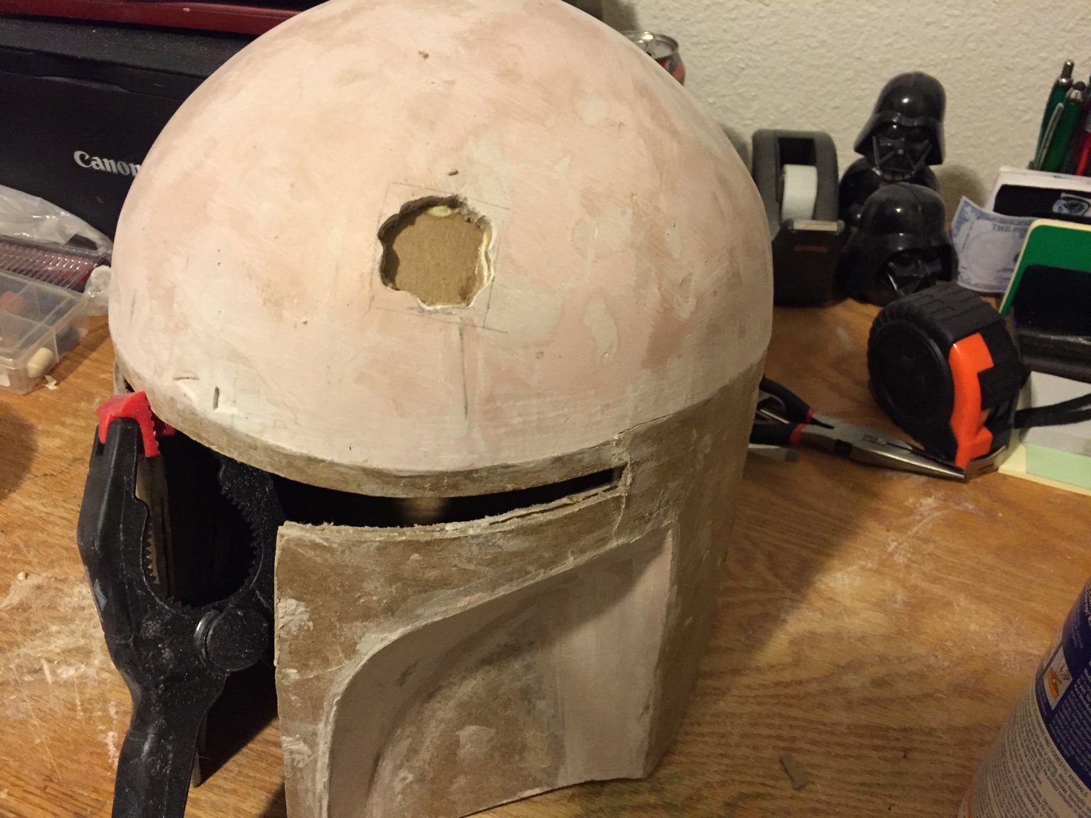

I glued a small piece of cardboard to the inside of the lid and then shaped the dent out of bondo. It didn't come out screen accurate at all but I like it
Dent still seemed a little too deep so I went one more round of bondo
And this is the final product

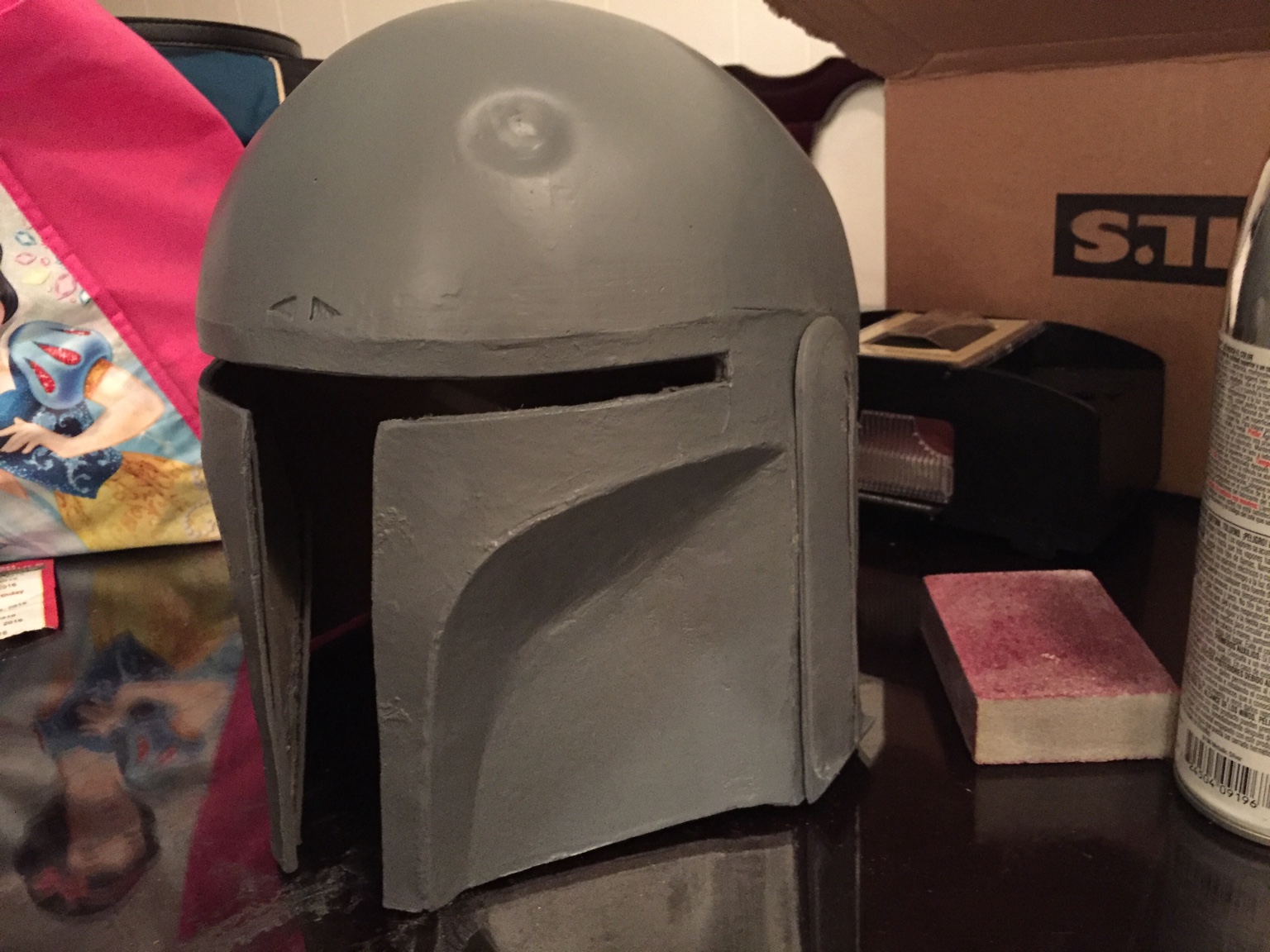

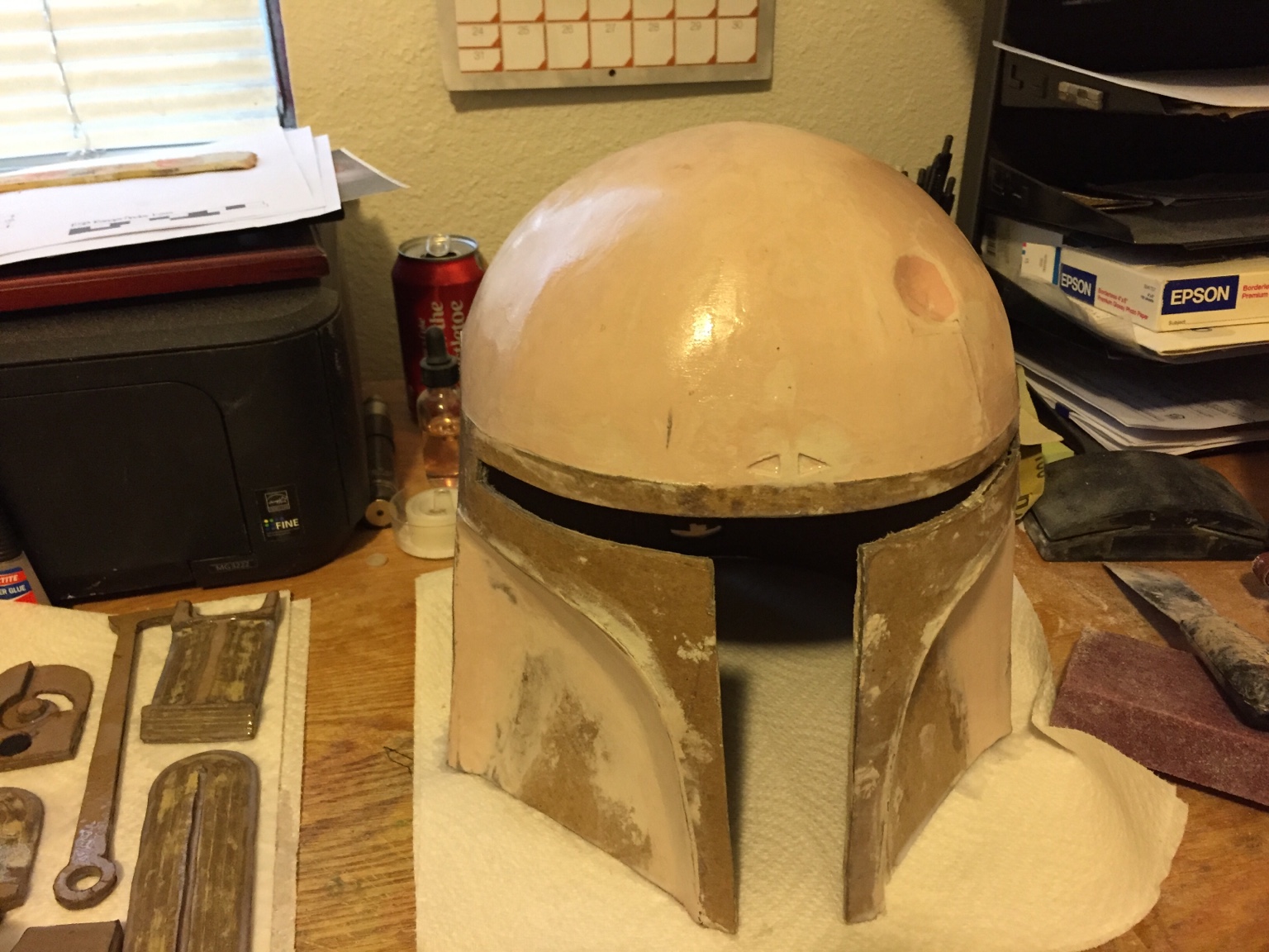

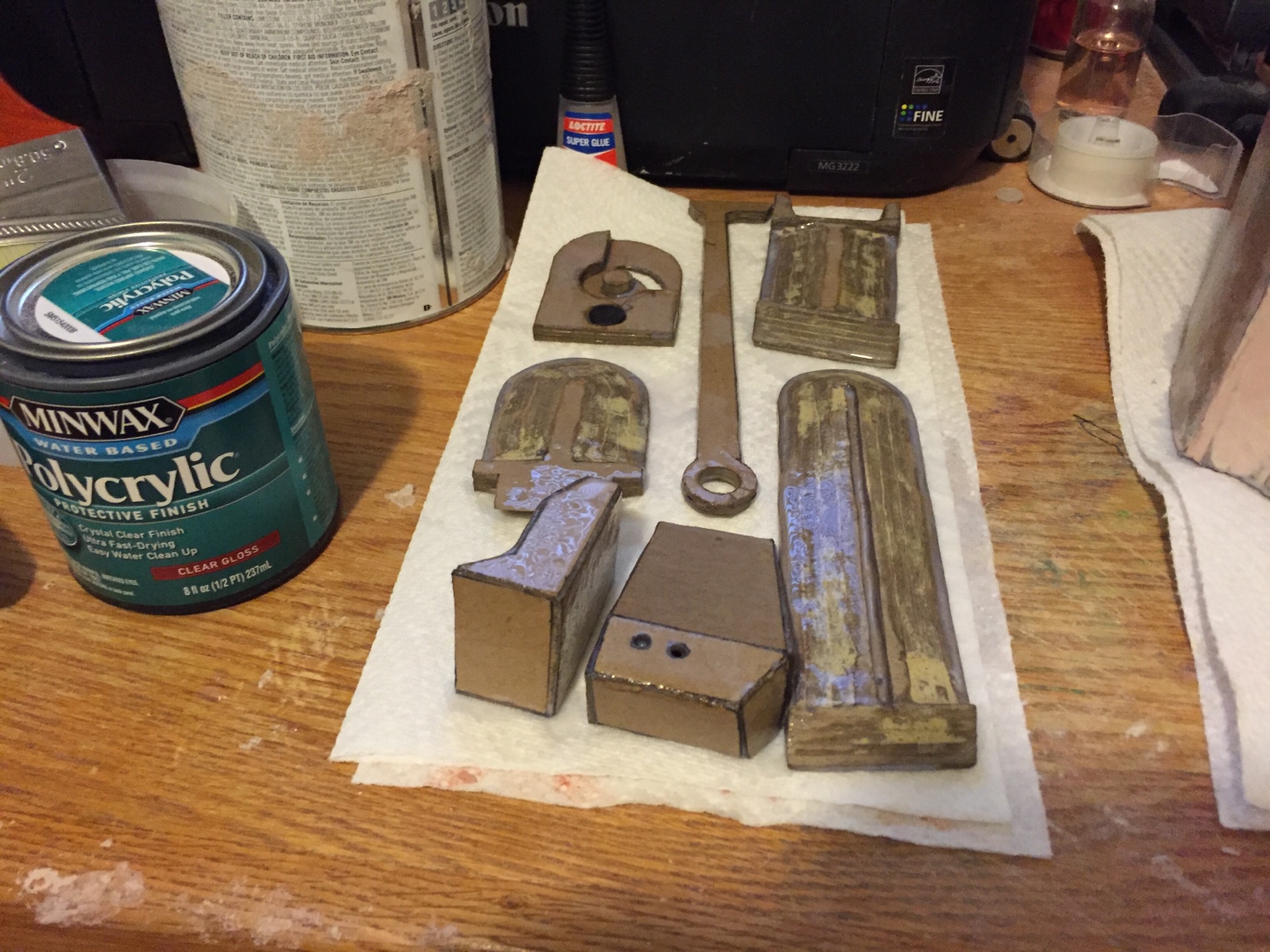

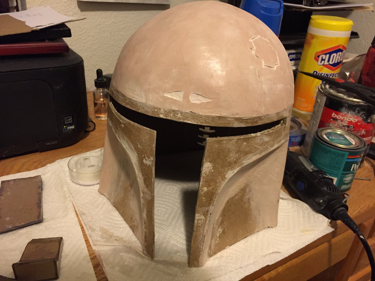

I then hit the other pieces with some wood filler to smooth them out
And hit everything with a few thin coats of sealer (at least I hope it's sealer. Did I use the right stuff???)
Well that's it for this update. Yeah some parts are a little sketchy looking but all in all I'm excited that I've been able to put something like this together.

Not sure about the painting over water based polycrylic sealer, are you using acrylic or oil/enamel paint?

Oh... And idk the difference I'm very new when it comes to paint. I'm only using rattle cans. Rustoleum primer went on fine so I'm hoping I'll be ok. That update is next

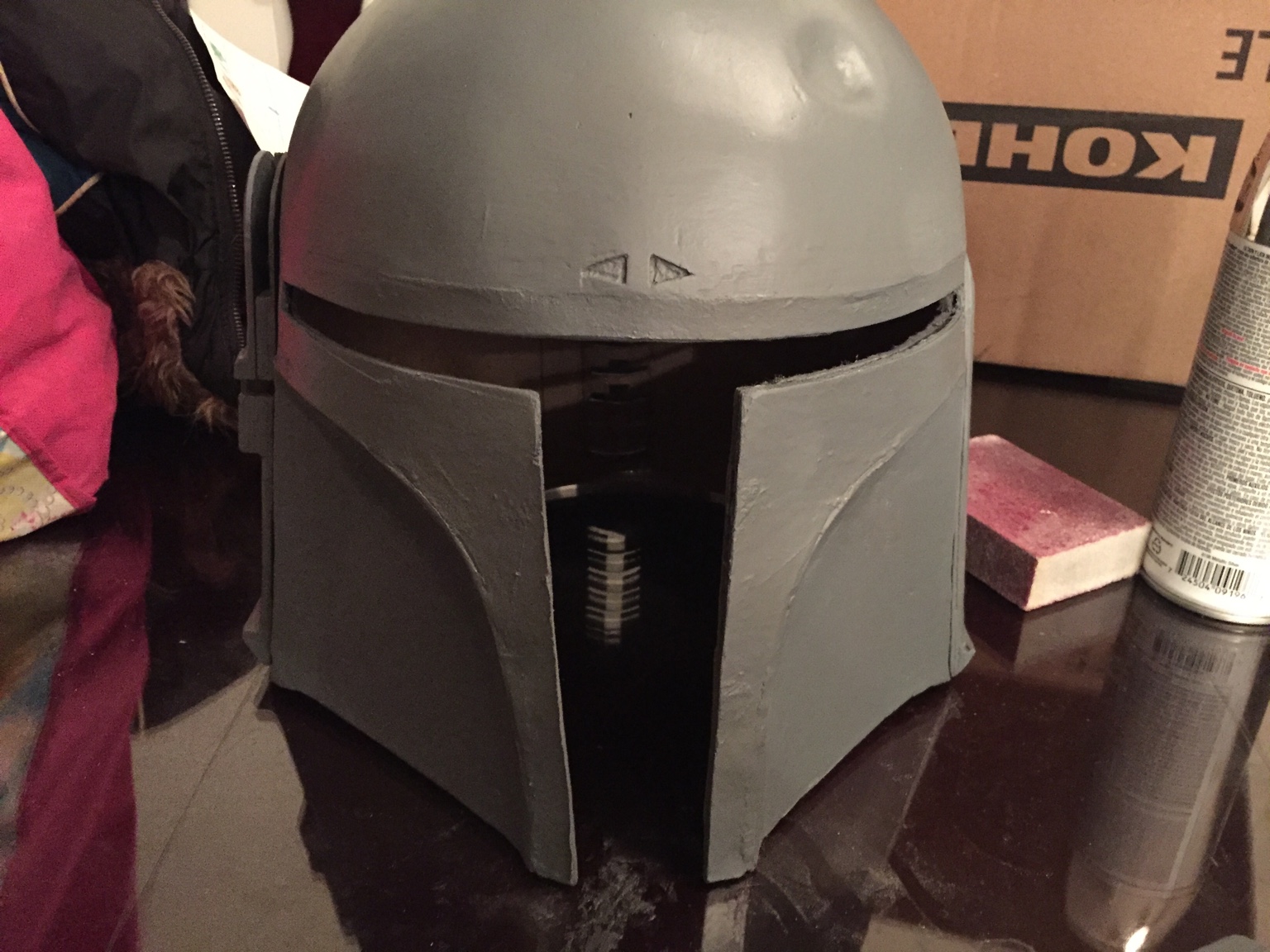

So I began by hitting it with some rustoleum primer
(Yes I'm aware the t-visor is slightly deformed. That's a fix I will have to worry about later)

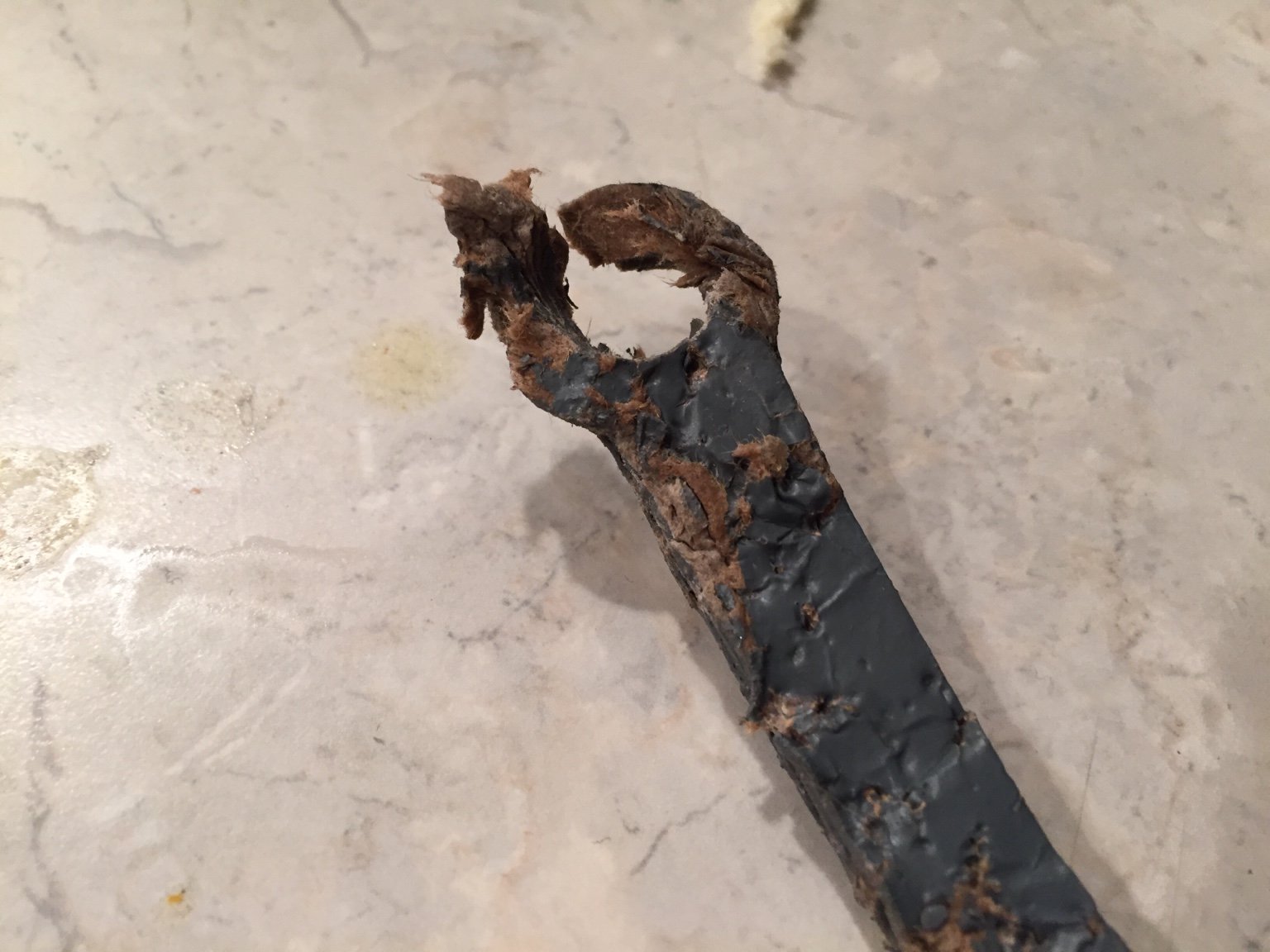

Oh no! My damn dog got ahold of my rangefinder stalk! Ugh! No worries, it was lame anyway. That gives me an excuse to make a better one!

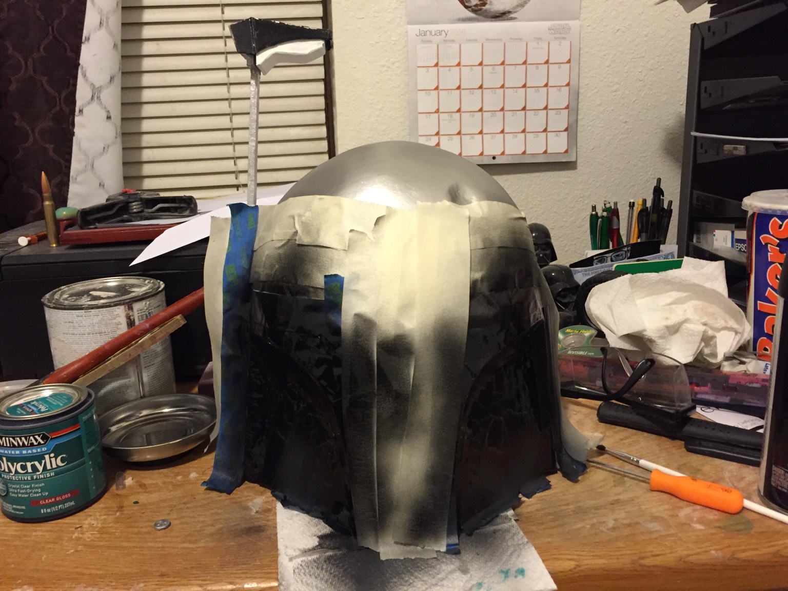

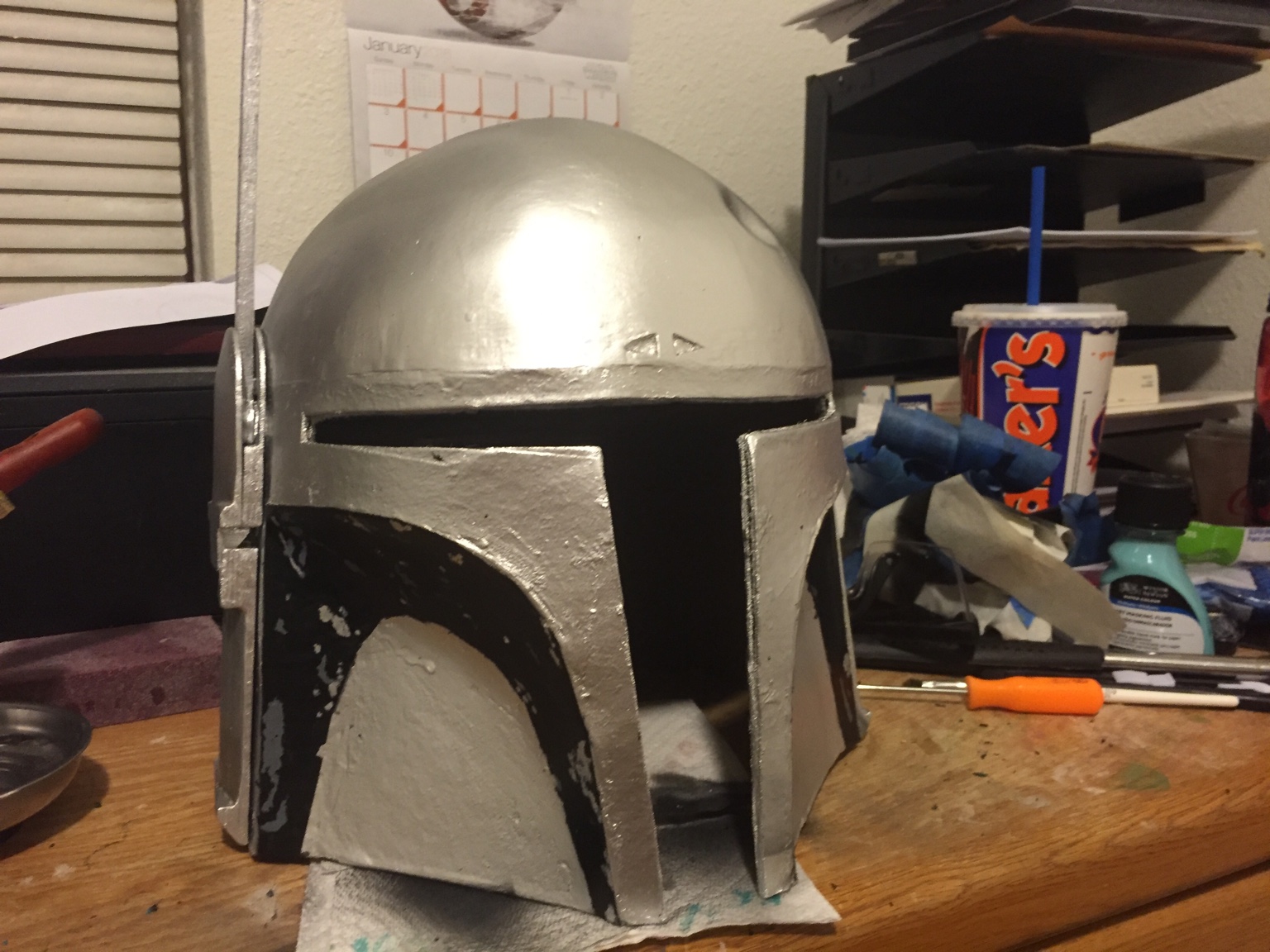

After the primer was dry I did an undercoat of krylon metallic silver. The game plan is to use liquid masking and layer the colors. We will see how that goes...
Better lighting.

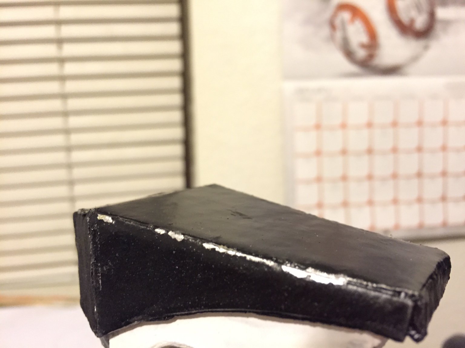

I painted the rangefinder with metallic silver, masked a little damage along the edges and then gave it some krylon satin black

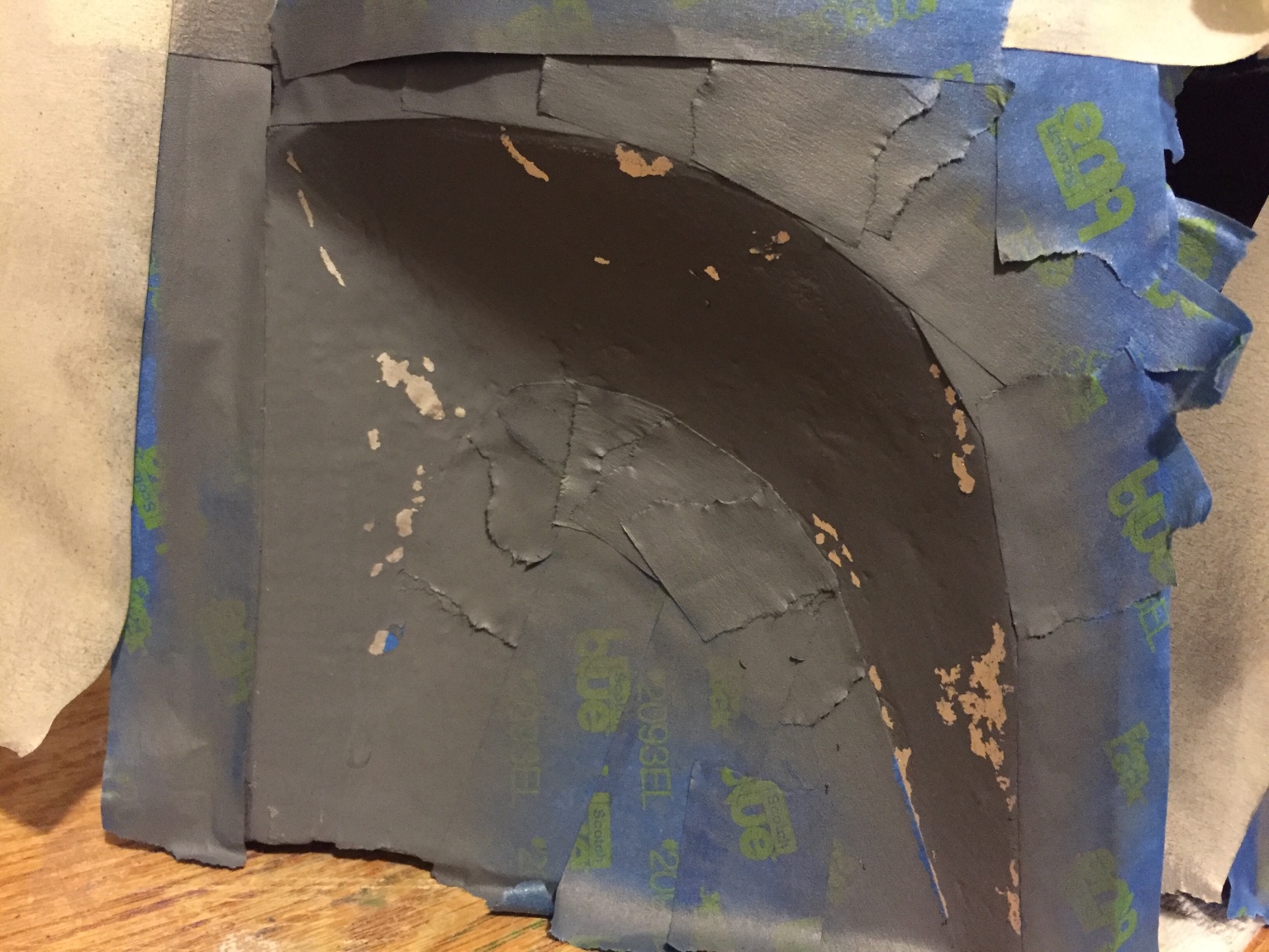

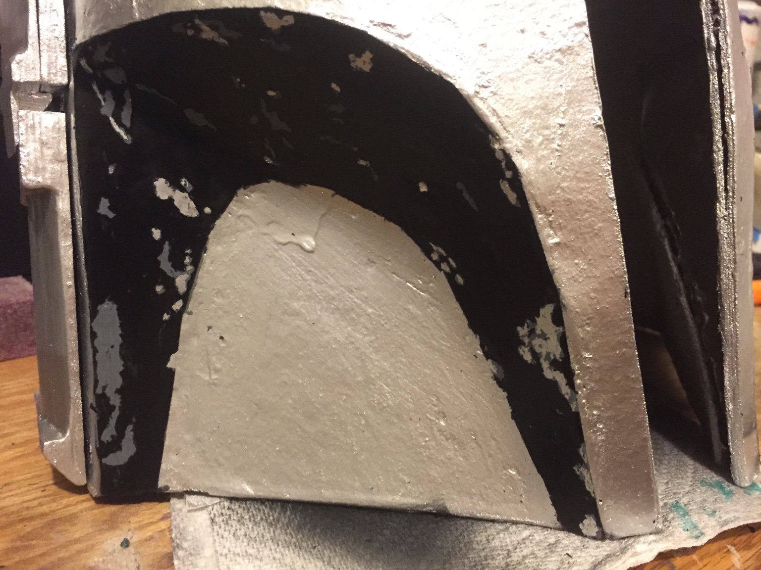

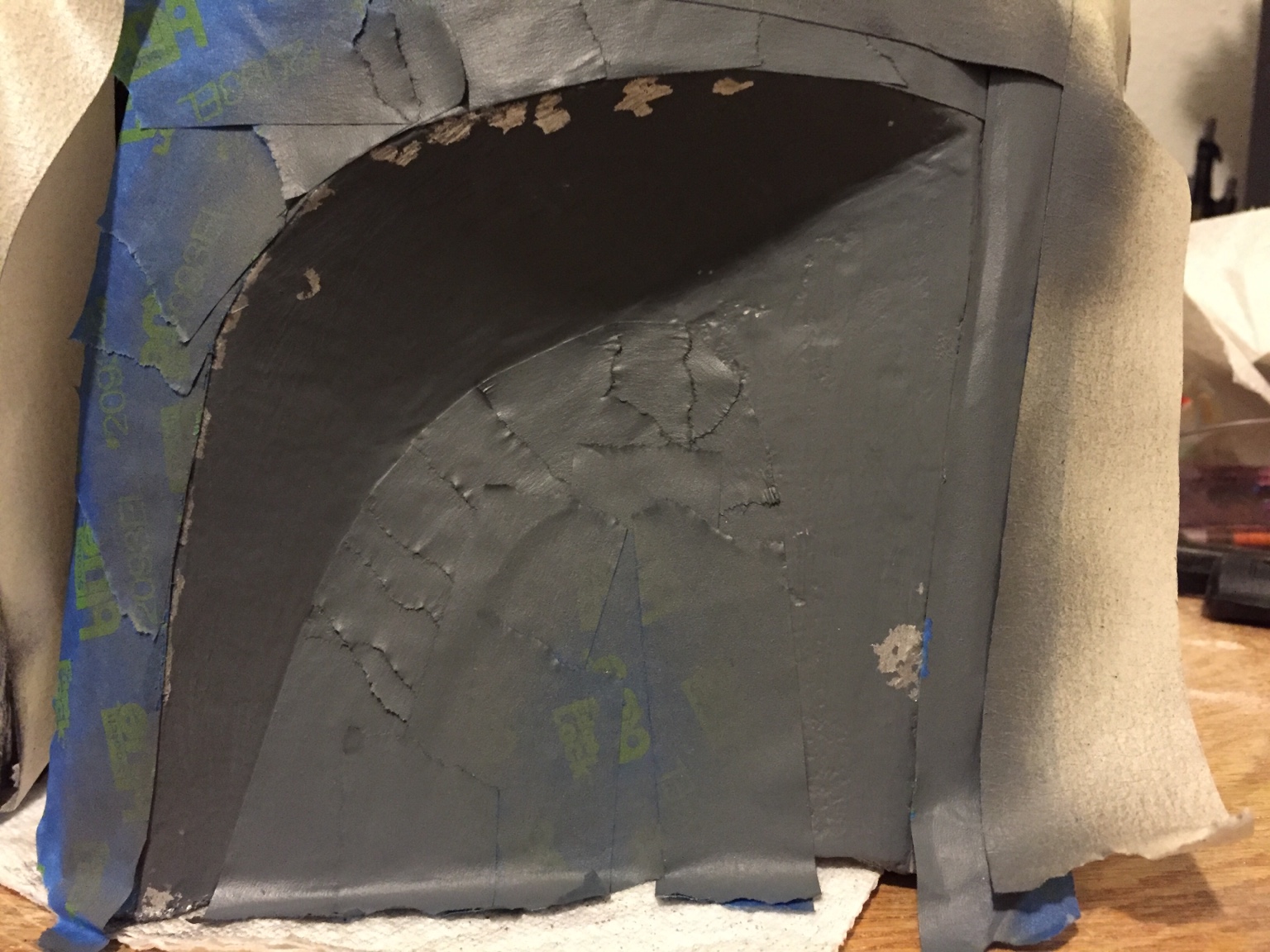

I masked the silver damage and then put on some grey.
After peeling off the masking fluid, I'm overall pretty pleased.
I then masked off the silver damage and the grey damage, and painted the upper cheeks black.
I know flat black is not accurate, but I prefer that look... And eh, this bucket is just for me anyway. Not trying to impress anyone

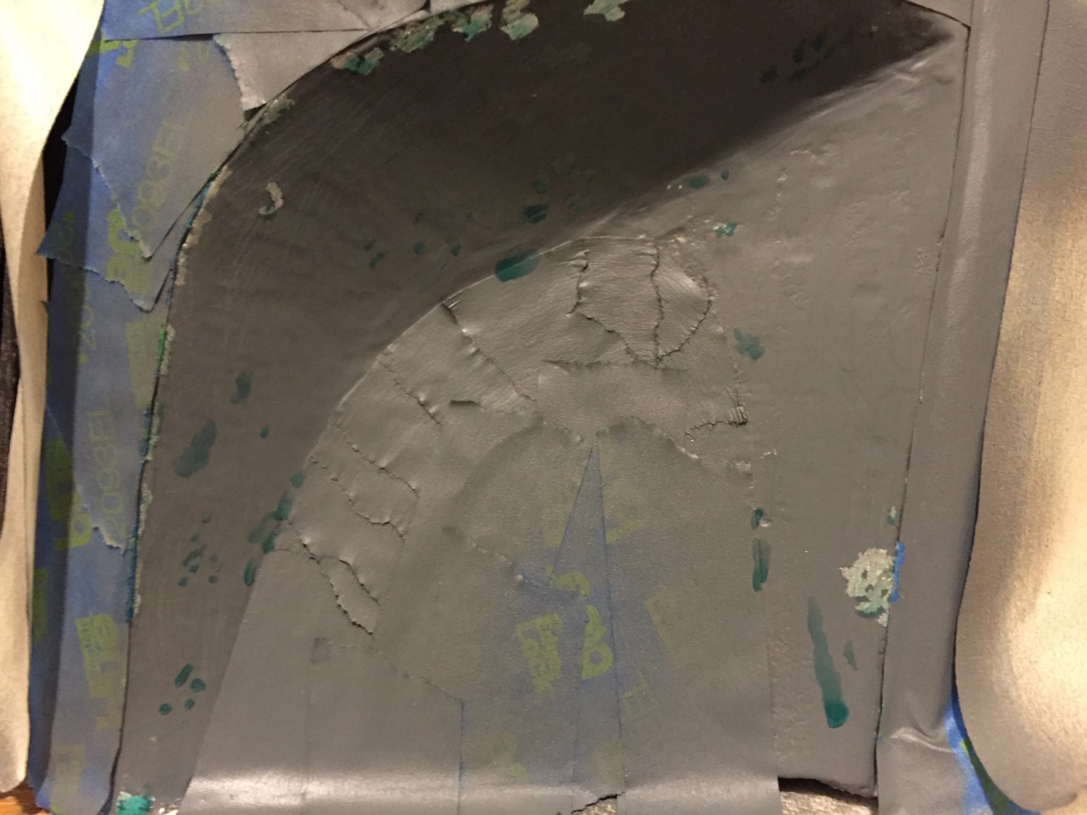

With masking fluid:
And the first layer of black

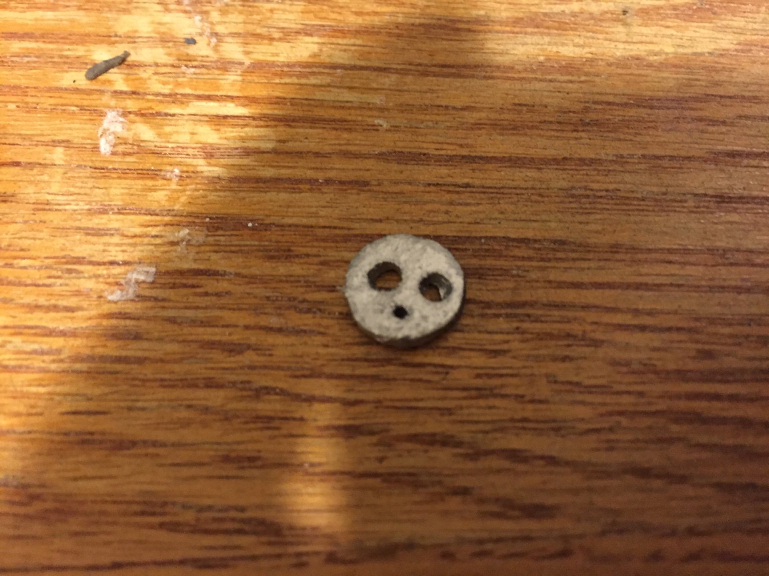

Quick question: I made a cardboard Borden connector but I haven't been able to find a ton of resources as to exactly where it goes, what direction its holes are oriented, what color, etc. all I know is roughly where it goes on the right cheek. Does anyone know of any good threads or references for this?

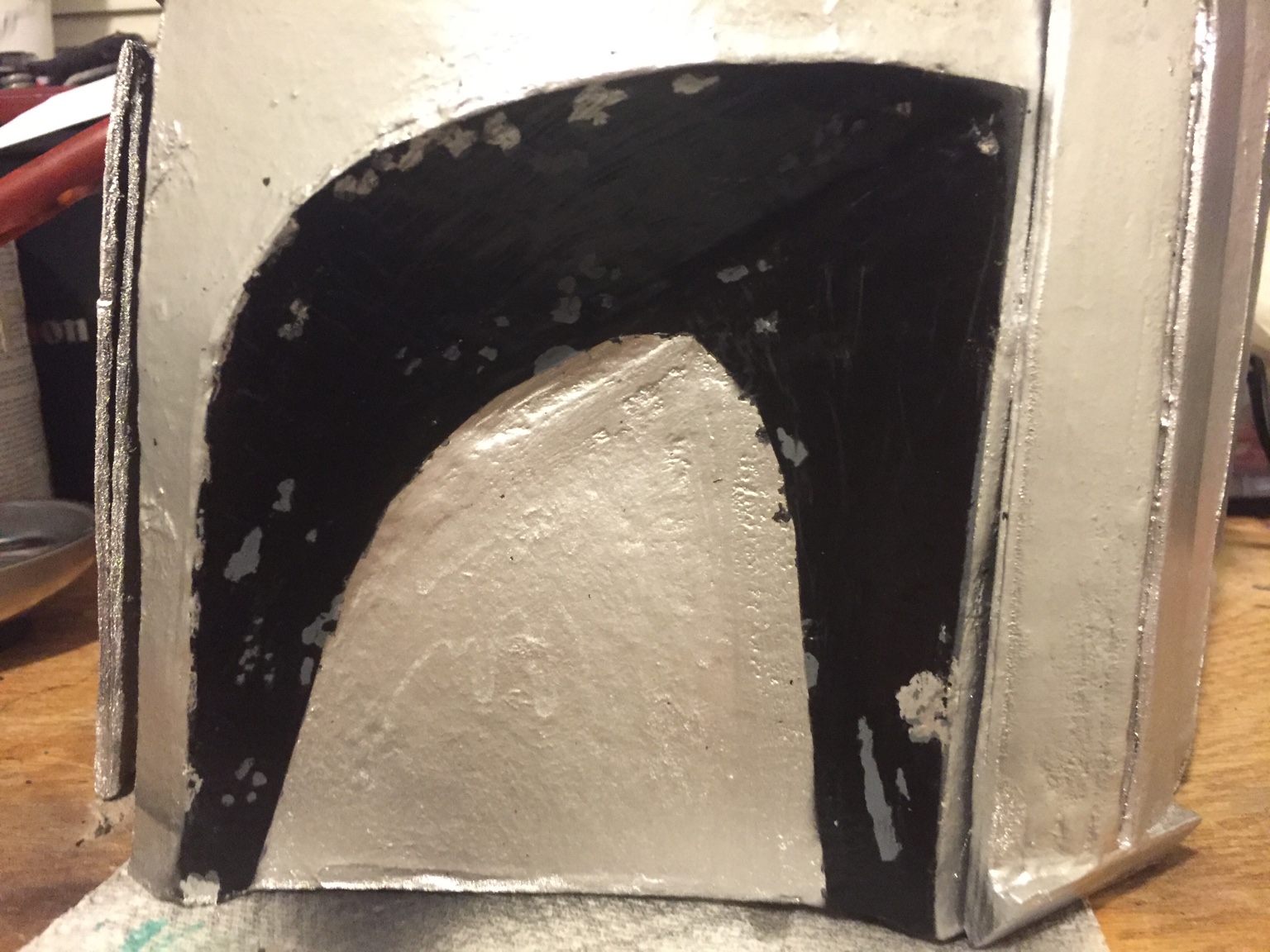

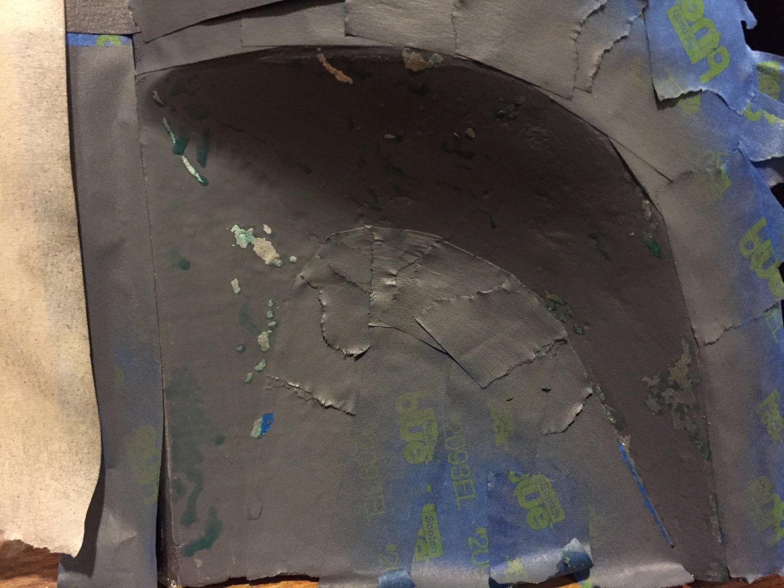

After letting the last black coat dry for just under 24 hours I finally got to take the liquid mask off
My final verdict on how I think it turned out:
Eh... I don't really know. Sometimes I look at it and think that it doesn't look half bad and then I'll look again a minute later and think it's terrible.
Honestly it's probably somewhere in between those two

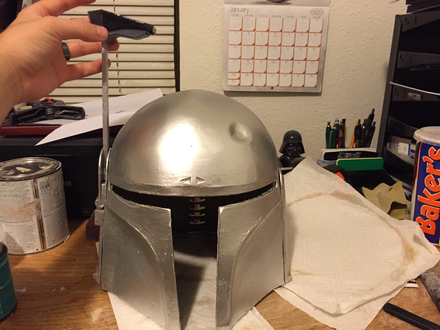

I haven't had a ton of time lately unfortunately but last night I found an hour to work on the helmet so I thought I'd do a real short update

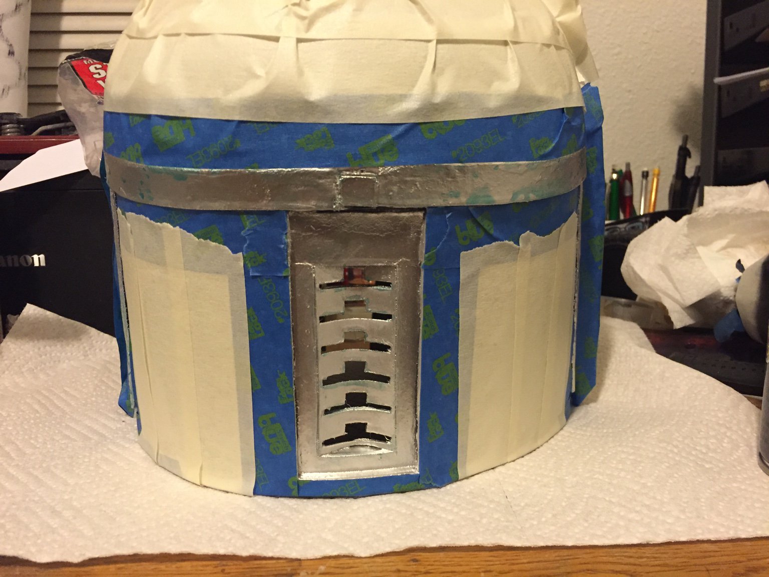

Like I said I don't have quite all the paint I need so I decided to do the mandibles.
I left the tape off of the key slots because that needs to be grey just like the first coat on the mandibles. I'm not sure if it's the right grey, so if I need to correct that later I will. I'm going to mask the key slots off for when I paint the red
I masked off the silver damage on the mandibles and around the back rim and put on the grey.
Once that's done I'm going to mask off the silver and grey damage and then go with the red. Hopefully will be done later today
