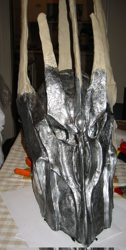

I made a Sauron helmet, using lightly shaped sintra, and sculpted Gapoxio (an A B epoxy clay) directly over it.
Of course, it's 9lbs, but it still got the job done! And the helmet only took me 2 weeks.
That is nine pounds of pure frigging COOL! :)

Camaro: that thing is SWEET. Nice work! How long is that epoxy workable for before it hardens?
Wow !!!! ... that is really something !! :).. maybe you could have a go at a prologue Elven helmet next
Gapoxio hardens after about an hour. The best thing about it, is that you can make it very smooth, with water, with only your fingertips. (did I already mention that?) :lol:
