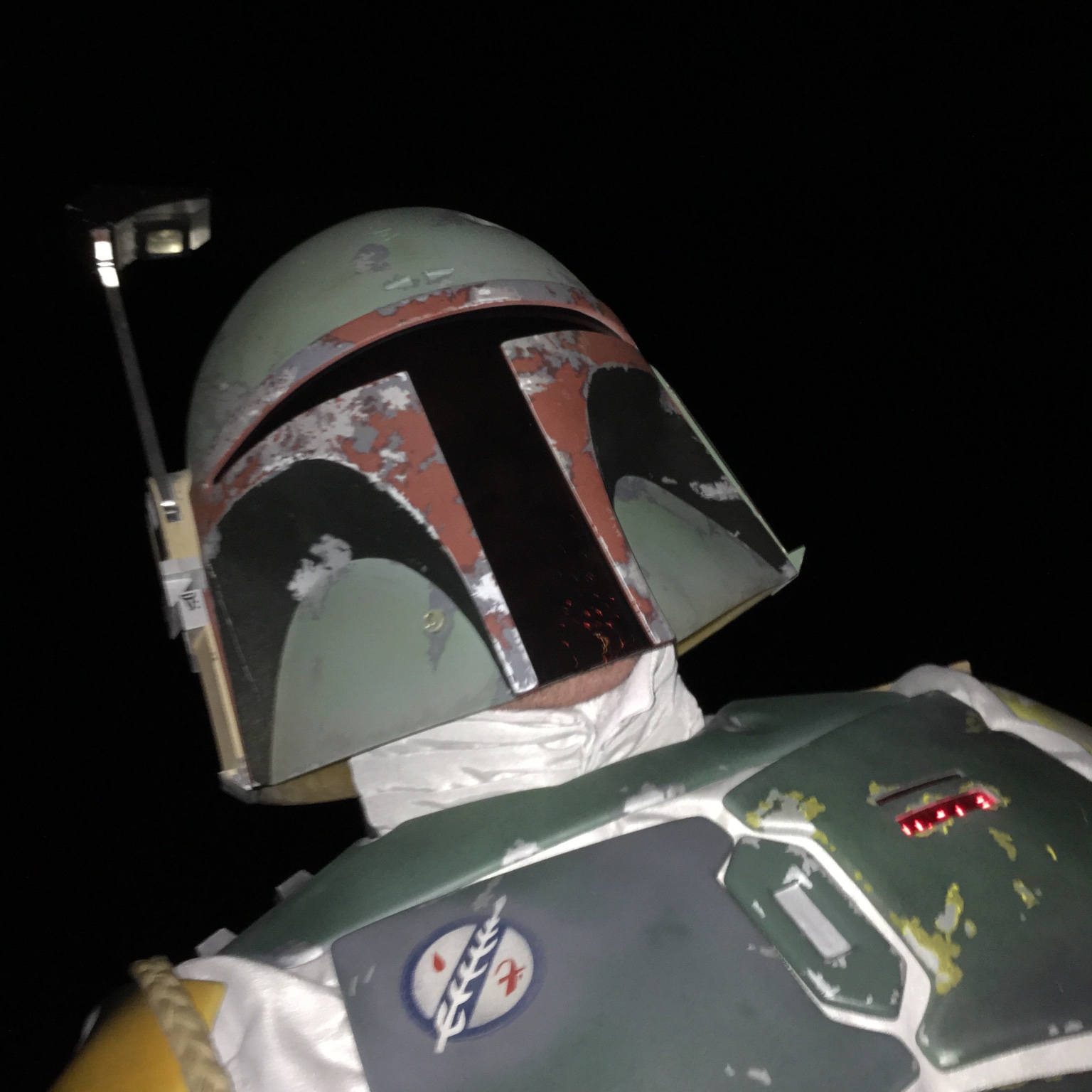

I cannibalized my Aker which sits in my left ammo belt pouch, leaving only the rechargeable battery and amplifier (making it much lighter). I run a wire from the amp up from the pocket and inside the flight suit, down my left sleeve and out the cuff of my glove to a momentary switch, then back through the sleeve to a circa 2000 Altec Lansing cpu speaker set. this allows me to control when my voice is amplified as it only activates the speaker when the switch is pressed. with my right hand constantly gripping my EE3, the left hand made the most sense and the switch hides easily in my palm outside of my glove.
the slender set of speakers literally hangs around my neck like a necklace and positions directly behind the center diamond, perfectly resting in my man cleavage causing zero bulge and centers my voice directly beneath my helmet. no talking out of my crotch or gauntlets or boots [emoji13]
you cant even tell its there...
being able to control when you amplify your voice is a huge perk, especially when you have to sneeze, or tell your buddy to check out that half naked cosplay girl over yonder. i have zero feedback, easy to fabricate and very easy to set up.
if anyone is interested, a full setup of these speakers (2 sets of 2 small speakers + subwoofer) in their original form goes for about 20 bucks on ebay (Altec Lansing 2100). their individual wattage aligns perfectly with the Aker amplifier output and they are LOUD together (mine is only turned up about half way). you don't have to worry about blowing them or messing up the amp itself.
hope this helps!
