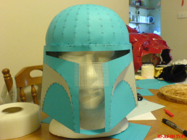

OK guys here is a Photo of the bucket. Skip, I hope I'm not jacking your thread mate! (I forgot about the visor insert you mentioned!)
Hey that looks good, I like the cards color scheme too! :) For the support parts I'd either laminate card together to thicken and strengthen it, or use thicker card. I can see it bowing there so the weight of resin or fibreglass could cause it to bend more and spoil the shape.
Can I ask how the dome looks? I can't see all around it. I wasn't sure about unfolding the dome that way. When I did the RG lid, I unfolded the dome into horizontal strips rather then for forks I went with on this one. Did it build ok? Or would you recommend the strips?

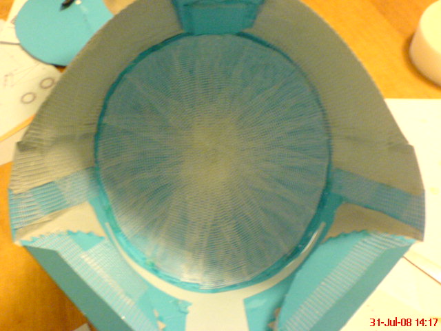

I fixed the problem with the ‘eye’ area; I inserted the visor and added a thin coat of casting resin to form the shape. I've resin/glass it this afternoon. I might have to start my own thread about this Mondo Buy’ce, (instead of wasting your space.)
The dome was THE hardest part but I think it turned out OK. I think for this bucket, horizontal strips works best, it was hard but once I join the four pieces together it just took shape no need for extra support. Besides Samurai Kabuto are constructed the same way and it’s worked well for them for almost a thousand years (I’m a History Buff). I think the strips are more of a project to project thing, I don’t think that it may have worked for the RG lid.

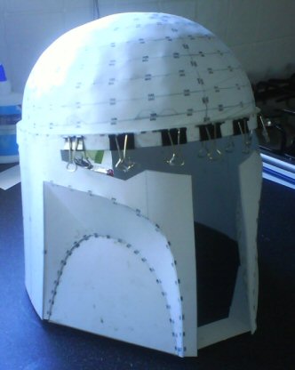

...I'm building my own bucket from my templates. For mine I wanted a stronger base to begin with to I laminated all of my sheets (except the dome parts)to thicker cardboard, 1mm thick. The helmet was still easy to make and the thicker card will help against warping or accidental damage before the fibreglass is added. To ensure a more stable model prior to glassing, I even triple laminated the flat plates inside the mandables.
It's looking really good so far IMO and hopefully will become a nice lid when I'm done. :)
I thought I'd post these here as well as my Custom thread. This won't be a Fett lid but it was built using my templates.
I improvised alot here as I wanted to use thicker card for it to form a tougher base. I pretty much explained it in my last post I think. Anyway, here are the pics:
