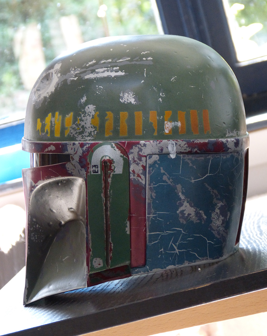

Hi,
after a few more days to think about that helmet, I figured something else that I wanted to show. I cannot fit inside that helmet and I got told by the seller that he couldn't do anything about that, BUT, it seems to me that the bottom edge of the back is really pushed inside (the front is also pushed outside) it's like if the not yet cured cast had been sitting on a table and deformed under its own weight. what do you guys think? and also does someone with a bit of experience has any idea how to properly re-deform that into the proper shape?

It looks to me like there is deformation to the face with the mandibles pushed in, and to the rear panels with the bottom pushed in. It also looks like a deformation on the top of the dome.

Could be the resin, some have particularly poor heat-resistance, Smooth-Cast 65D in particular gives many people problems. Some Cali and Florida cosplayers have actually had their 65D-made costumes deform from just being out in the sunlight. Maybe got deformed from sitting in a sweltering ground shipping container, or ifyou live in a hot area eethan and left it in the sunlight. Would explain the cracked appearance of the paint on the back too, if that's not just crappy painting.
Doesn't explain some of the other issues like the cheek bumps and the rocky textured ears, but yeah, does look like the whole thing got heated up and flattened at some point.

Interesting point you've raised there because the cracking on the back panels doesn't appear to be present in the pictures in the first post. The visor gap appears to be far straighter in the picture in the first post than the outward curvature in the later pictures indicating that at least some of this warping has occurred after those first pictures were taken?
I've had resin casts deform in just direct sunlight
The helmet in the first post is from a different individual, not the helmet that eethan received.

Yeah, my helmet had already the cracking on the paint and everything and I'm almost sure it didn't deform more since I first received it.

I'll try to reshape my helmet with an hairdrier gently when I get the time and see where that gets me.

I think he just wishes you had expressed the problem directly to him earlier so he could have taken steps to make it right. Since OP's helmet from the same maker looks alright, and you say yours arrived deformed, it'd say it's almost surely an issue that occurred during shipping in some hot tractor trailer or something. If so, all he'd have to do is switch to a more heat-resistant resin like ONYX or even one of the Task-lines, and no customers would risk experiencing the problem again.
