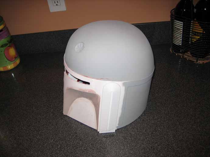

Wow, that is amazing!! Were the upper cheeks hard to get curved like that? And what kind of glue did you use to hold it together? I'm thinking of using three pieces for the upper cheeks, but I was wondering how using two pieces worked out for you?

The upper cheeks were the hardest part of the forming process. It is actually four pieces per side. I tried one piece and there was no way. Too many conflicting curves. I cut the original piece into four pieces (back corner, upper corner, middle curve and finally the lower cheek. If you look carefully you should be able to just make out where the lower three pieces are connected. I use super glue for the initial tacks then used Pro Weld liquid cement to join the sections. I reinforced the joints with a bead of super glue and accelerator. Thanks to everyone for the great feedback and I will keep you posted with my progress.

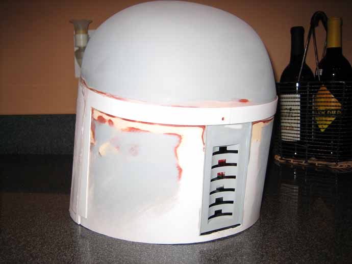

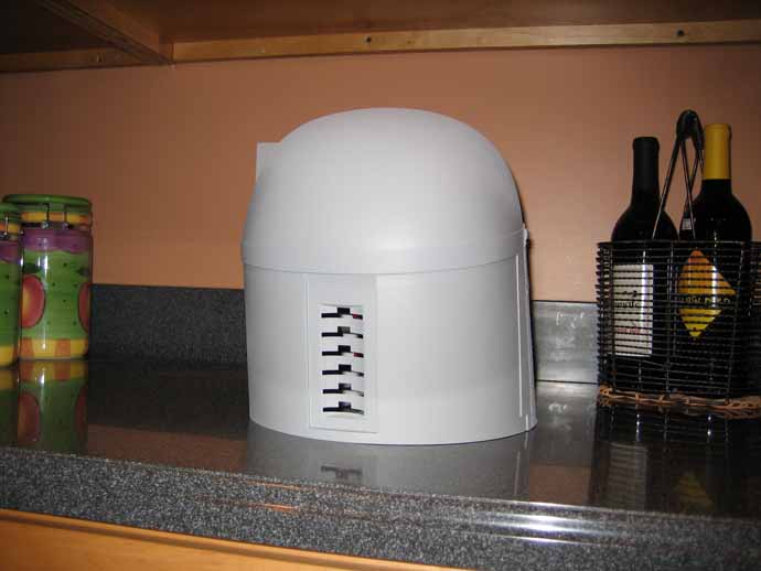

Here are some updated photos of my progress over the last couple of weeks. Concentrating on the keyslots and the entire back of the helmet. I used heat formed styrene for the keyslot insert by strapping the plastic to a 1 1/2" piece of plumbing pipe and using the boiling water technique to keep its shape. Attached template to the styrene and then cut out the keyslots. The rest of the insert is strip styrene and sheet. The last photos show the back with the first coat of primer applied. Ready for sand, prime, sand, prime... you know the drill. A question for anyone out there. The MQ1 casting I have has the lower section of circuit board but I do not see this section shown in any of the reference photos. Should I cut this lower section off and fill in around the casting with sheet to better match the MQ1 such as bobamaker's? Any help with this area would be appreciated.

Just use the top portion of the MQ1. I cover the lower three keyslots with a smooth piece of plastic that I cut from a plastic drink cup from Krystals. It's already curved so it doesn't need to be heated or shaped. Just paint it the appropriate color and glue it in place.
They actually used the whole board, but since the lower half has so few features you really can't tell except in extreme close up pictures.

Its been a couple of weeks and here is my latest progress. I have been working on the ear pieces. I knew things would slow down considerably when I reached these detail parts. Constantly checking and rechecking the reference photos has proved invaluable as well as TDH members help and advice. The photos show the construction of the left earpiece out of styrene which I heat formed to obtain the shape. Later I will post a template for the U-shaped piece in order to form the part correctly.
Thanks Alan for the positioning info on the ear pieces!:) The last photos show the mounting of the left earpiece and initial coat of primer. Plenty to fill and sand yet. Finally, their is the lower section of the right earpiece which I completed today and applied the first coat of primer.
