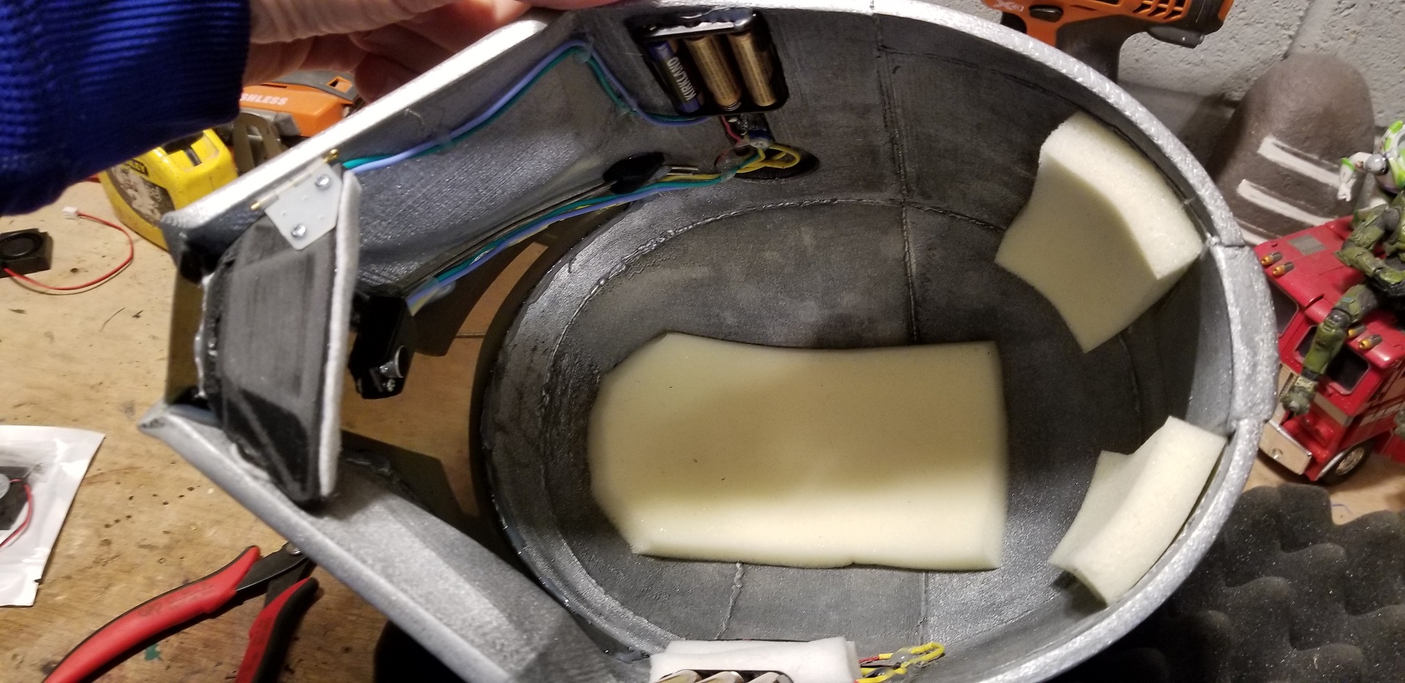

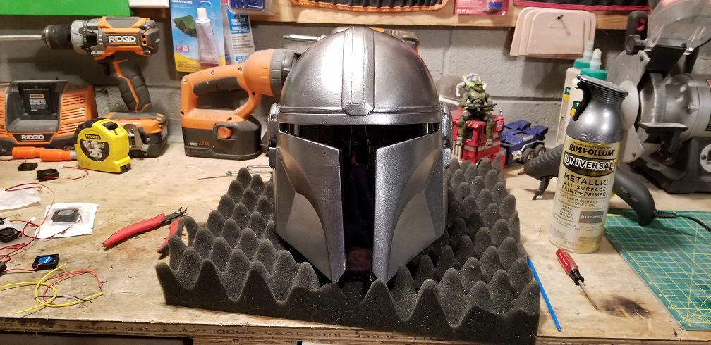

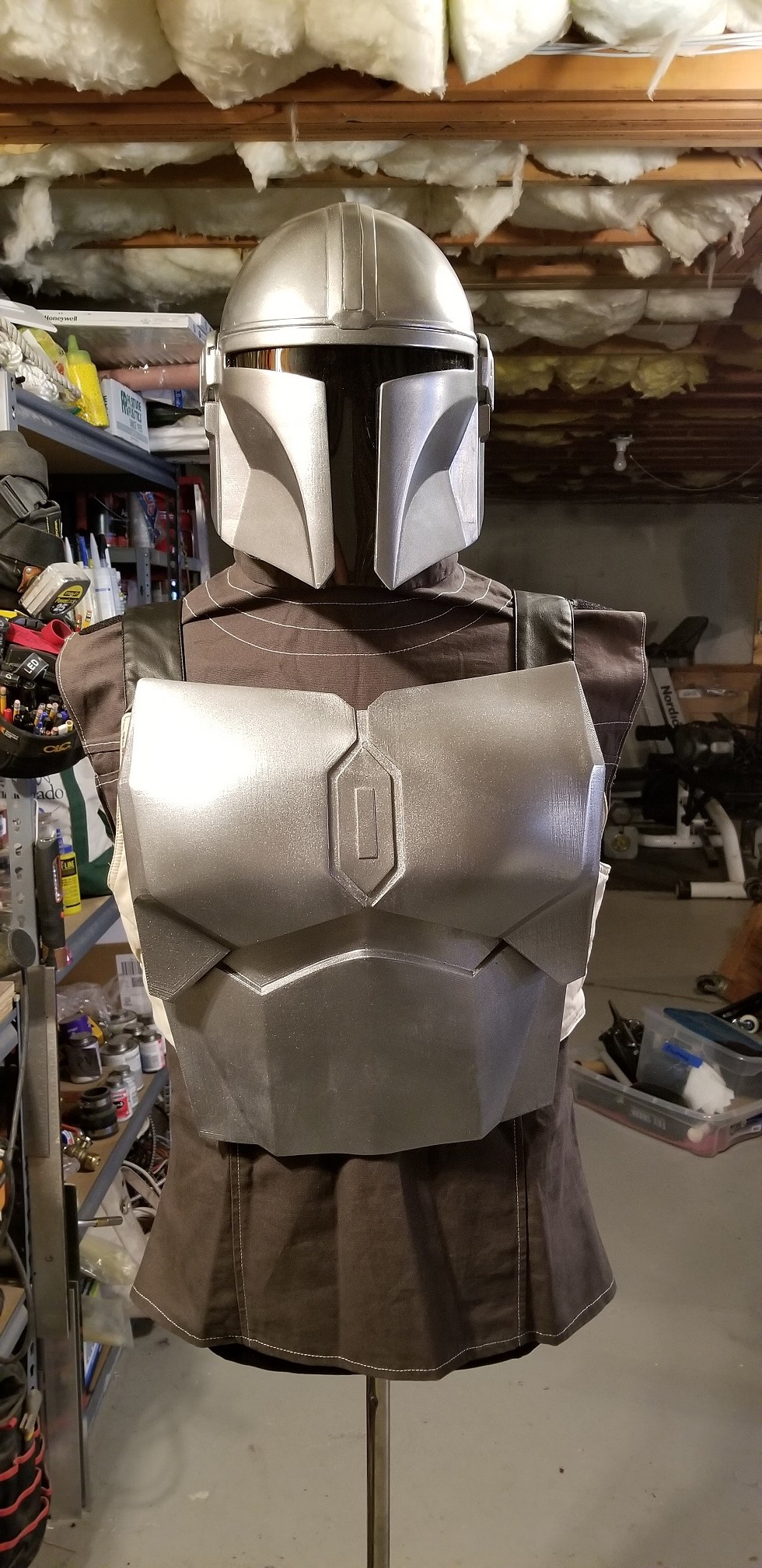

So let's start off with the helmet. Using Rop Pauza's design from my minifactory and poking all types of holes through it, I printed it out and worked into the system a fan and speaker phone.
Helmet - Raw

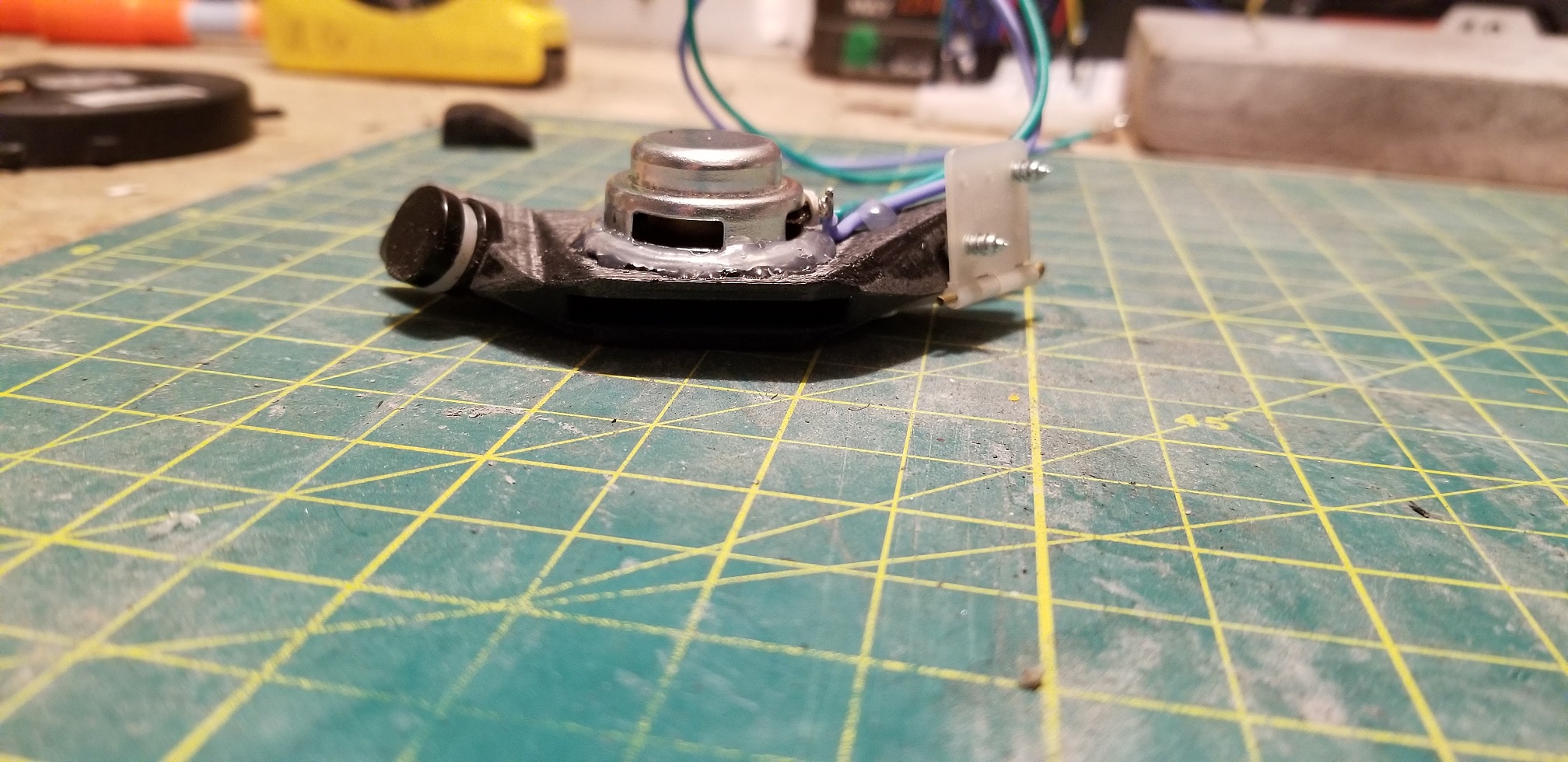

Speaker contraption I set up for the chin area.
Wiring the mic.
Wiring the rest of the speaker system.
On/off latching button built into the side of helmet.
Inside of helmet
Outside - Finished.
Speaker Test.

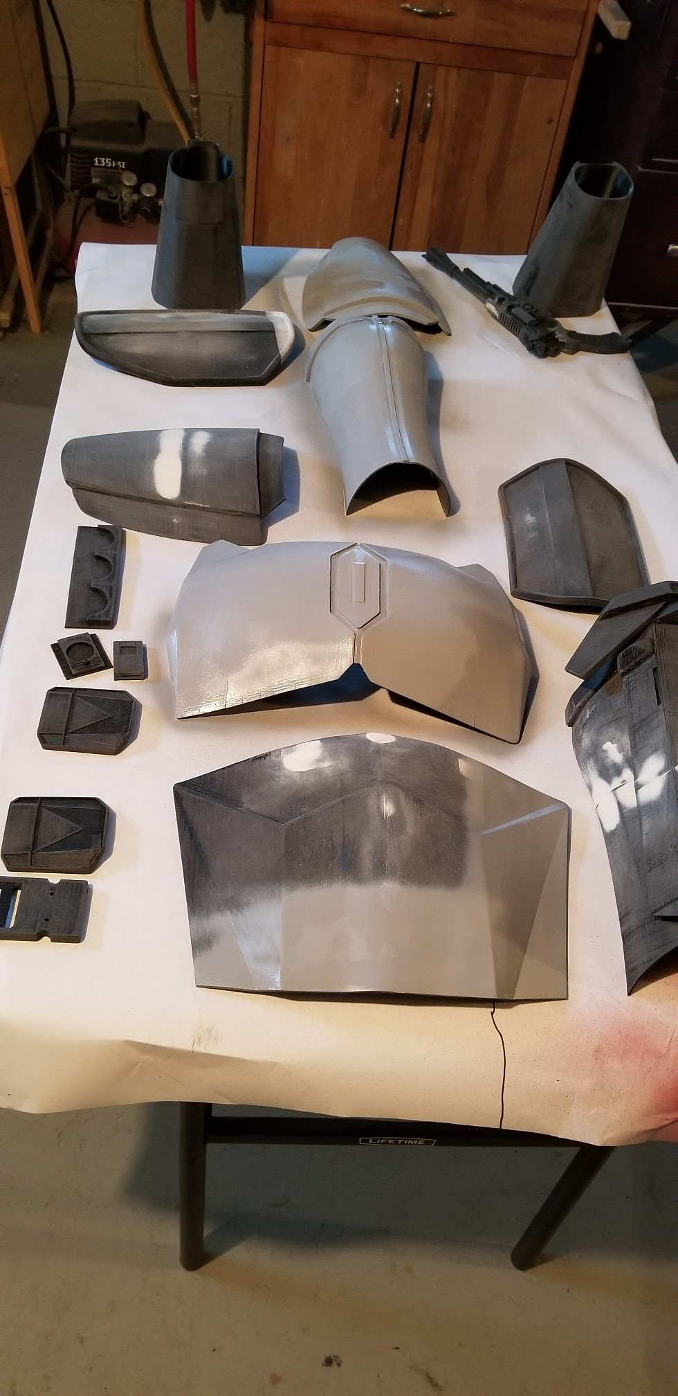

Armor:
Nothing new here, just print and go.
Redesigned gauntlets so that they can be locked using pins on the inside.
Raw Print
Lock works!

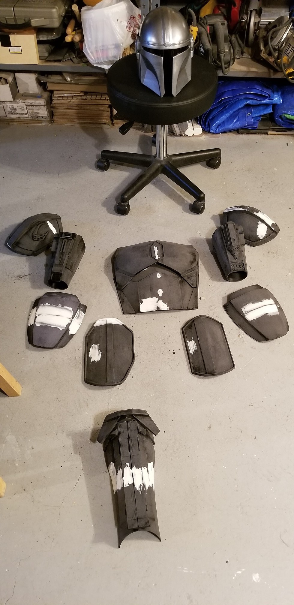

Prepping the pieces for sanding. Need to get rid of the lines.

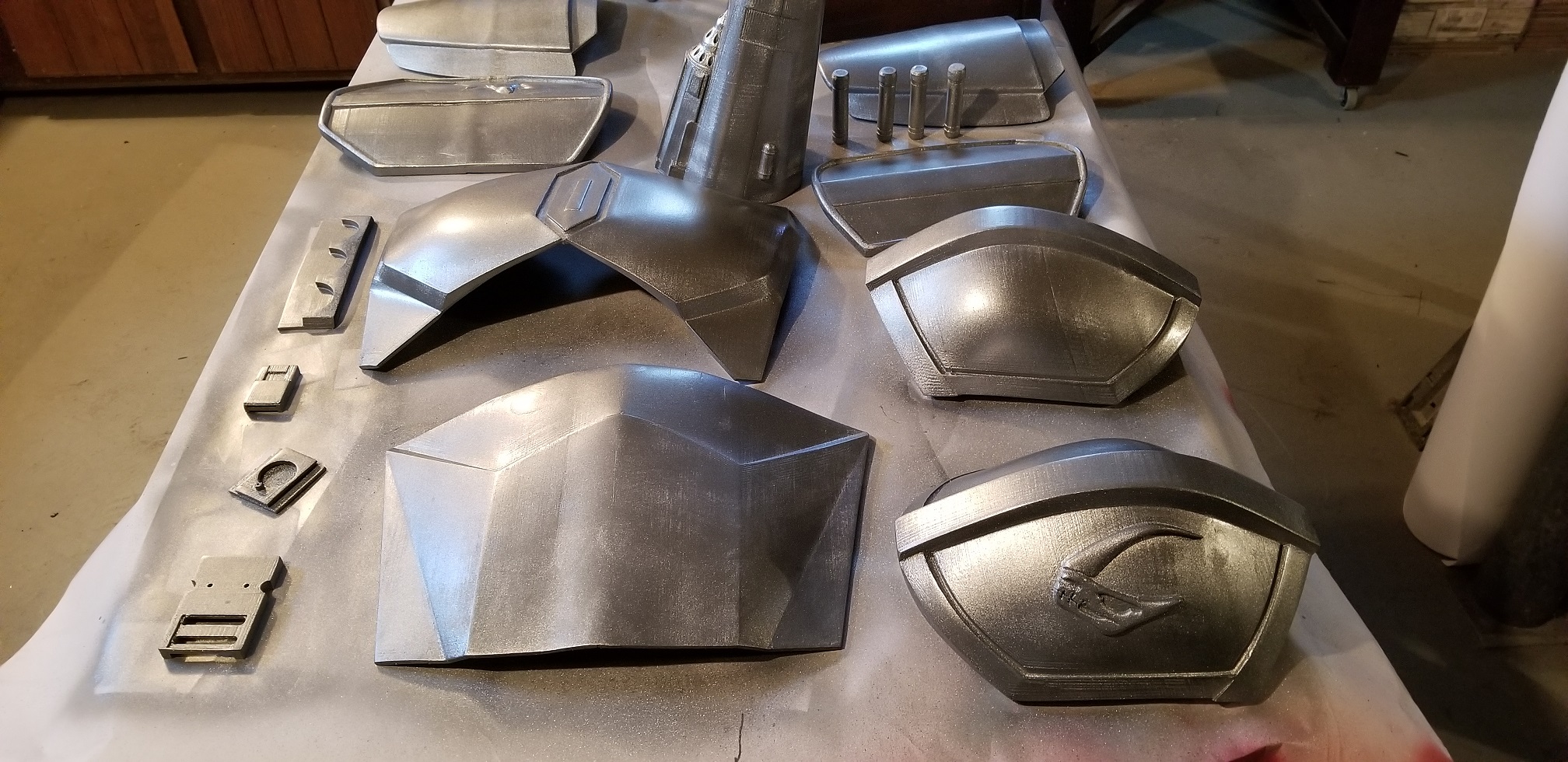

Prime Time!
Shoulders I designed.
Steel coat.

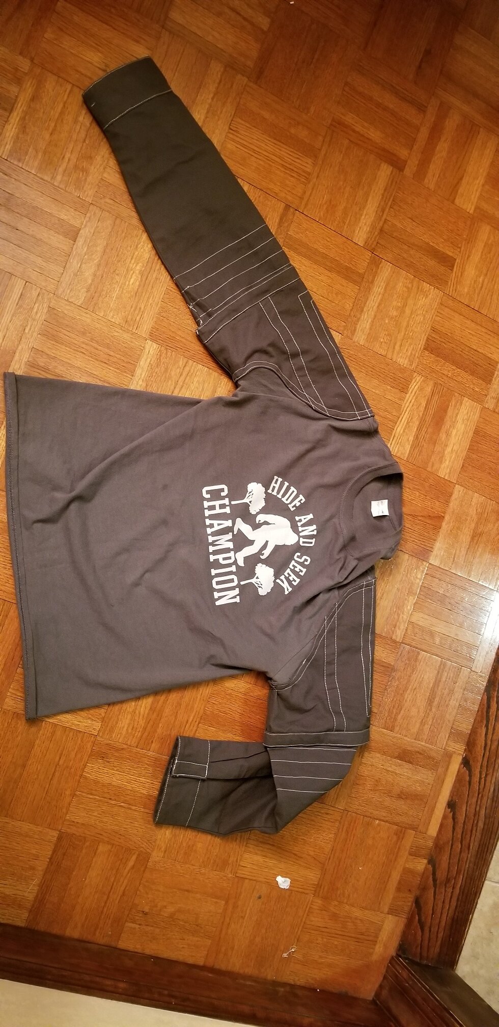

Sewing: I purchased off of ebay this outfit:
The spare parts and padding are next to useless but the sewing is close enough when it comes to material used. I did a lot of adjusting to get this to look and fit well.
For the shirt? I cut off the arms and sewn them to a t-shirt I like.
Original shirt above.
My t-shirt I attached them to.

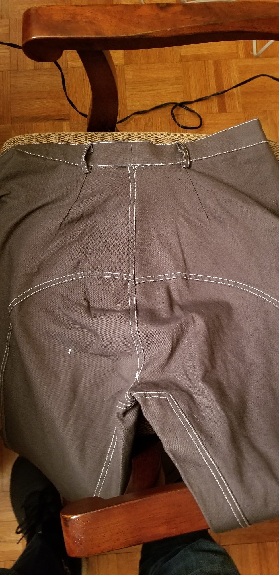

Pants were too big. I took them in the hard way...kind of like how you do jeans.
It's not perfect, but it will do.
Nice and snug. maybe a little too snug. Well I'll try to keep my weight down.
and now to assemble the rest of the armor:
I used velcro under the straps and t-nuts and screws to attach the armor to the suit. The undersuit, I had to remove the half zipper in the back and put a full one in. Luckily I had one left over.
Used t-nuts and screws to attach the shoulder armor.
A little bit of weathering and gloss overcoat and I'd say I'm ready for holloween...just not sure which year.

Does the speaker system require saudering? It sounds great!
Rob Pauza is the maker of the 3D printed designs right? Or did I misunderstand?
The speaker system (and fan) do need soldering. If you already have the Soldering tools, it'll be about $15 per speaker system. I did a full workup here: Simple Helmet Speaker System
