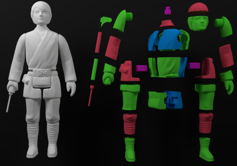

Hey all, I'm working with the incredibly talented laellee on a new project and wanted to post here in the event anyone is interested. Project 1278 is my vision of bringing all 12 of the first Star Wars figures released in 1978 to a life-sized, 3D printable format. The first figure in this series is complete; Luke Skywalker. Luke stands approximately 5'-10" tall, has a rotating head, adjustable arms, and a retractable lightsaber; just like the vintage 3.75" scale figure.

The majority of these pieces are cut to fit a printer with a build volume of 256*256*256 mm³. The info sheet that comes with the download has more information.

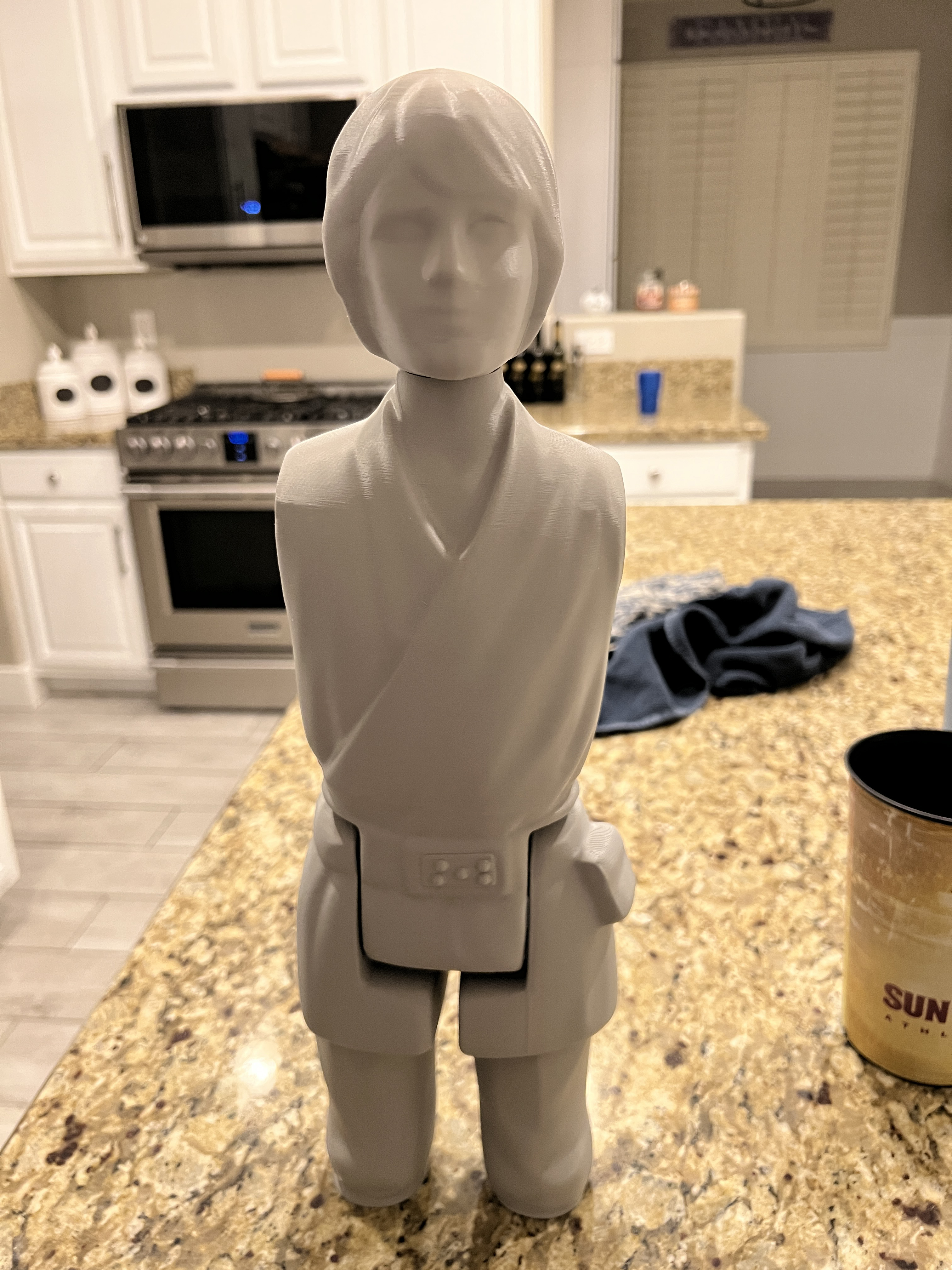

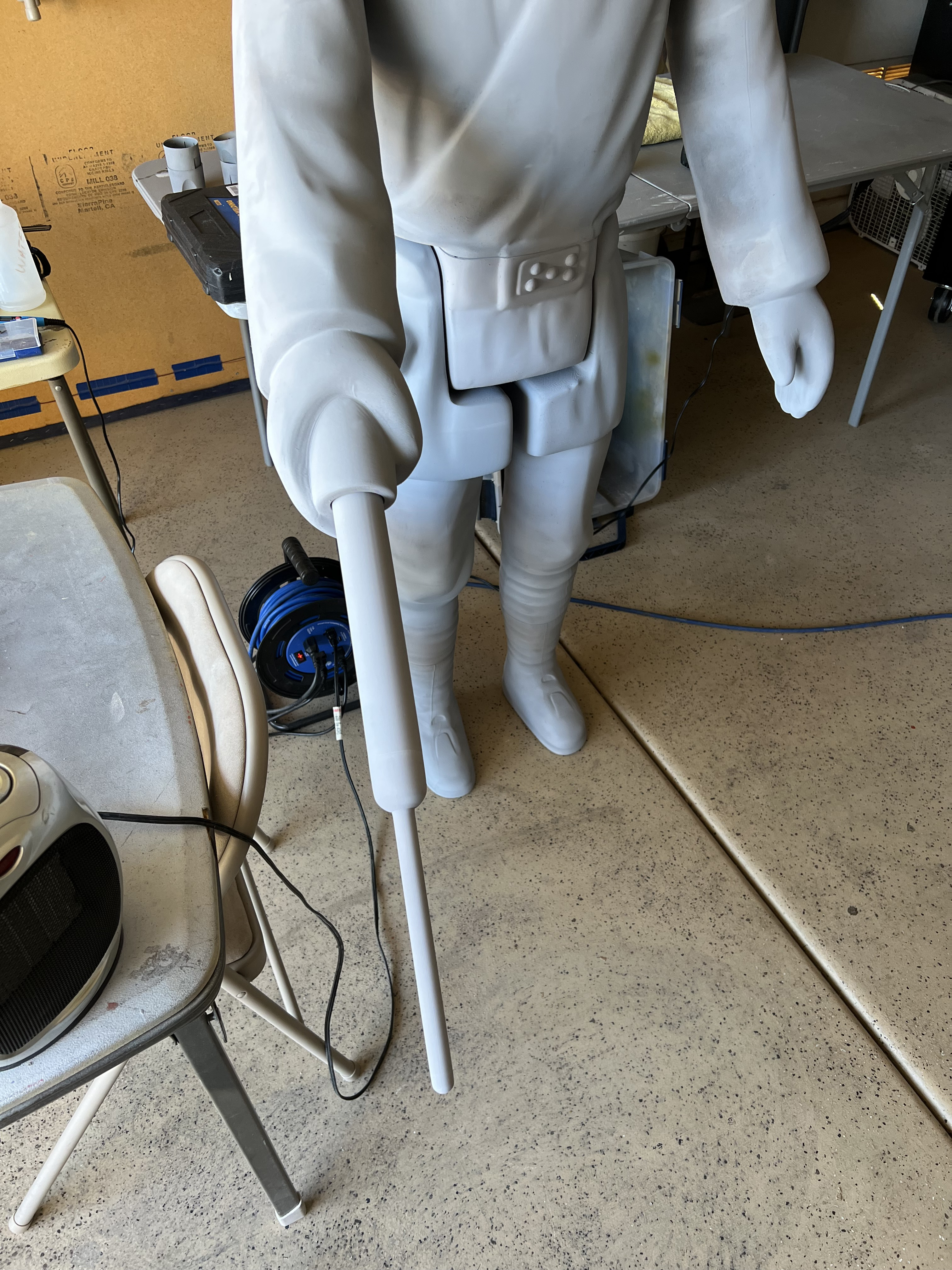

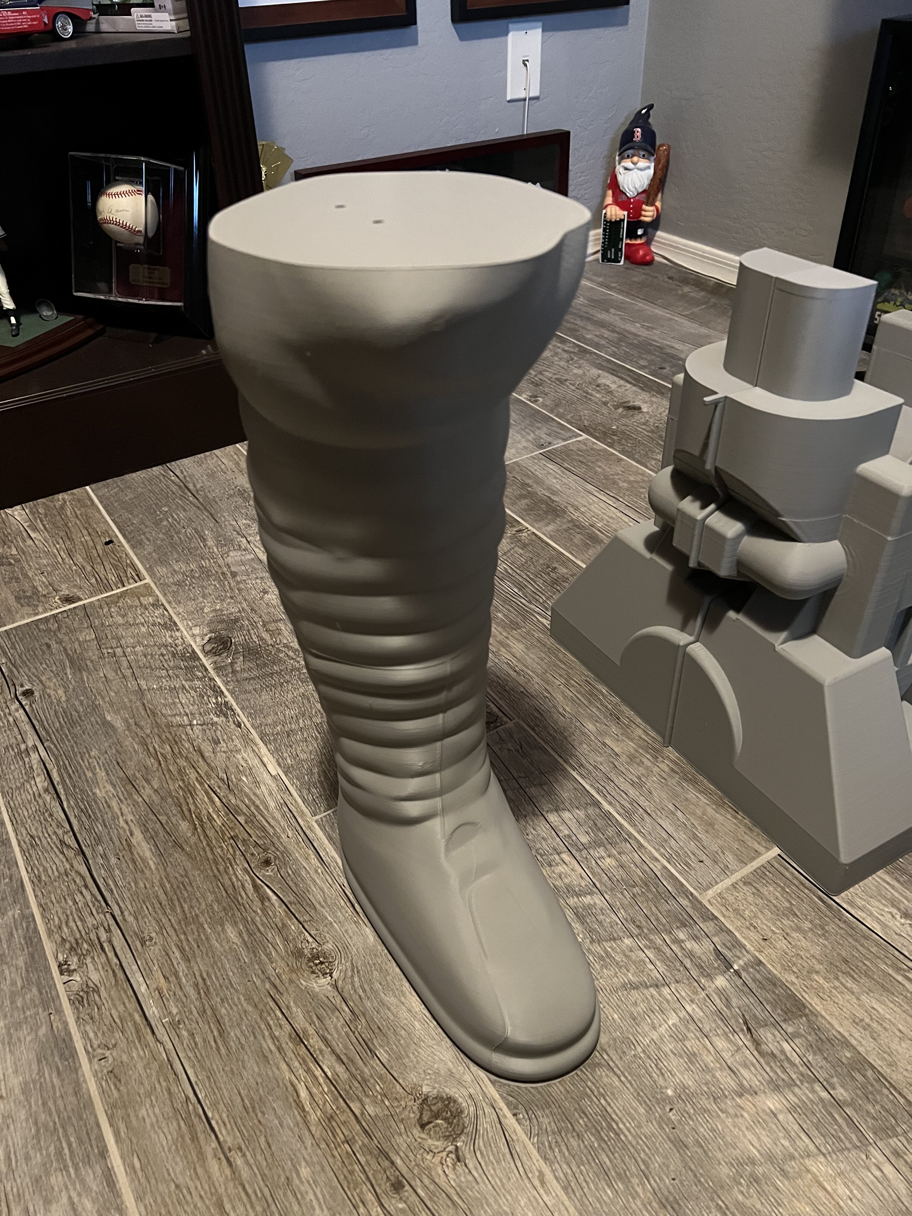

Jumping around on projects at the moment, but making progress on Luke. Just need to finish printing his back torso and arms. Here's the legs, pelvis, lightsaber, and front torso pieces. Not going to glue anything together until everything is printed and test fitted. The lightsaber has a removable, magnetically attached handle to make it easier to slide into his hand. It also has a magnet cavity on the rear end, and one that matches inside the arm, to keep the saber in place when retracted.
The prints look great, but I do have some areas to clean up as I'm still playing with orientation to save on time and filament. Once this is assembled I'll bondo the seams and get to sanding / painting. I'm pleased with how this is looking, real fun to see a childhood toy come to life at this size.

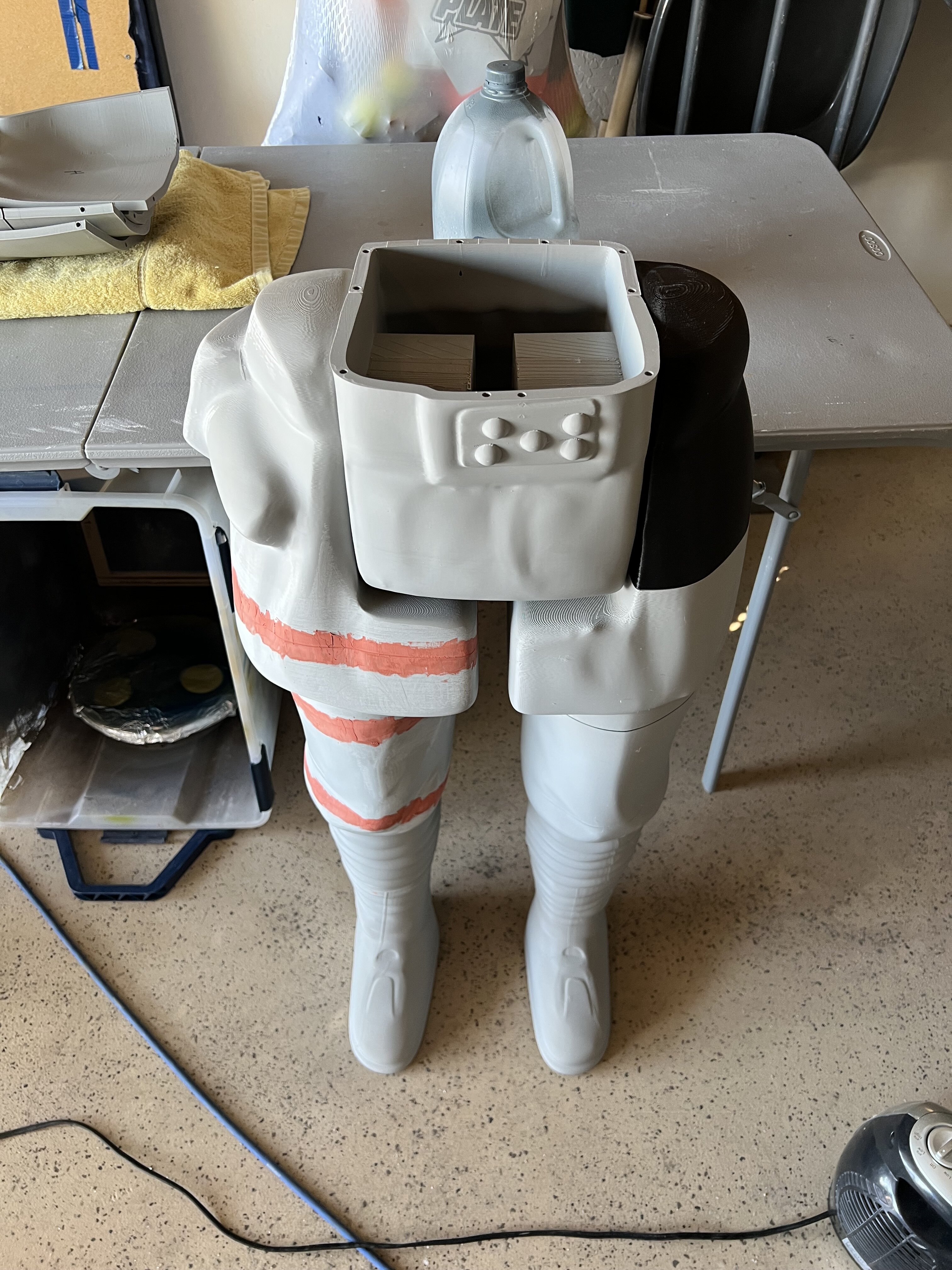

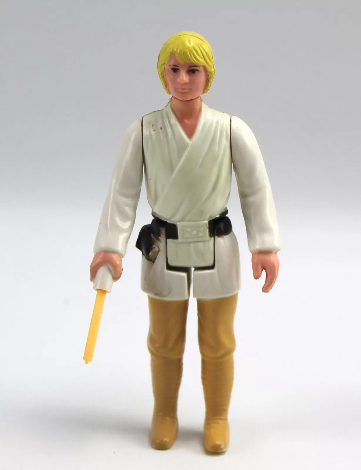

Jumping right back to this project now that all pieces are printed. I started assembling the leg pieces and pelvis section. This probably looks odd being so raw but I have a bit more bondoing and sanding to complete, but I can already tell this is going to be a faithful homage to the original action figure (pictured for reference). I've always loved building life-sized figures, but building these life-sized Kenner "action figures" brings a whole new level of giddiness!

Making great progress on this figure, working on getting everything that needs to be permanently together glued and also doing some test fitting before I start applying more bondo and sanding. It's gonna take a little work to get some of these seams hidden, but that's just part of the process on a build this size!

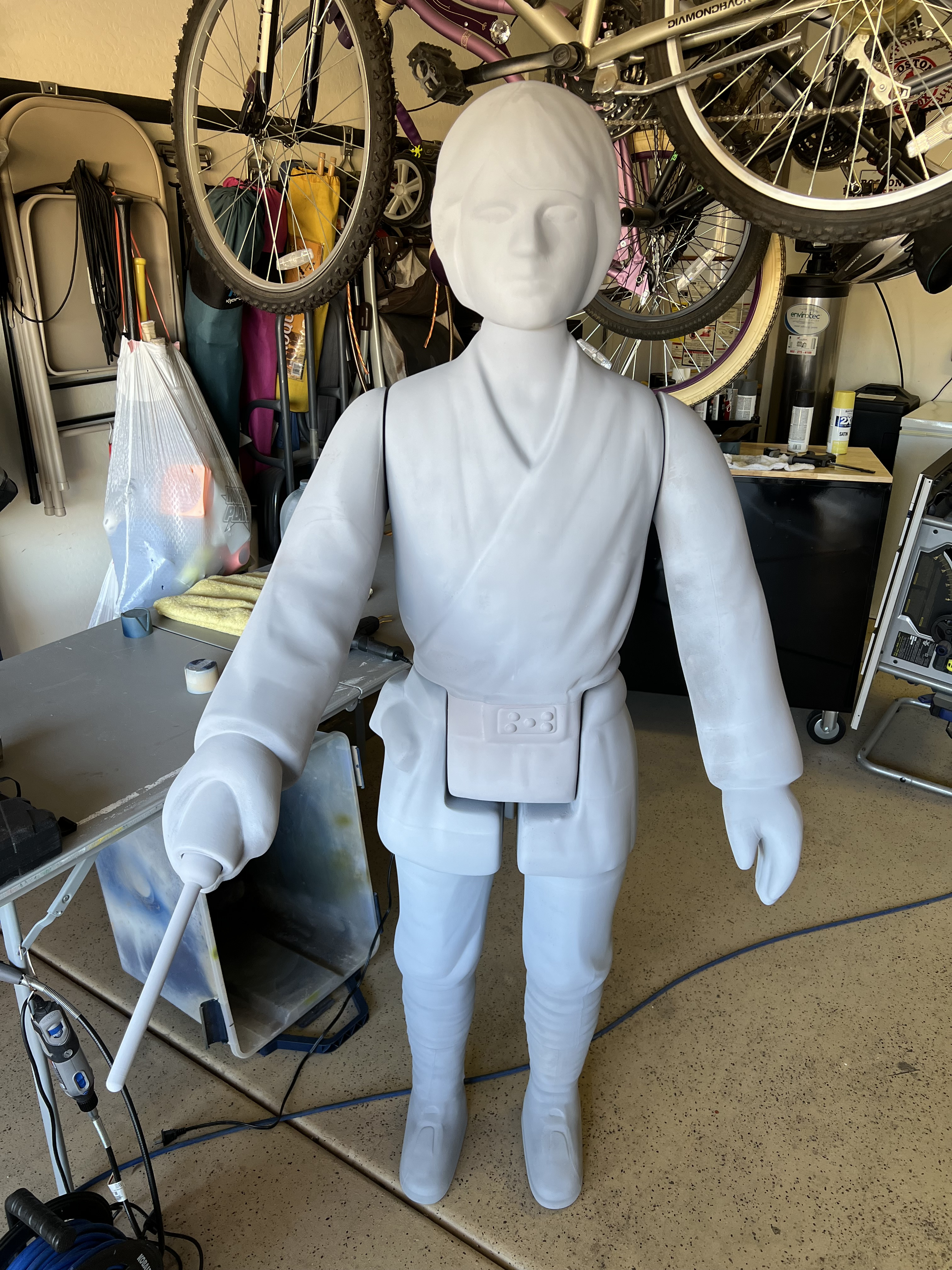

Finally got all the pieces printed, glued, bondo'd, sanded, and a final coat of filler primer. I just need one final sanding before I start paint.........lot of work to get to his point, but I love how it's coming along.............

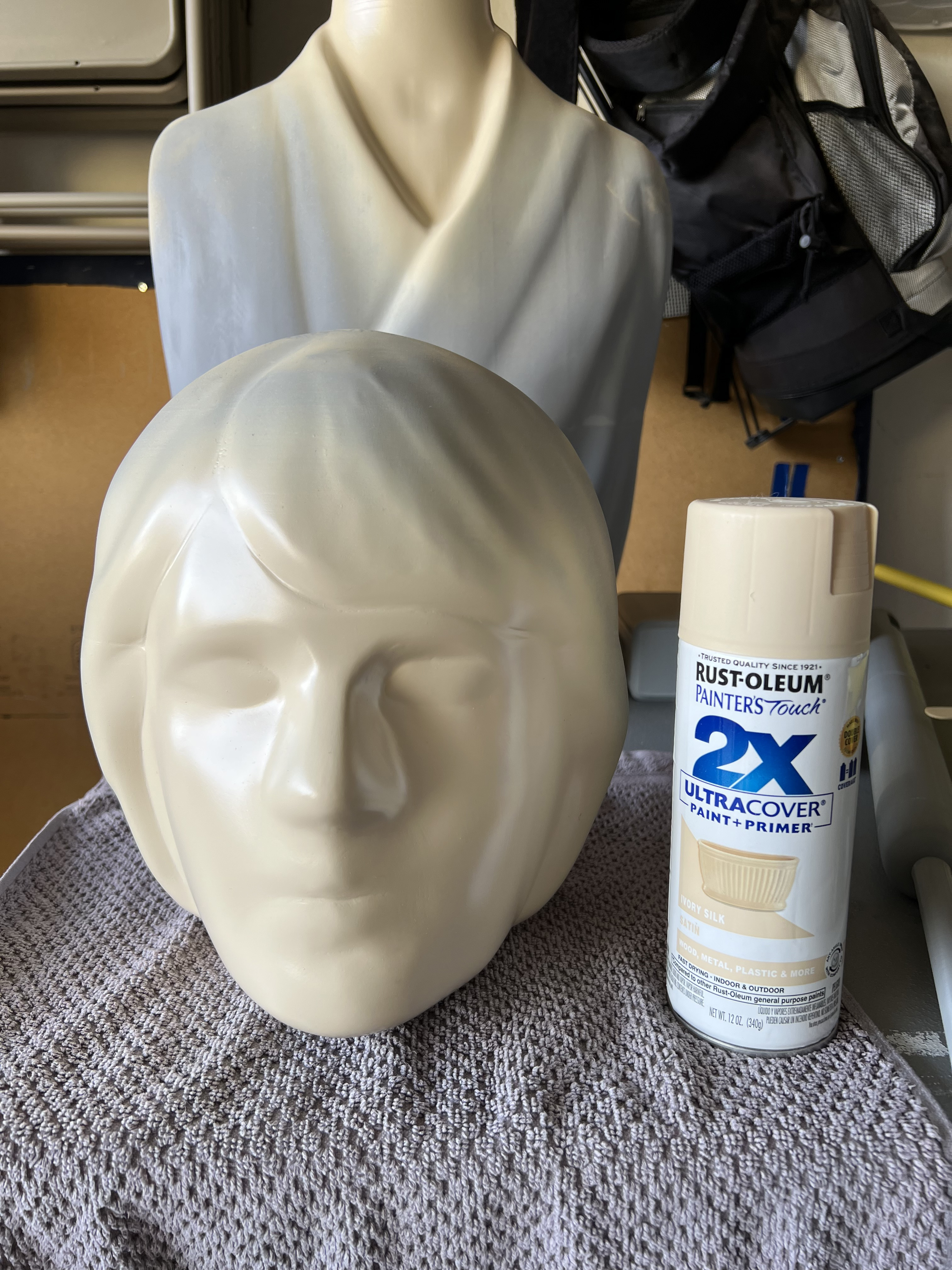

Jumping around on projects again but I got a little more done on Luke today. I was dreading trying to find a rattle can color that would look good as a skin color, but I found this Rustoleum "Ivory Silk" color that I think came out pretty nice. I'll be adding a list of colors when done and updating my build PDF, but just wanted to share this now. I'll give this another day to dry, then mask off and paint the hair yellow, then make templates for the eyes and eyebrows and get those painted.............

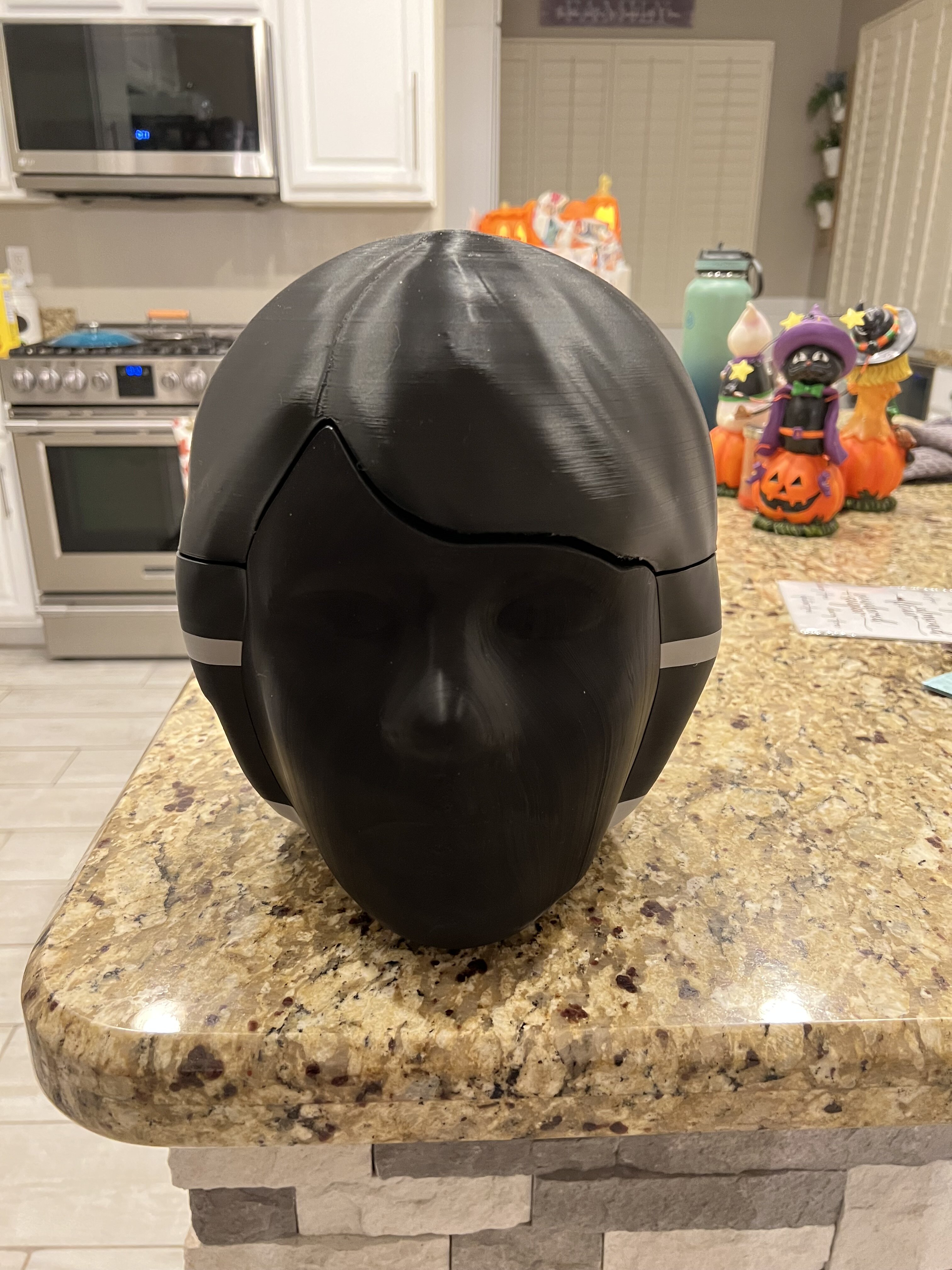

The weather has been a real PITA lately so I haven't had a chance to paint, but in the meantime, I'm working on another little project with these Luke Skywalker STL files. It's gonna be a 1/3 scale figure (about 23.5" tall), so thought I would share what that looks like so far..............

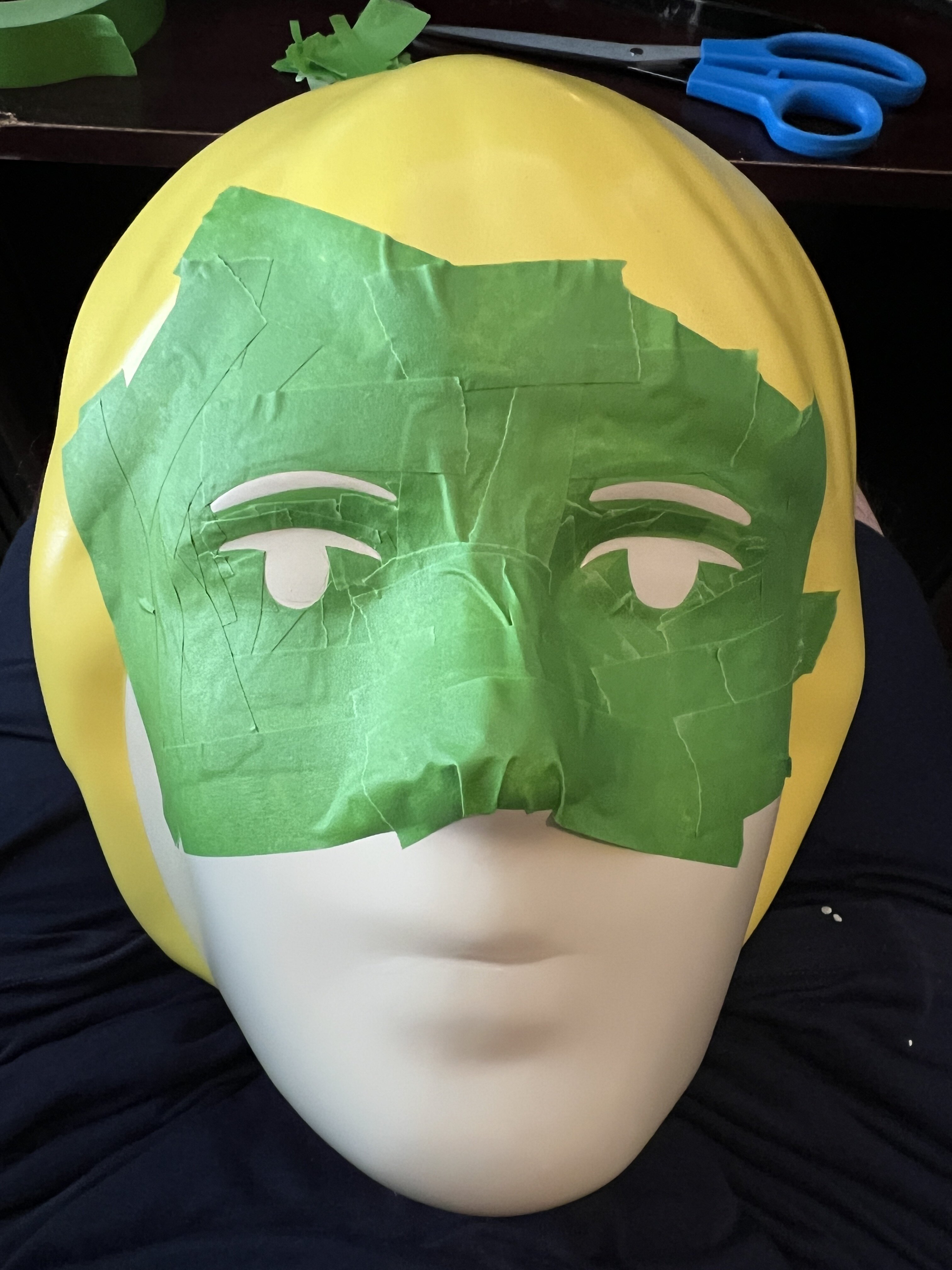

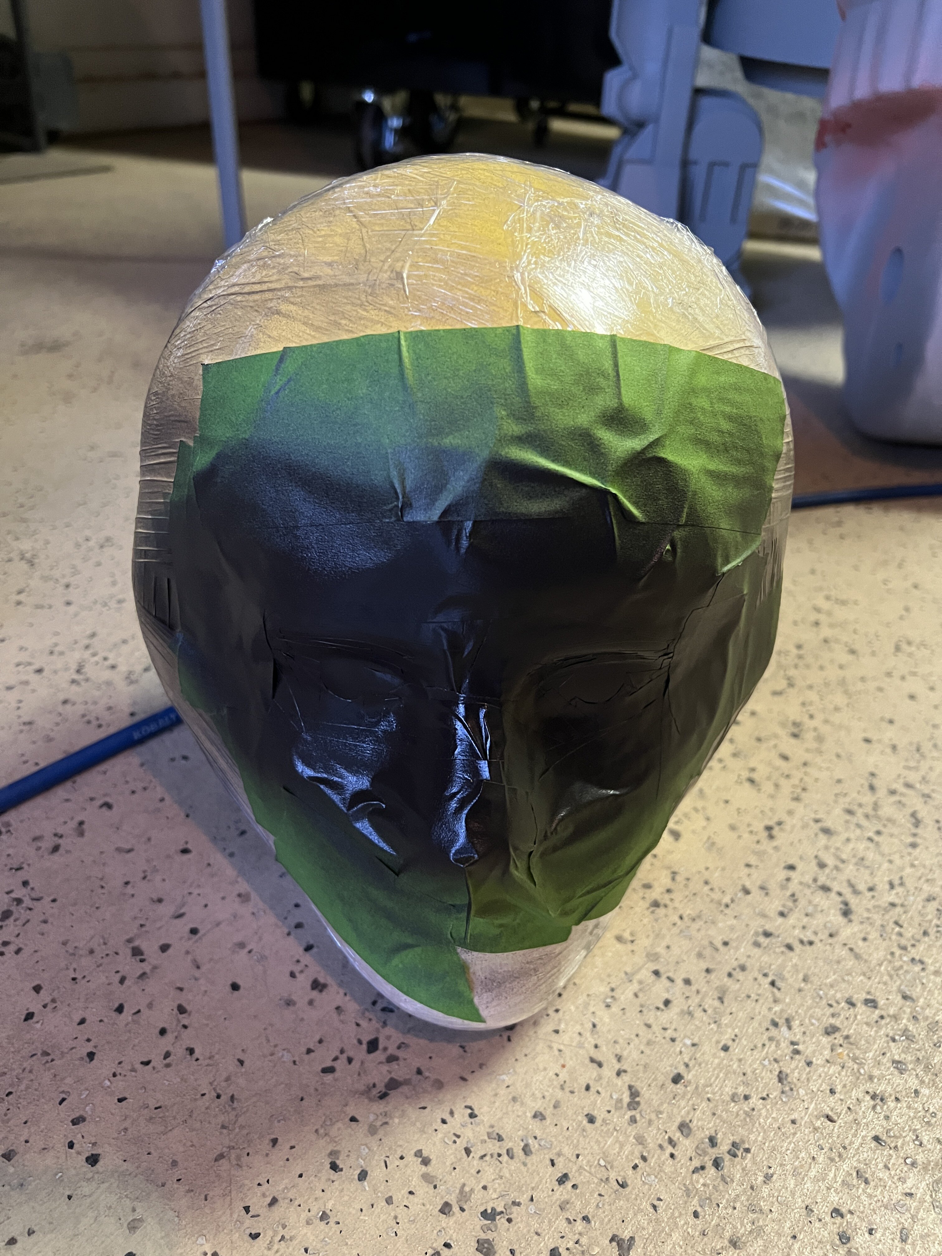

I hate how life can sometimes get in the way of life, if you know what I mean. It's been slow going on some of these projects, but managing to make progress. I taped off the eye areas for this Luke, cool thing is these are super simple features, so just took a little patience (although I kept thinking I was working on a Robin project!).
In looking at my vintage Luke figure, I initially thought the belt and eyes were black (and maybe some are depending on what factory they came out of) but it's actually a dark brown. So I used "Dark Walnut" for the belt and eyes. I'm also real pleased with the "Ivory Silk" I used for the skin. Not perfect, but it's a great rattle can color for this project (these aren't the best pictures because of the lighting, and he's not as shiny as the pictures would have you believe because I'm using Satin paints, but you get the point).

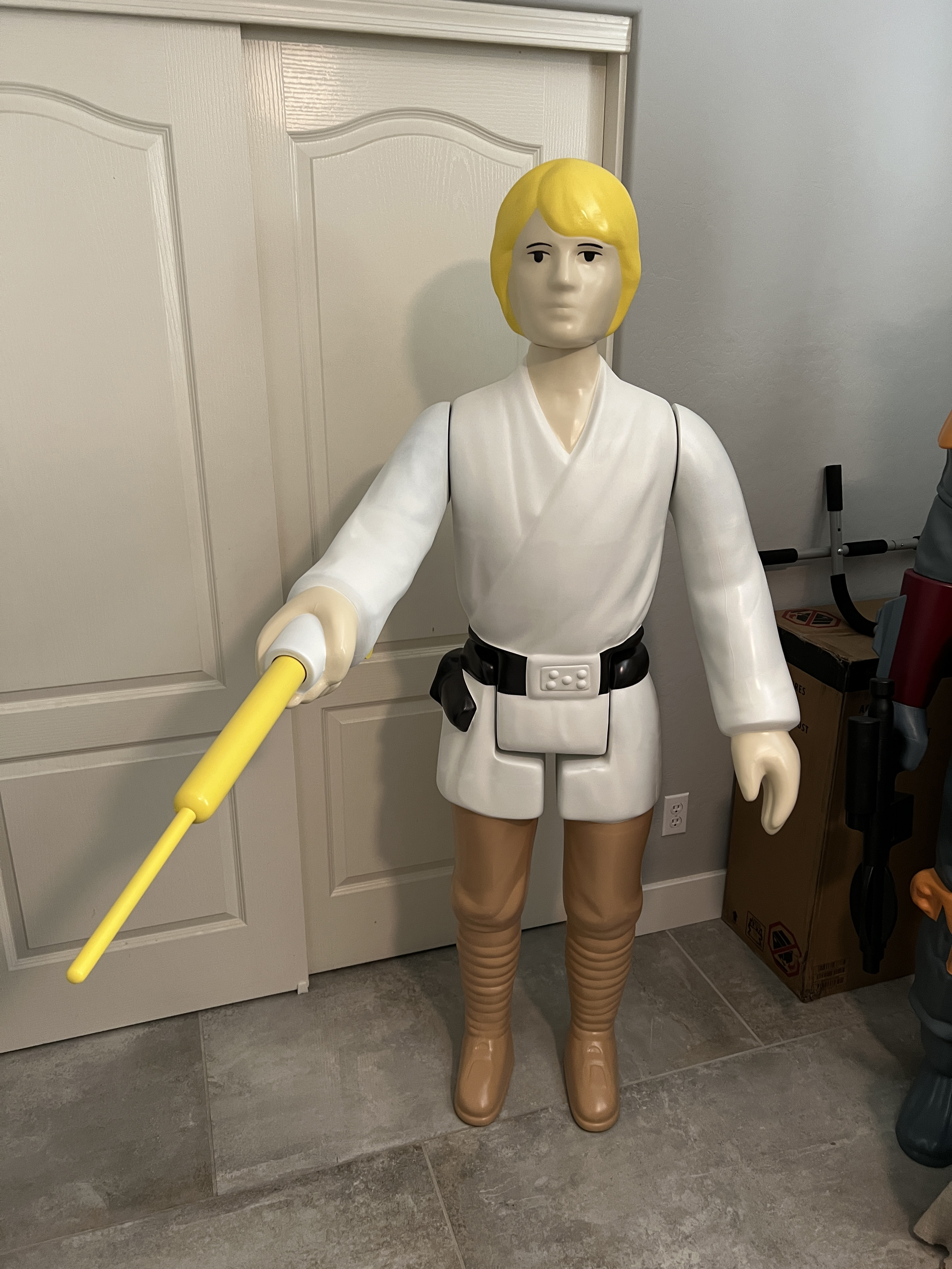

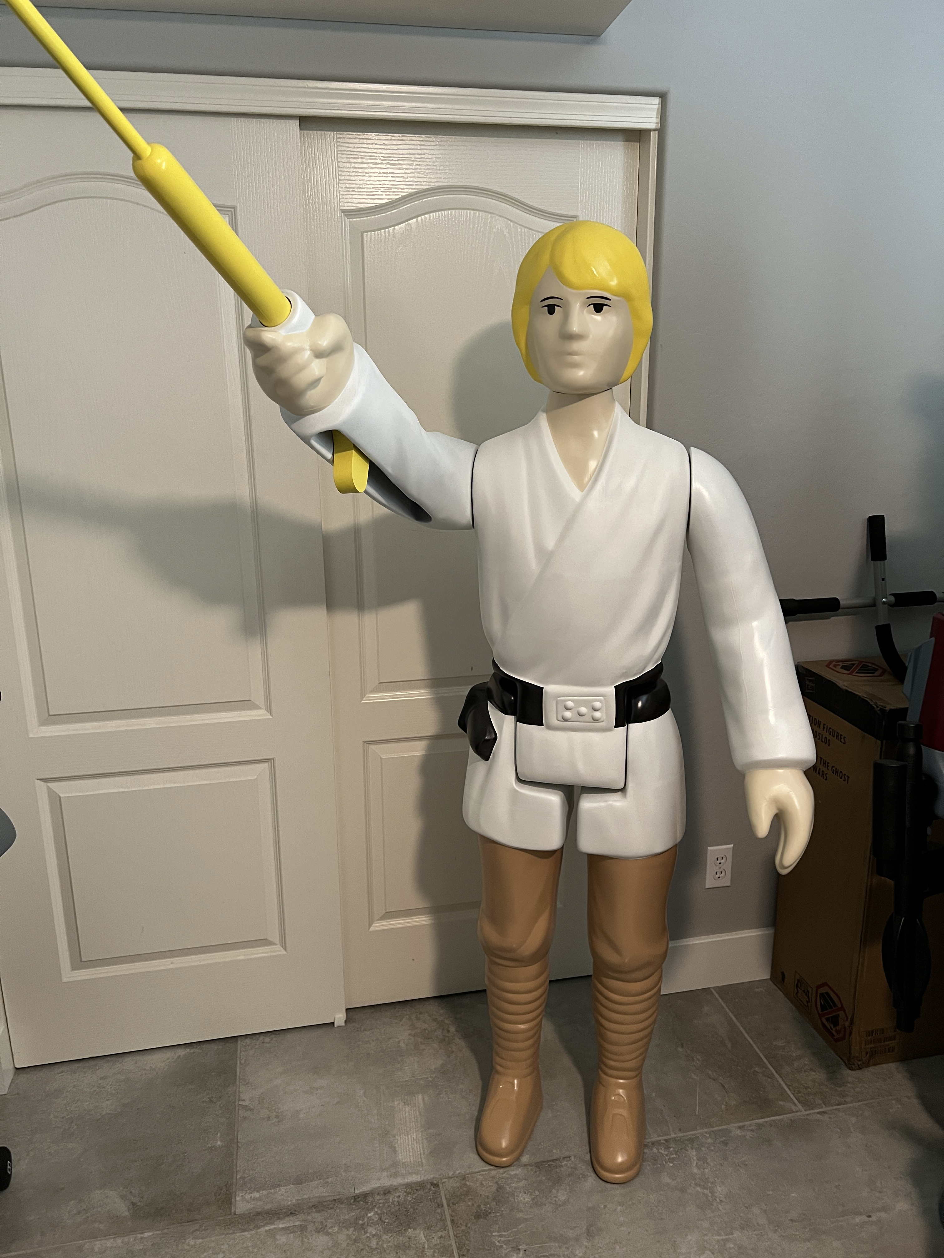

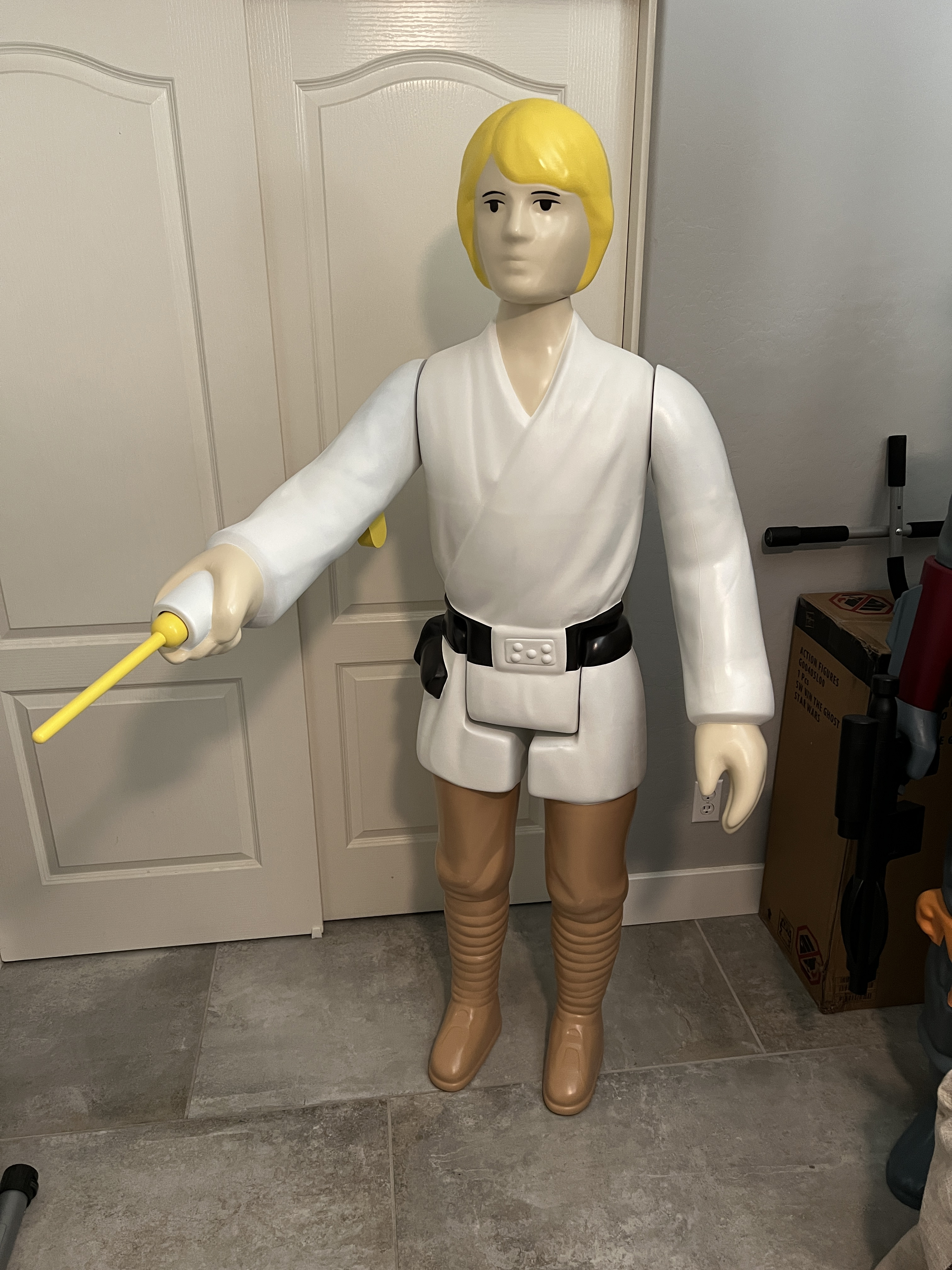

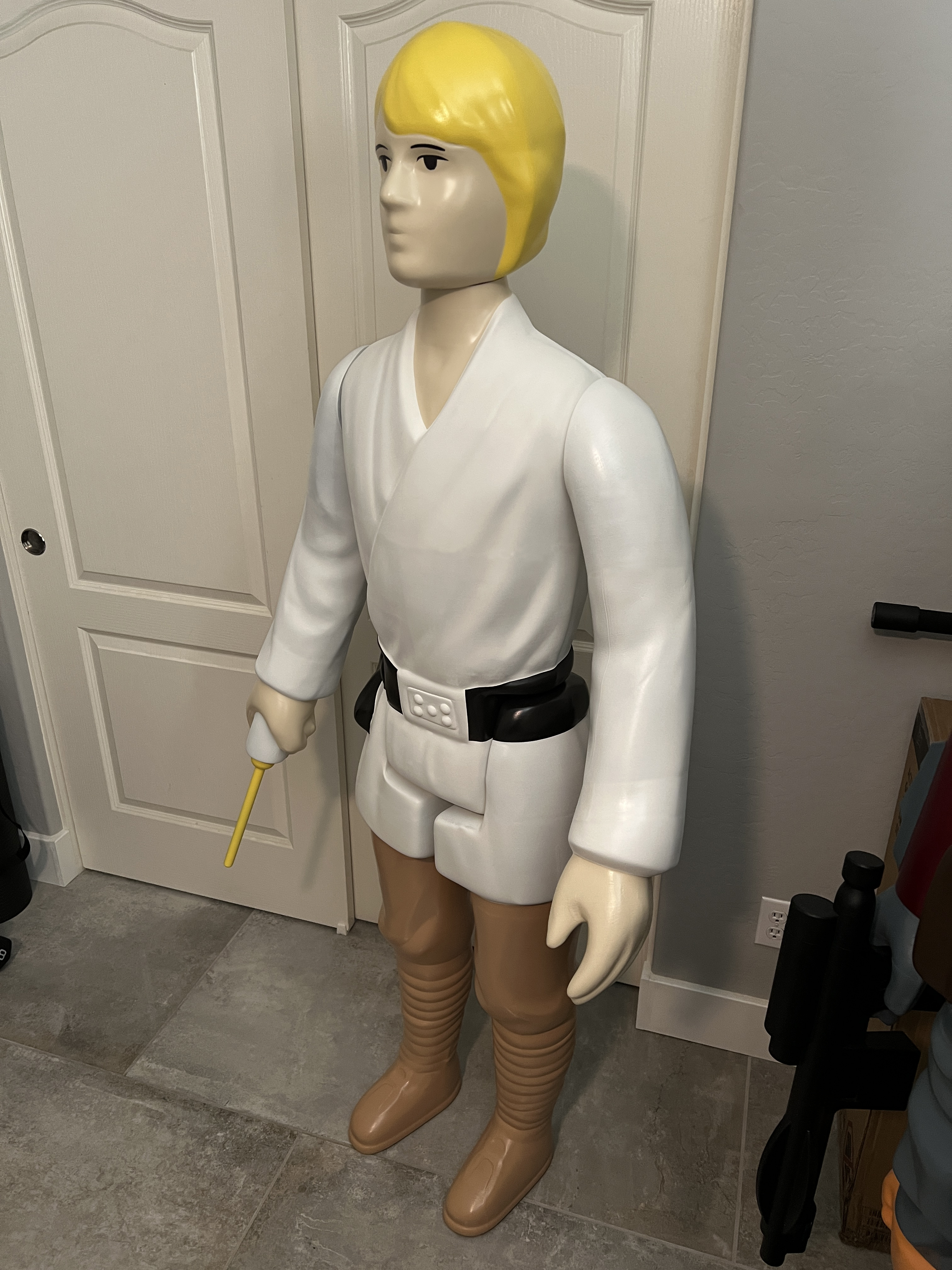

Been sidelined with a few issues lately but I managed to finish Luke. I'm real pleased with how he came out; he has poseable arms, rotating head, and a retractable lightsaber just like the original figure. Thanks laellee for a fantastic design!
