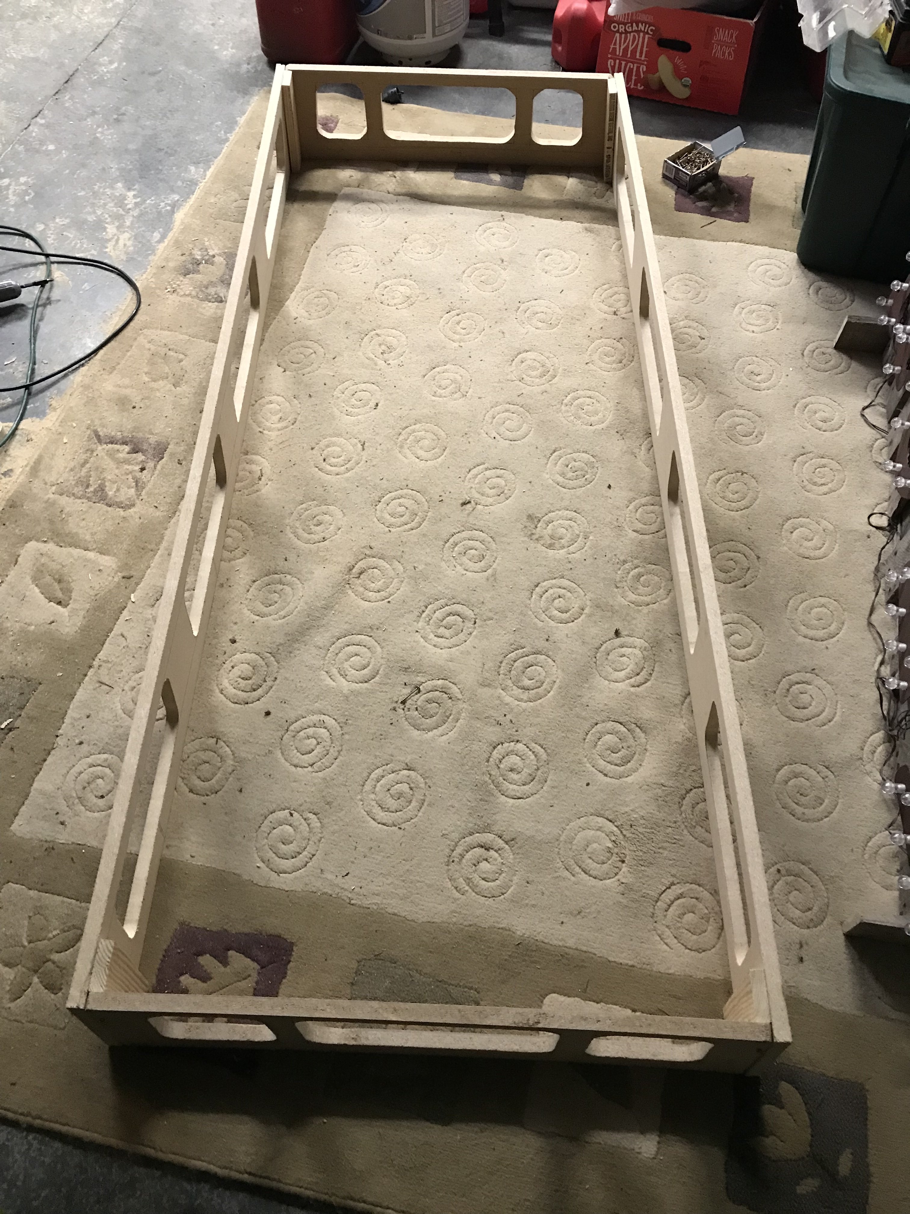

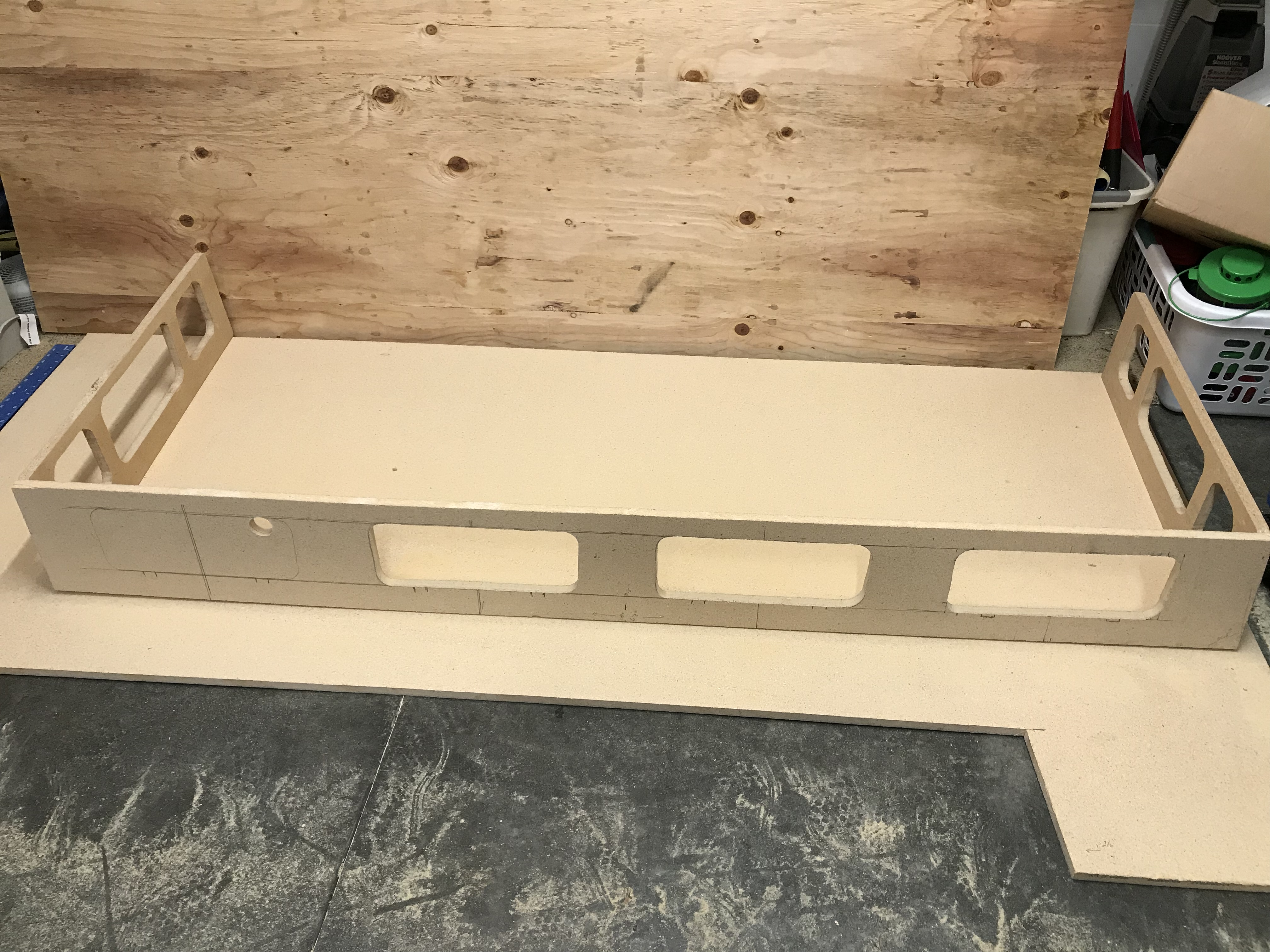

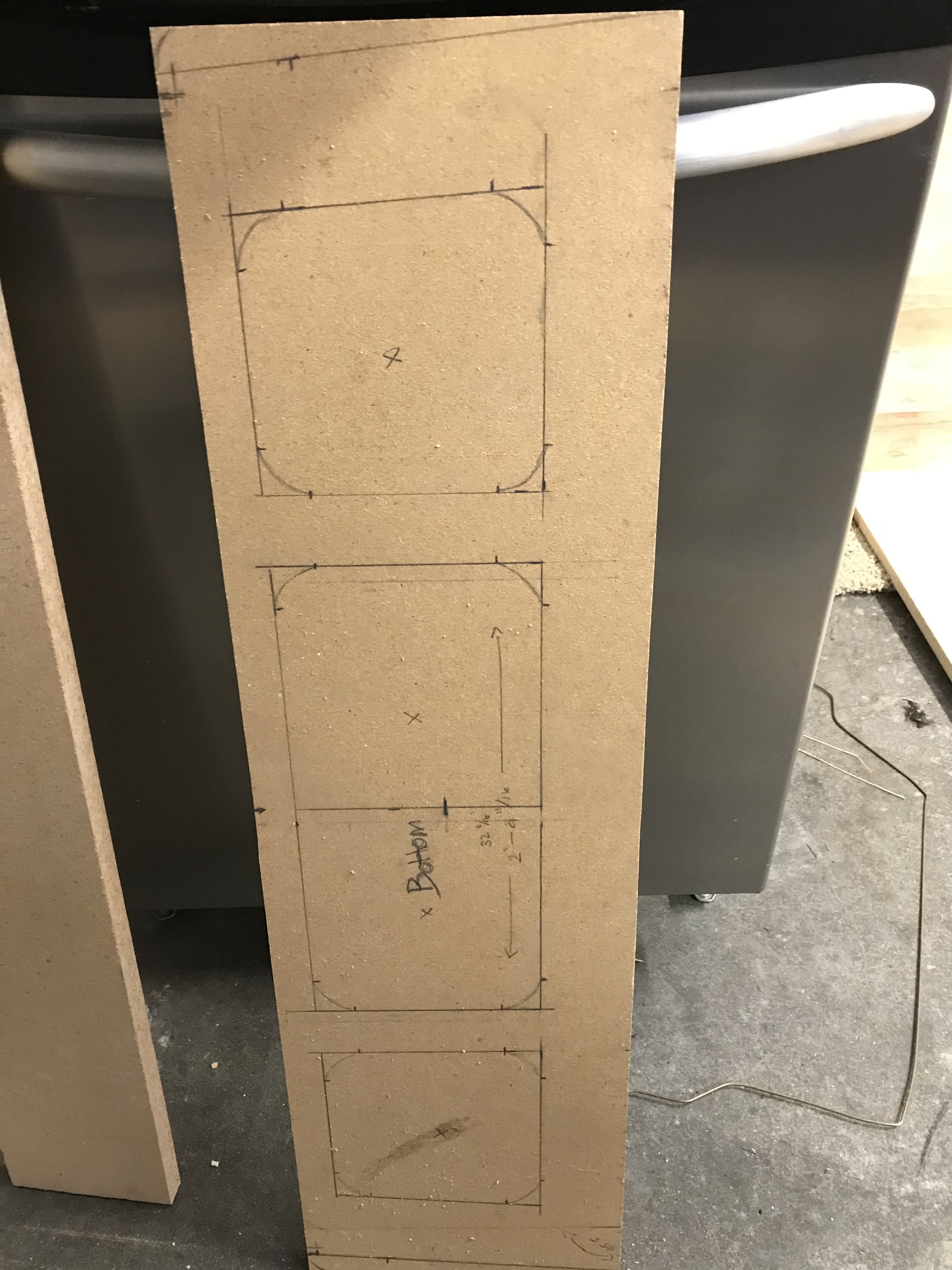

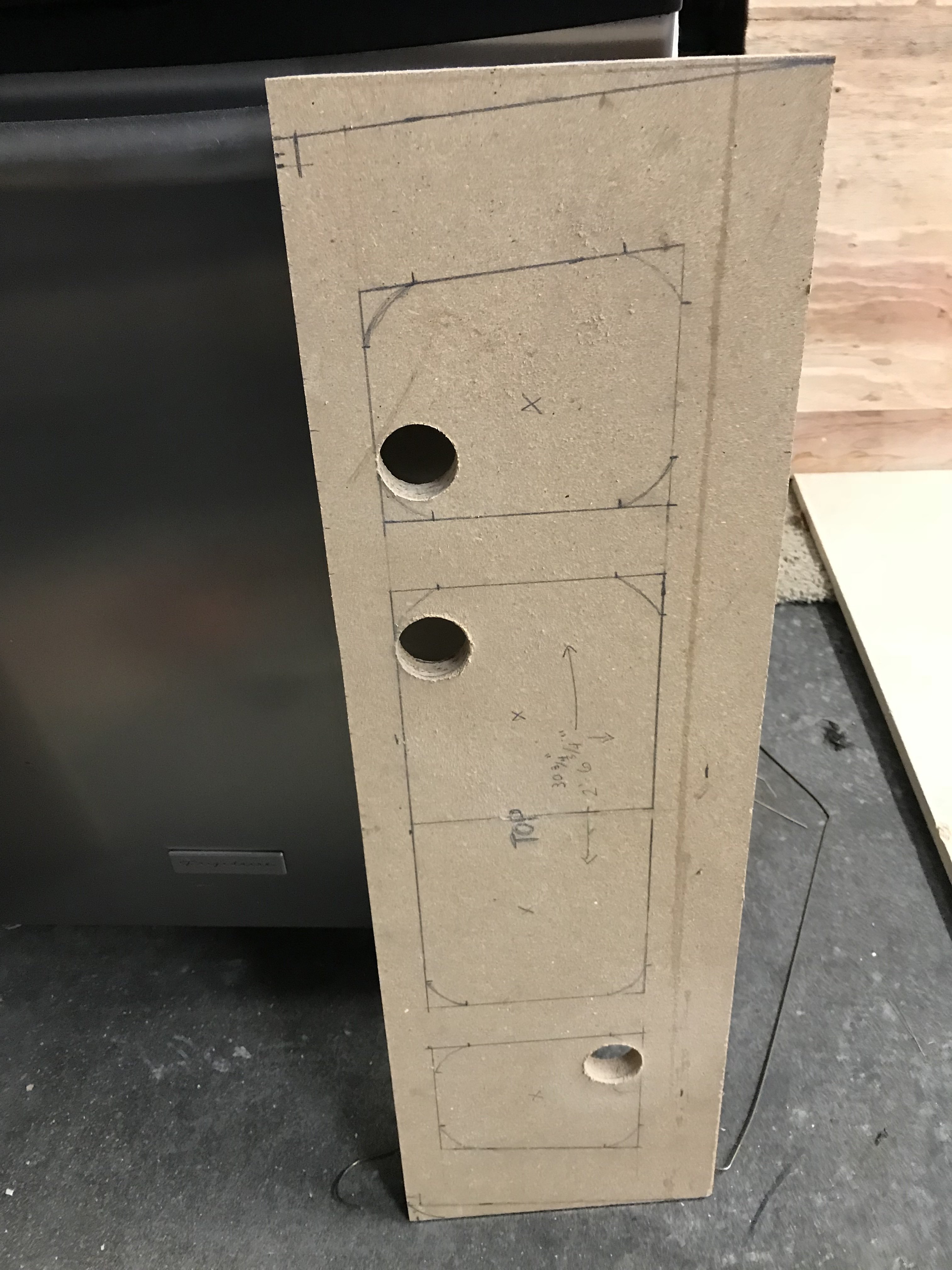

4E66B918-83F2-4916-858D-EB707E44BFBD.jpeg C9227F1C-FBF6-4E5A-B704-C8E3F36AA1FA.jpeg D53C0036-BBCC-4D36-B305-115C4FCA9807.jpeg 28B9AC14-11EE-4740-A940-CCB033ABD285.jpeg 2FB3E62A-C6A4-4364-8CBD-DA3C3821274B.jpeg

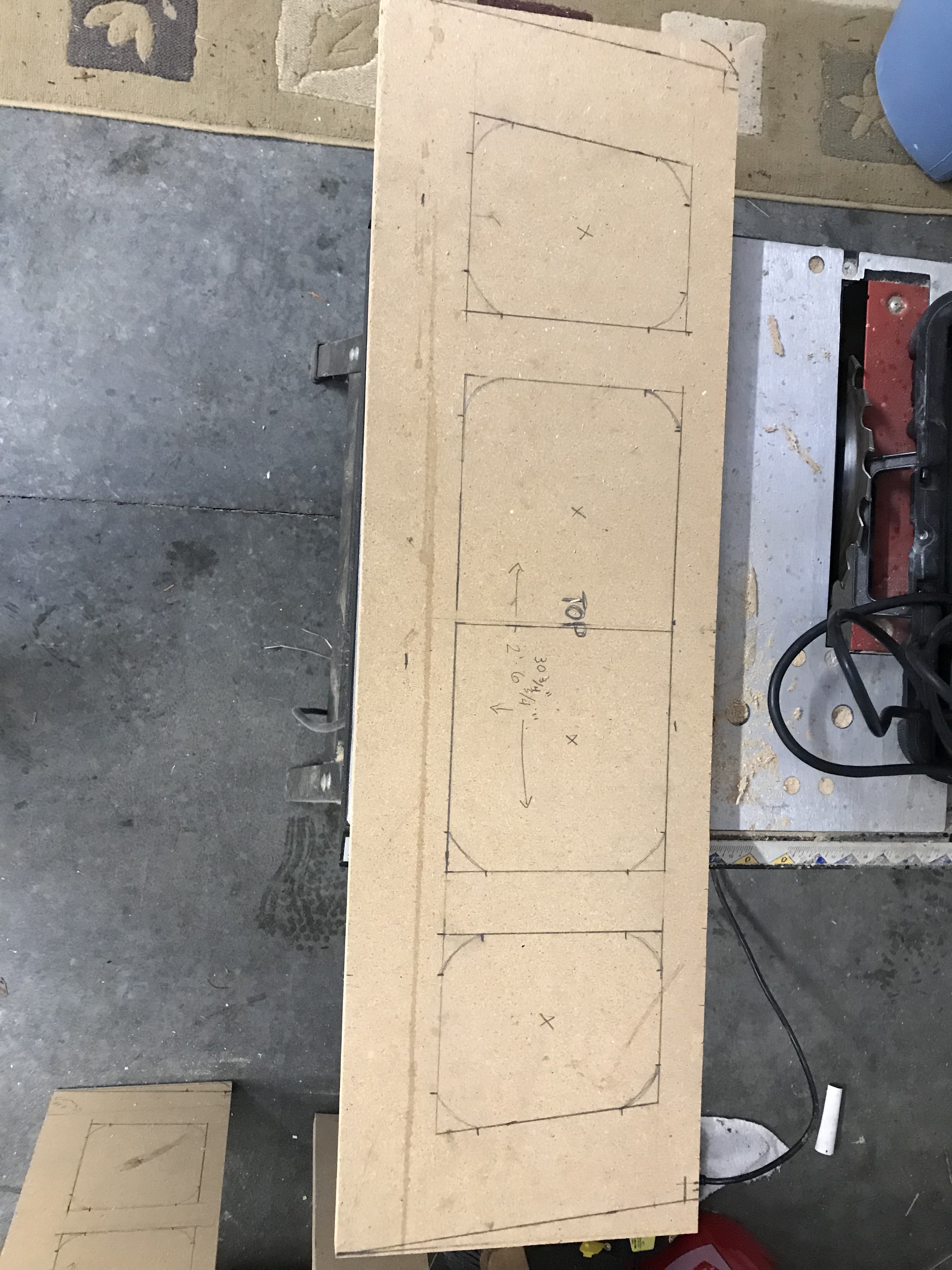

The photos above are of the basic layout for the top and bottom of the cabinet. I got the measurements from the blueprints that have been posted on here before.

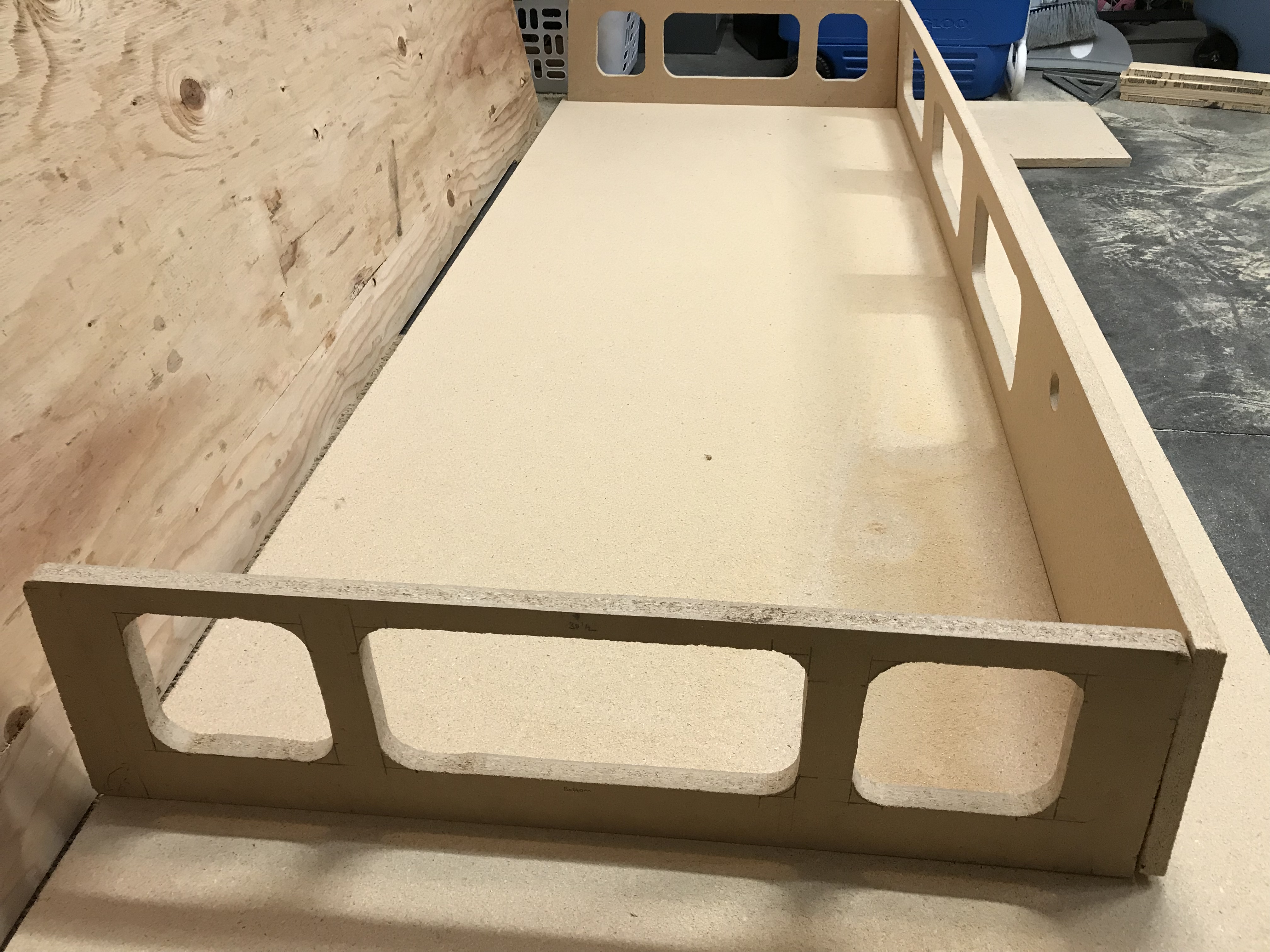

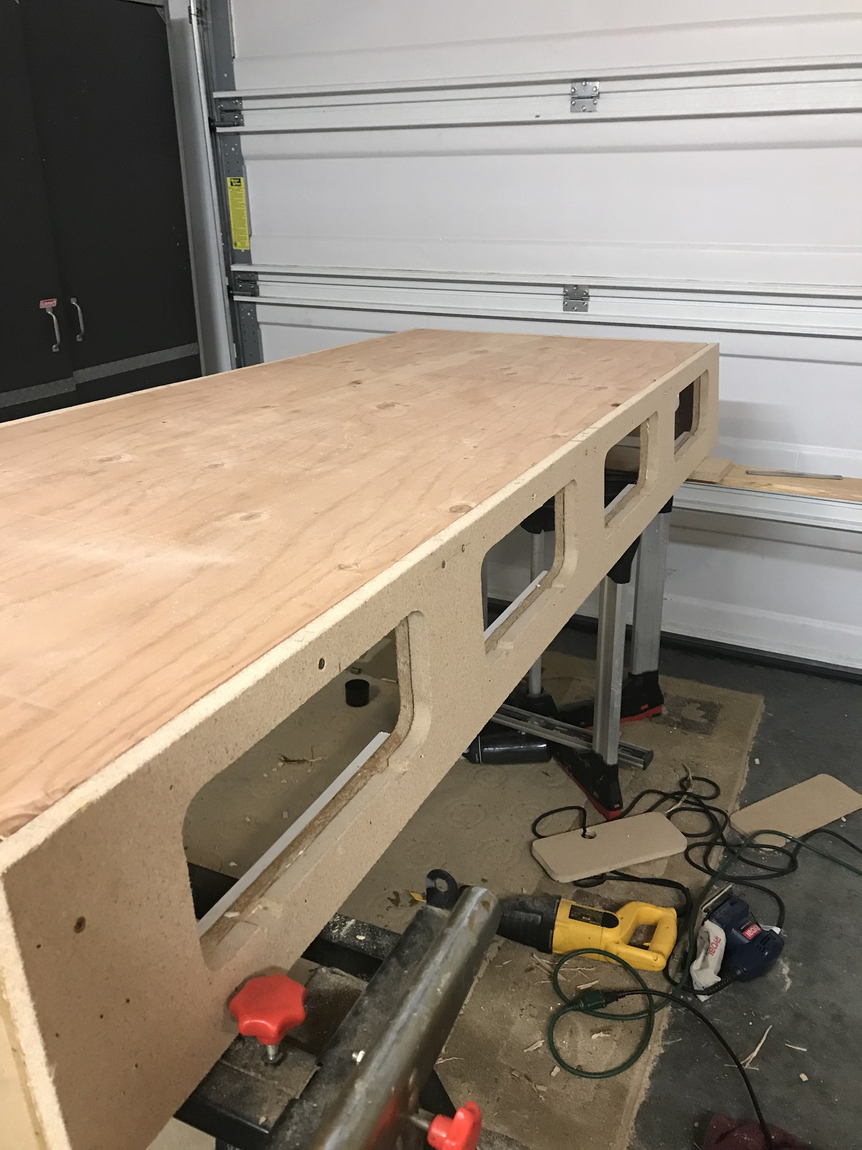

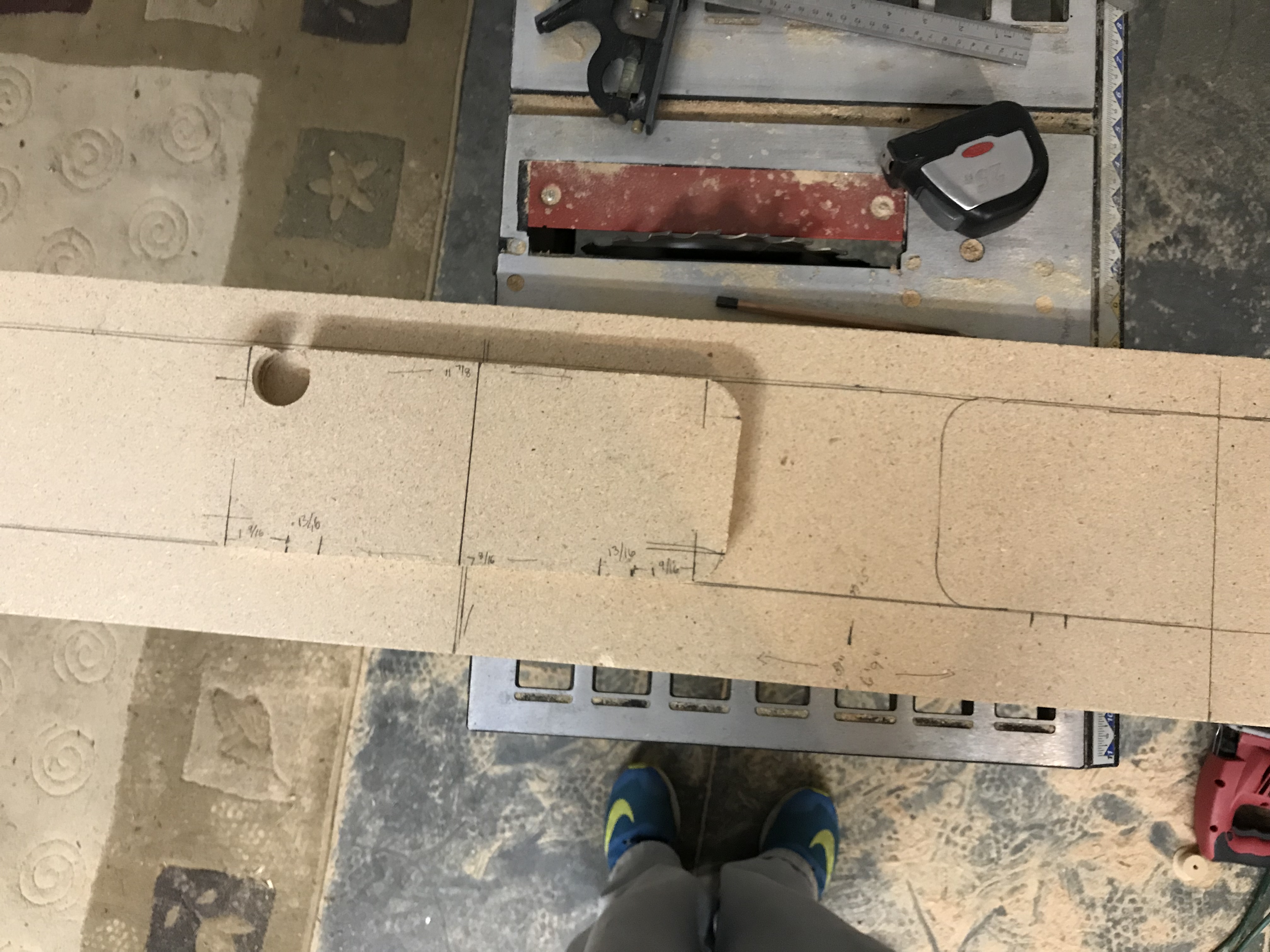

E6101437-B706-4DE1-89E6-4425790EAED1.jpeg 2AB3E459-DE15-4303-BCE8-E5B7BB6AC7E3.jpeg 4EE995C5-B5B8-4E6F-902B-AE350F1AC695.jpeg 23D3CD21-9229-4B54-9C09-5724A54C9C27.jpeg 1764B53B-30F2-4673-A80E-74E2B7BDA82F.jpeg 859DE181-2A01-4D1D-88CE-088BD80530C5.jpeg

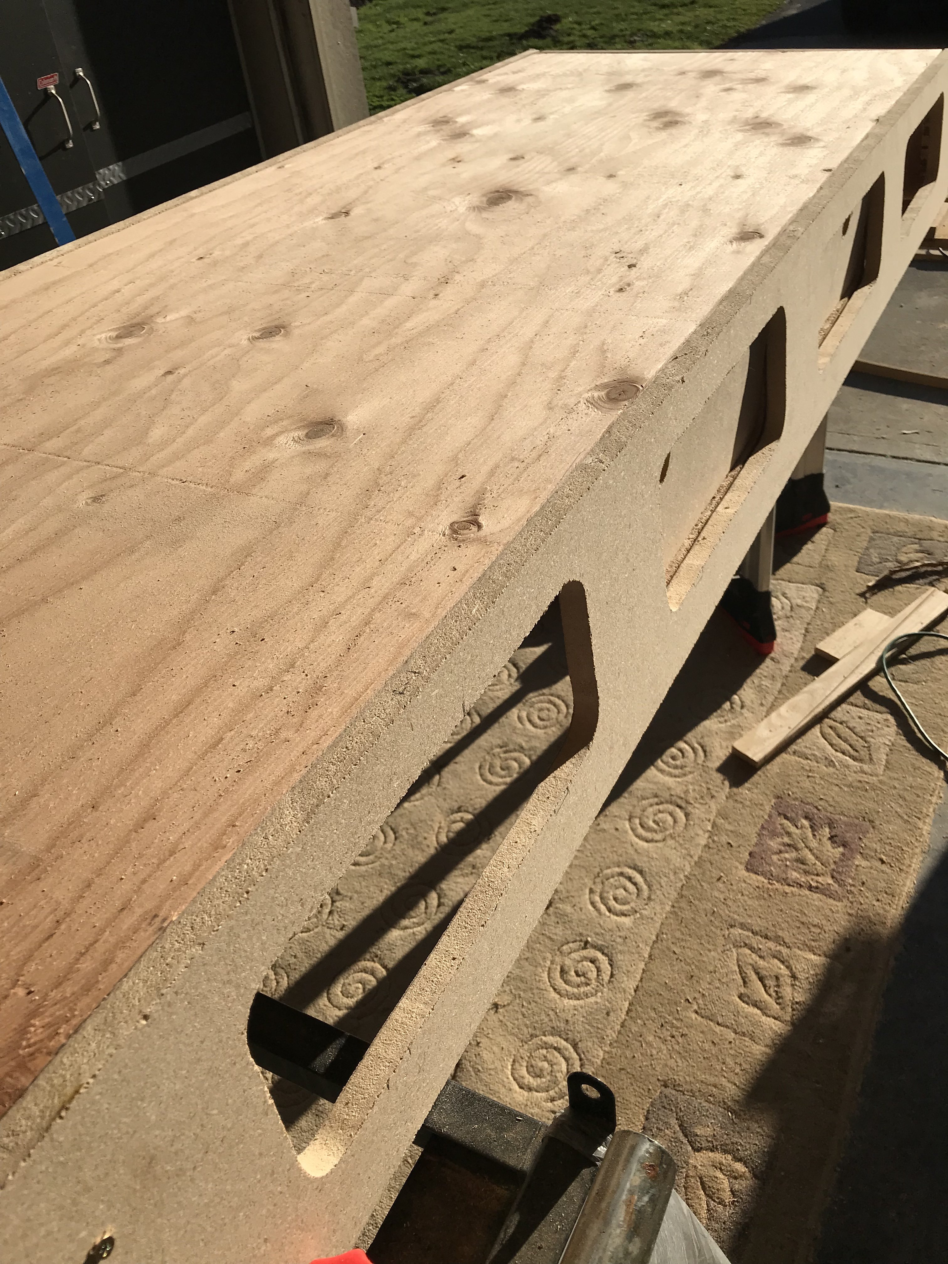

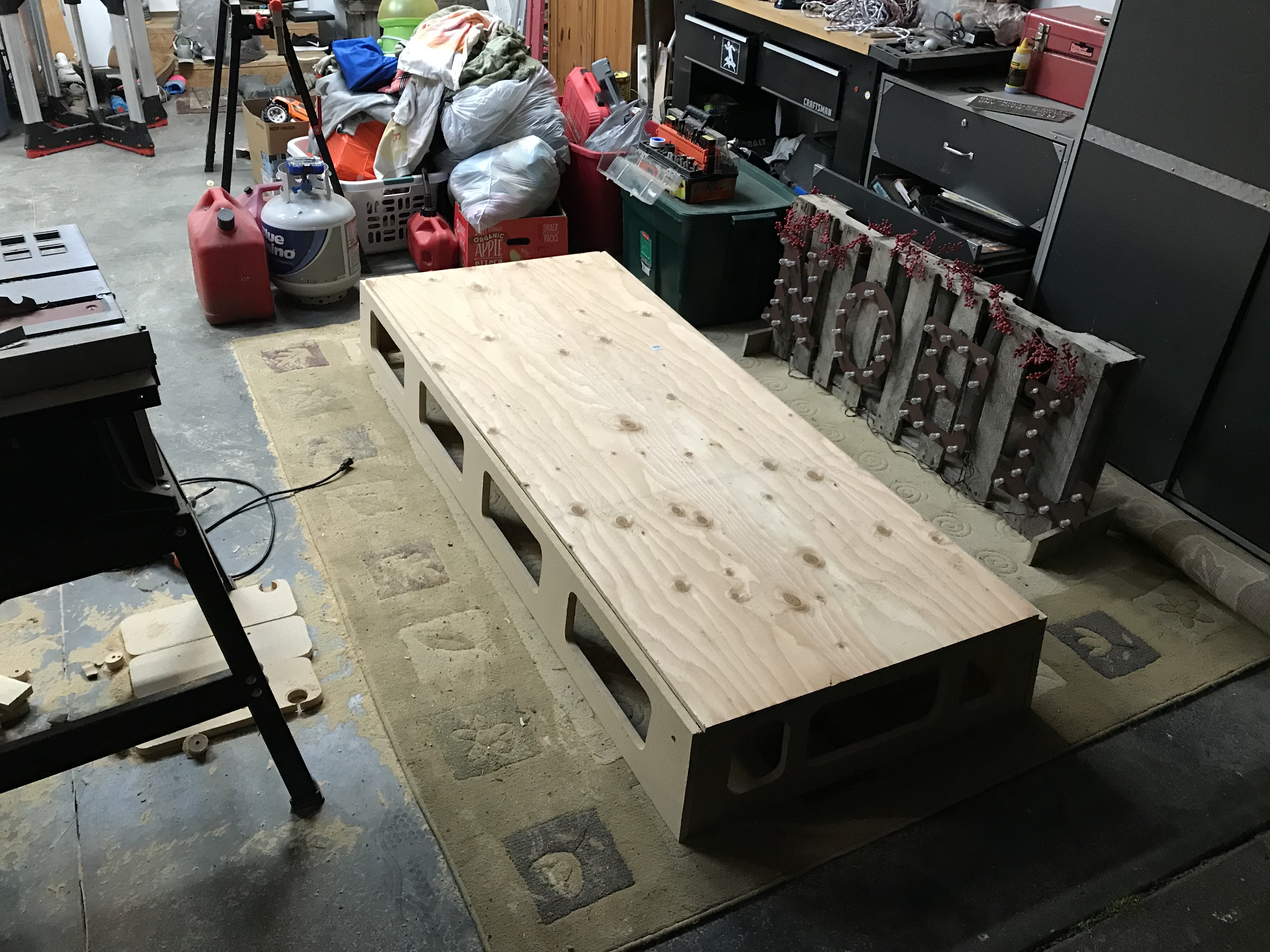

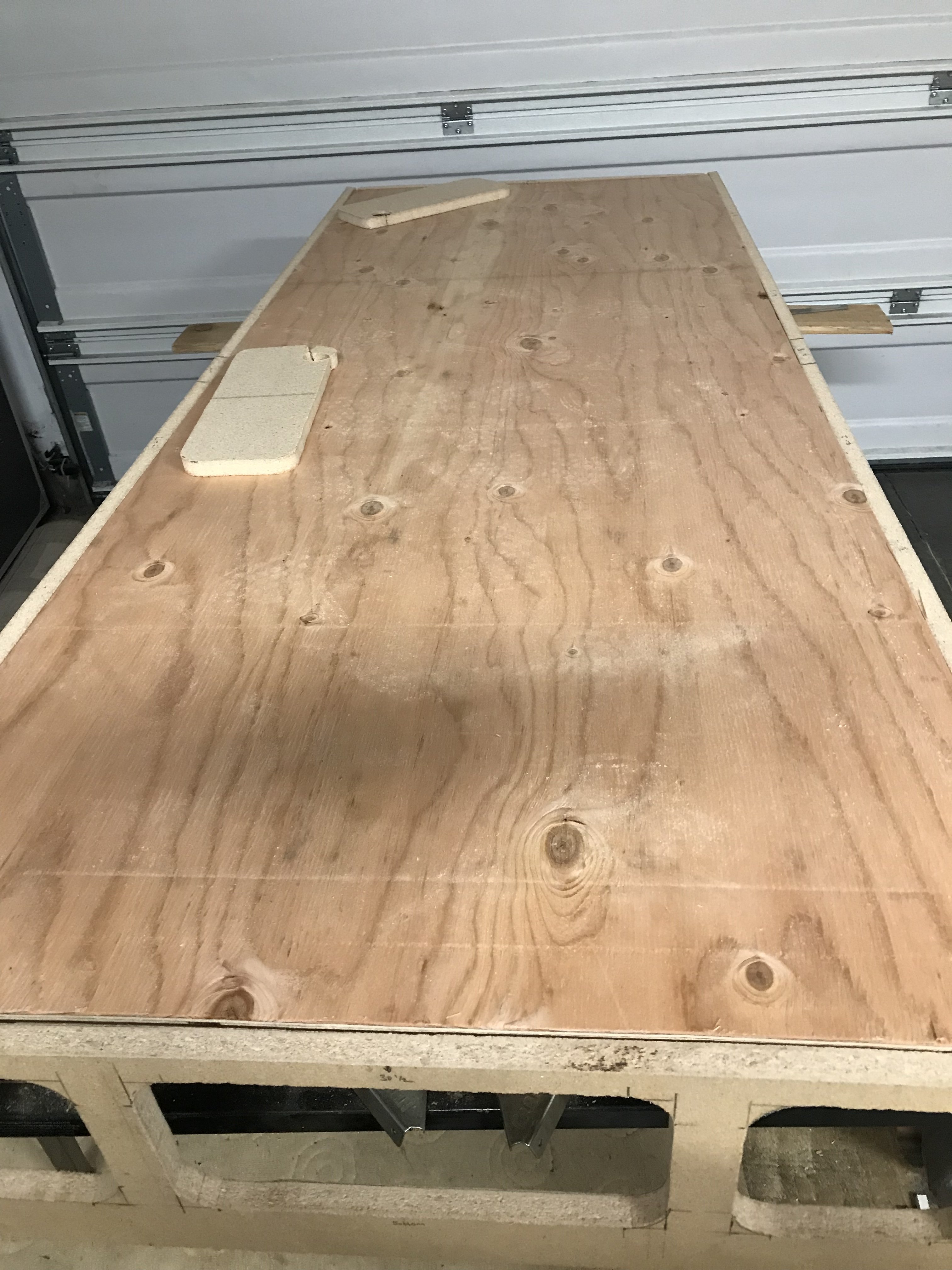

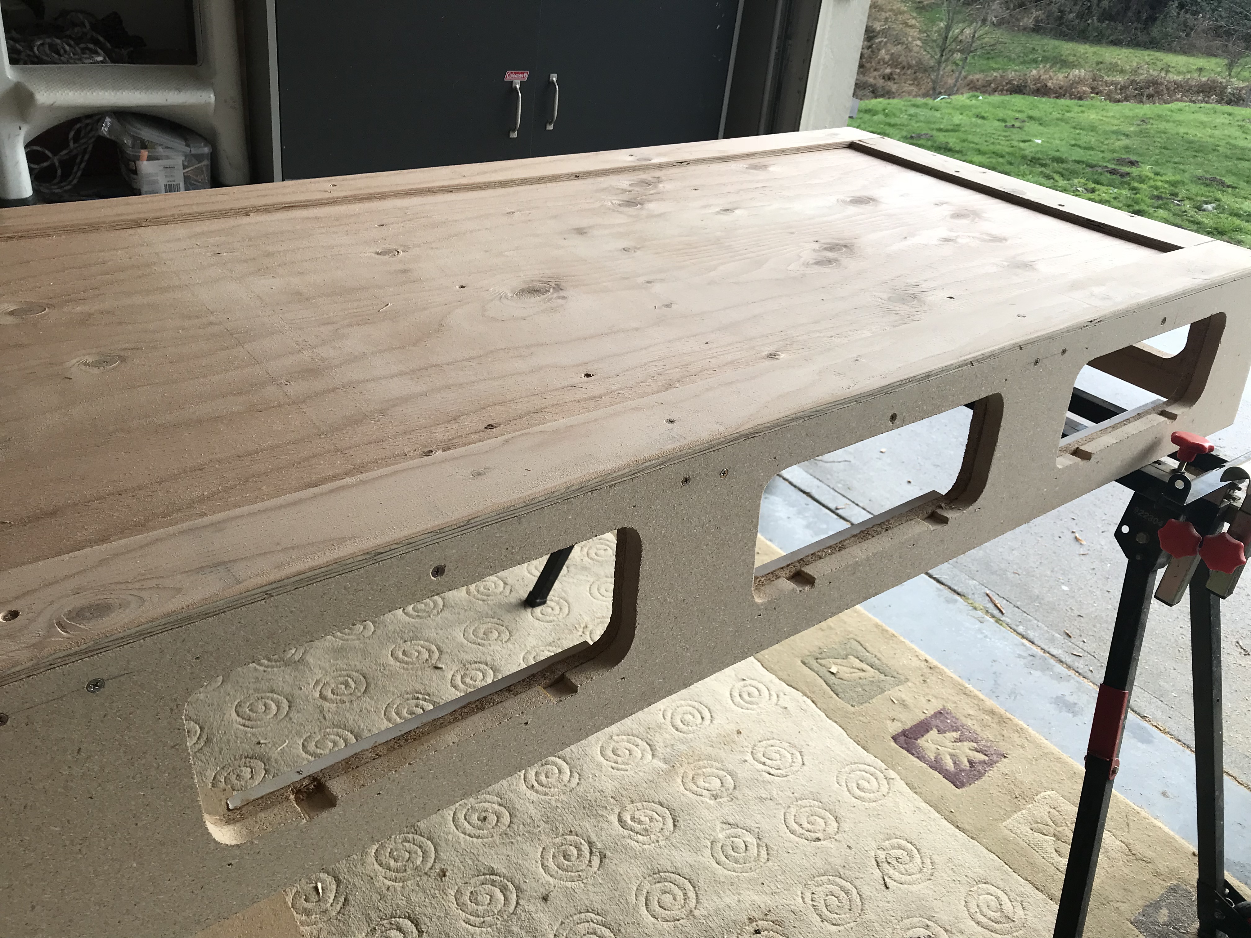

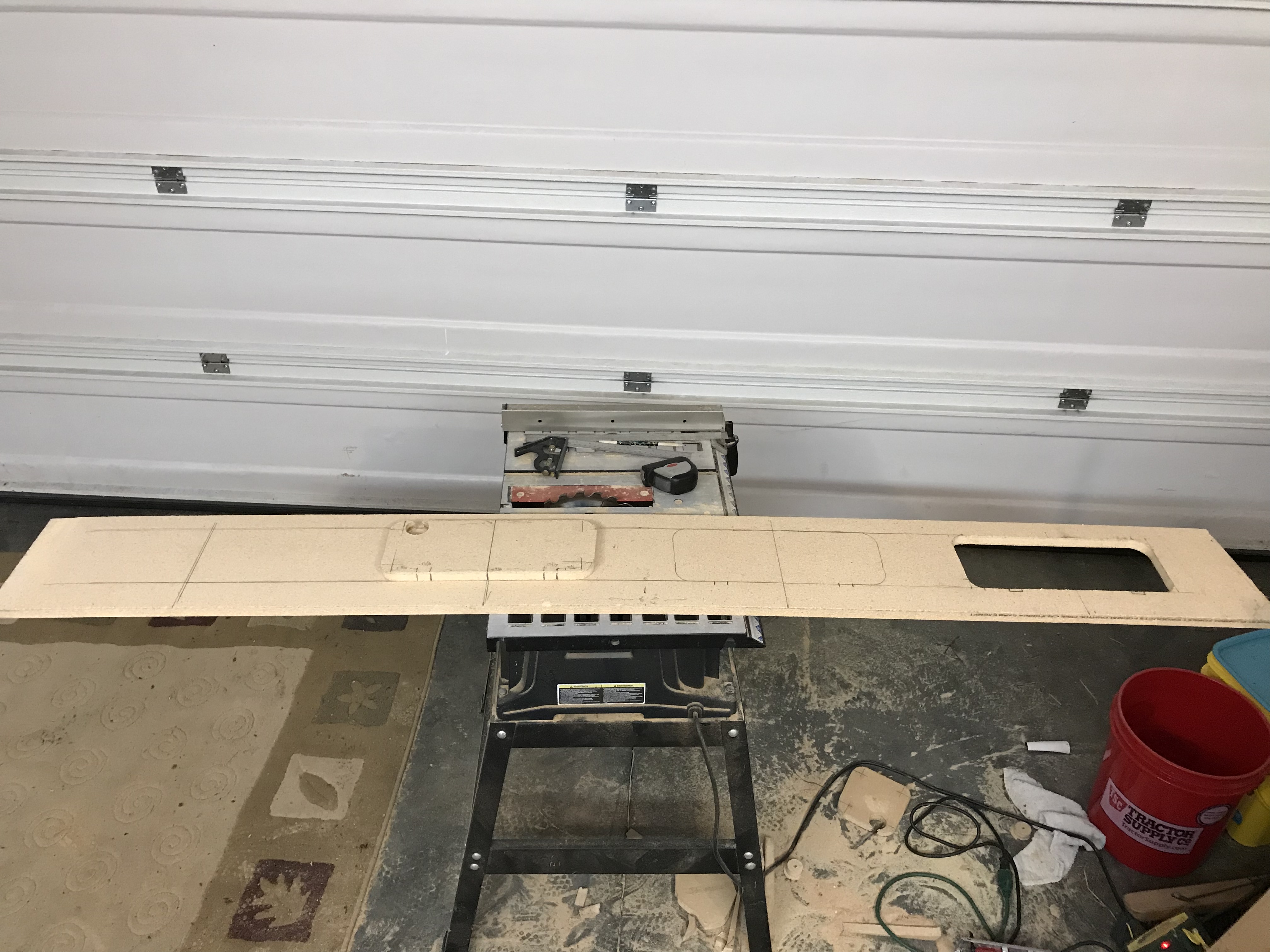

This is the cutout for the top and bottom of the cabinet. I am using 3/4 MDF for the outside of the box hoping to make it sturdy.

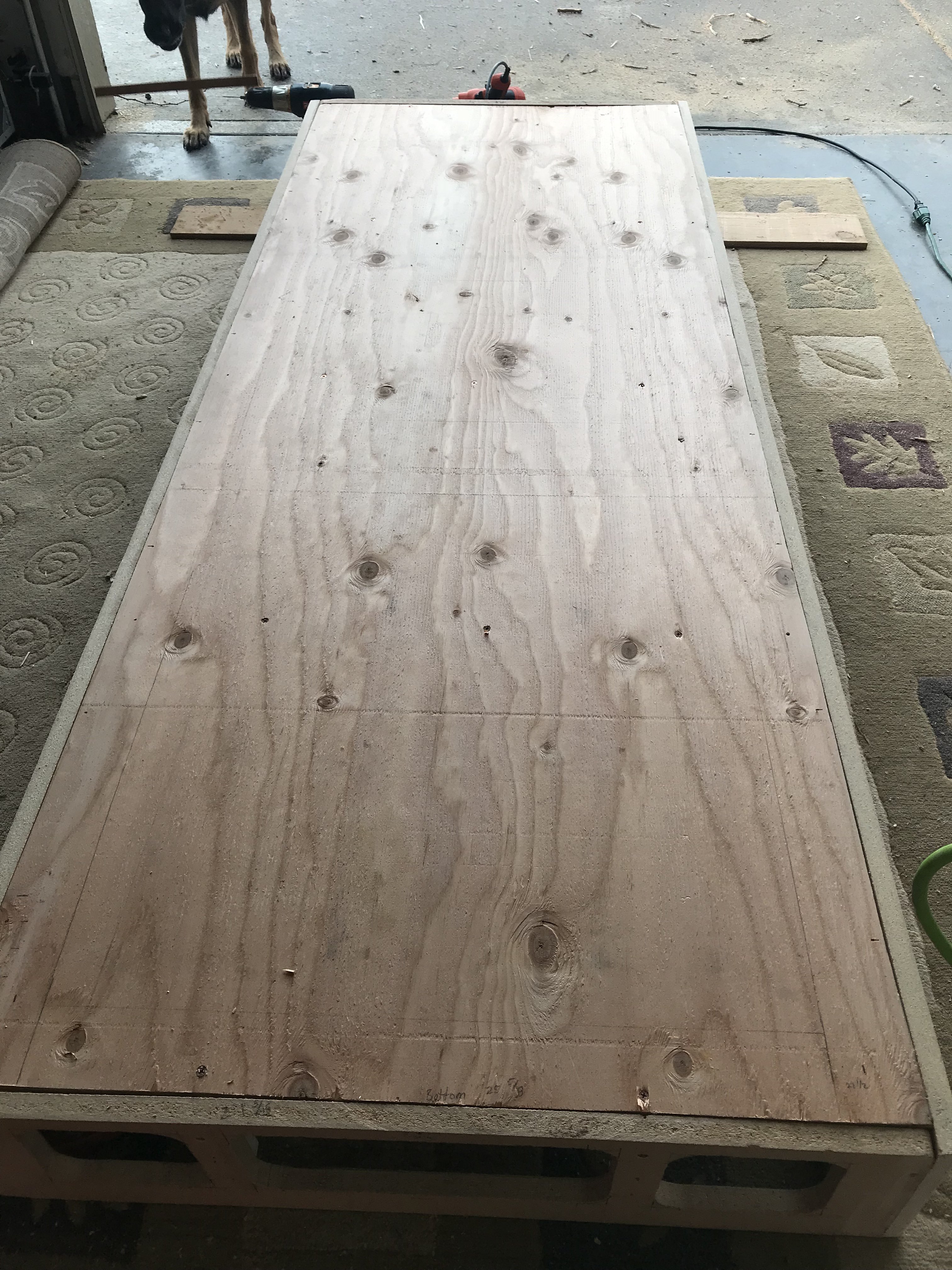

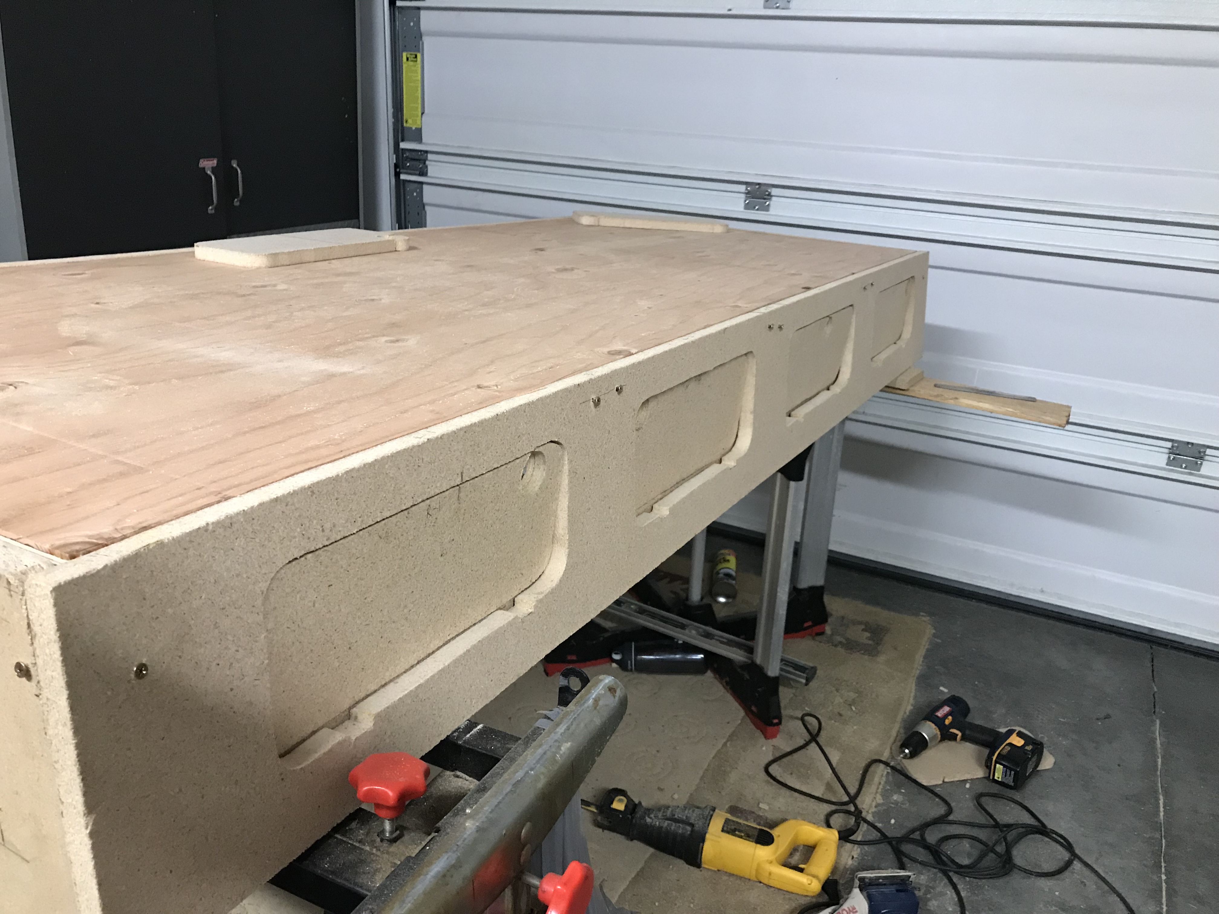

9796FEE7-D6FF-4BF1-B6E3-30F2AEB88045.jpeg 342E5B2A-4422-4A8D-9E91-EB9D721F08F1.jpeg 5AE08971-6011-4520-9C3A-1EC447E9DC2D.jpeg
I used 1/2” press board for the top panel.

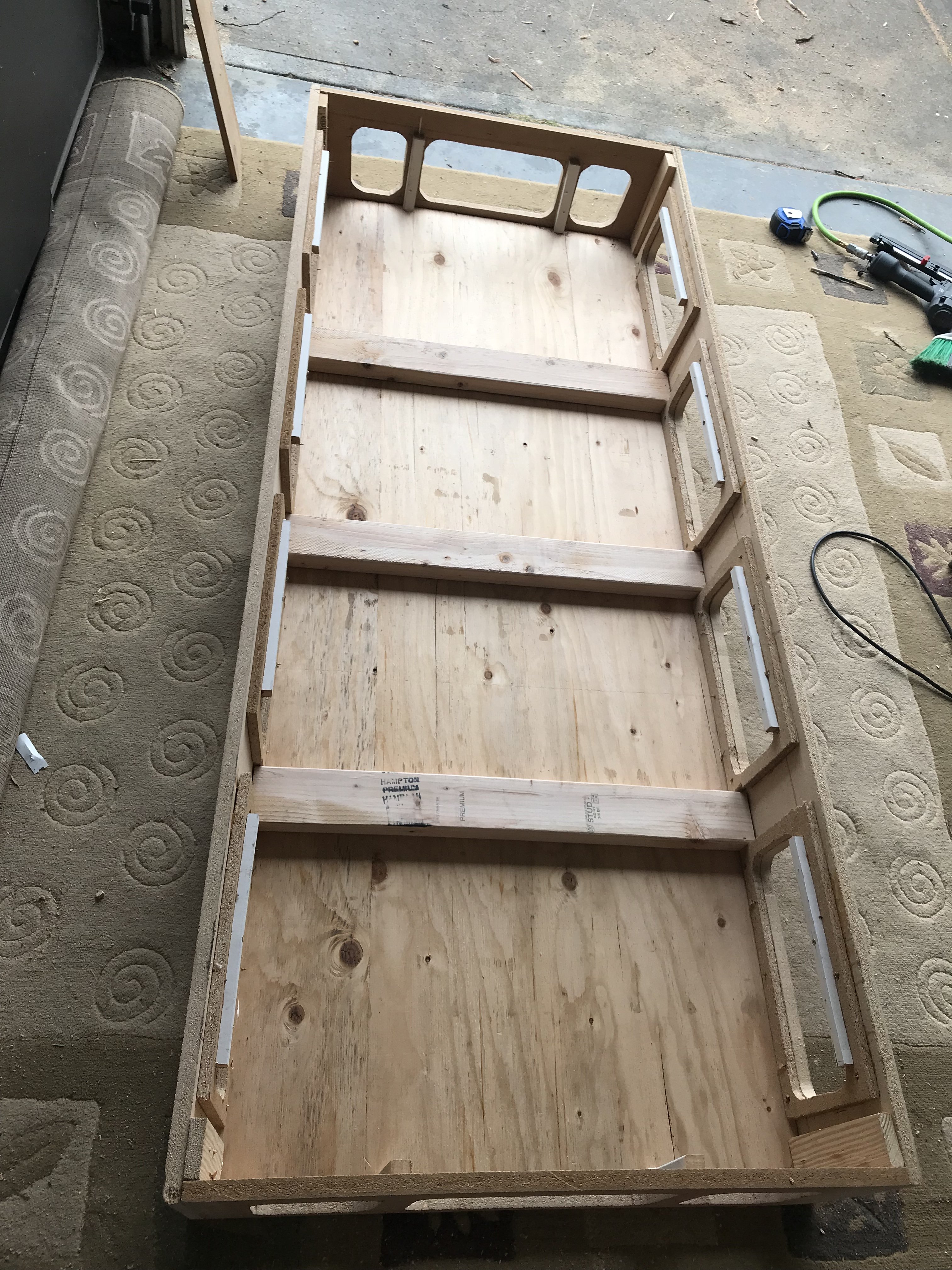

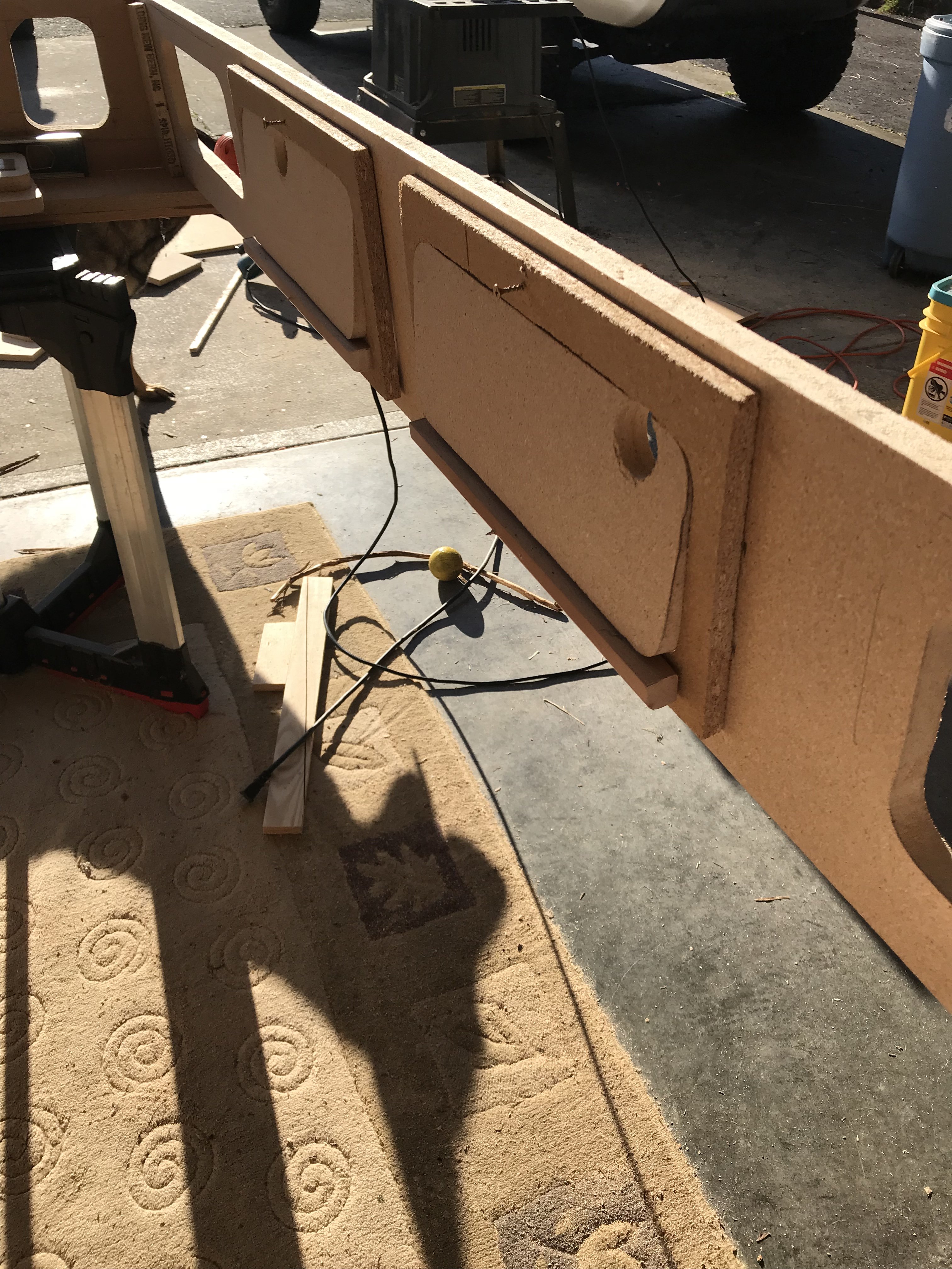

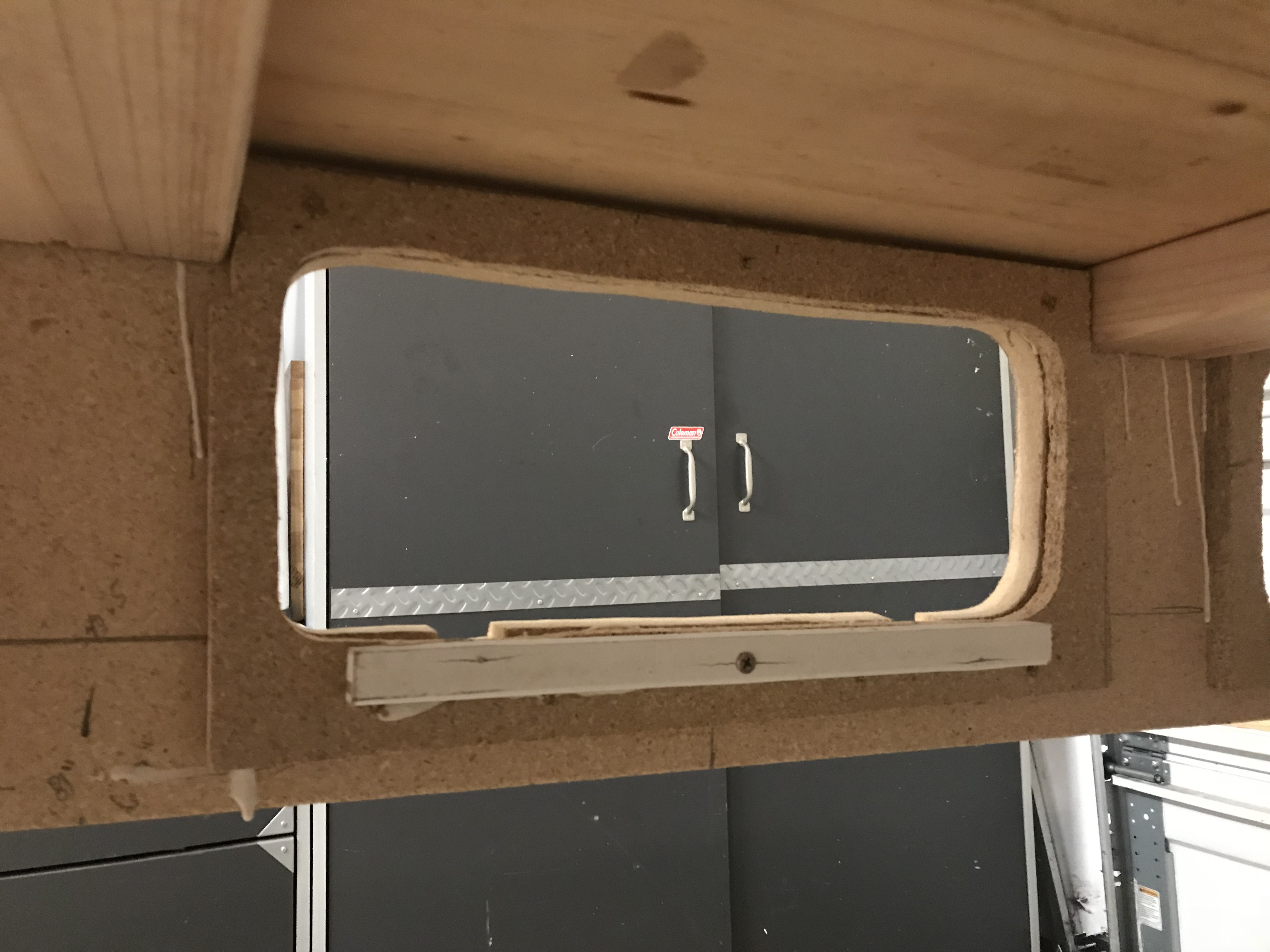

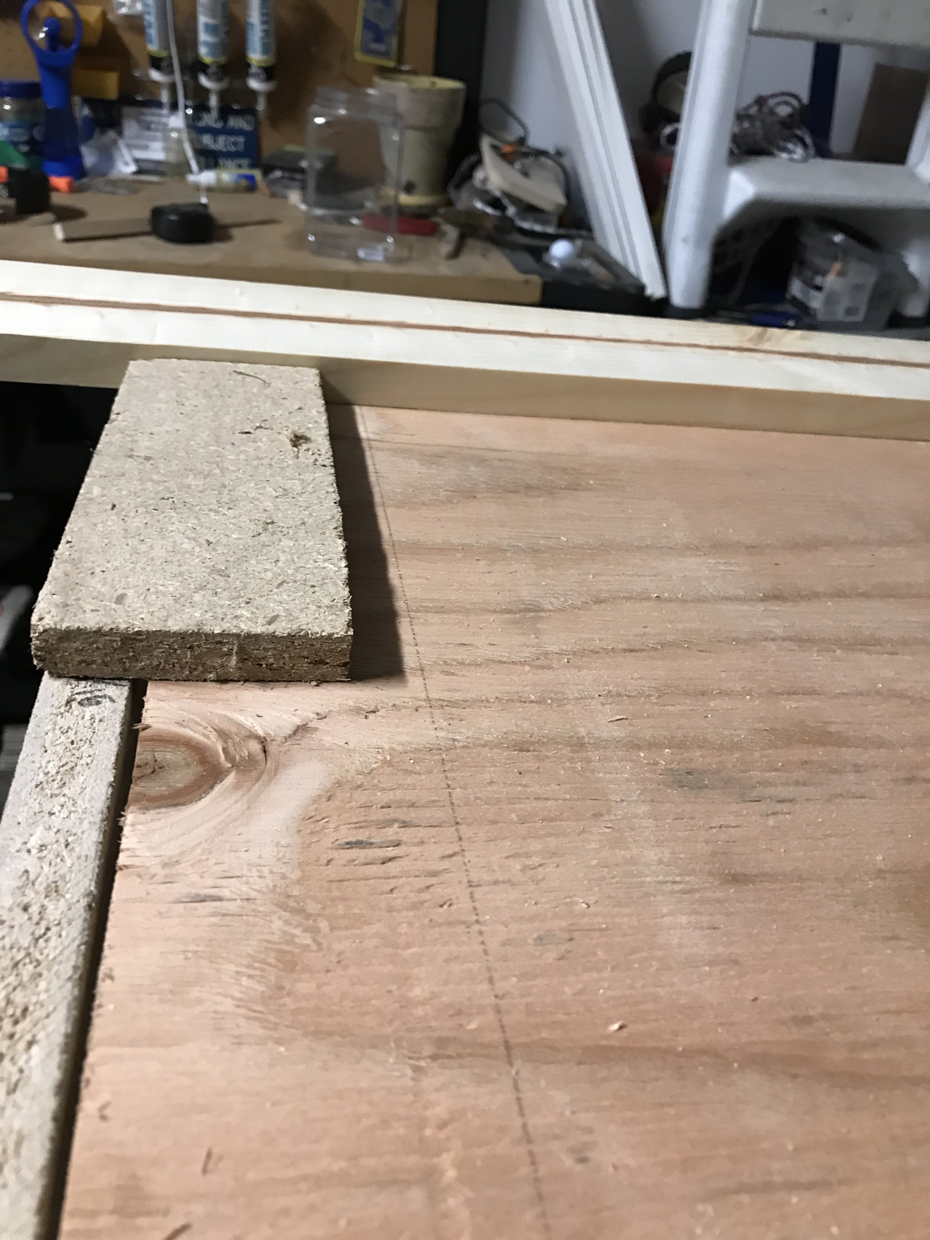

80EA784B-B1E4-4B0B-B1A3-5DAC577E4C5A.jpeg FD4F527B-197A-4315-AE9B-EE0F759AEA2C.jpeg 1AEF4FB7-876B-49EA-A6DE-950184502647.jpeg 078238C6-D54C-4D85-94EB-9CCDF4408546.jpeg CAF08073-5C98-42BC-A3FE-16B874C2BAB4.jpeg ABFEA944-B5A5-4102-BB3D-3A77F112CEF5.jpeg
I created these mounts for the inside to hold the panels at the right angle. I also measured them out so they lay 1/2 below the top so the Han board will have some extra support on the sides.

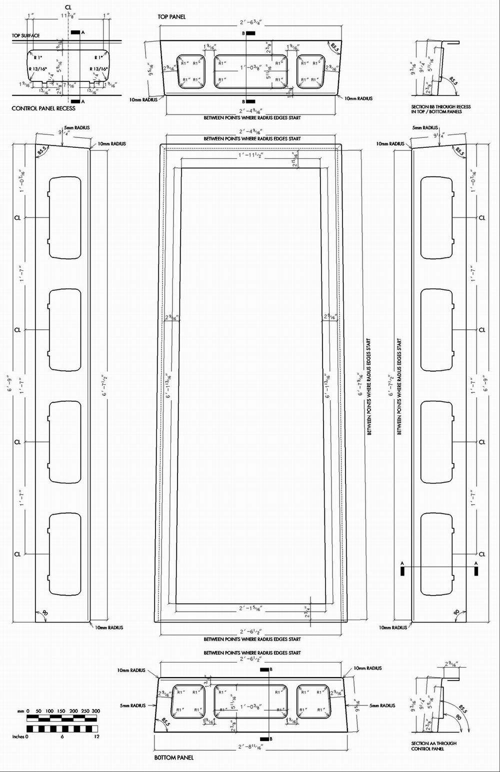

Thought I’d post the plan in case someone didn’t have them yet. I did not make these and found them on TDH.

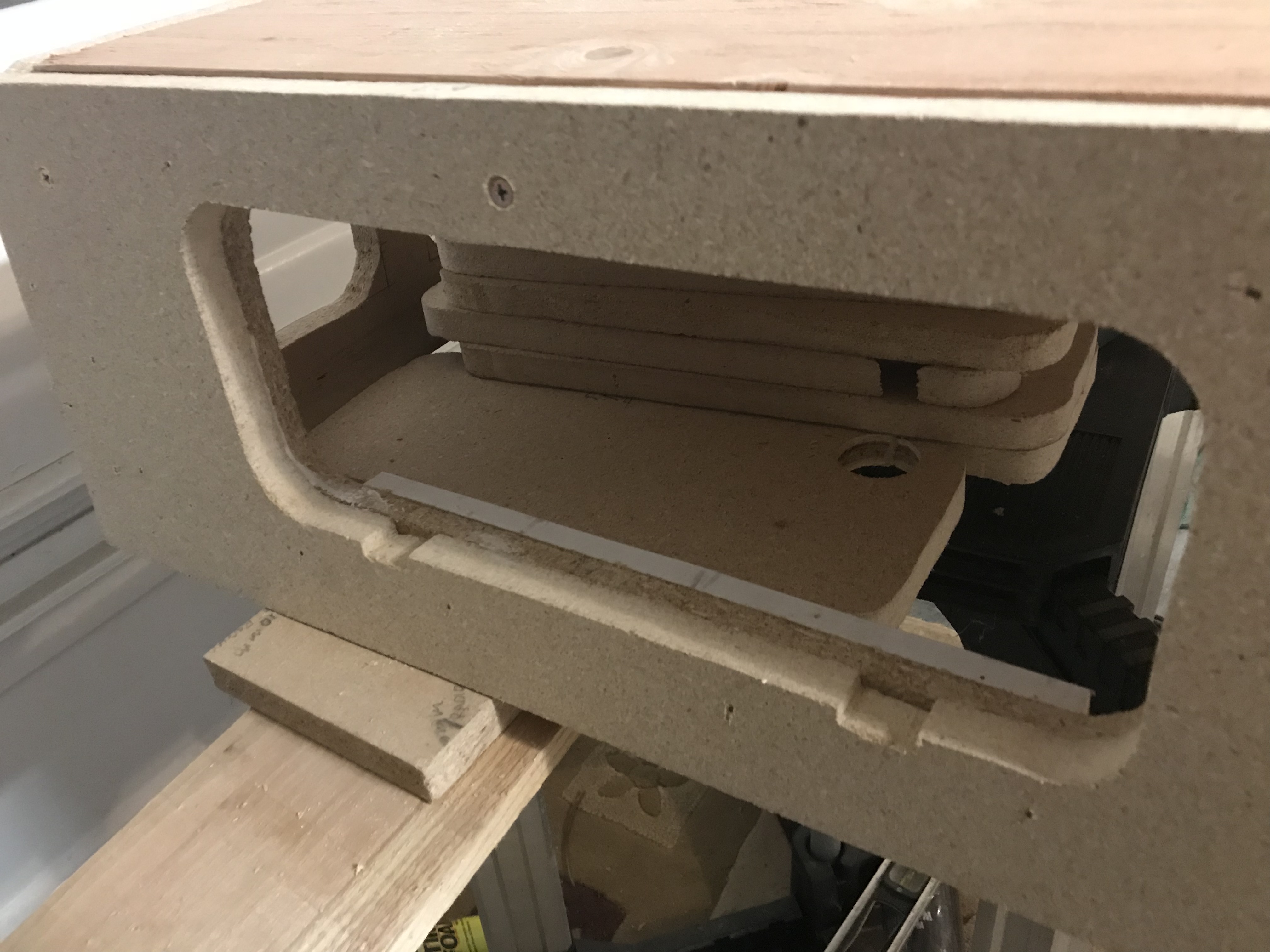

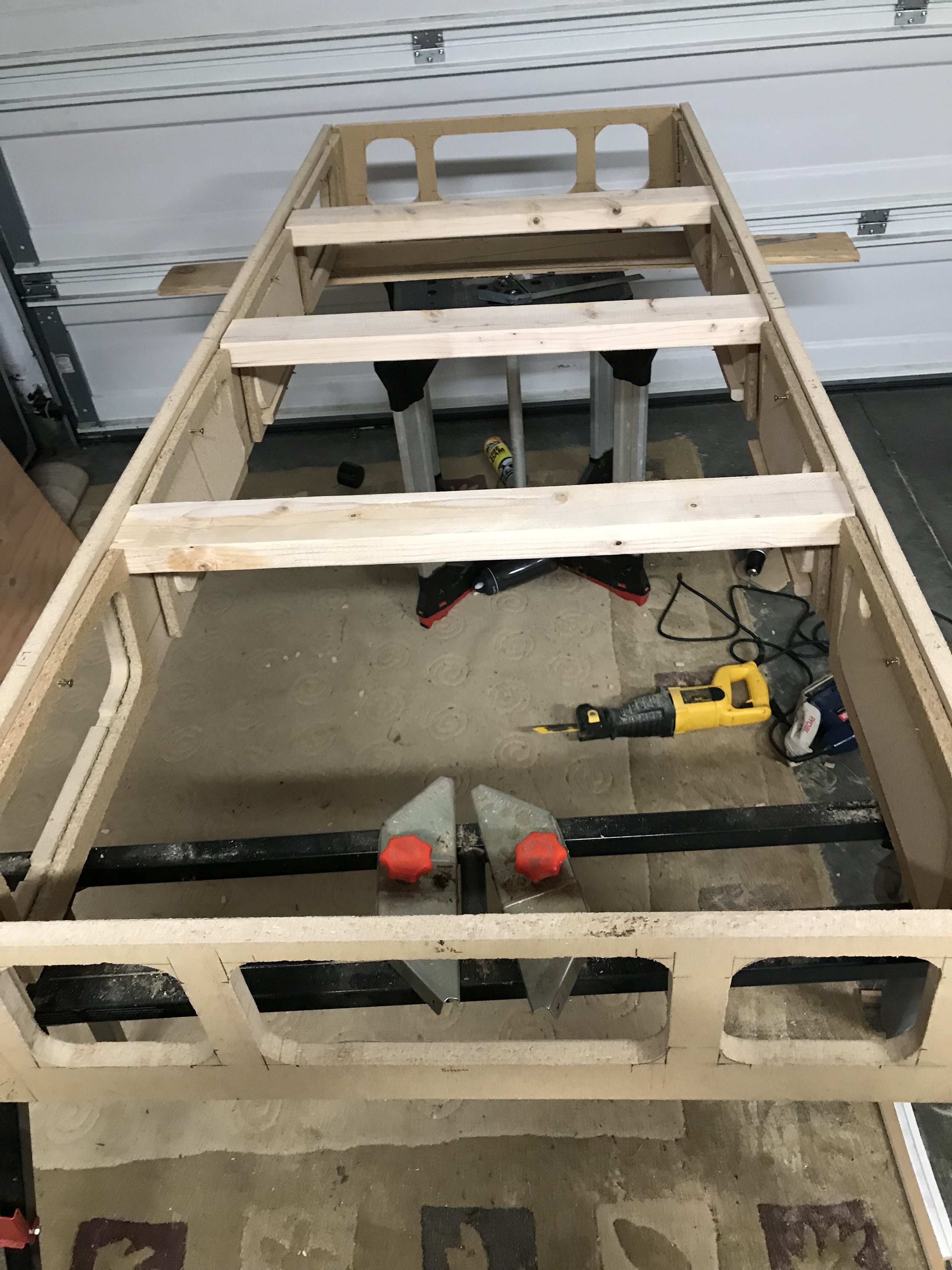

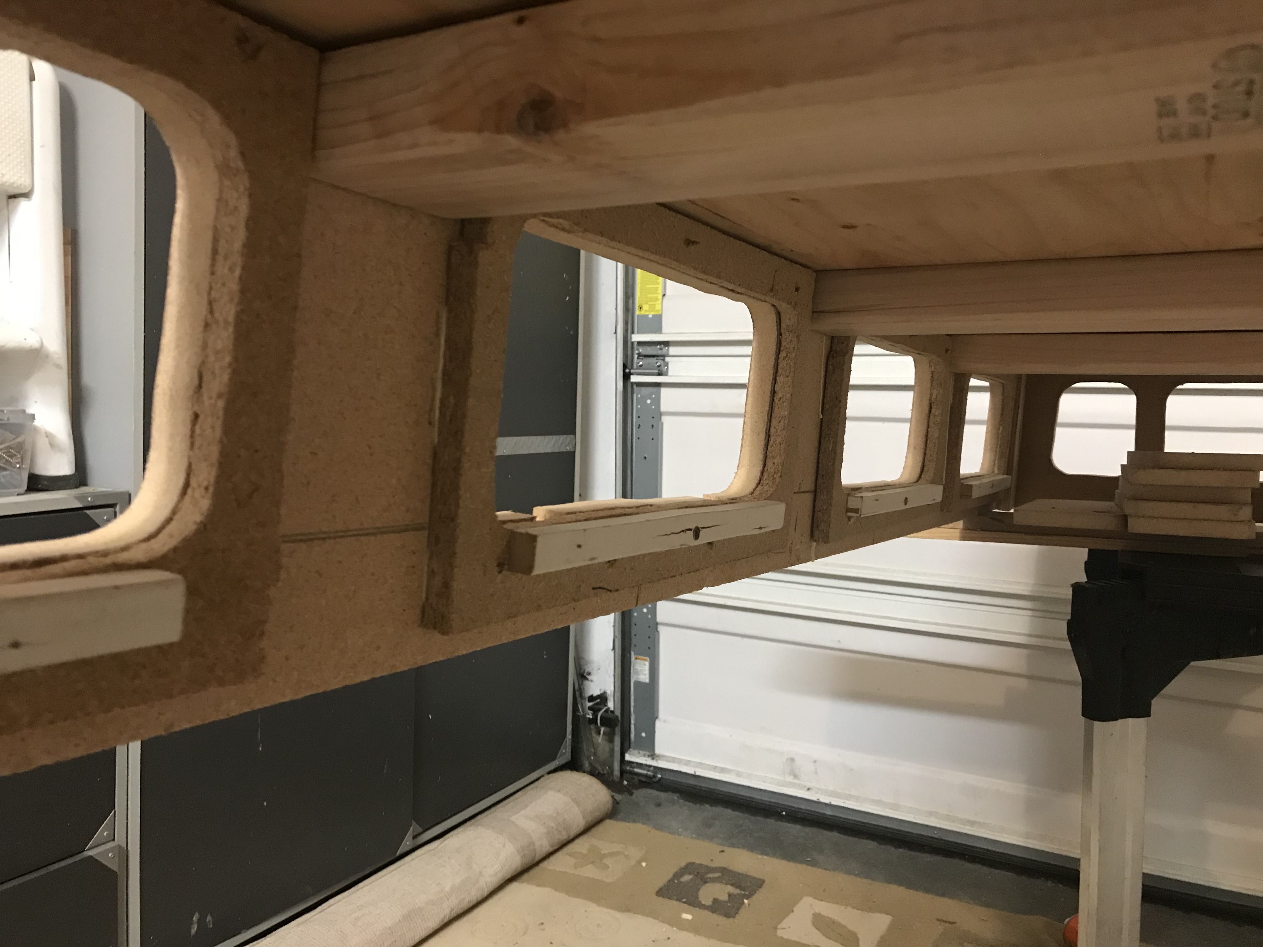

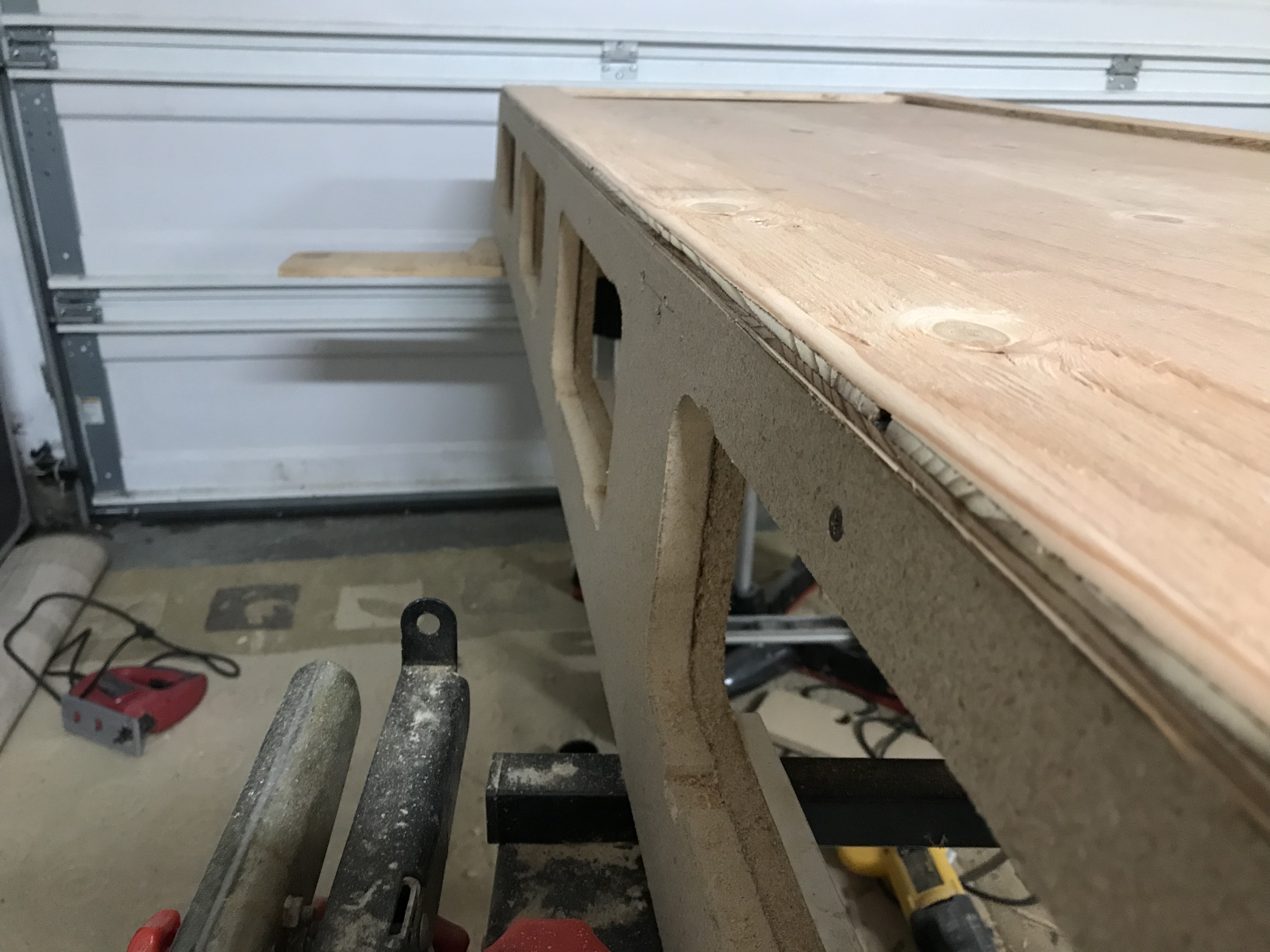

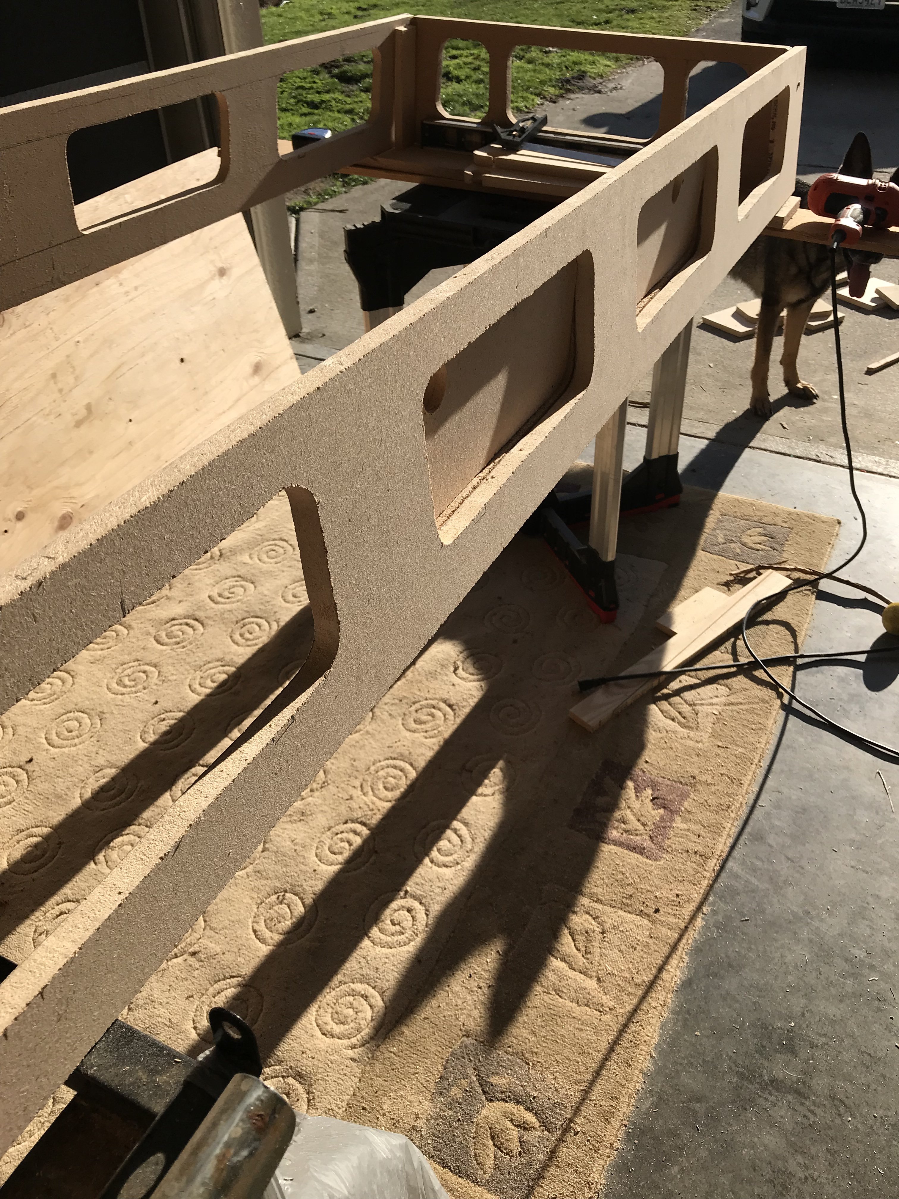

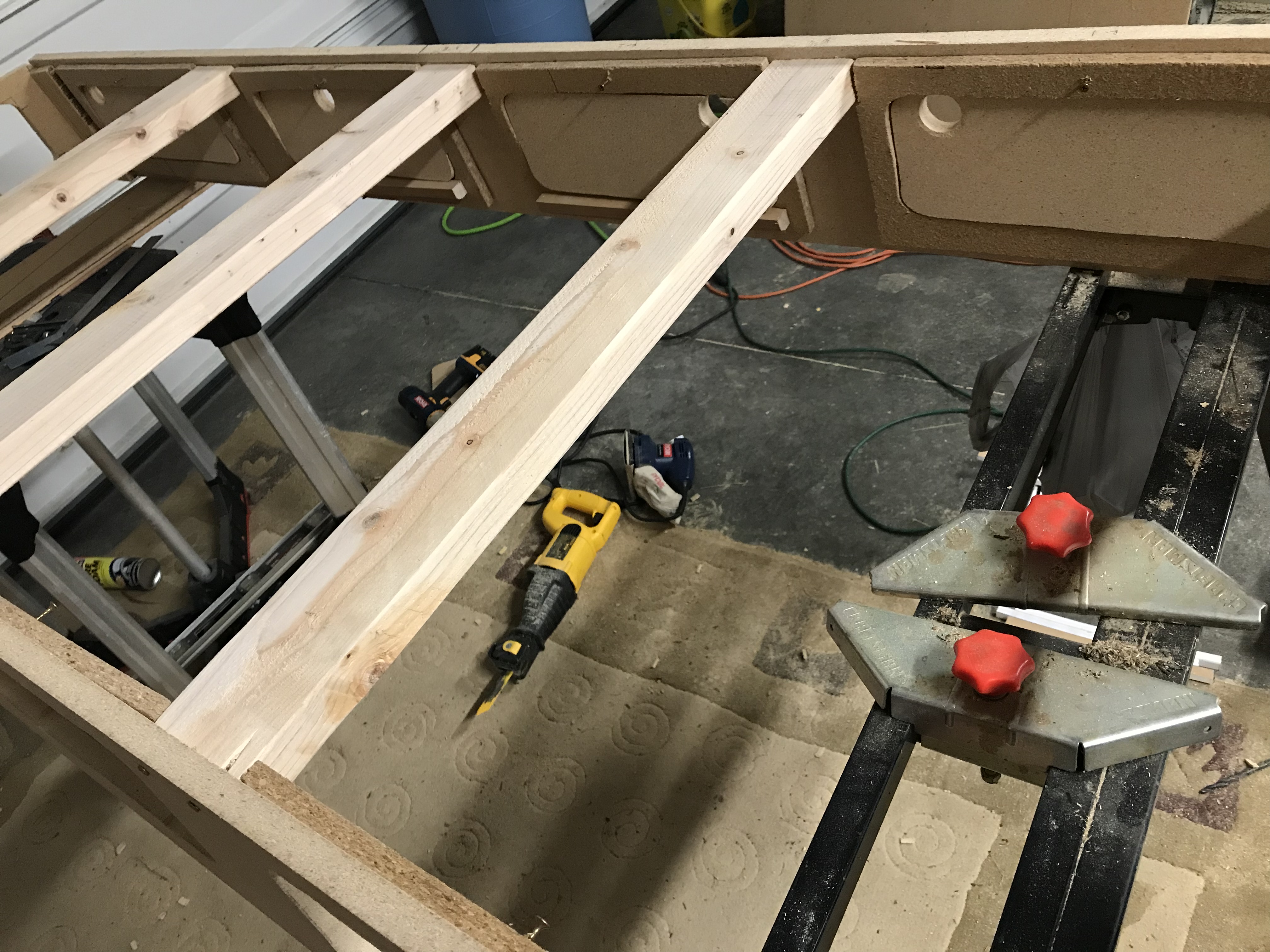

11DB4493-572C-44D2-9462-5BAB5235A828.jpeg AFEDC91E-CEEA-438F-ACE7-ED5CB8BFA936.jpeg 4CD15E24-0CBC-41EF-B3A8-BCC42FAD5B2C.jpeg 5FF9C387-71E3-426A-8F36-3FB5705EFC50.jpeg

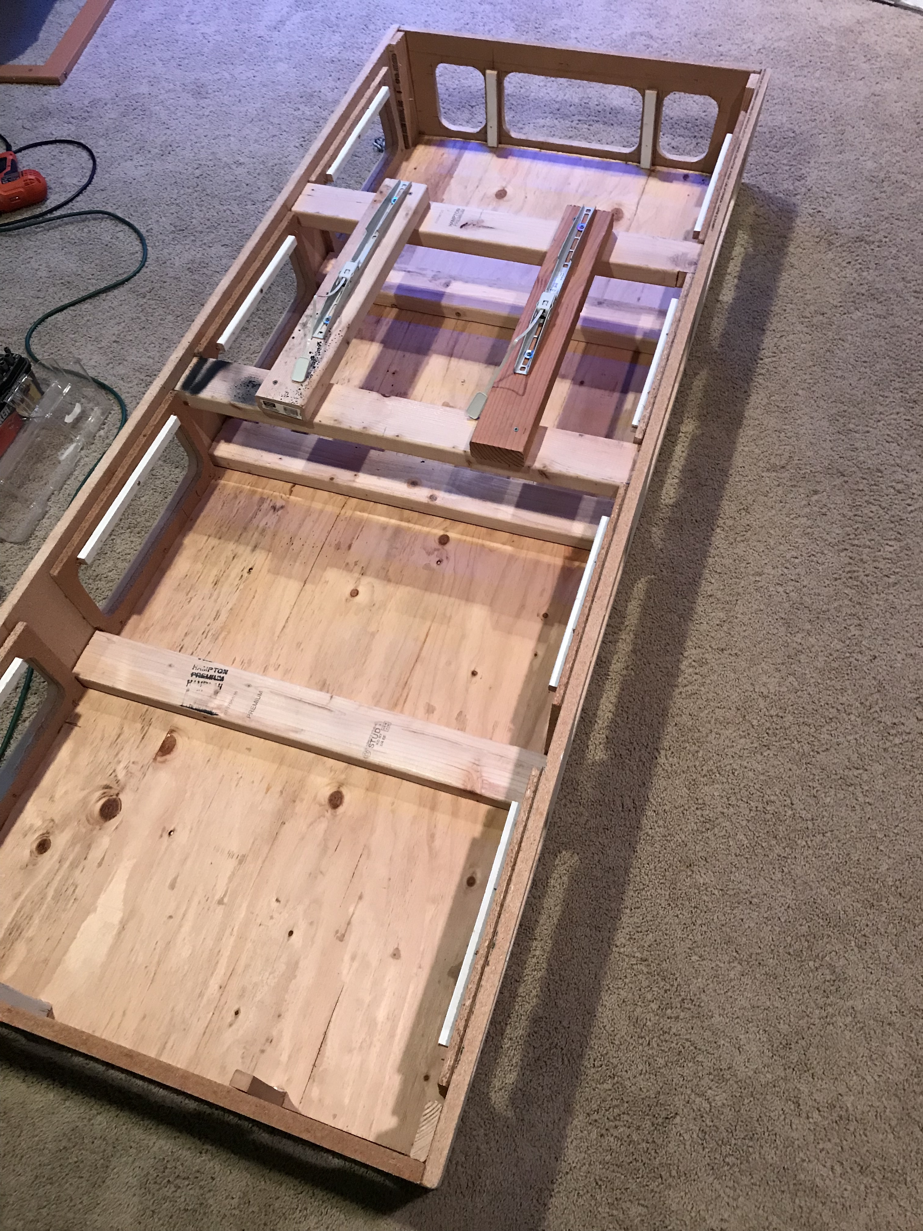

Put some work in on the inside framing and the panel display mounts I really want these to end up with the right angle so I’m trying to make them fit perfectly. I’m using 1/2” mdf for the framing of the panel brackets and mounting an extra suport to crest the angle.
The side panels are fitting in nicely.
This is with the top laid on the frame. I have it fit in pretty well I have measured and marked down 1/2” on the inside of the frame and adjusted a little to make the top lay on top.

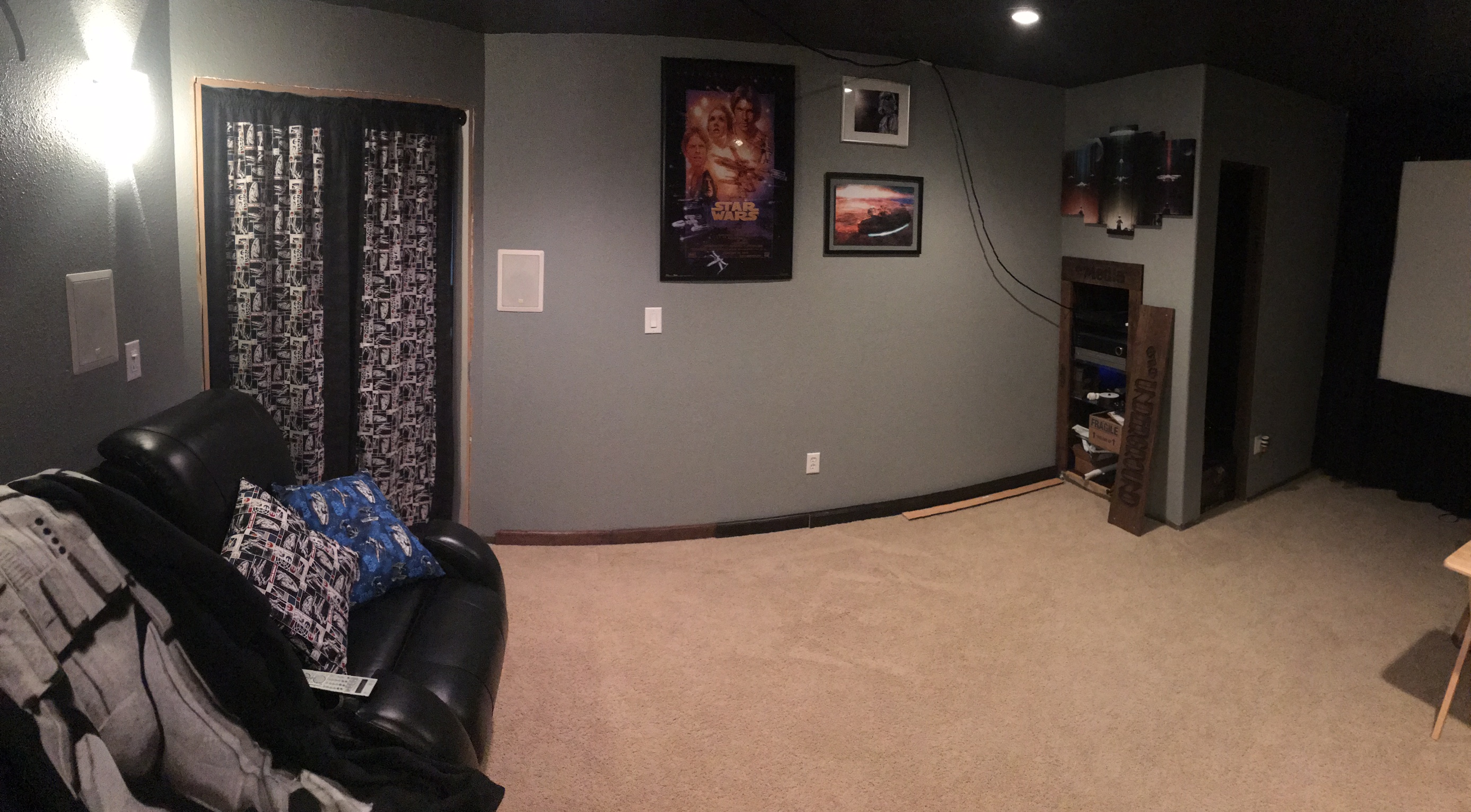

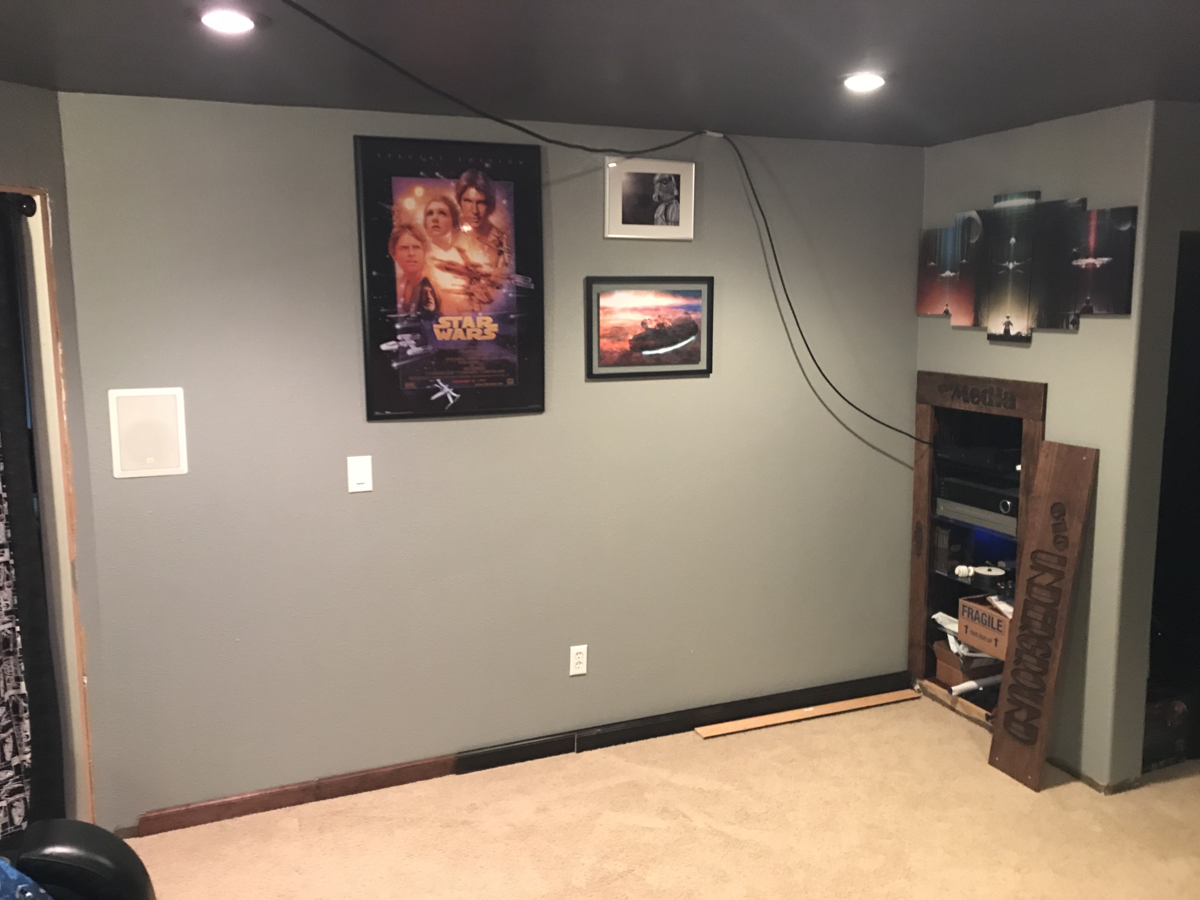

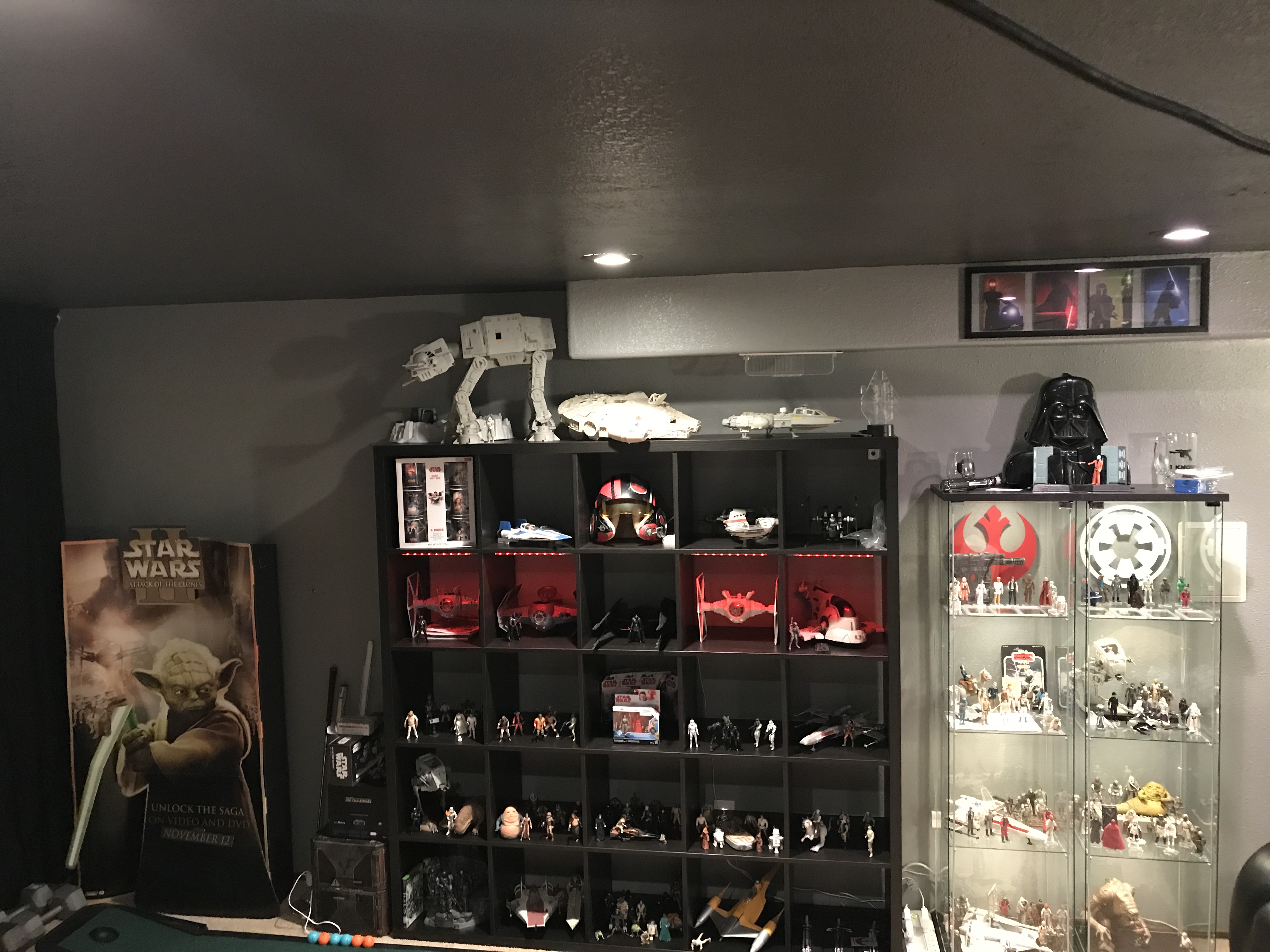

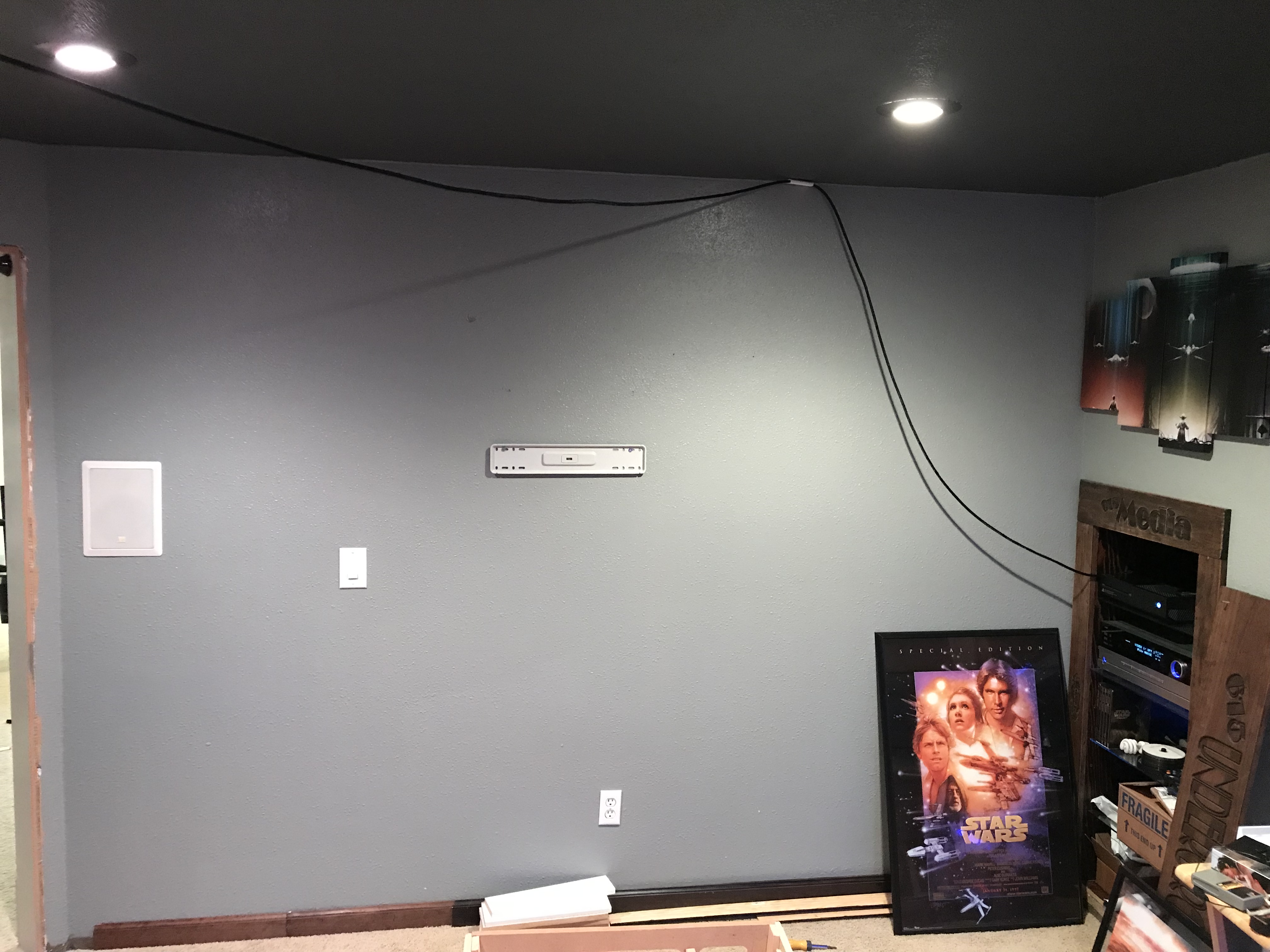

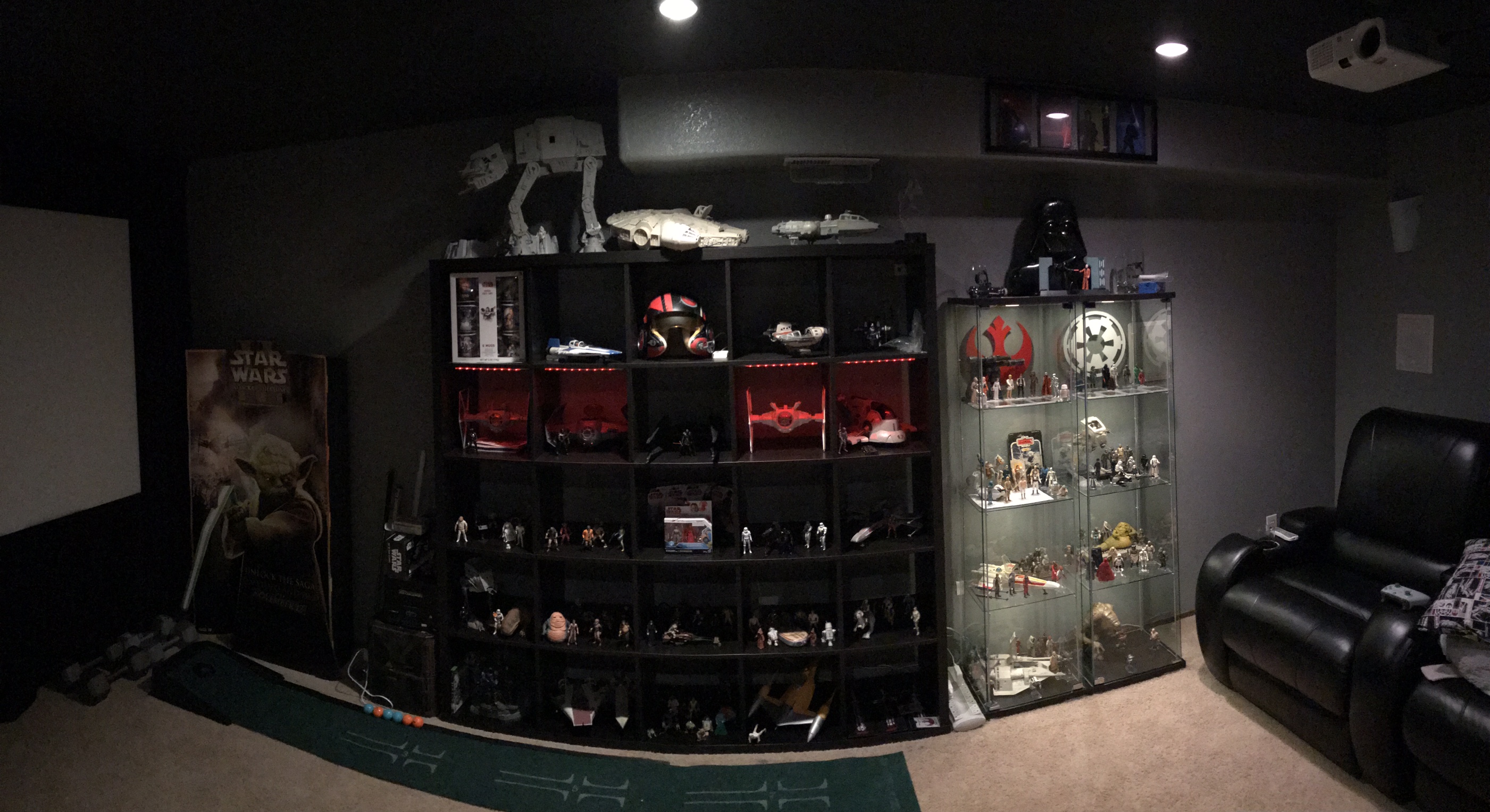

I also have a question for everyone. I am going to mount my HIC on this wall in my theater room.
The question is where should I mount it?
My theater screen is to the left of this picture but I’m debating on if I should mount it far left? Or move the lighted glass display and mount it more in the middle.
The glass display is the most noticeable to the eyes when you enter the room.
Thoughts?
I also have thought of creating an independent HIC wall on the left side of the room.
My wife likes this idea because she informed me she doesn’t want “creepy guy coming out of the wall” right next to her when we watch movies.
Its just my opinion, but if I had a room as cool as this in my house, a Boba or HiC display would be the cornerstone piece and I would want it in the most visible spot in the room!
My vote is more middle. (y)

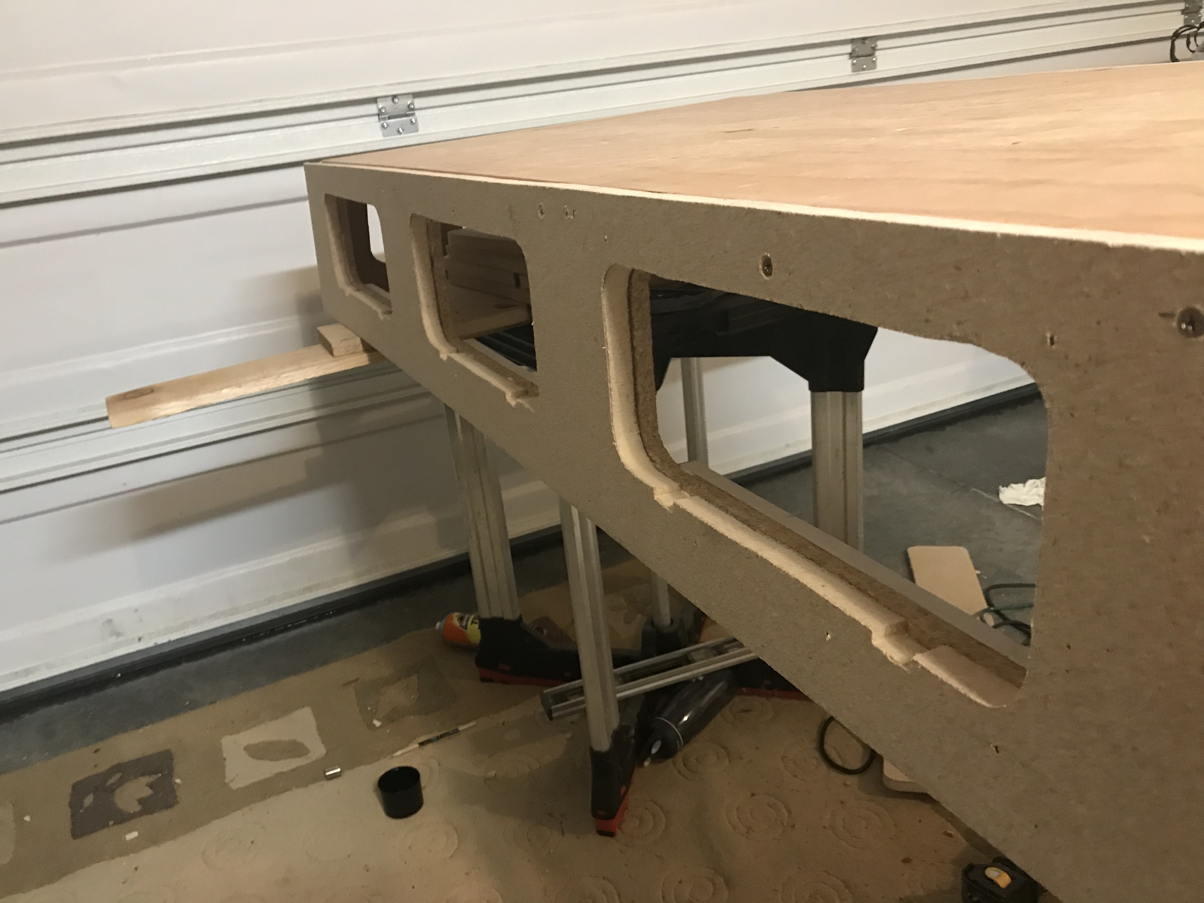

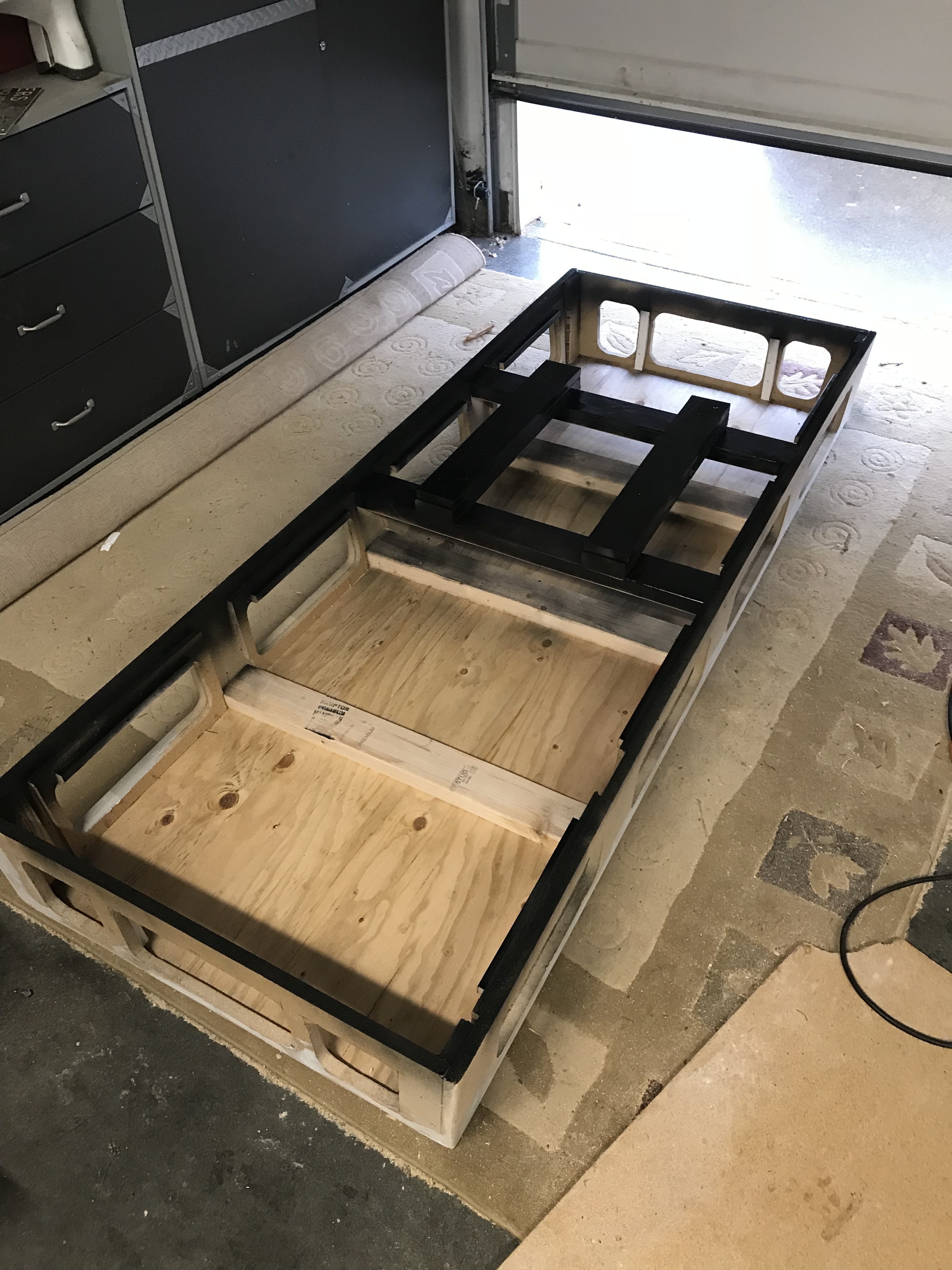

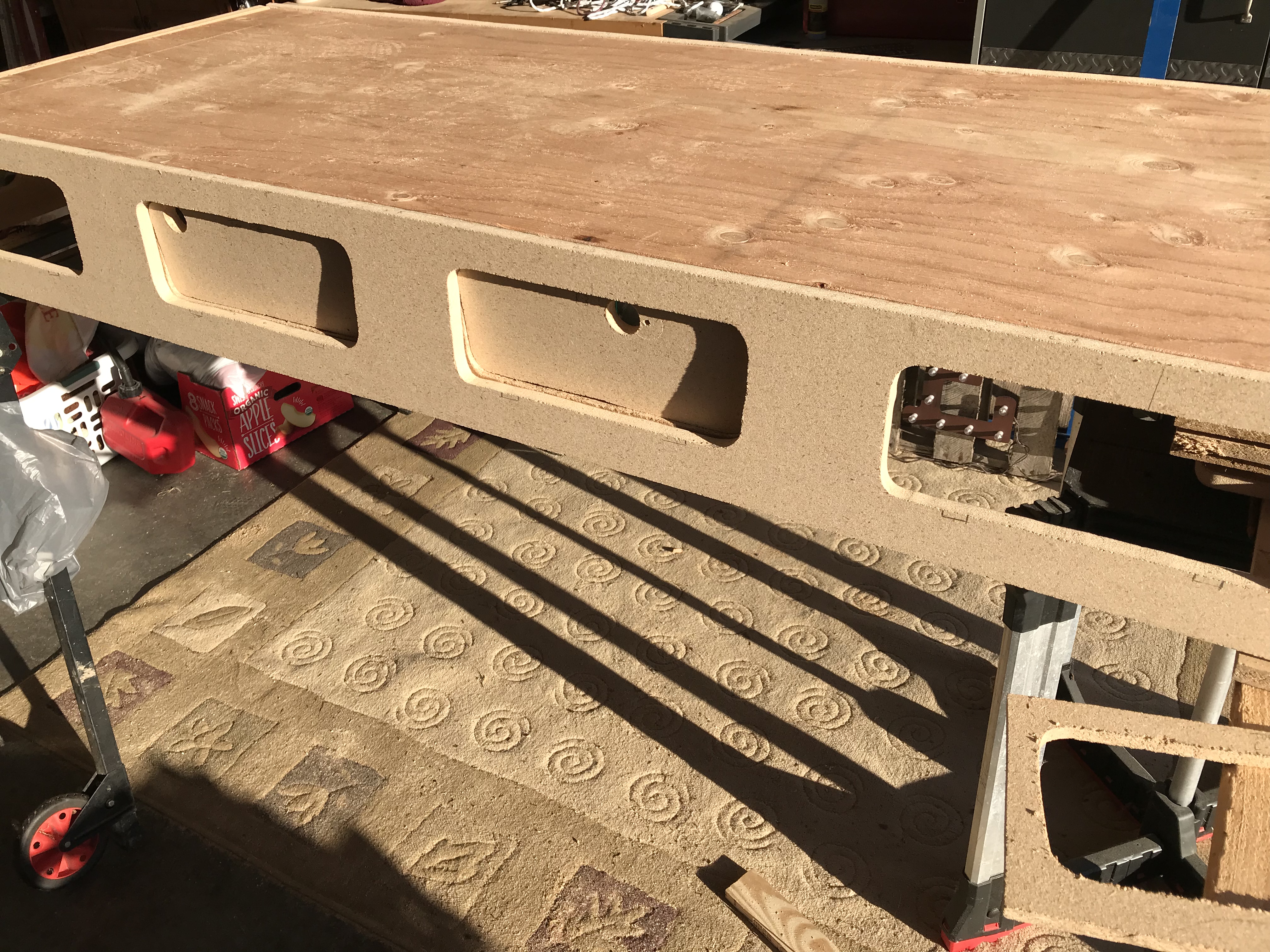

This is the underside (and outside) showing the inside panel brackets after they are secured.

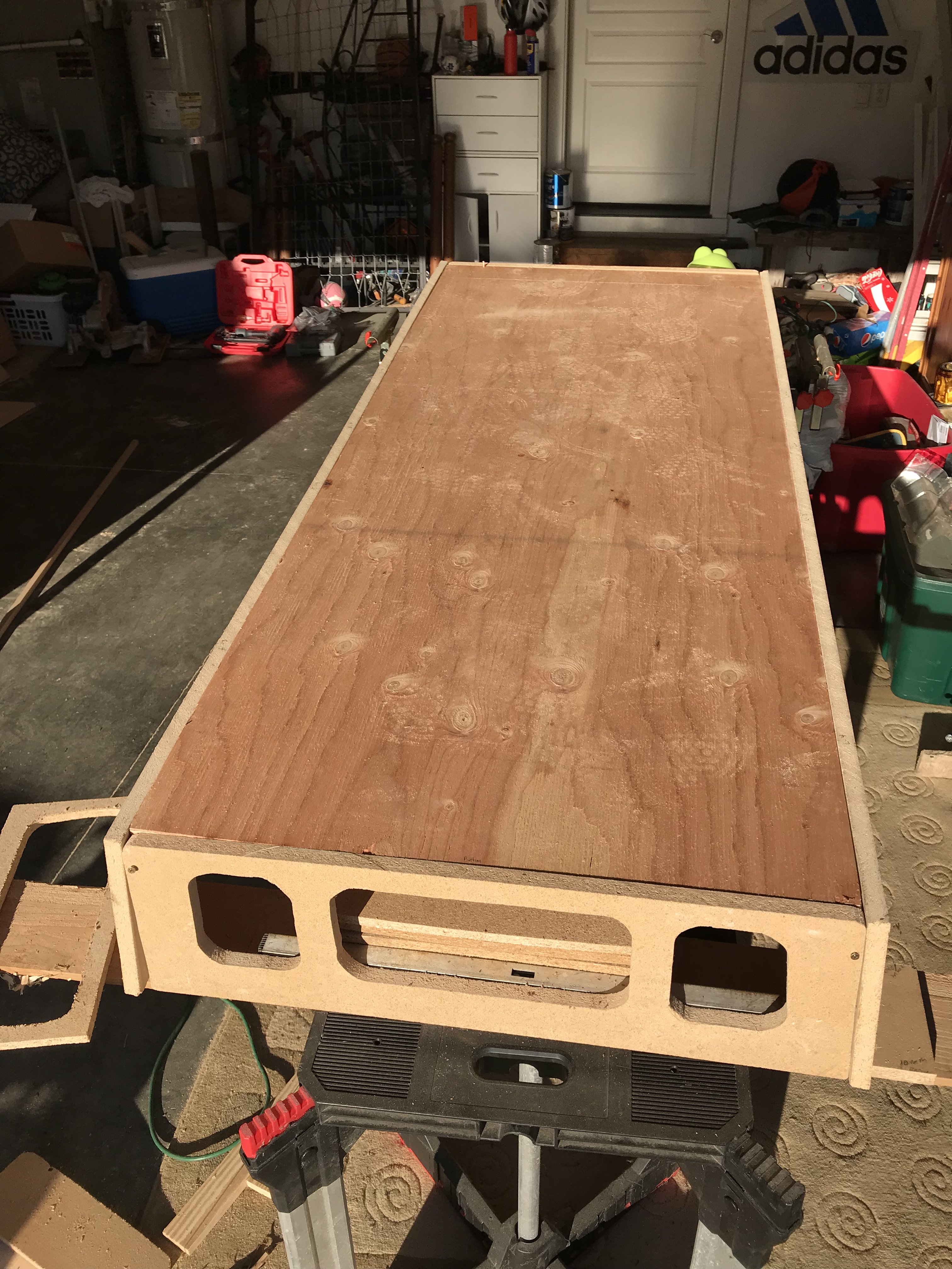

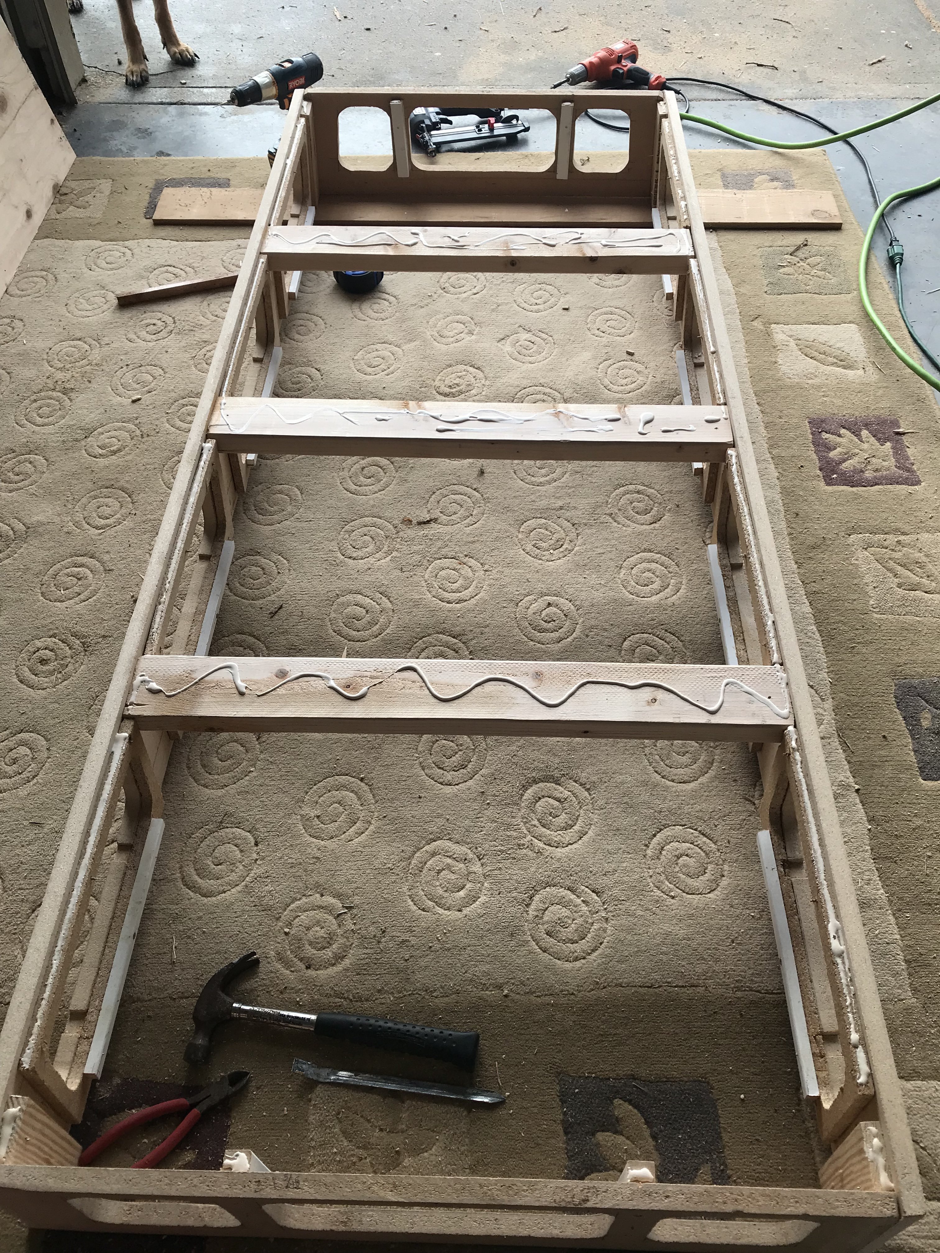

1BD893C1-8F47-4932-9A7A-1F2AAA0E53F3.jpeg 438CD13B-DA14-4423-B072-FDD3562F1E74.jpeg 3E201C3D-EB90-4856-B758-E31BF9E81A4A.jpeg 224E0307-5635-4E12-B88E-1B86EB471932.jpeg 26FDE833-A9E3-446C-81BB-8DB24ECEE450.jpeg
A little more work on the box today. I started gluing everything down and sinking in the screws better. I also finished up the frames for the panels and secured them down.

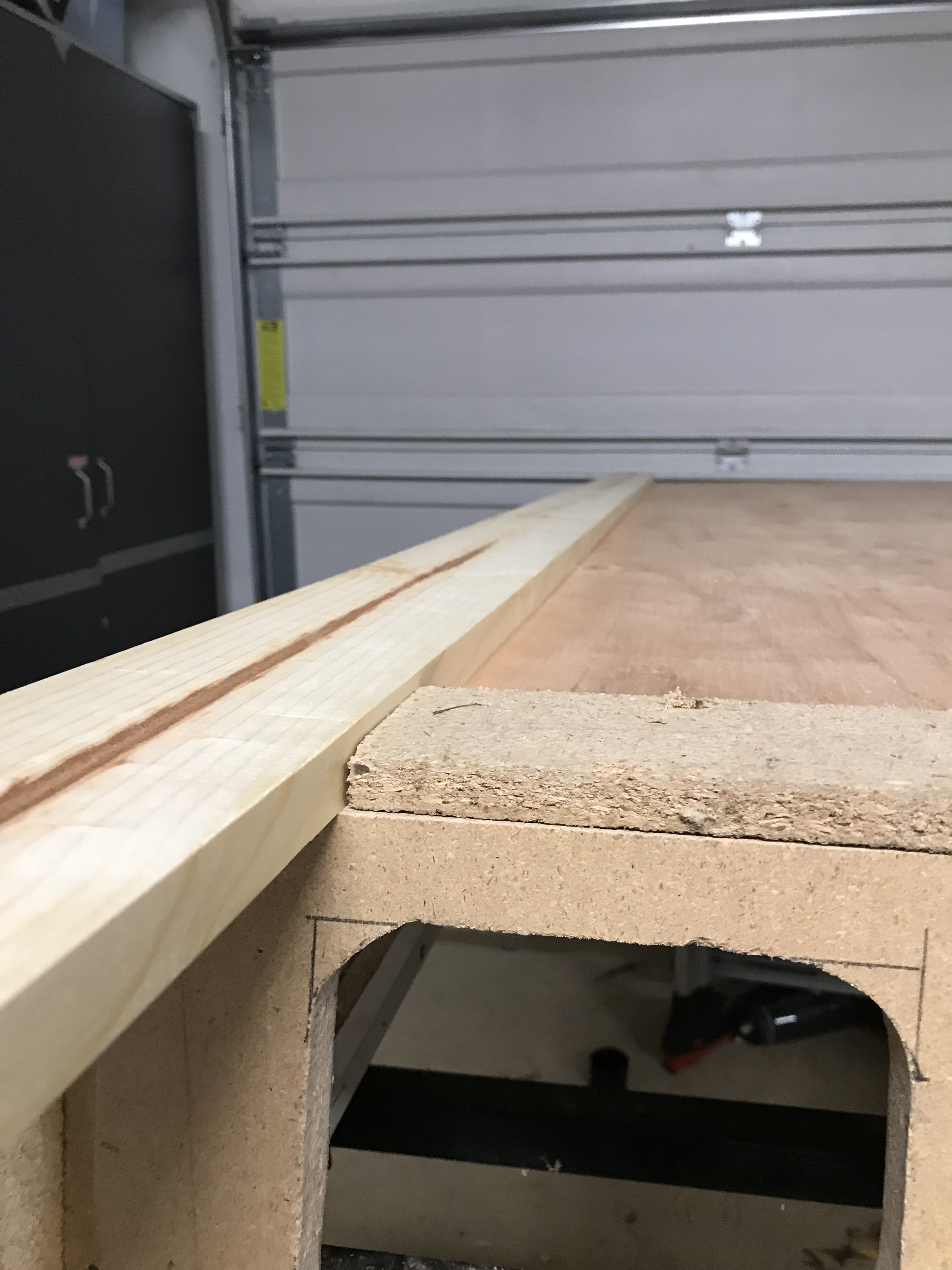

6625E818-36A0-4935-9366-B3A843D4CA21.jpeg 363FD711-543C-46BA-9AFE-7985A07D23F7.jpeg
I’m dealing with a bit of an issue. I could only find precut 3/4” boards for the trim around the HIC. I could cut my own out of 1/2” but I know it will be tough to get them completely straight.
Just got some advice from Zenix saying that I could just fill another flat board 1/4” inside of the trim frame to raise up Han.
This may be the way to go. Anyone else tried another way? I’m wondering if I could plain down the wood trim to make it thinner?

E019C8FA-132E-425E-B9C2-9567239D16DD.jpeg 60D0E778-7CB3-43EA-92BC-27D644AE6709.jpeg
So I decided to make my own trim out of the 1/2” pine board. I was afraid it wouldn’t end up straight and look out of place. It turned out fine and now I have less depth to fill with the glue/Bondo for the Carbonite.
I also routed out the edges. I got this advice from clmayfield and I agree that it makes it look way better.

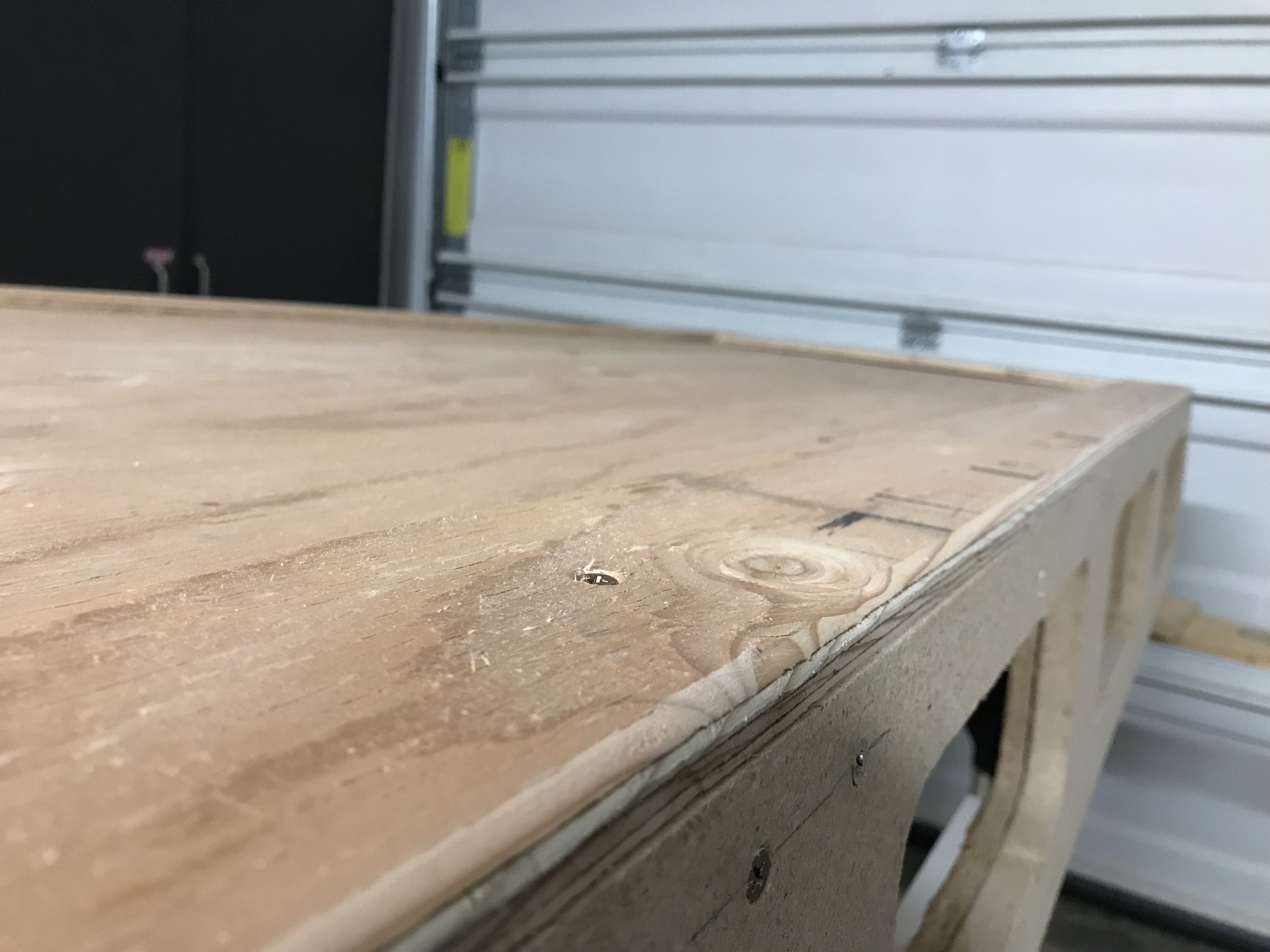

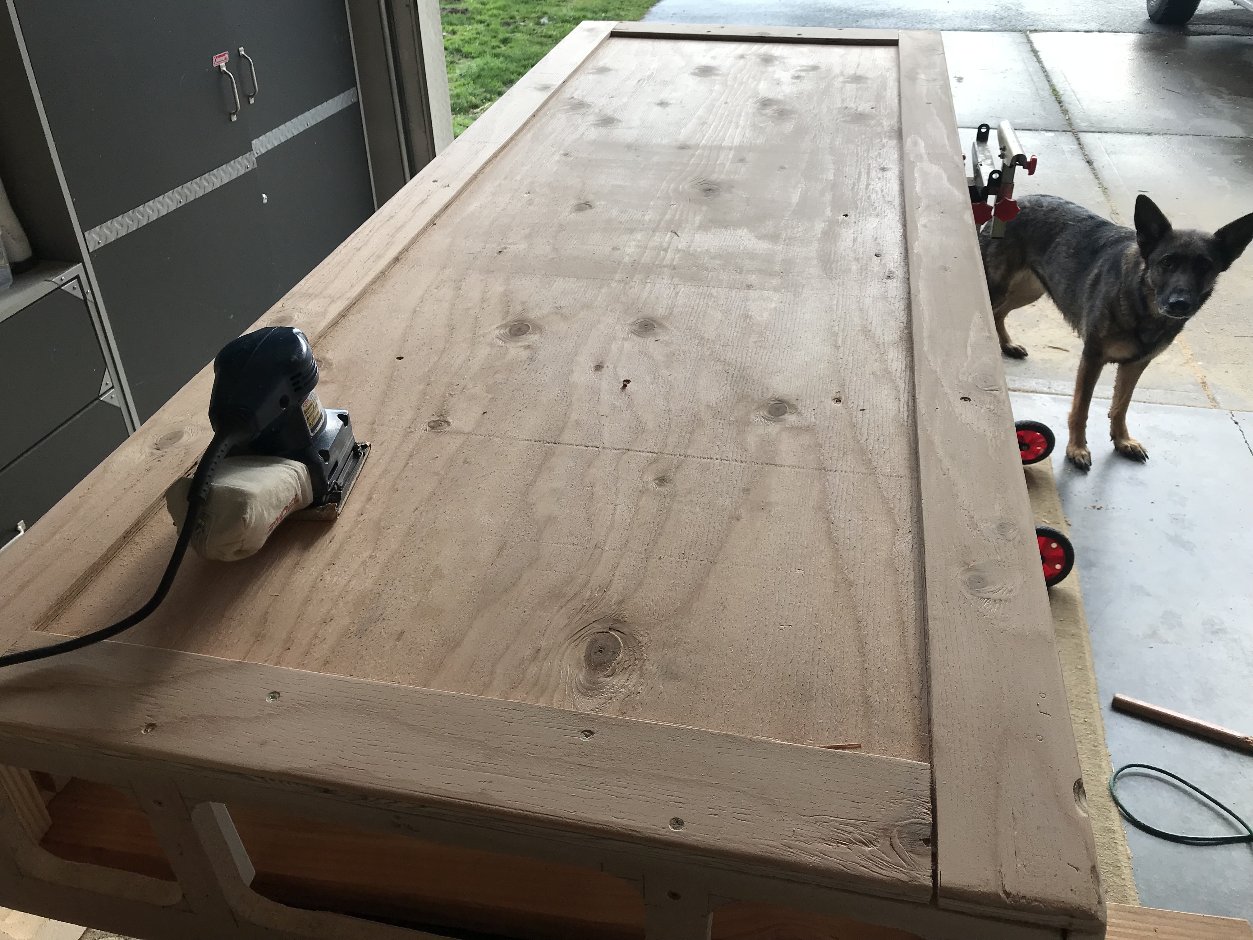

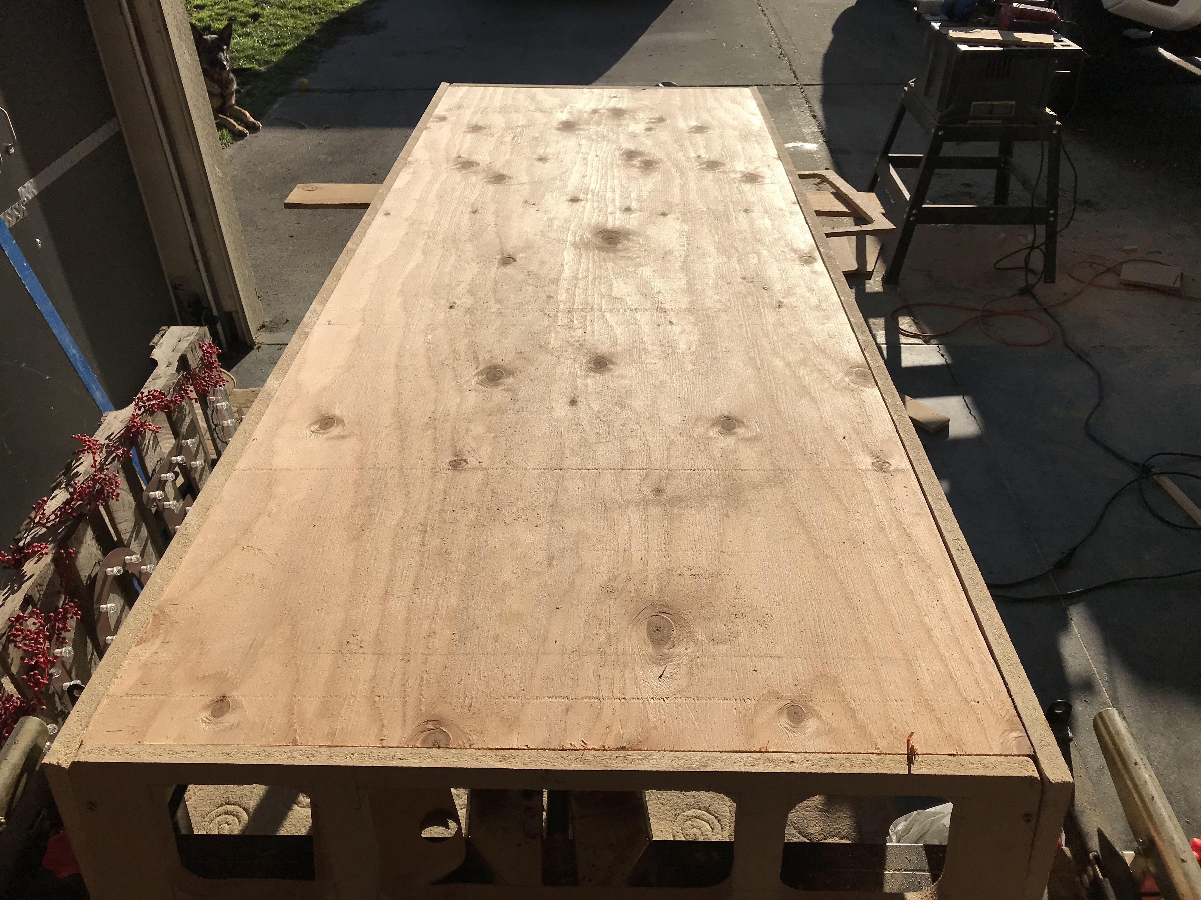

Finally felt good enough about the fit that I decided to secure it all down.
F7D9A161-2A9F-4997-B2EC-45CE8FF43AC1.jpeg 4B30F968-7626-442A-B3EF-E4F34DAD71CD.jpeg F18B38F8-E801-4724-BA5E-9F00B0E82588.jpeg

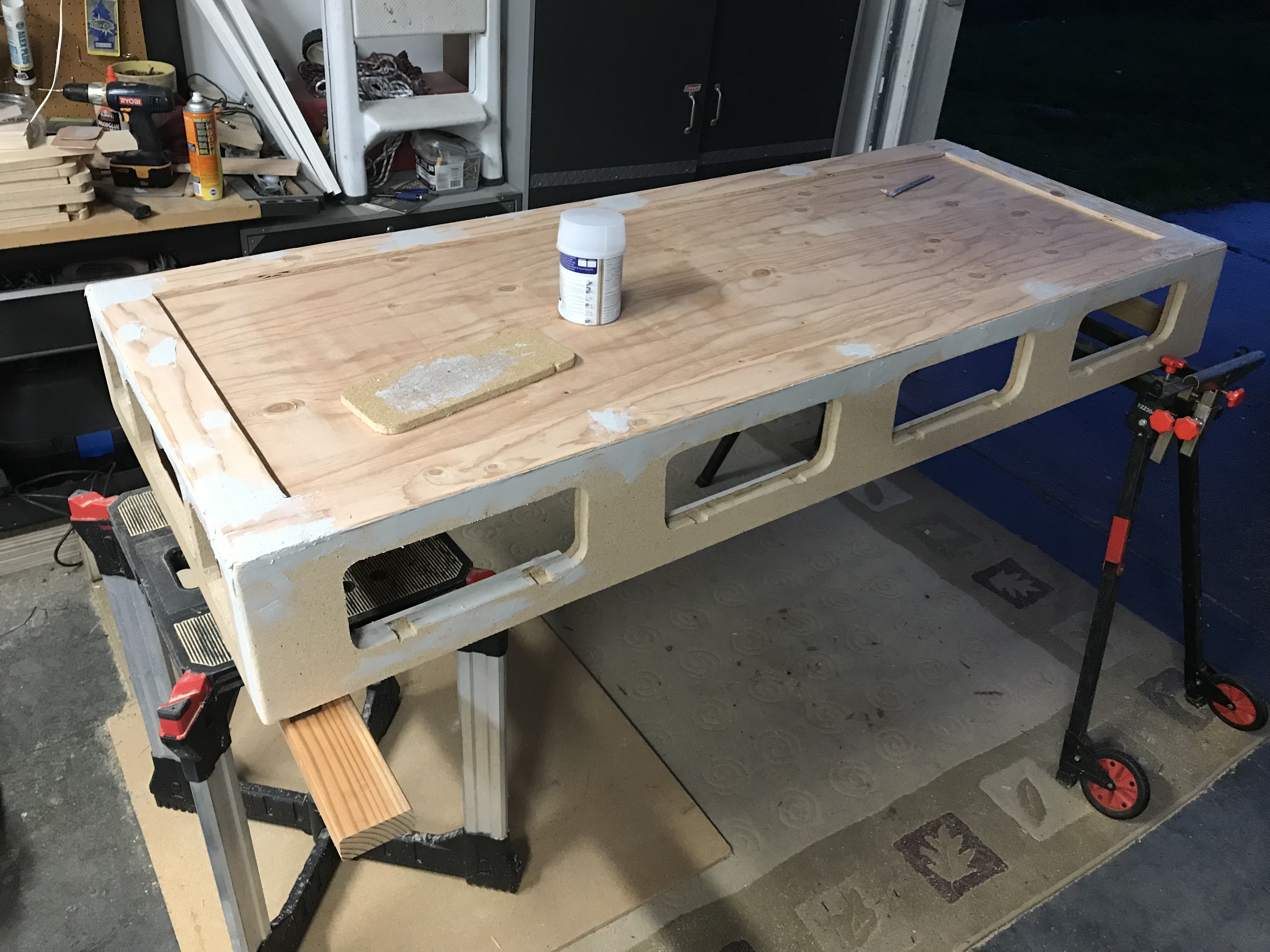

I secured the outside frame as well and start d sanding it down. It’s amazing how much better it looks with just the sanding.
5D019ACD-4505-4220-8669-FE3C3C3C7649.jpeg CD238912-18B4-4D34-8D38-84A224E53B24.jpeg
This is my first go with Bondo. I haven’t done any work with it before. I fell like it’s pretty easy to work with but...... don’t mix more than you need or can get down in about 4-5 minutes. It gets difficult real fast.

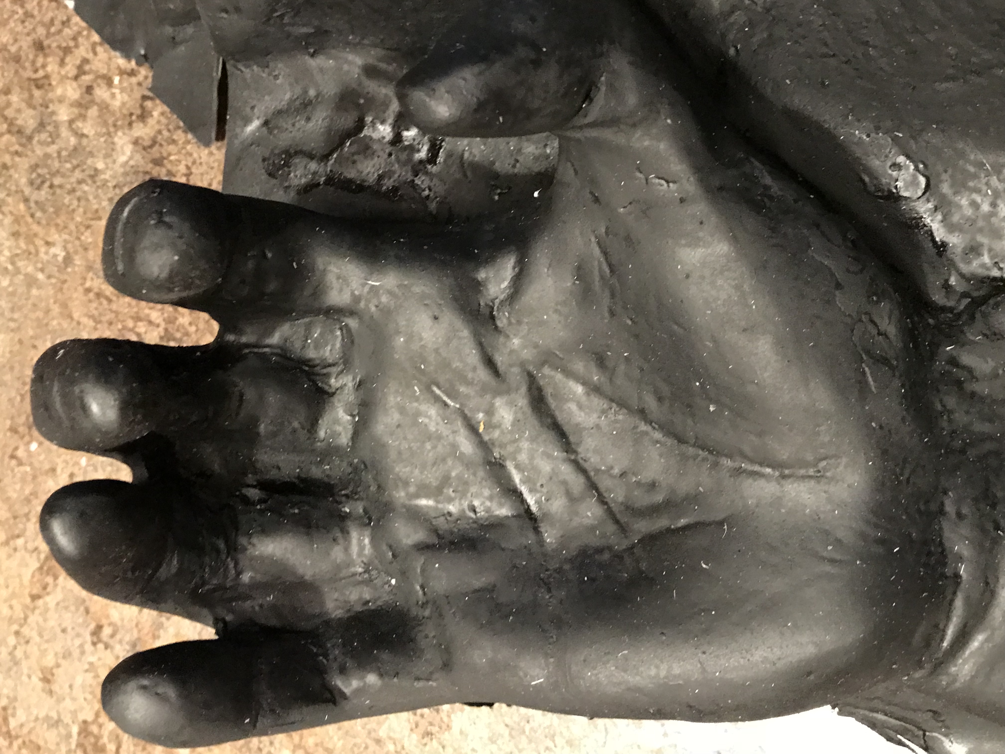

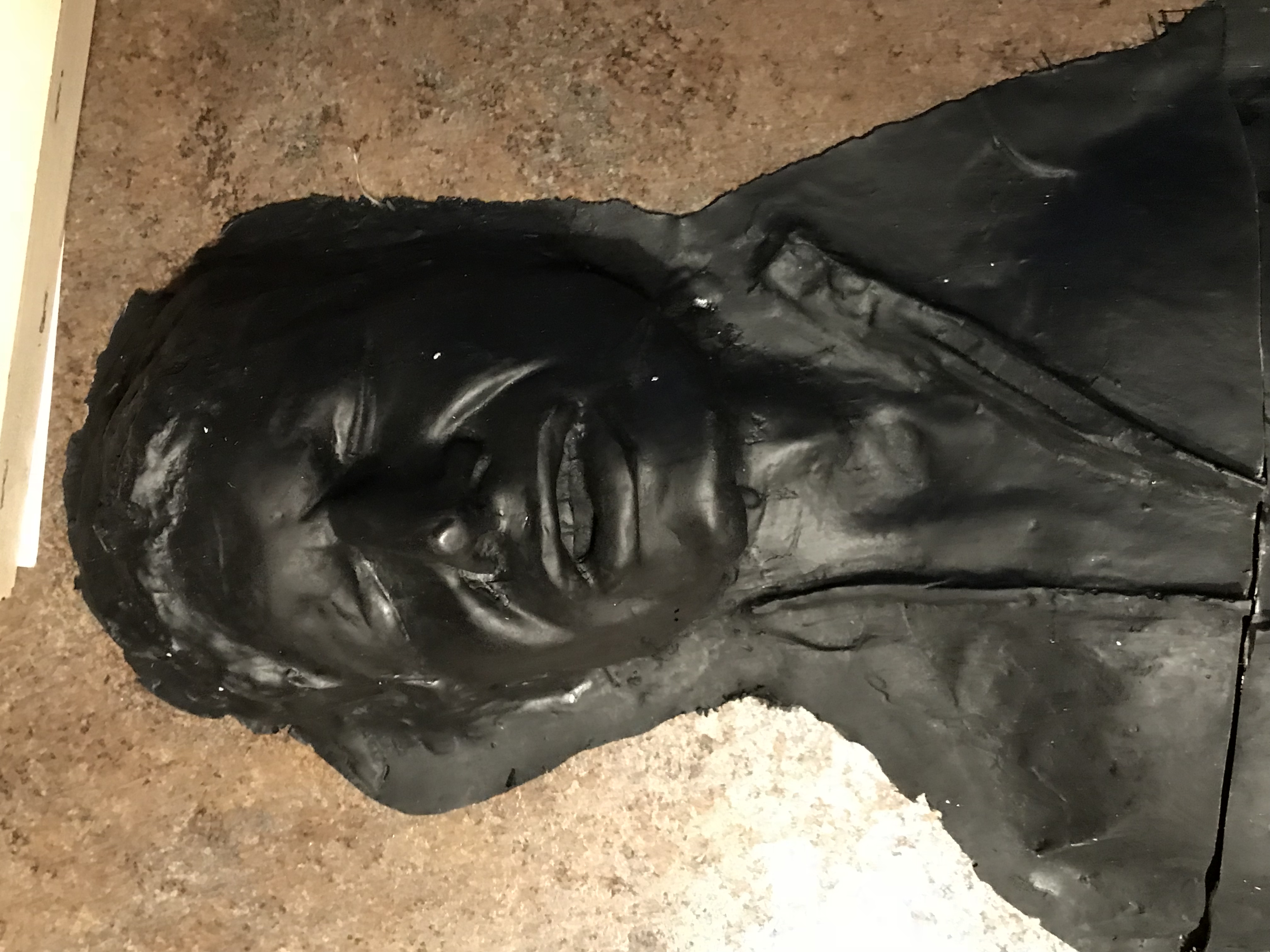

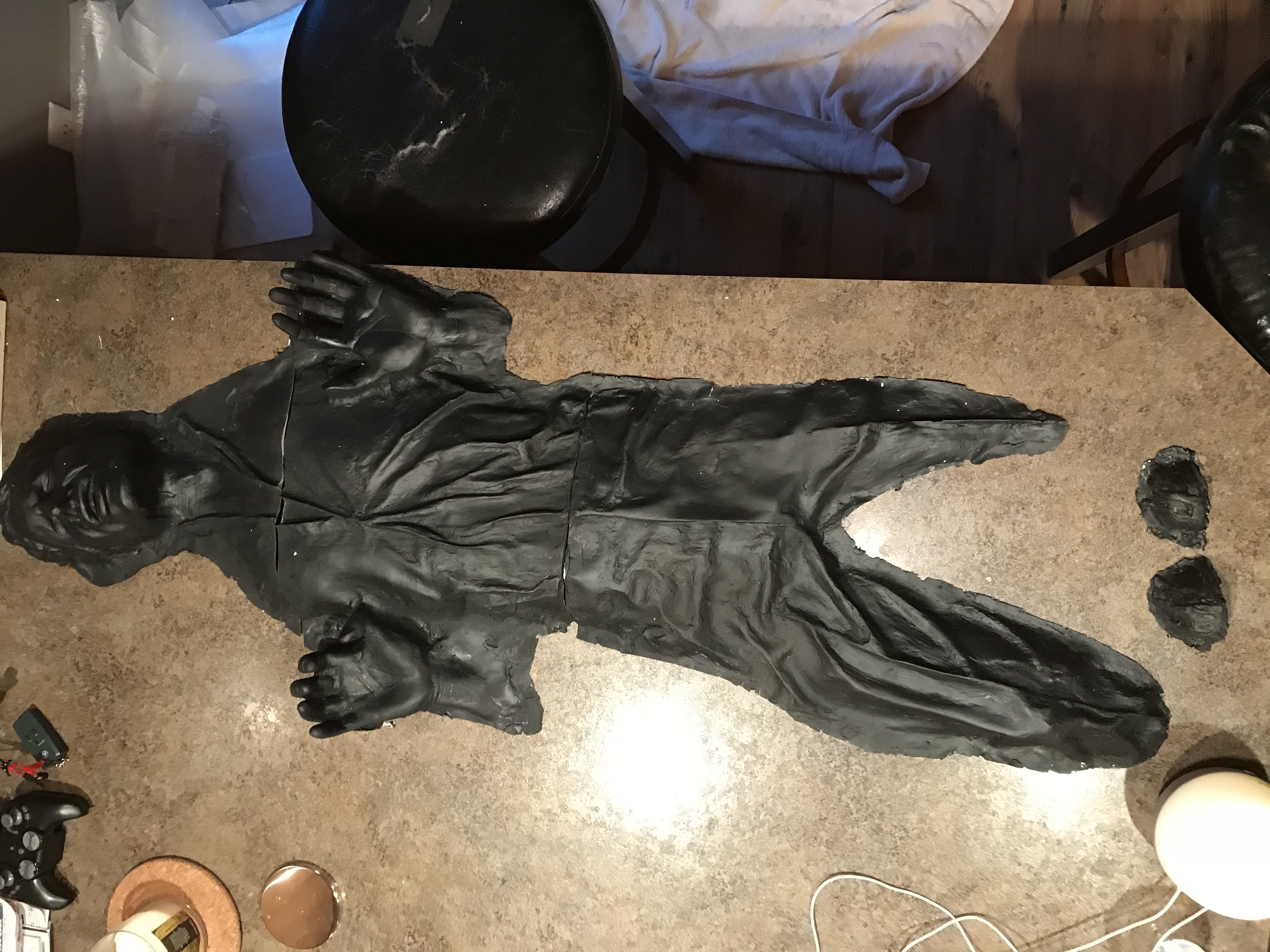

So my Han arrived.
I am am pleased overall with the mold. The face and hands appear to be really well done.
My only concern is how thin the mold feels. I’m trying to decide how to combine the separated pieces and how to secure it to the box.
Any thoughts? Should I use some form of silicone or adhesive and then just screws?
also.... should I use some fill for the back? Like foam? Just want to make it to have a more sturdy feel.
