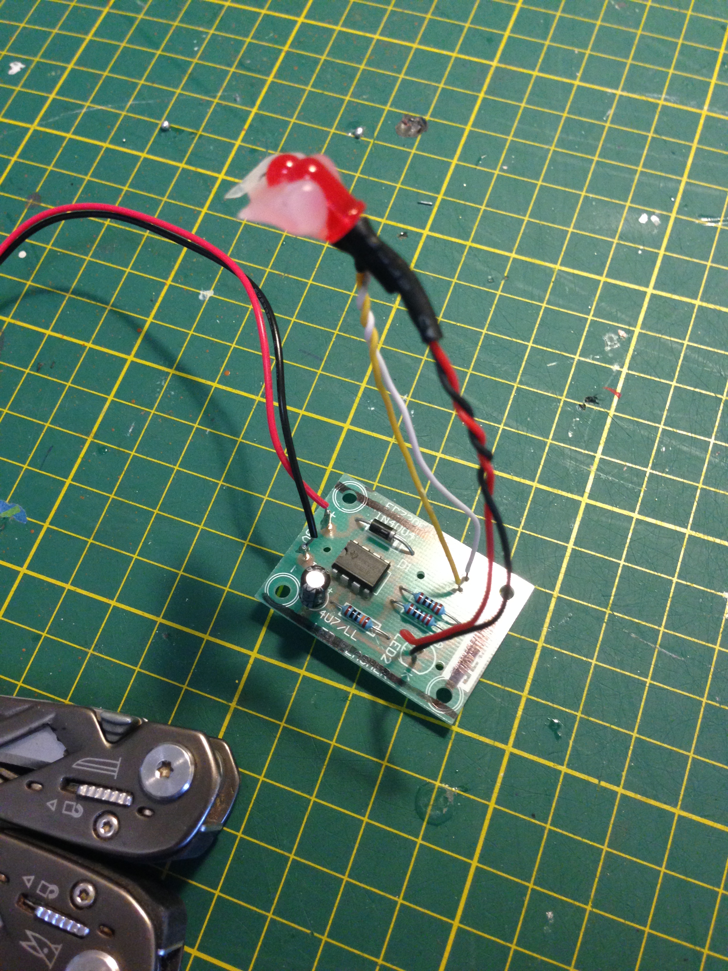

I bought a $8 2 Flasher LED kit from Jaycar Electronics, swapped out the 2nd green LED for a red one I had spare and started on building the circuit board.
I then took it for a test drive running from a 9V battery to make sure it was working.

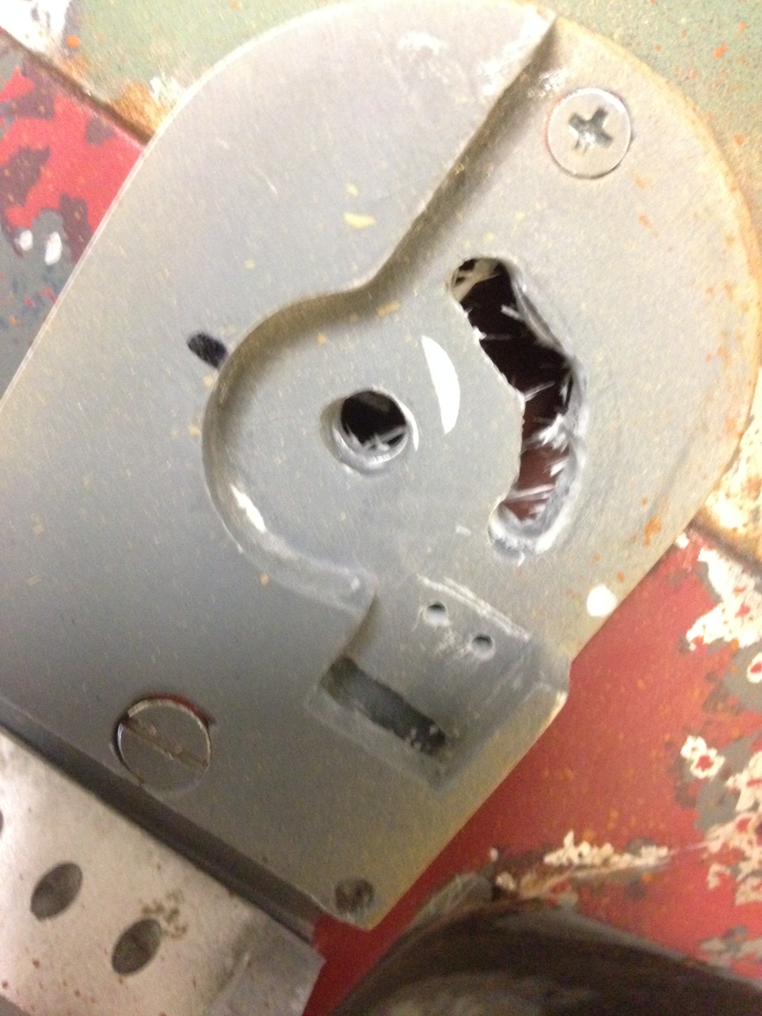

Next stop Dremmel City population me as I had to chop off the sides of the board carefully so It could fit inside the housing of the RF.

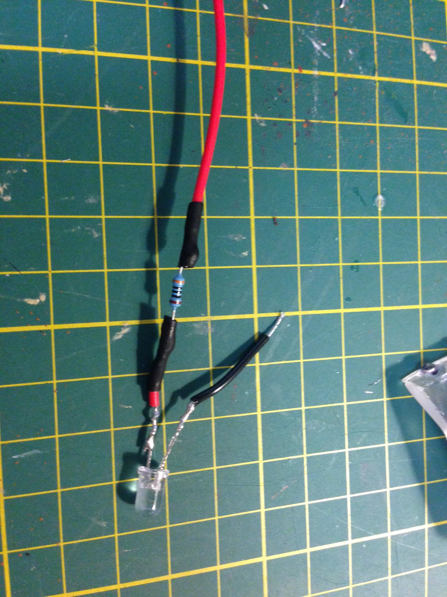

1386.JPG 2x LEDs are then zap a gapped into their respective holes.

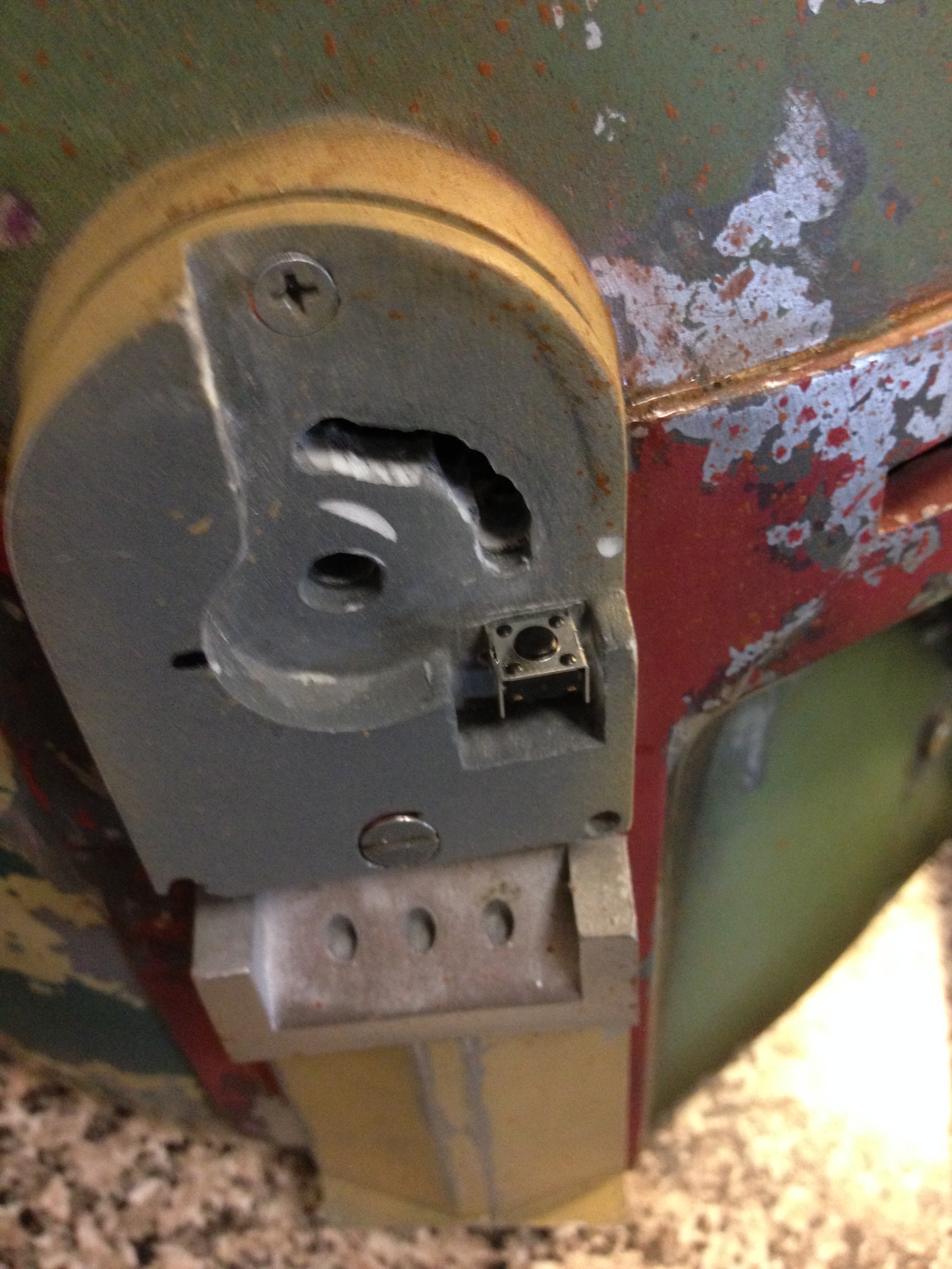

I then made some room for the wires from the hollow stalk to move freely into the helmet where the power supply will live. i also drilled some small holes for the momentary switch that I picked up for $1.50. That is resting on a piece of plastic from a 3.5mm stereo jack plastic cover (not shown in pictures).

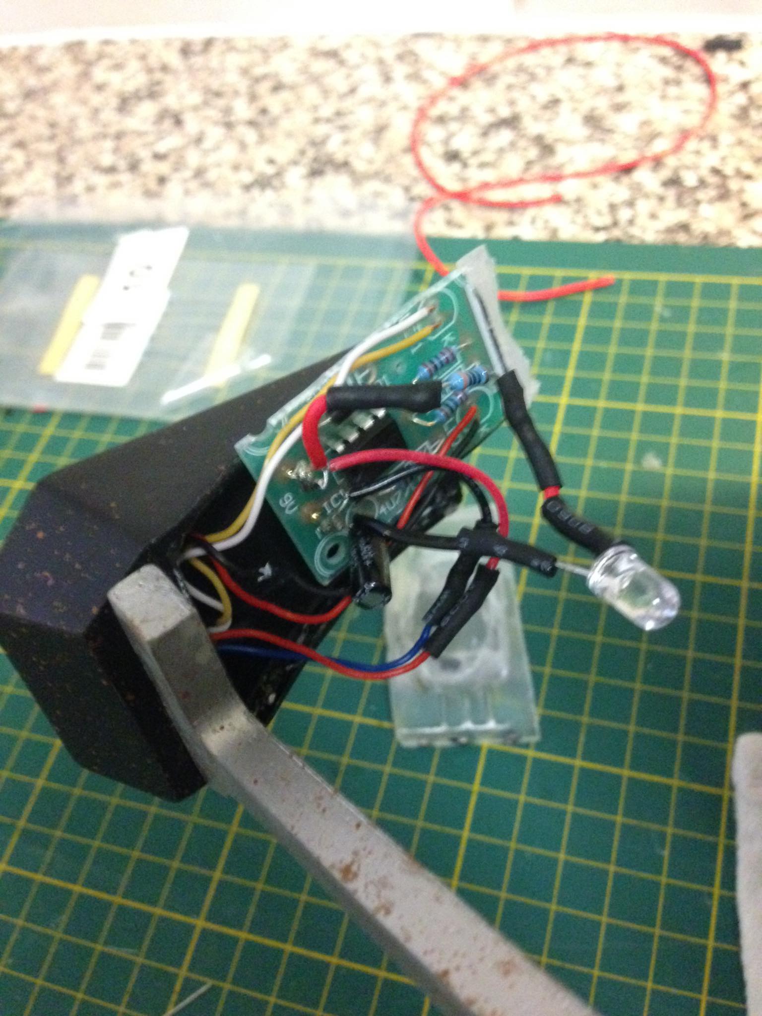

1453.JPG I then soldered and heat shrinked the leads from the LED's to the leads from the 9v Battery / Momentary switch.

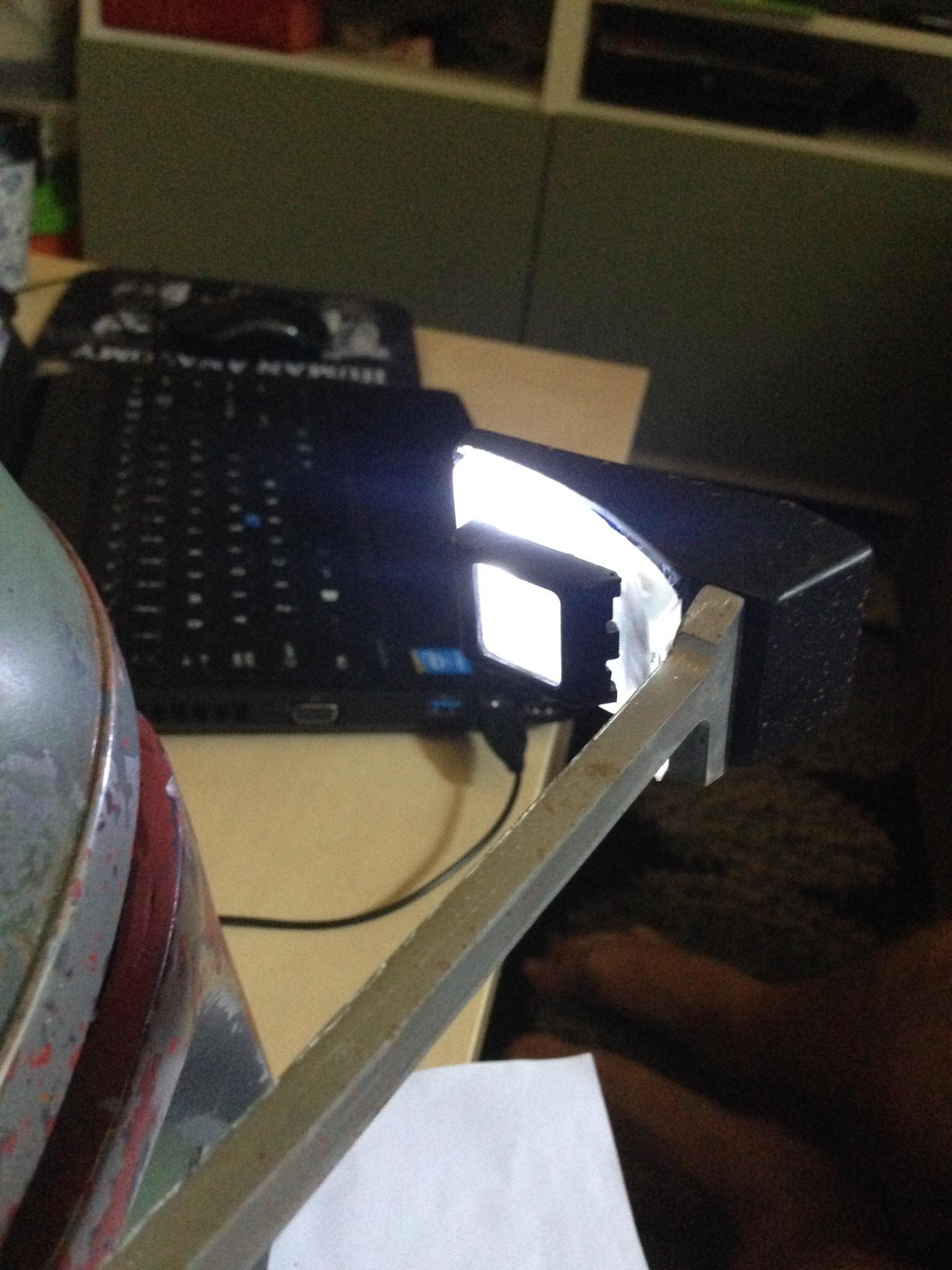

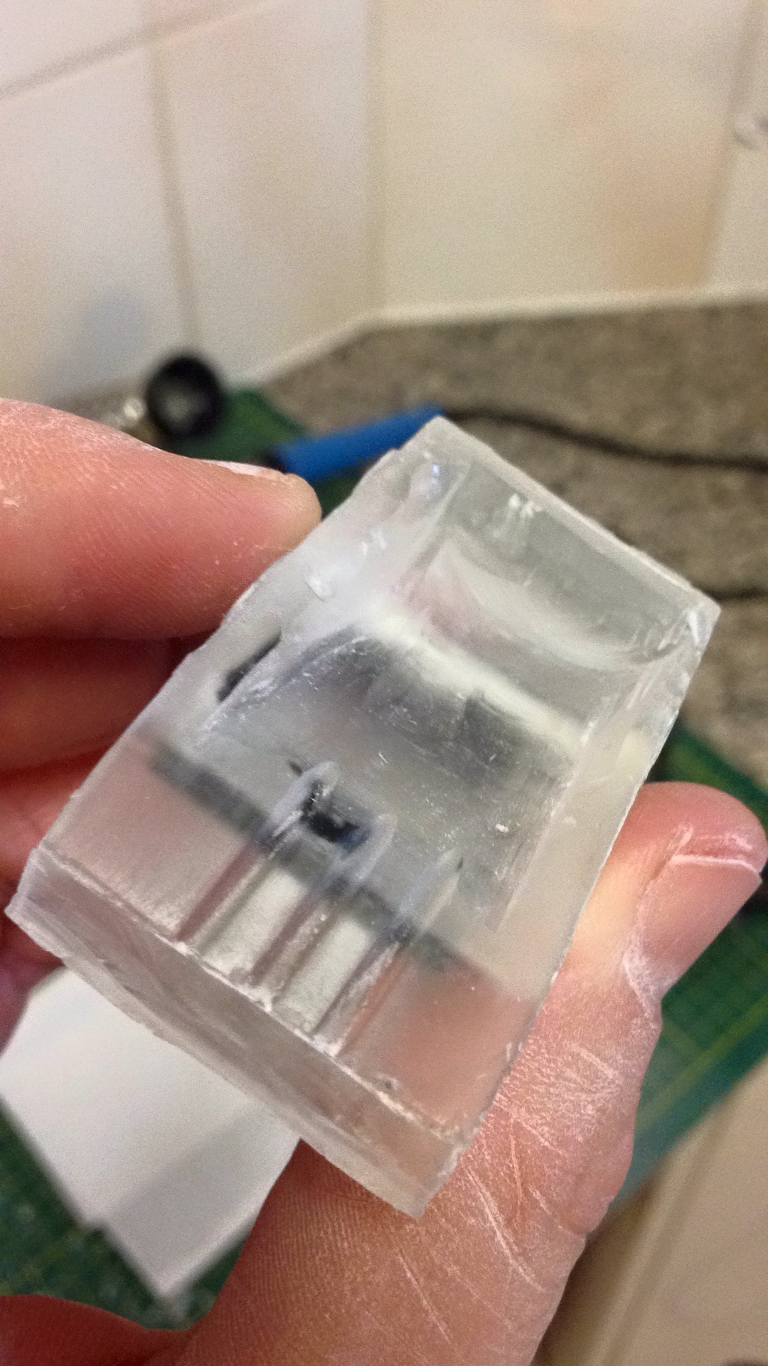

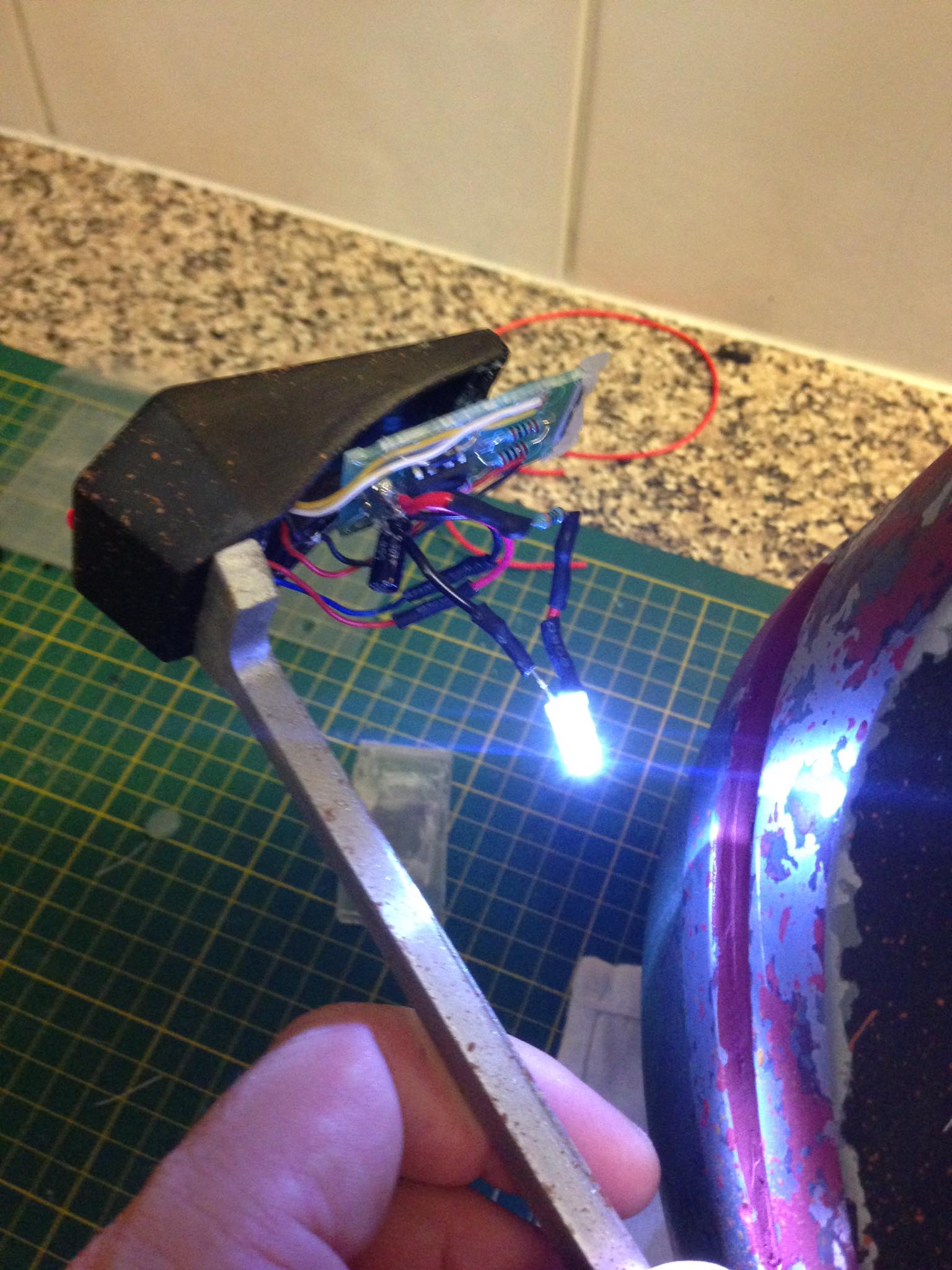

1431.JPG I hollowed out the clear part of the RF topper where I am going to insert a white LED later on once I get one. It currently attaches with small magnets to the RF housing.

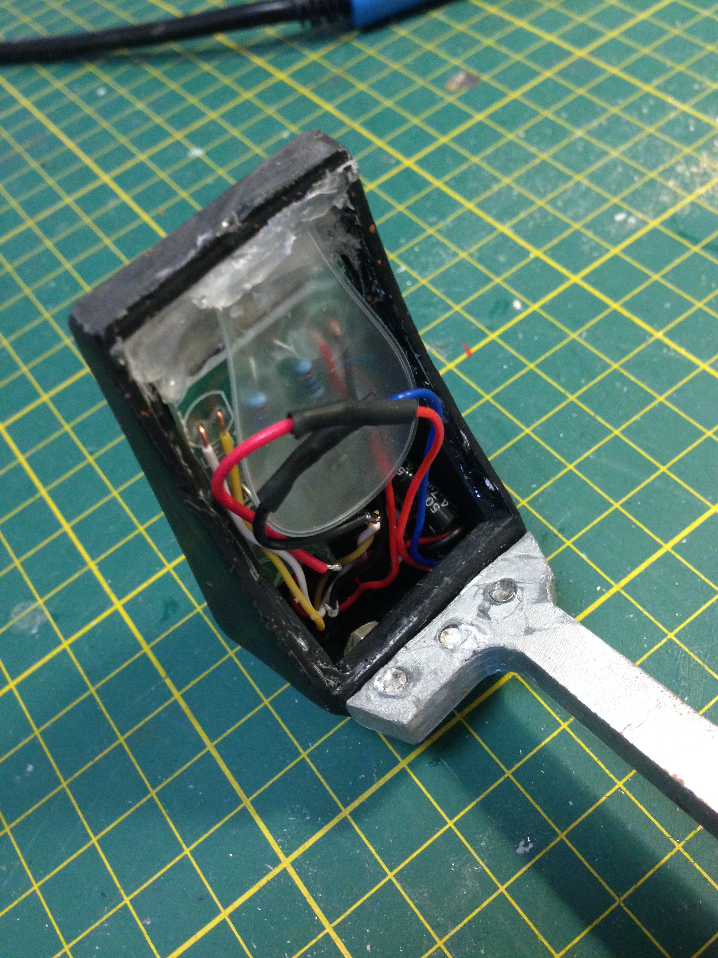

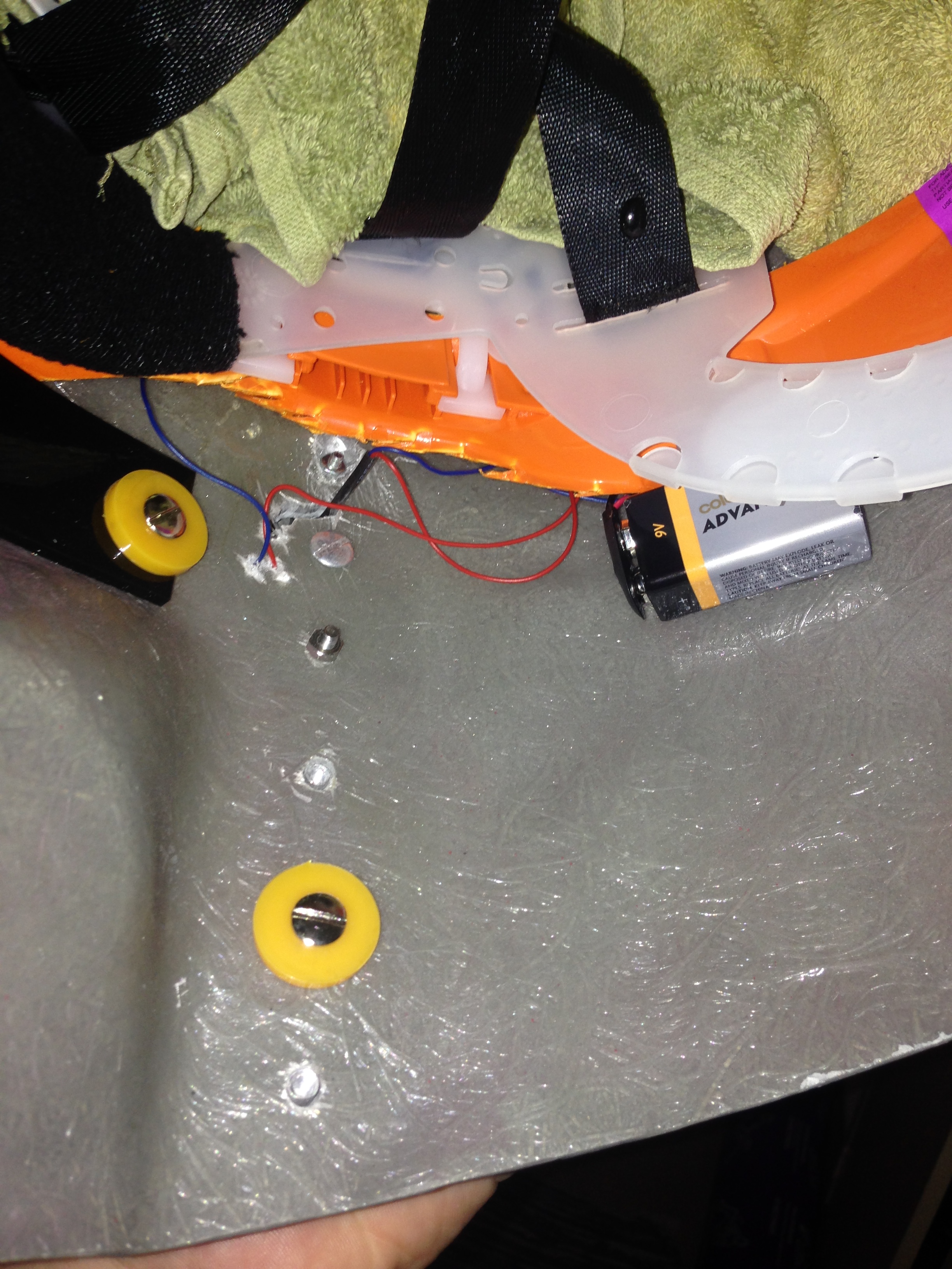

IMG_4454.JPG This is what it looks like from the inside. The battery is held by double sided velcro nicely and does not budge. Fits nicely when I am wearing the helmet.

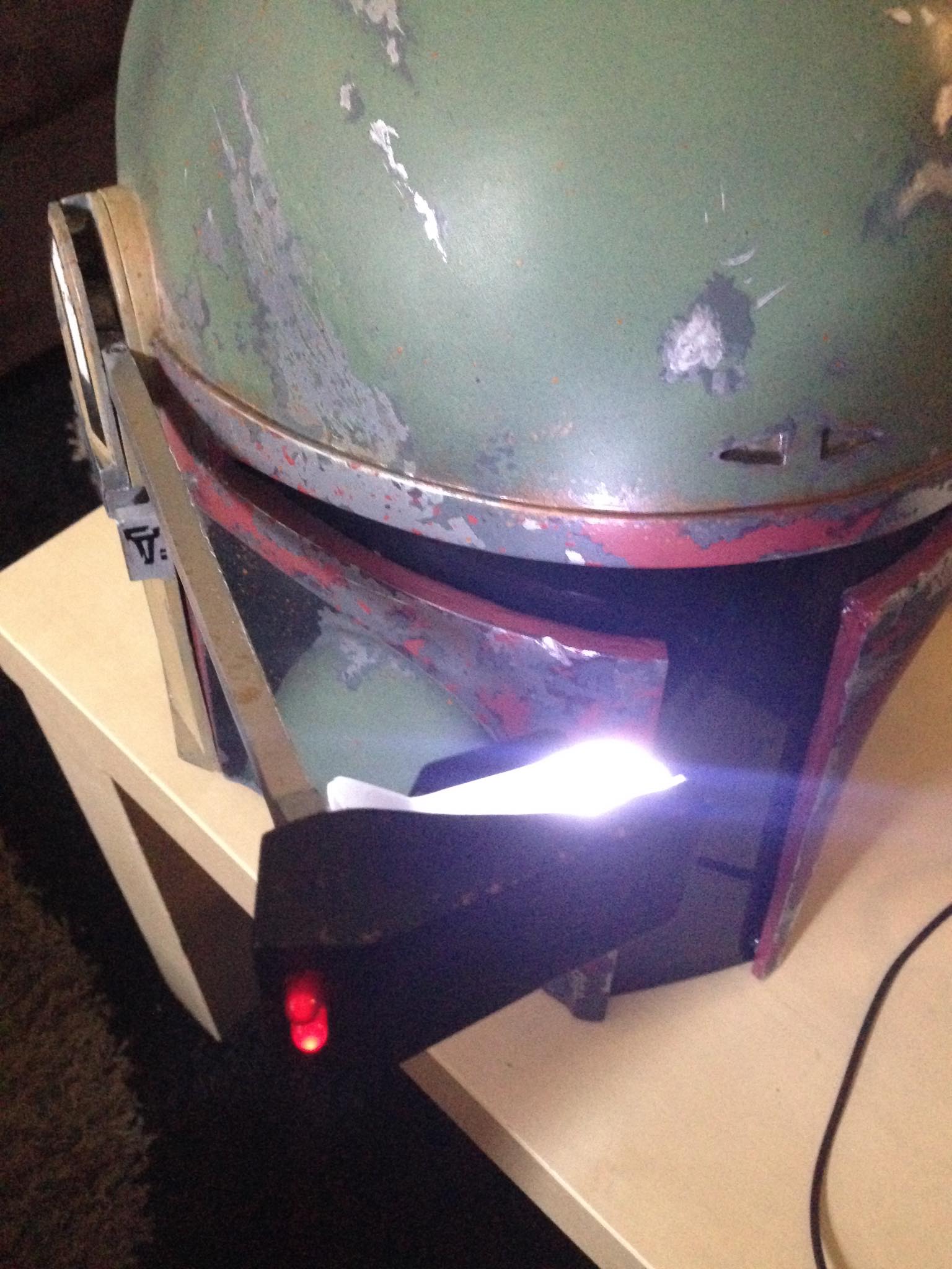

A video of it working
