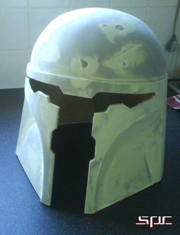

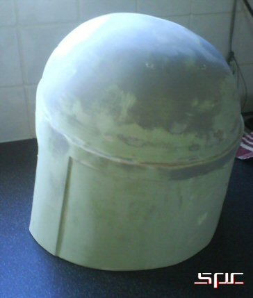

My helmet has come a long way I think. I gave it a coat of primer to see just how near the end I was. There was still filling and sanding to do back to it! I've opted to fill the vent at the back in favour of something more unique or customised, I've also started to add dents and dings to it. The biggest thing is that I've now cut out my visor area! That needs sanding back to the guidelines today along with sandint back the left mandable. Then it should be done and ready for ear pieces.
Here are some pics:

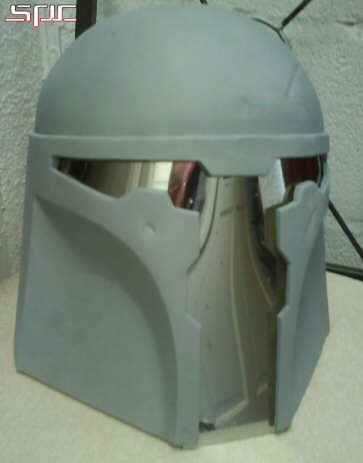

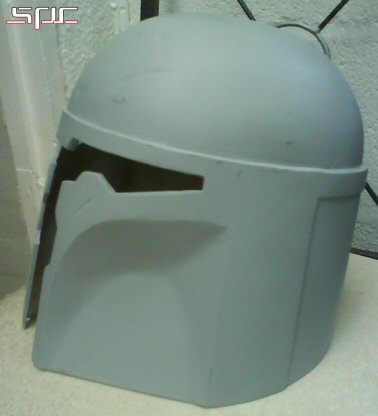

I've finished sanding the helmet down and everything is now smooth, except for the dents I've added. LOL! It's primered and I've even had time to make and install the visor!!

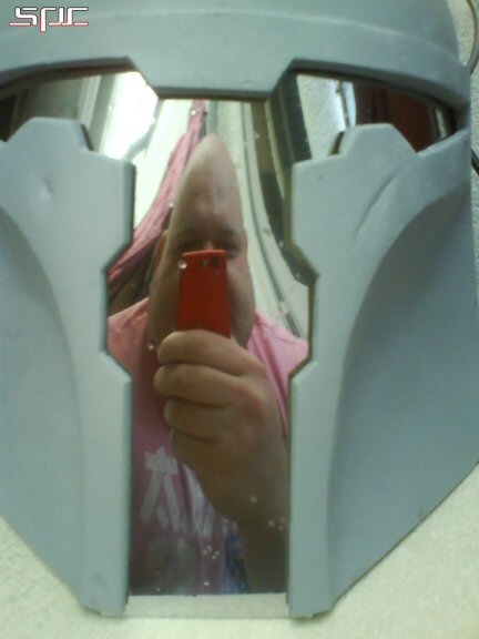

I love it! Got quite the kick out of wearing it too with the visor in. I do need to recover the visor though as the film I used has a few bubbls in it. I should have taken my time with it.
Some pics:

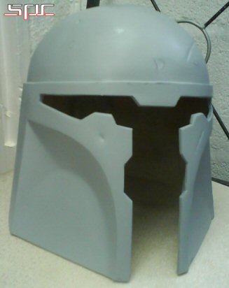

And here's the visor!!
That looks simply amazing, bro! I really really like mirrored visor, and the almost halo-esque shape to the visor opening. If I could ask, and I'm sure alot of people would love to see this as well, if you could do at least a brief tutorial on your method of fiberglassing, because yours turned out GREAT. Do you have any pictures of the glassing process?

*the pic of you in it tho* not very flattering bruv? :lol:
Believe me bro, that's an improvement! LOL Kiddin' of course!
Thanks both, I'm glad you like it! As for fibreglassing pics, I'm afraid I have none, though I could photo the inside later for ya. I started glassing the dome first as that had to be reinforced the most. Then just spiralling around and down to the bottom. Though I paid alot of attention the the mandables and just the face area in general as I knew this would become very bendy when the visor was cut out. That part of my lid is around 5mm thick give or take.
I posted pics of the filler stage though, you'll see I worked in sections. Dome, face, ears and trim, cheeks, back, and then the mandables. Touchine up the prvious area as I went.

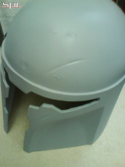

@ Mckenic, The darkest areas you see on the dome are where I used my Dremmel to grind out filler to make dents along with a sort of gash or slash sort of mark. The grey is just primer.
So the helmet hasn't been built to look new, I'll add to this with paint effects when I get to that stage.
