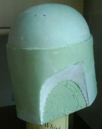

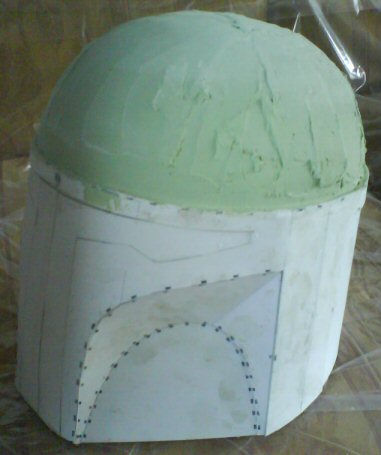

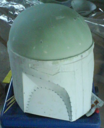

EDIT: Just a quick pic update. I'm further along than this now but forgot to take my phone the last time I was out sanding. The pic is just a quick show of the filler on the dome. I'm uploading it mainly to show any new people to the technique how it looks through the various stages.

I've sanded more of the dome out. It's coming along really well. I'll need another pass over with the filler though, just skimming it really.

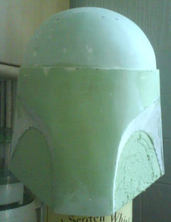

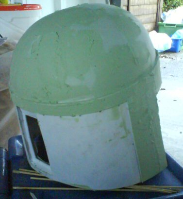

I've sanded the dome back as far as I dare now. I've skimmed it over again too to fill the odd dips and what-not, and to smooth over some uneven bits. I took some pics:
I've also started to smooth over the face too. I'll be leaving it overnight now and I'll be back at it tomorrow morning.

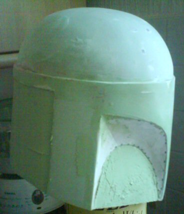

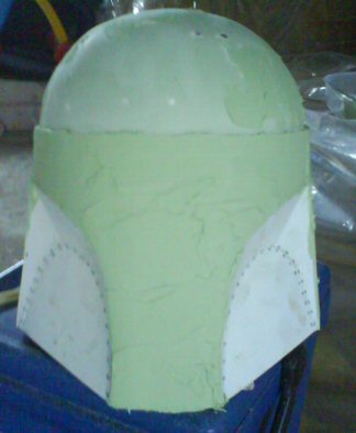

Update on my helmet again. I had a wee problem this morning, the filler hadn't set as it should when I left it lastnight. It was still really soft, I'd failed to mix the hardener in thoroughly so I had to scrape it all off and start over. :(
Still, it's all done now and looking pretty good IMO. I spent alot of the time sanding the dome, it's getting there but still needs more work tomorrow. The face is good now, nice and smooth and I finished off by filling in the cheek plates and the rear. Tomorrow I'll be sanding that back too.

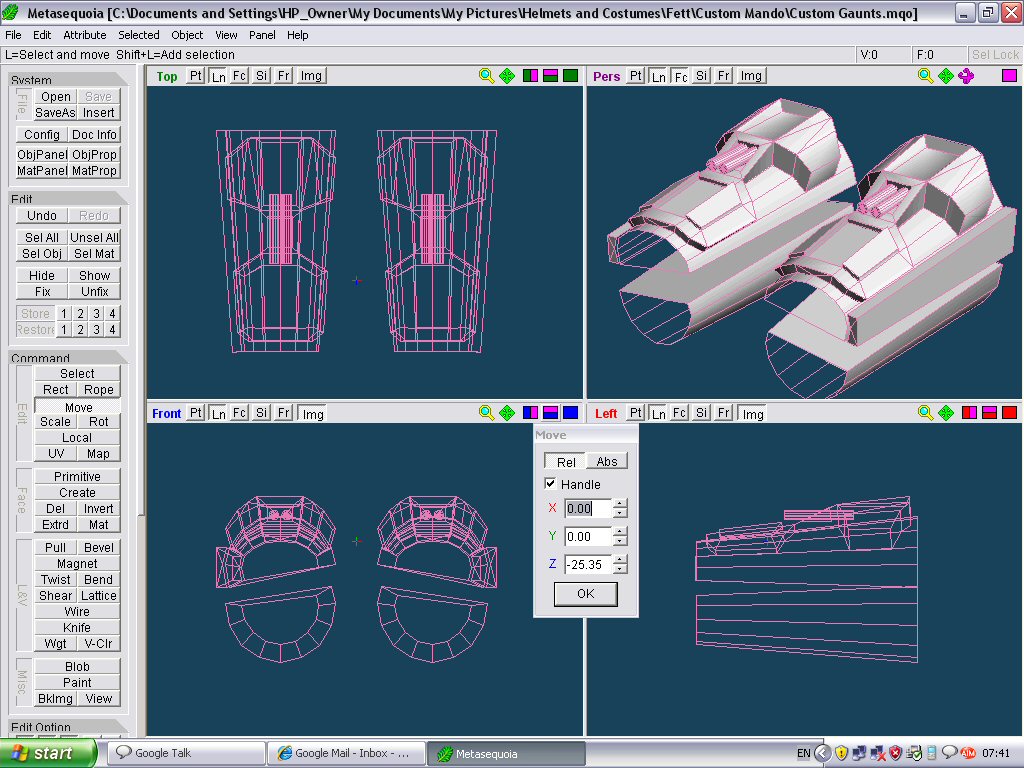

Here's a screen cap of my Gauntlet design. I just modelled this as I went, I didn't draw a rough sketch or anything before hand.
I like them, and last night I was thinking about using them for both arms but now I'm not so sure. The cylinders you see are just to represent some sort of launcher tube or barrel. and the block on the outer side of each gaunt will be a mounting bracket of sorts for various weapons. I've not designed those yet.
I was wondering if I might get some opinions as to whether I should use them for both armos or just one? OR even if they just don't fit in with the SW look? That thought has crossed my mind a few times now.
Any feedback is greatly appreciated guys. :

The gauntlets look really nice, as for 'fitting-in' with the SW scheme it's totally a persoanl choice? With Boba / Jango we're pretty set on the gauntlets and what they look like.
With a custom it's pretty much what is in your imagination...
'Personally' I'd probably go for 2 different types for diff ranges of weapon attachements? ;)
I'm thinking that too. Though maybe the same base gaunt, with two different attachments on the mounting block? That's why it's there to mount different weapons.

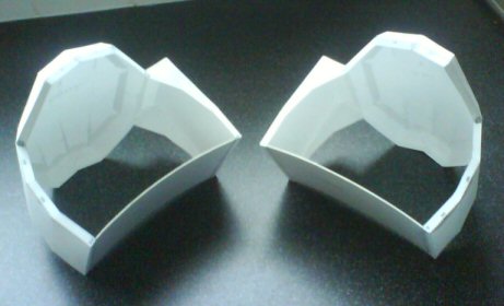

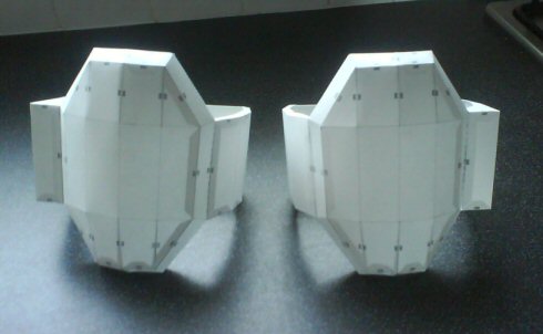

I've started to build my armor today. Just the knees but I wanted test my scaling to make sure the rest would fit me. Luckily I got it right the first time and it should all fit me. :)
I'll be glassing and smoothing tomorrow.

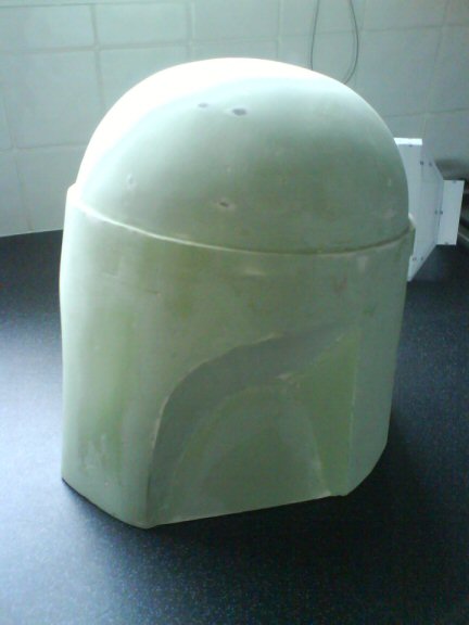

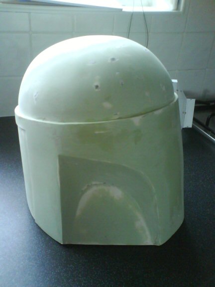

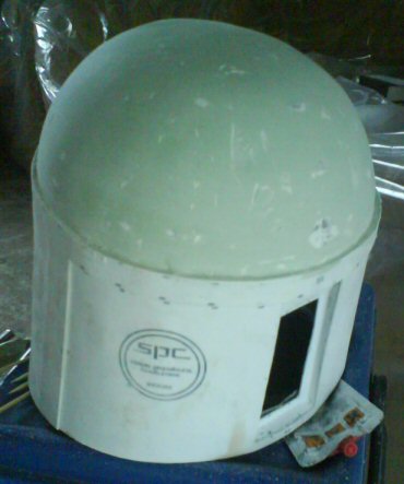

Anyway, I left the helmet with the mandables filled and half sanded. It's nearing the end now but looking pretty decent I think. I've now got some T-nuts for fixing in the visor. I'm going to alter the design for the shape of the visor too to fit my charcters look more than the previous visor I had in mind.
Here are some pics.

I like the gauntlets but I dont like the symmetrical aspect. I like the wrist end though, maybe make the elbow ends slightly different.
Yeah, I've stopped work on the gauntlet models. I liked them but I'm not sure if I liked them enough. I may rework them.
