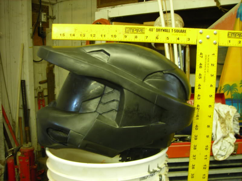

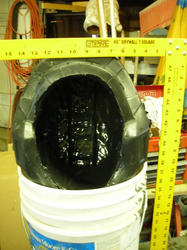

I'm in the middle of a run of Halo helmets using this exact same method.
The trick is, using a bit of trial and error, you will eventually figure out how much resin you need to pour into the helmet so that there is no excess to pour out and waste. For example, the helmets I'm making are rather large and I'm mixing batches of about 8ounces of liquid resin per layer. I end up putting in four to six layers to build thickness and, depending on what I add to the batches of resin, the final castings will end up as much as 1/4" to 3/8" thick. I wouldn't want to play football in these things, but they do hold up to a reasonable amount of abuse.
Also, look into what're called "thixotropic" additives that make the resin a little more viscous. That way, you can build thicker coats each time you pour. I usually add microballoons to the first layer to make an easy-to-sand surface and then mix in silicates or glassfiber in the next few layers for strength.
There will be some irregularities inside where the resin cures in drips or rivulets (or full formations of stalagmites and stalagtites), but they can be easily fixed with a dremel tool or an angle grinder with a flapwheel sanding disk. Here's the best pic I've got of the inner surface of one of my castings:
Before anyone asks, here's a shot of the outside of the same helmet:
