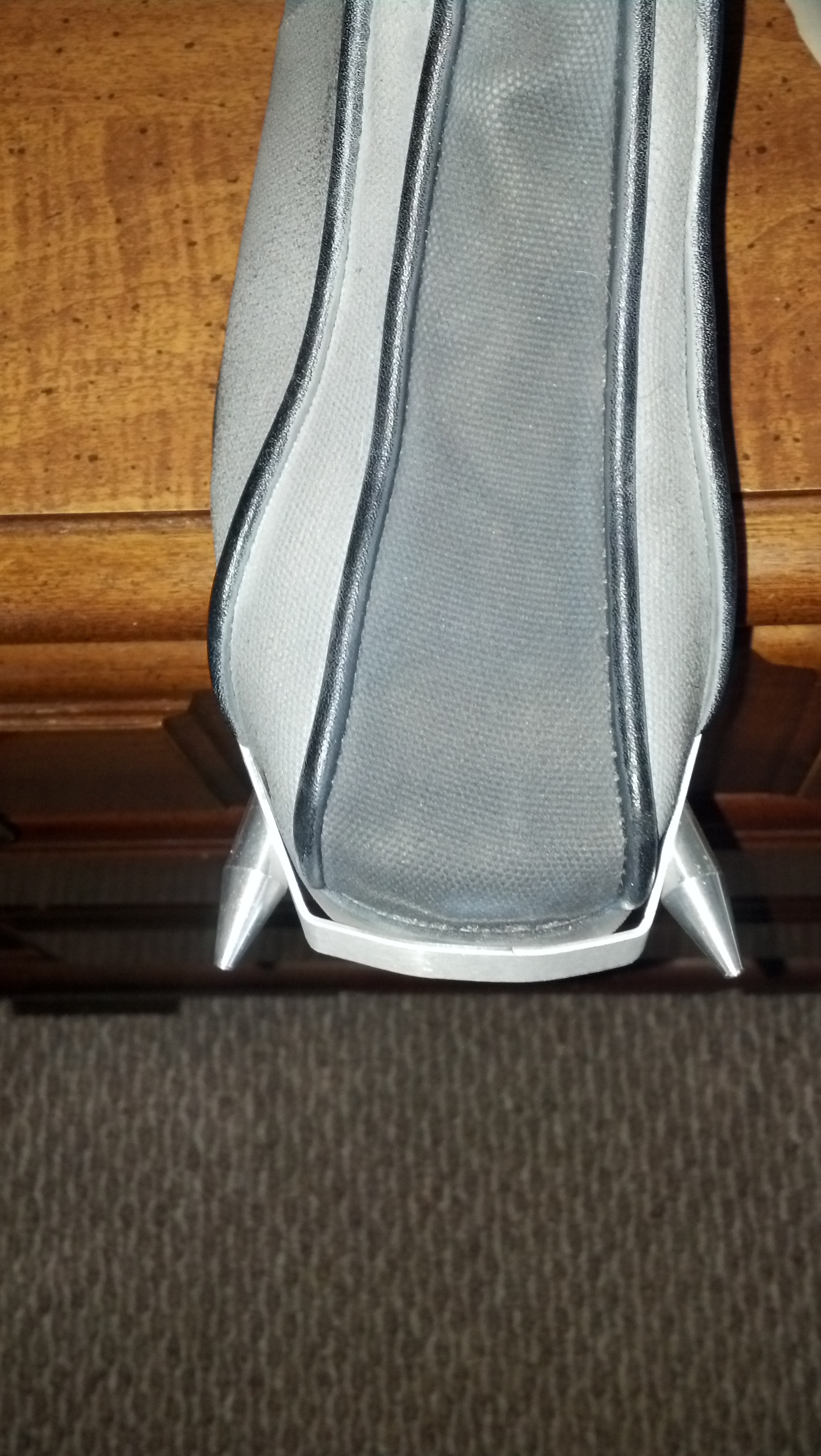

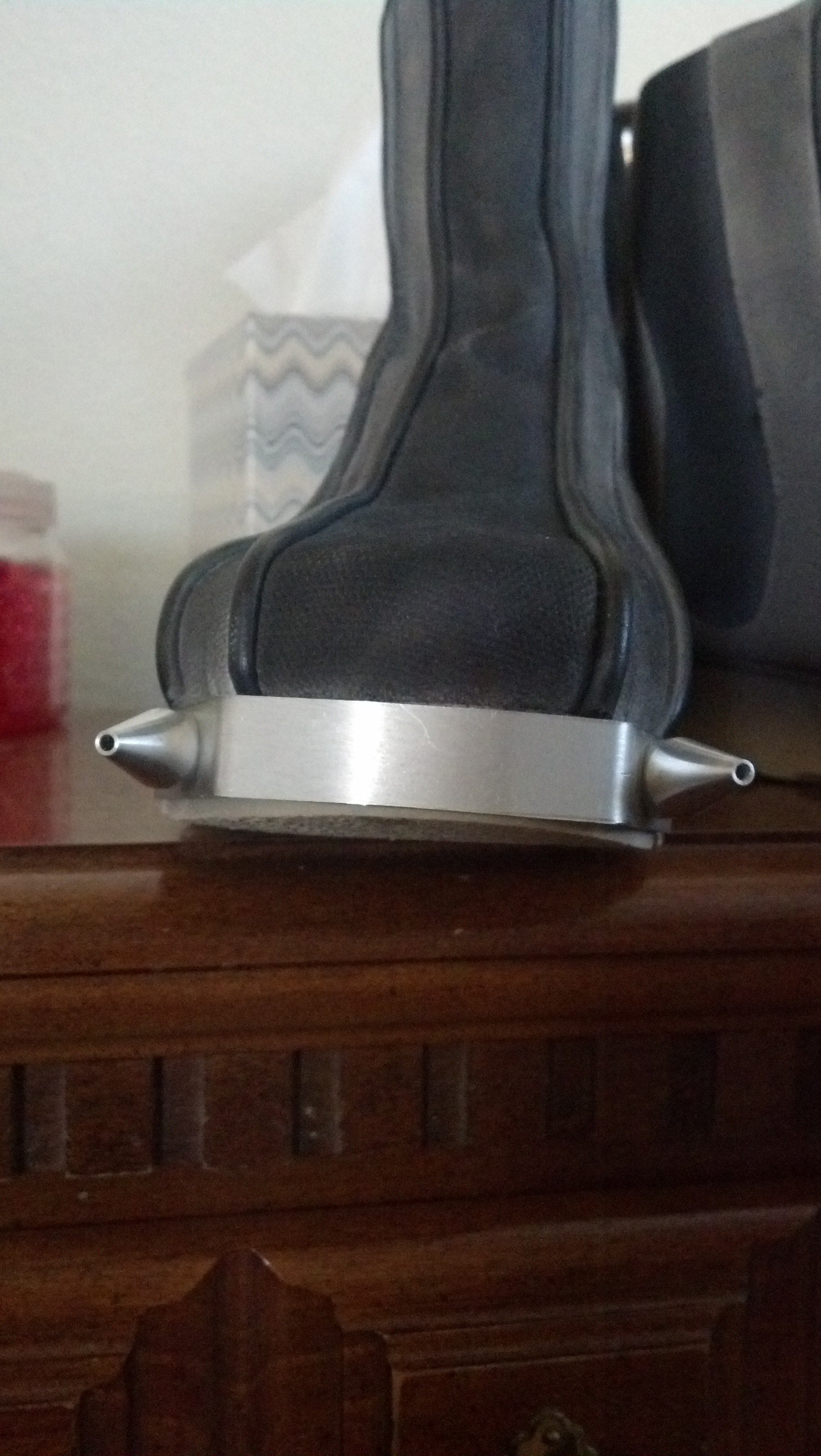

Has anyone else received their Mojo spikes and held them up to their MOW boots... its an oh cr-p moment. these are at least 1/2 an inch too wide.They are beautiful- no doubt- but when the sides are squeezed together to fit the spikes are angling at 10 and 2 o’clock. They may work great for taking out snipers but they would look much better straight forward. The only fix I can think of is to put a new bend, move one spike and cut off the excess on the end.
But I’m also on cold meds and not thinking right… am I missing an easier fix?

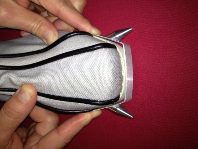

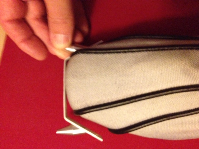

Having the same issue right now lol. I'm just bending them slightly by hand and they look alright but having thoughts of modifying the aluminium plate being its a little too big and wide. When a more accurate shoe comes out with wider toes it will probably work better now they have the spikes to use an as example to work with.

They are pretty easy to fix .... i have small feet so these are massive. All i did was use the correct Star head (TORX) driver (M8) to remove the small machine screw holding the spike on ON ONE SIDE only ...
Do not try and use an Allen Key as all it does is strip the head. The base of the spike and the threads of the machine screws seem like they are held on with loctite thread-lock or similar making it **** tight and double important to use the correct TORX driver. Once unscrewed it disassembles easily.
Next - flatten out the thin toe bar using a vice .. or in my case flat pliers, and then hold the good remaining spike with bend against your shoe. This gives you the new location to mark the new bend location.
Re-bend the bar (again vice or pliers).... then its simply a case of re-marking the new spike location and drilling one hole all the way through .. from memory think its 4mm. Then use a larger drill to slightly countersink the first hole to allow the machinescrew head to bed in ...
Lastly .. you can then mark up where you want the screwholes to move to ... use your dremmil or saw to even off the longer bar you now have on the newly bent side. Lastly drill the new screw attaching hole you marked up.
its actually pretty darned simple fix ... other than buggering up my first attempt by using the dreaded allen key it took me about 30 minutes to alter mine ... less if you have access to a proper workshop i'd guess.
