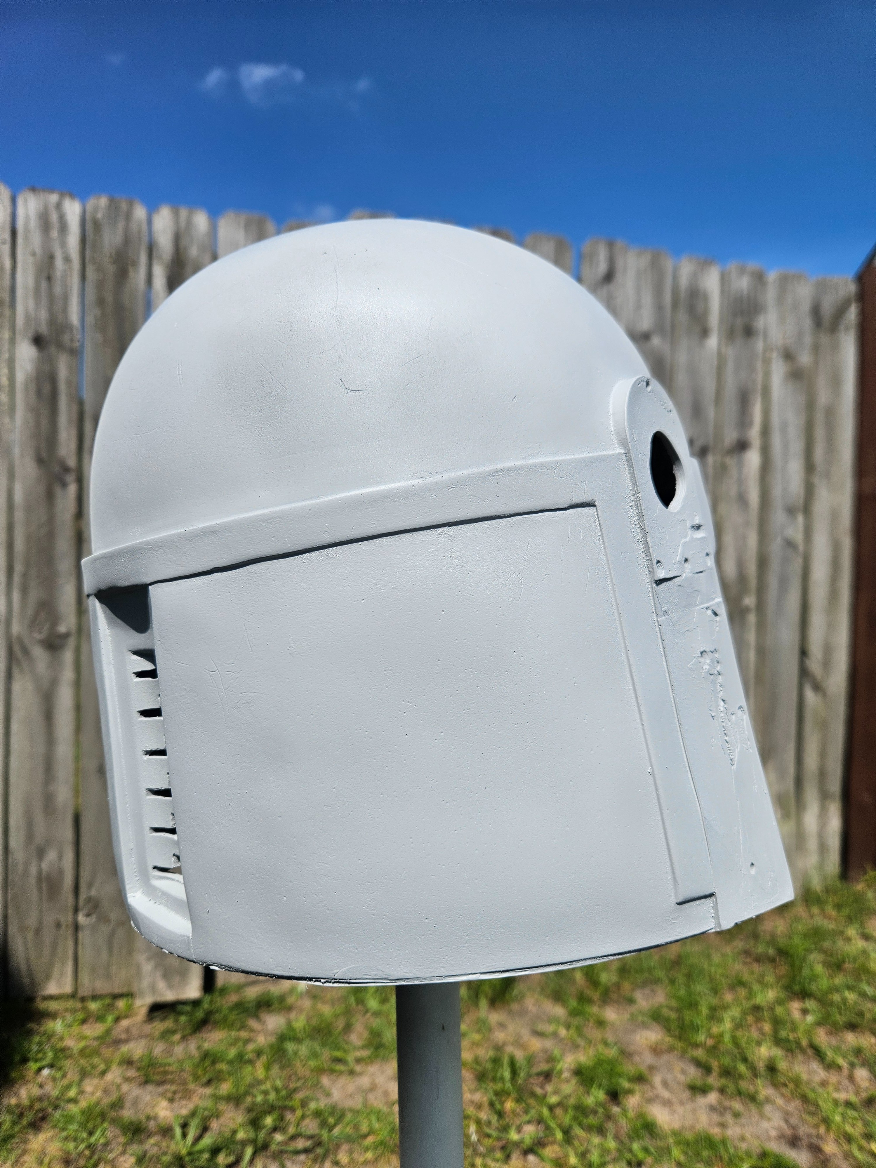

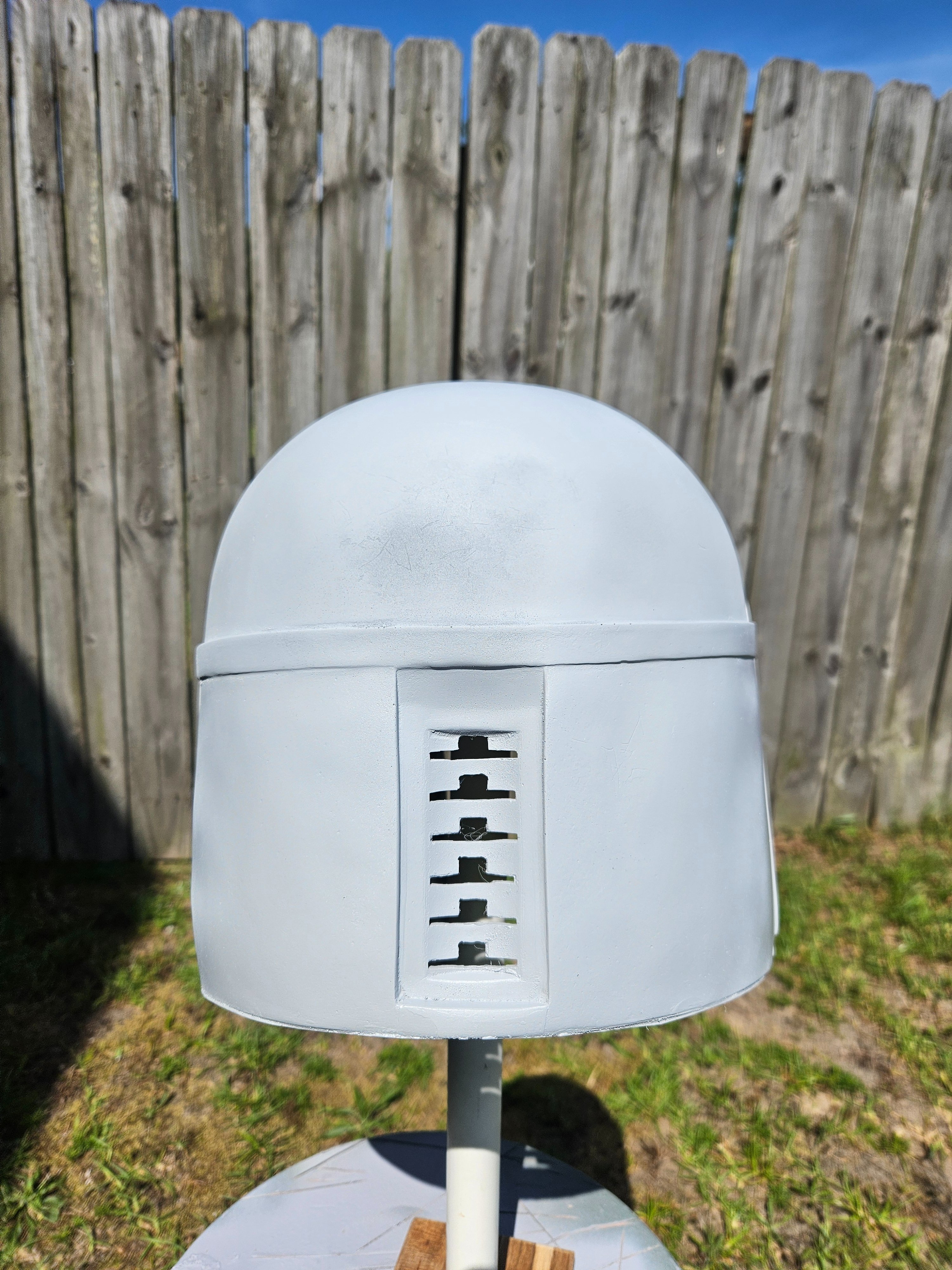

I figured it has been quite some time since I have done a paintup. I believe the last couple I did all got sold here or on the RPF. Around Spring of last year, I got a super nice MinuteFett ESB cast from another member here for a good price. Now that its been sitting on the shelf for a while, it is definitely time to start painting! This will be my first paintup using Archive-X acrylics instead of my usual humbrol enamel paint up.

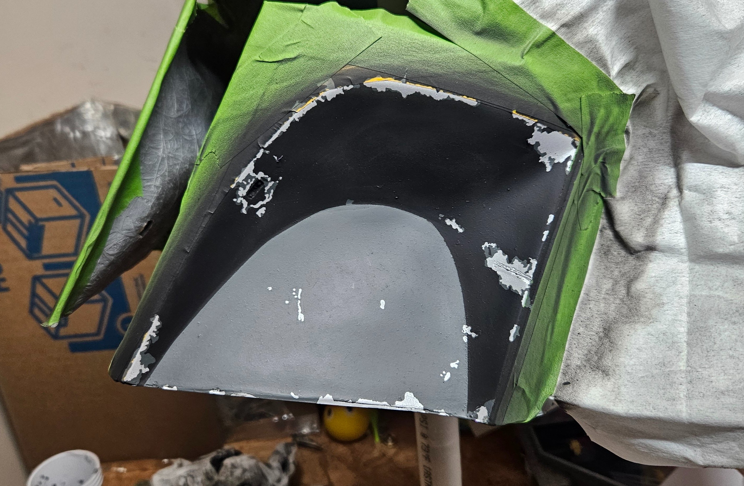

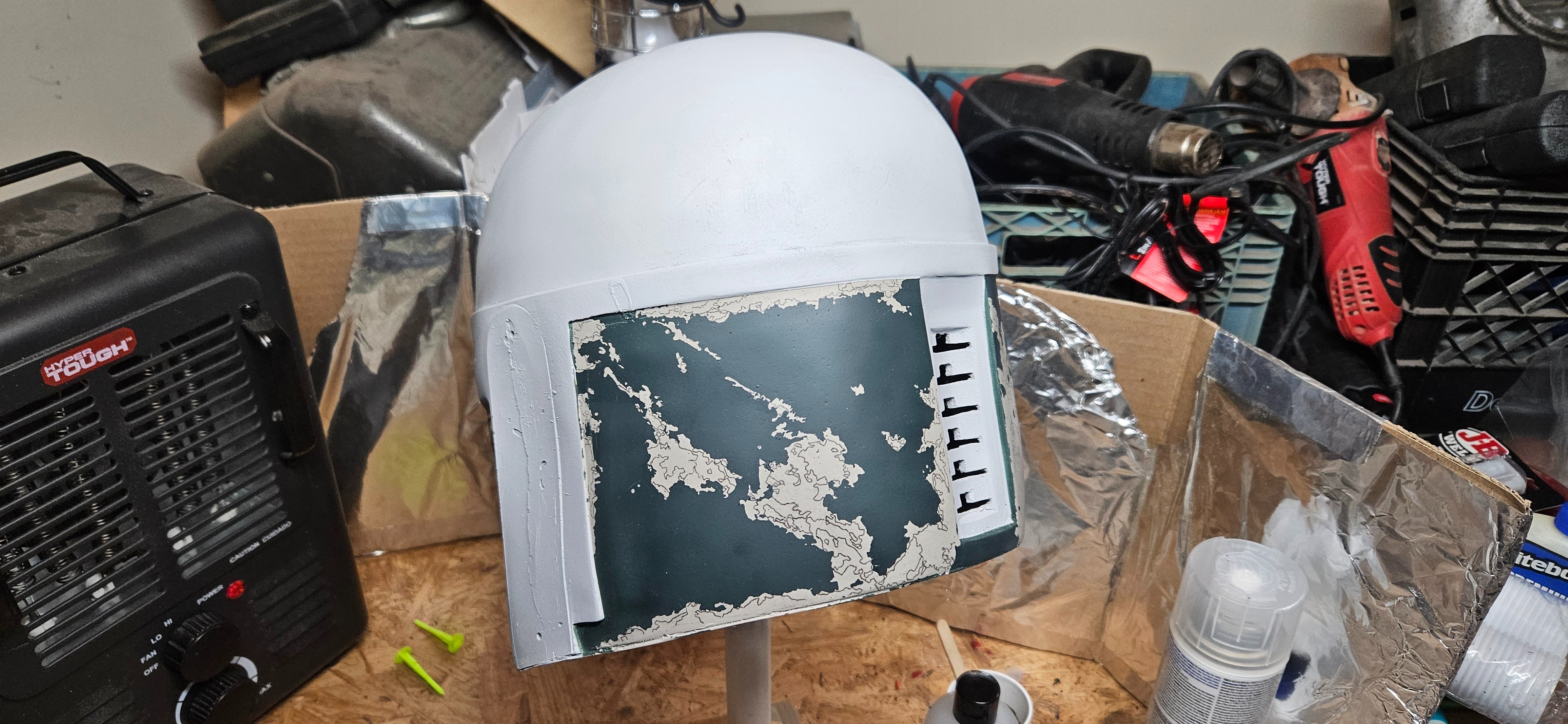

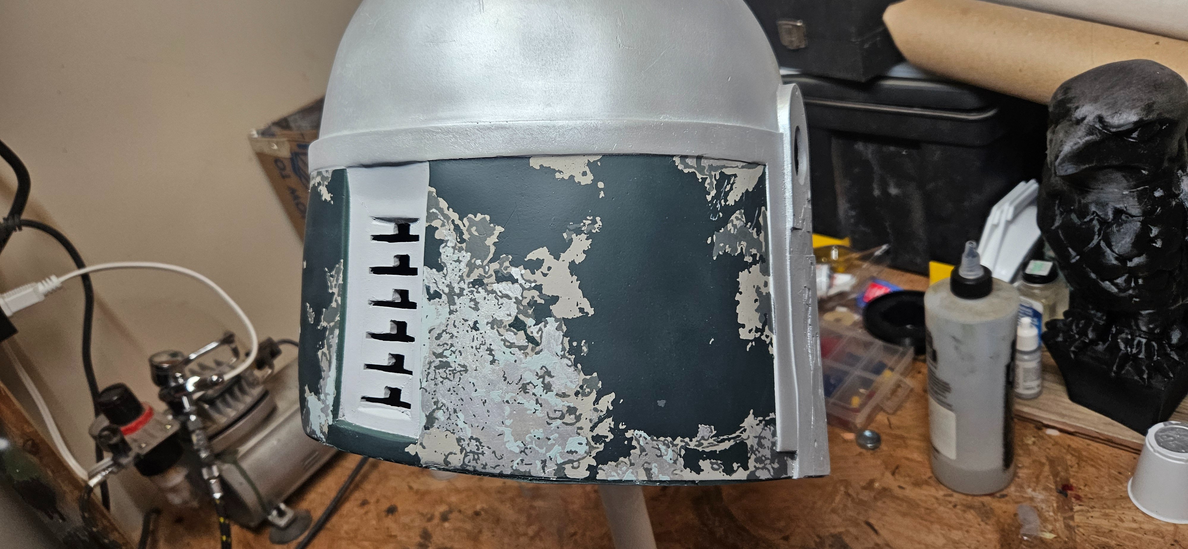

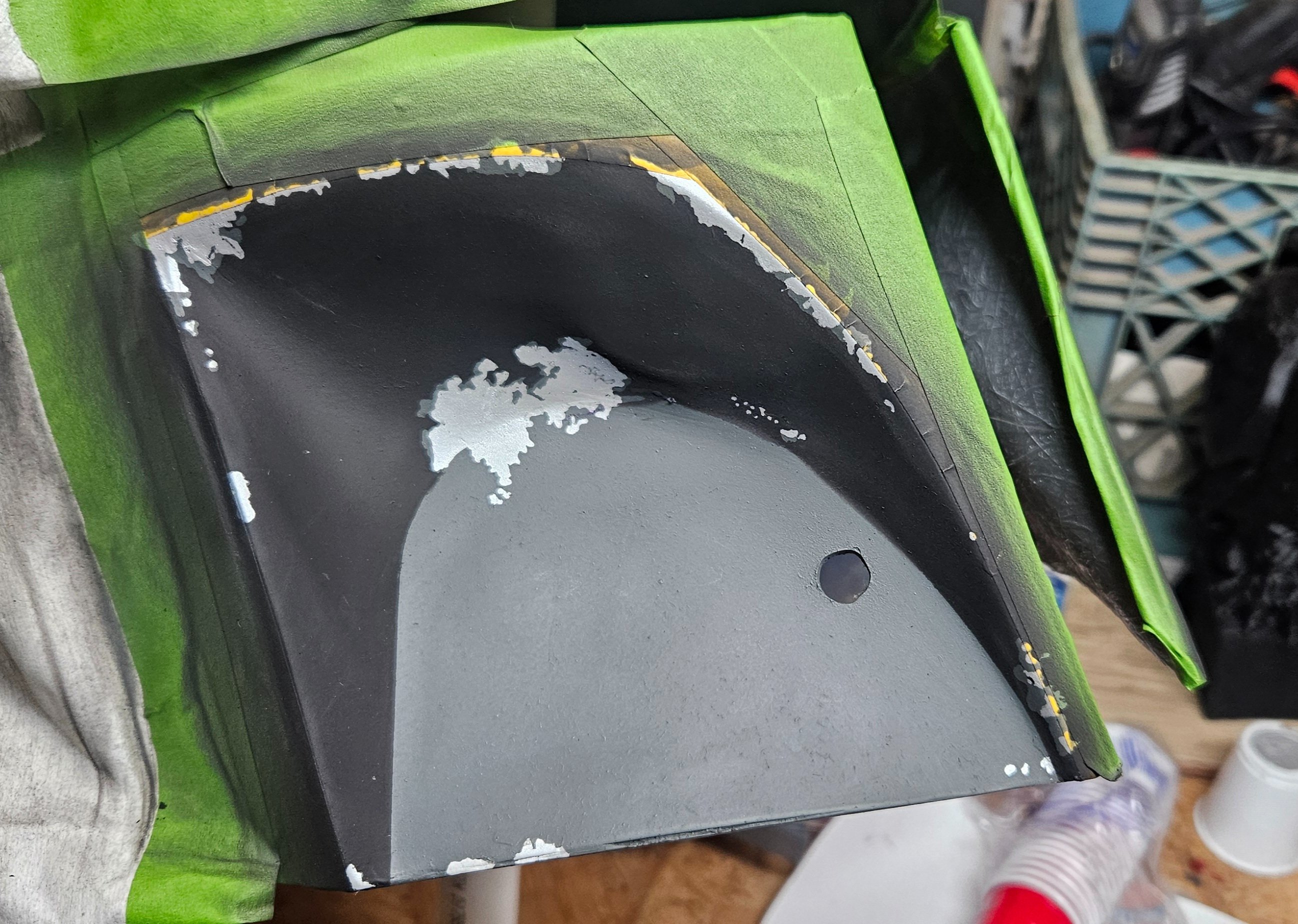

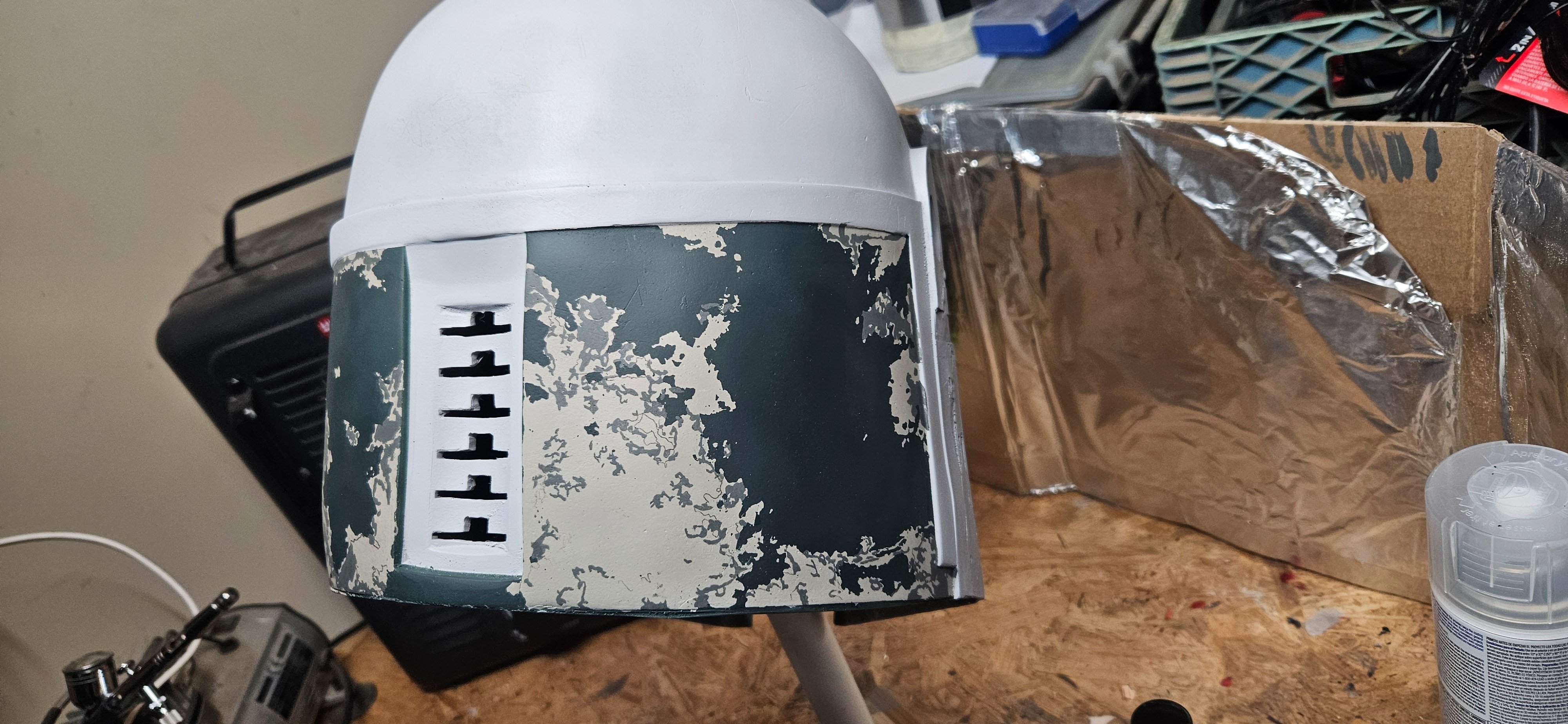

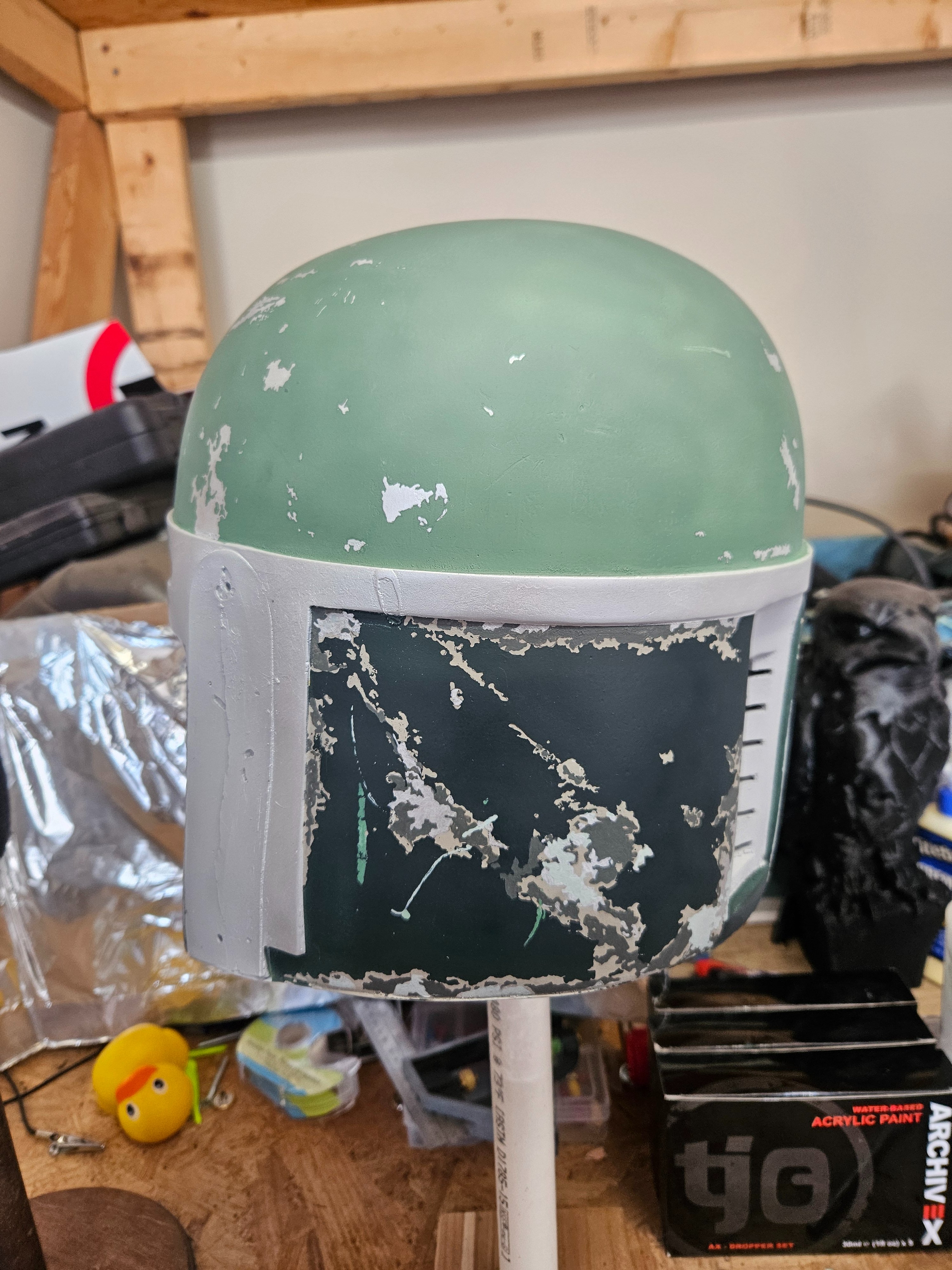

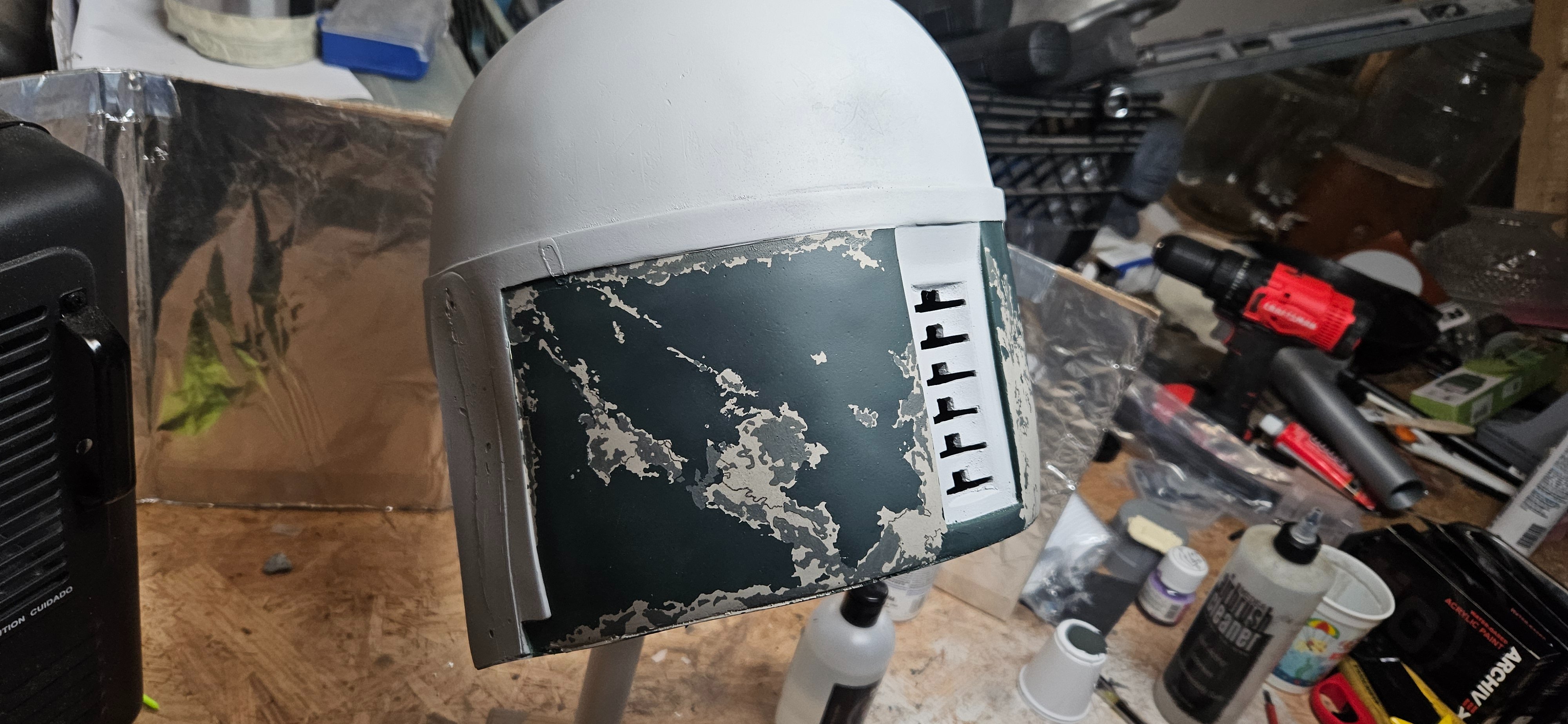

I already knocked out the back panels over the last several weeks. Started with a base of fine primer, and started laying on color. Next a layer of dark grime. I used Humbrol liquid mask to mask off the damaged area, then applied a 2:1 mix of Dark Green and Engine Black.
Next, I traced out the areas where the SP Lark Dark Gray, Vallejo model air aluminum, and custom light gray/blue mix would be topically applied. Lastly I mixed light green with a small amount of light gray until the right color was achieved for the scratches on the left hand back panel.

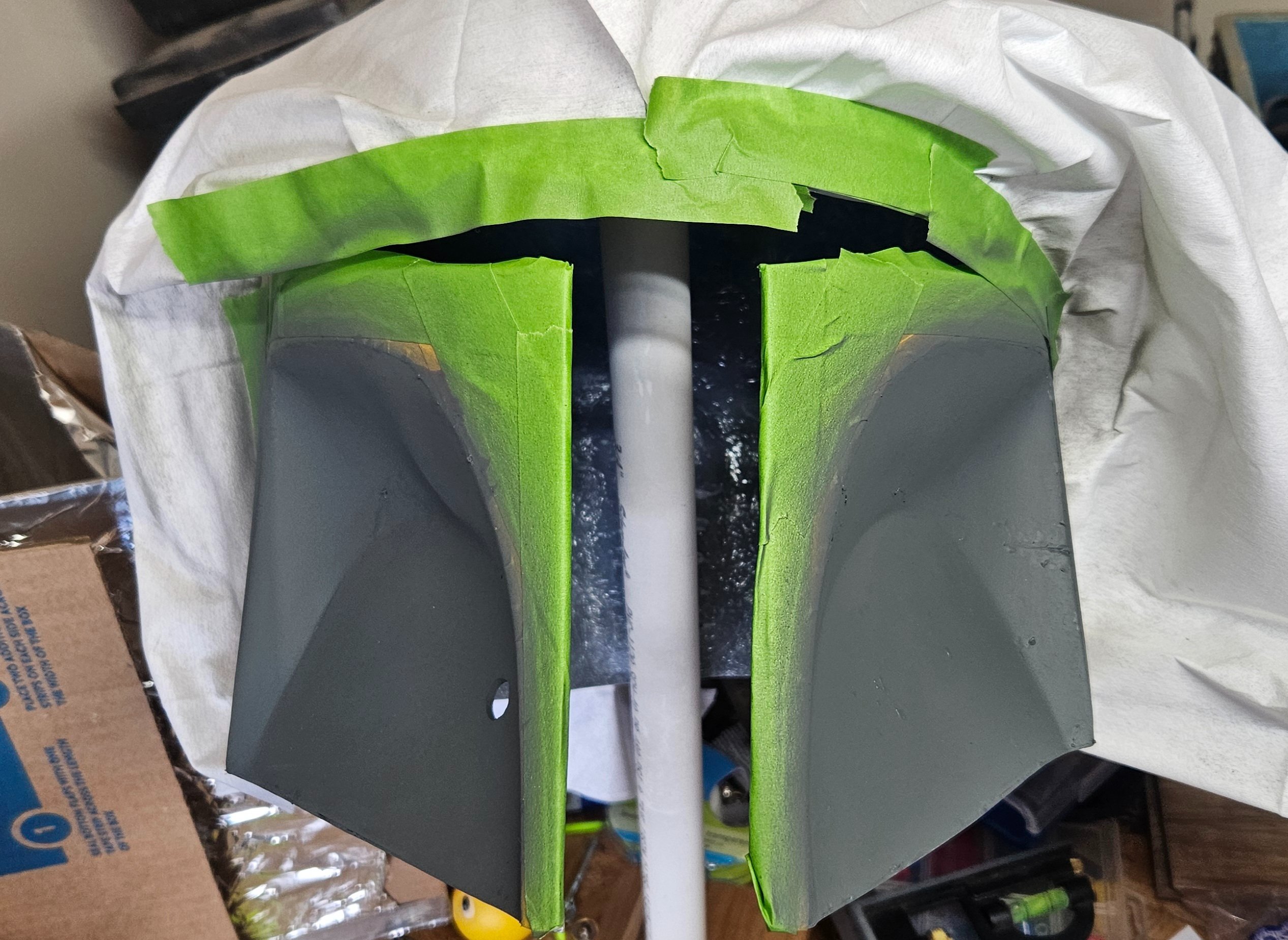

I am actively cutting out Rafal's template for the upper and lower cheeks, and plan to be better about documenting the next steps as I go. Stay tuned!
