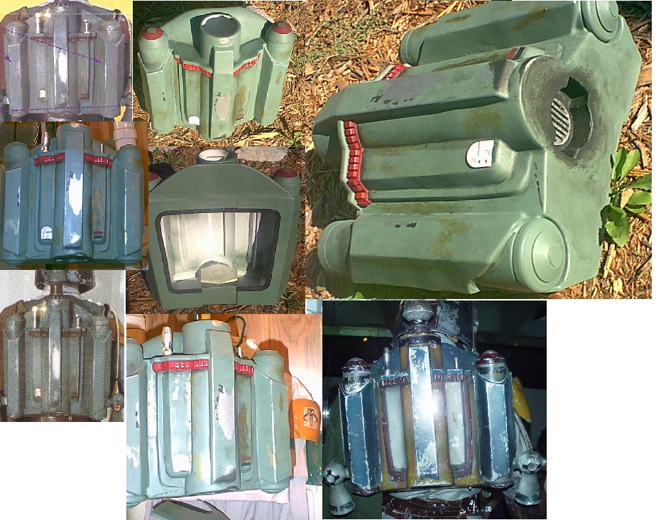

This is a WIP. Iv'e got the body pretty much done. I'm holdong of on the final touches and some blending. untill the rocket and thrusters are complete. I've decided to leave the access area open, so I used the stormtrooper helmet trim around the adges of the opening. I shot several pics in different light, but realy none give off the correct color.
Thank you to FP for the custome paint that came with my ESB guantlets. This is the same dome and cheek paint Fettpride used on Bobafettish's helmet wich is a slight tad lighter than Rogue studio's panzier olive.
The little white "decal" is actualy ABS plastic I cut out with a dremel and glued on too give it a 3-D look. It took about 15 minutes to cut out.
Thanks to roguestudio, Fettpride,and motor fish for weather tutorials and sugestions!
And Thanks MB for a good looking kit!
:eek:
That's got to be the bes ESB Pack i've seen thus far !
Great weathering so far Brian !
FP
Glad you figured out how to post your pics. :)
That is definately one the best ESB jet packs we've seen. :eek:
Keep up the great work. :thumbsup:
