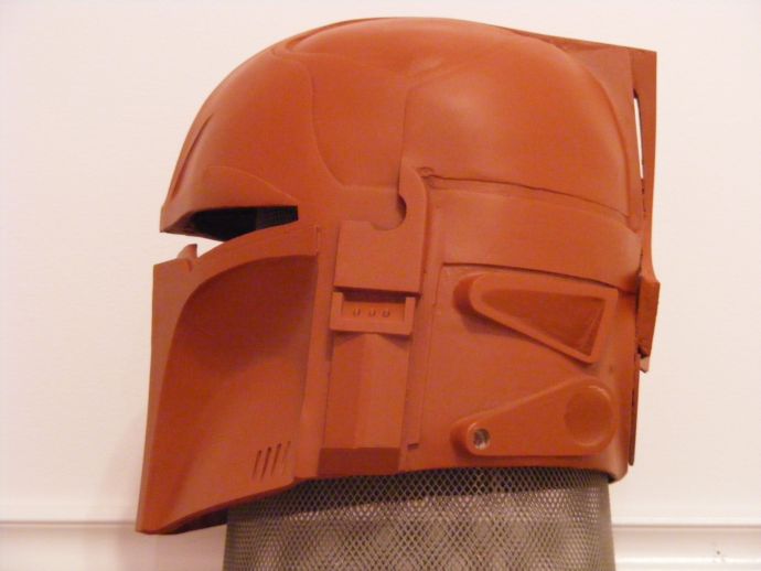

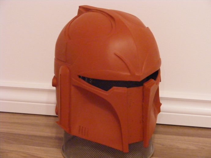

**August 19th** Just a quick update. I've only had a couple spare hours all week to tinker with the helmet. More setbacks than work accomplished. Hopefully by the end of the week I'll have the back of the helmet done. I'll be leaving out any detailed greeblies to make the casting procedure easier.
Holy Asterisks! That looks incredible!
The back is stunning, I also love the little gills on the sides too. Little details like that make it look awesome. You're a crazy individual Marrow Sun!
Marrow....didn't see this in the thread, but what kind of materials are you sculpting this out of?
Mostly bondo jelly, MDF and styrene. I try to avoid the plastics as much as possible as I don't have a lot of luck with the bondos adhering to them properly. MDF is your friend:D
