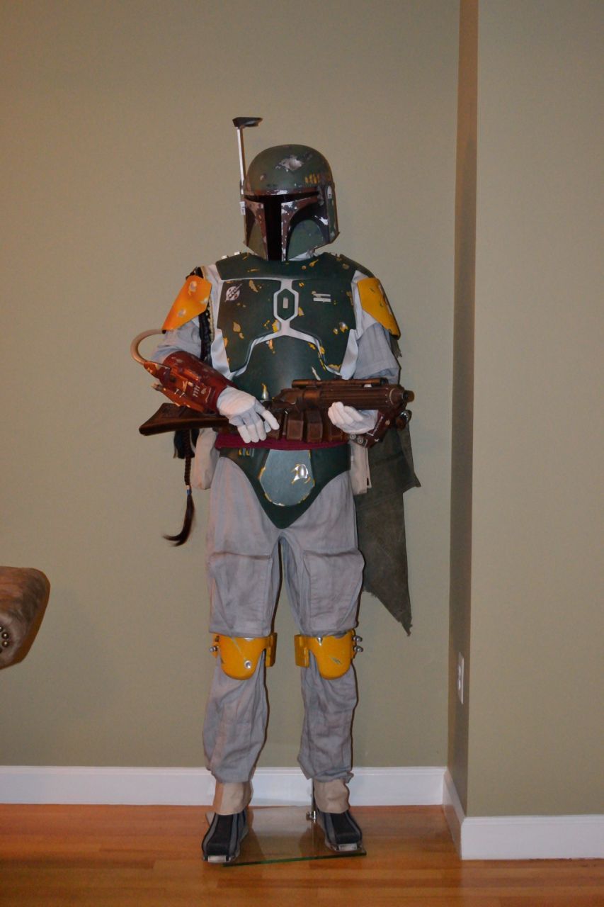

I had sold my original one along with my sandtrooper. When I got the new mannequin, dressed it in Fett, and didn't think it would hold I traded back with the guy I sold the sandtrooper to. It's a SOLID mannequin (my old one that I have now) but it's a pain in the butt to dress. Seeing how it's displayed 99% of the time it's not too big a deal. I got the one from Mannequinhub.com but the website doesn't seem to work anymore. They've got some bad reviews but my experience with them was super easy and I got exactly what I ordered. You can't pose it but that's the trade off for having one that is gonna stand up under the weight of the armor.
I would recommend either buying a basic store mannequin and modding it or building one from scratch entirely. It's really, really hard to get costumes on mannequins to look right without a lot of customization. I would stay away from the posable ones. Like a lot of the other posters said, they don't really offer the support you need. I made mine from duct tape and expanding foam. Not fancy but it does the job. One thing you're going to want are anatomically correct posable hands. These guys will tell you getting a Fett mannequin to hold the blaster correctly is a pain. Bottom line, I don't think there is an easy solution. Customization is key. :thumbsup:
Thanks for the tips Matty matt! Your Fett is amazing. Having my fett displayed just like that is my end goal. I remember watching your WIP thread. What happened to your sweet display stand?
I still have it. I was just moving some stuff around in my basement. Thanks for the compliments.

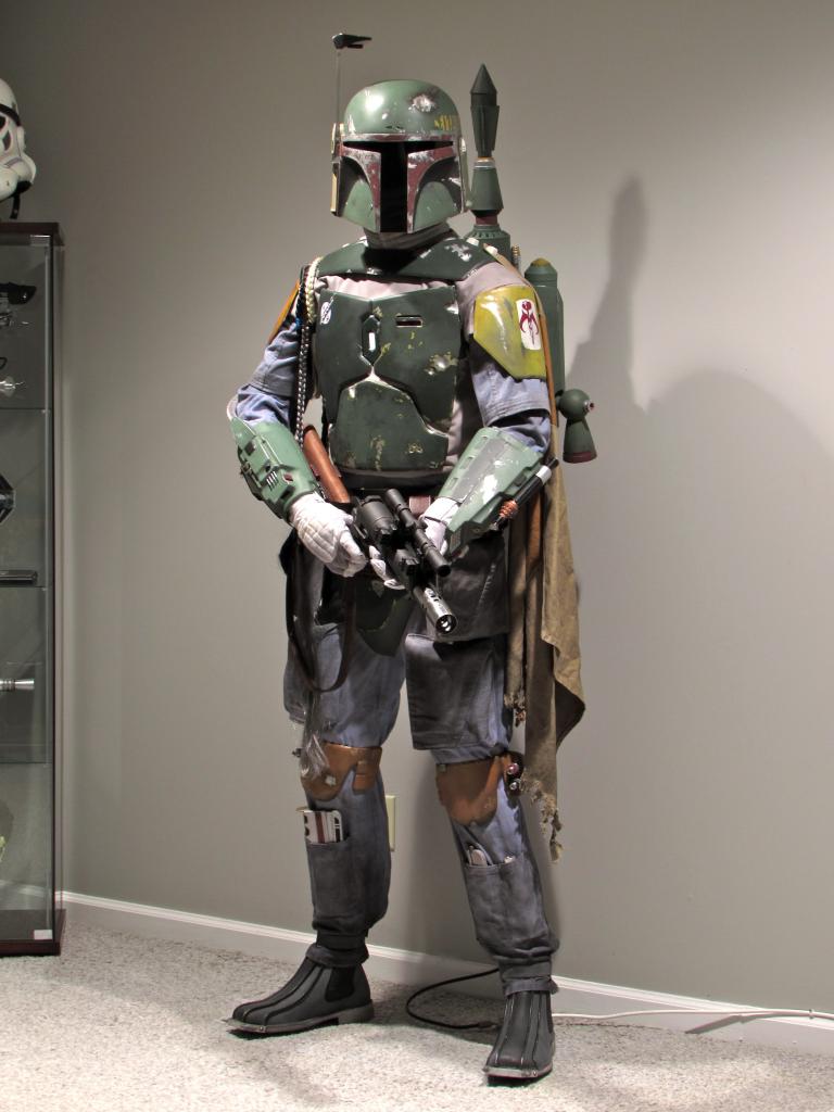

Matty Matt how do you get yours to stand up by itself?
The legs are solid foam with wooden dowels going down them. He stands up just fine, but I have to attach him to the wall with a wire so he doesn't fall forward.

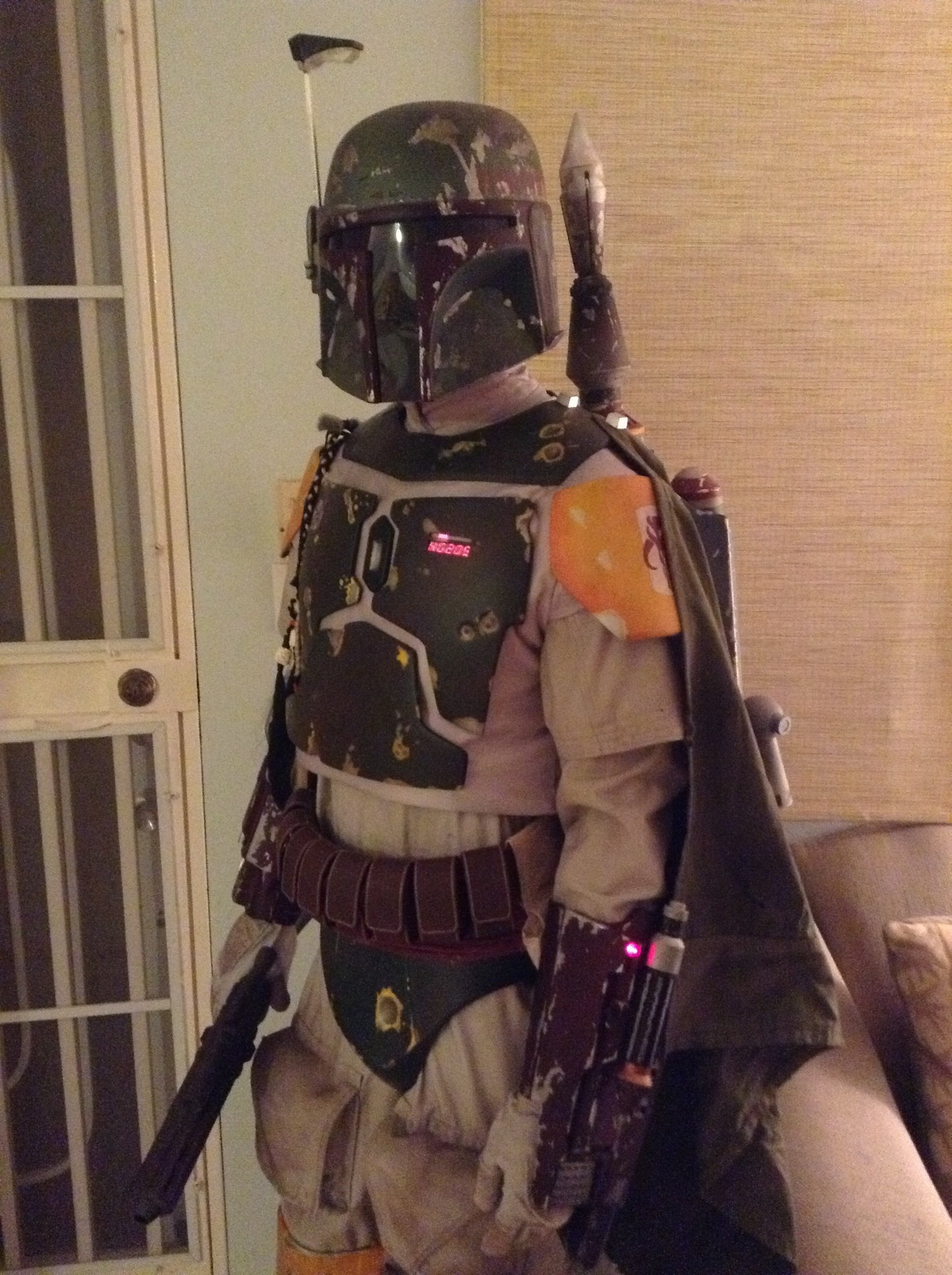

I struggled with this as well. I ended up buying one with poseable arms from Roxy Display. It feels solid, even with the jetpack. I think it was about $180 with shipping.
