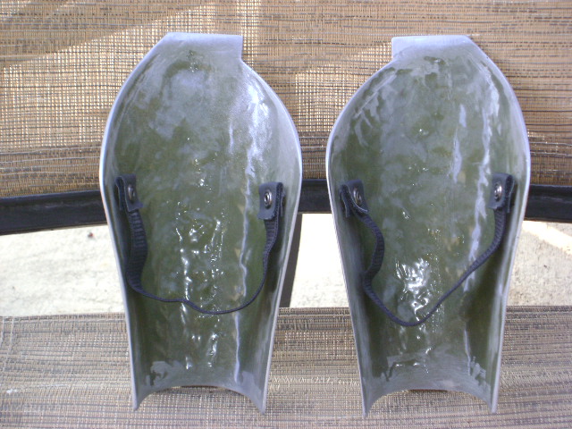

For the shin armor, use elastic straps and snaps, and put the straps through small holes in your flightsuit legs and wrap them around your legs. Make sure the elastic straps are tight enough so your armor doesn't move around too freely. If one strap isn't enough, add a second one at the bottom.

Here's a pic of the shin strap.
Thanks Cruzer. I going to be doing that for me shins, thanks for that. I using snaps for my cod piece also. Will revisit the boot plate now as per your instructions. Thanks very much. Sent you pm before.
Thanks Cruzer for your advice. I got round to doing the shins, only problem I have on them is the flightsuit look baggy where the shins are? Any advice to sort the baggy part on the flightsuit where the shins are.

Use a safety pin to gather up the excess leg material behind your shin armor. And replacing the velcro on your boot armor with snaps would do the trick. You also want to make sure the velcro staps on your boot armor are taunt, but it looks like they are from the pics.
Thats great Cruzer, will have a look this weekend. Sent you a pm, beginning to wonder what was happening. Any ideas on my shins problem? Here is a pic to explain all.

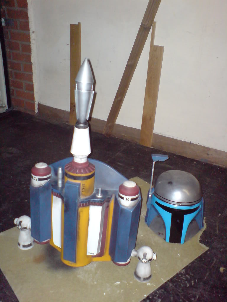

Was at Bobby Fett UK's house today. Picked up my helmet and Jet Pack off him. Got my flightsuit weathered.
Am sure most of you have seen the progress of my jet pack build by Bobby Fett UK.
