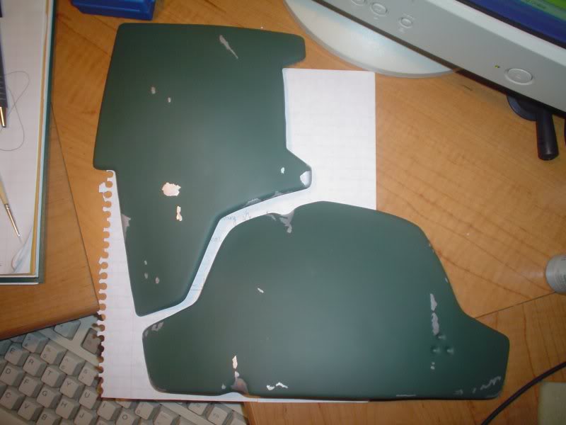

I bought something called "Susan Scheewe Blue Masking Fluid." The only listed ingrediant is natural rubber latex. It goes on super easy. I have not yet pulled any off yet since my armor is still wet. I will let you know how it does.
I pulled my masking fluid off late last night and I have to tell you, that stuff works like a charm! The key is to use a rubber cement eraser as Spideyfett has advised. What I did was just barely scratch the paint over the latex, then used the eraser. The latex sticks to the eraser like a magnet! You can also control the removal much better. Of all of the paint I removed, I only had one flake come off by surprise.

Looks great!
