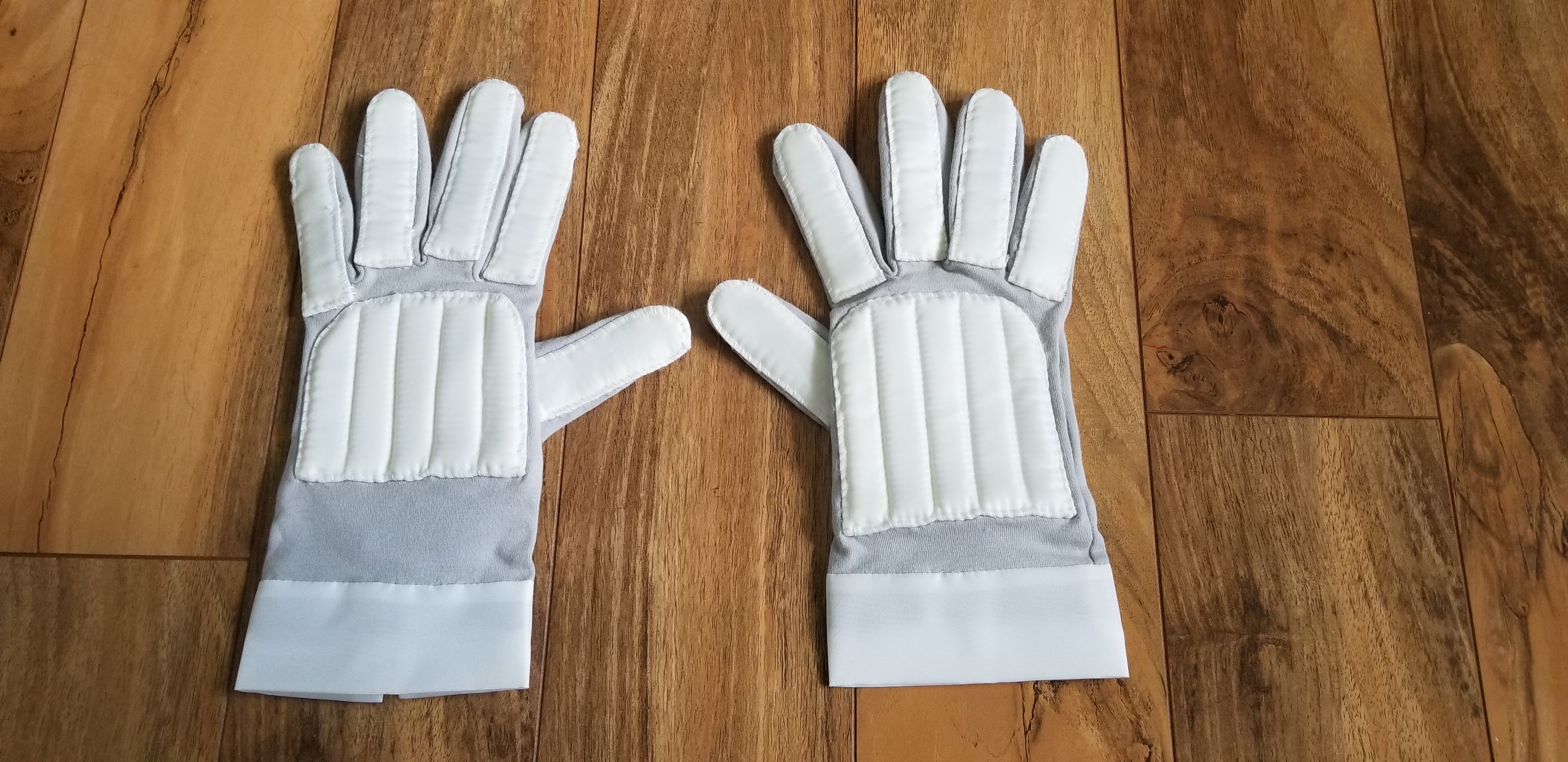

The finger tip switches are attached to small rounded pieces of plastic cut from an OJ bottle. They are slid inside the glove so no cutting or sewing is required on the glove itself. I am using ethernet cables to get to the playback unit which will be in my thigh pocket with the PA system. These are the cheapest smallest connectors I could come up with that had at least 6 wires. There is a female ethernet jack under the gauntlets where the gloves plug in. This way the buttons and short ethernet cable can stay in the gloves.

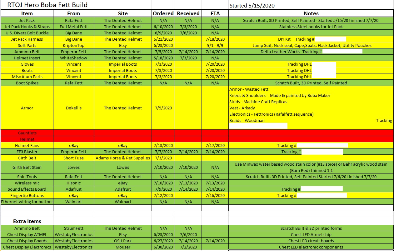

Sure.
Here is my parts list and pictures of what has showed up so far.
Green - Received
Yellow - Ordered
Red - Not Ordered

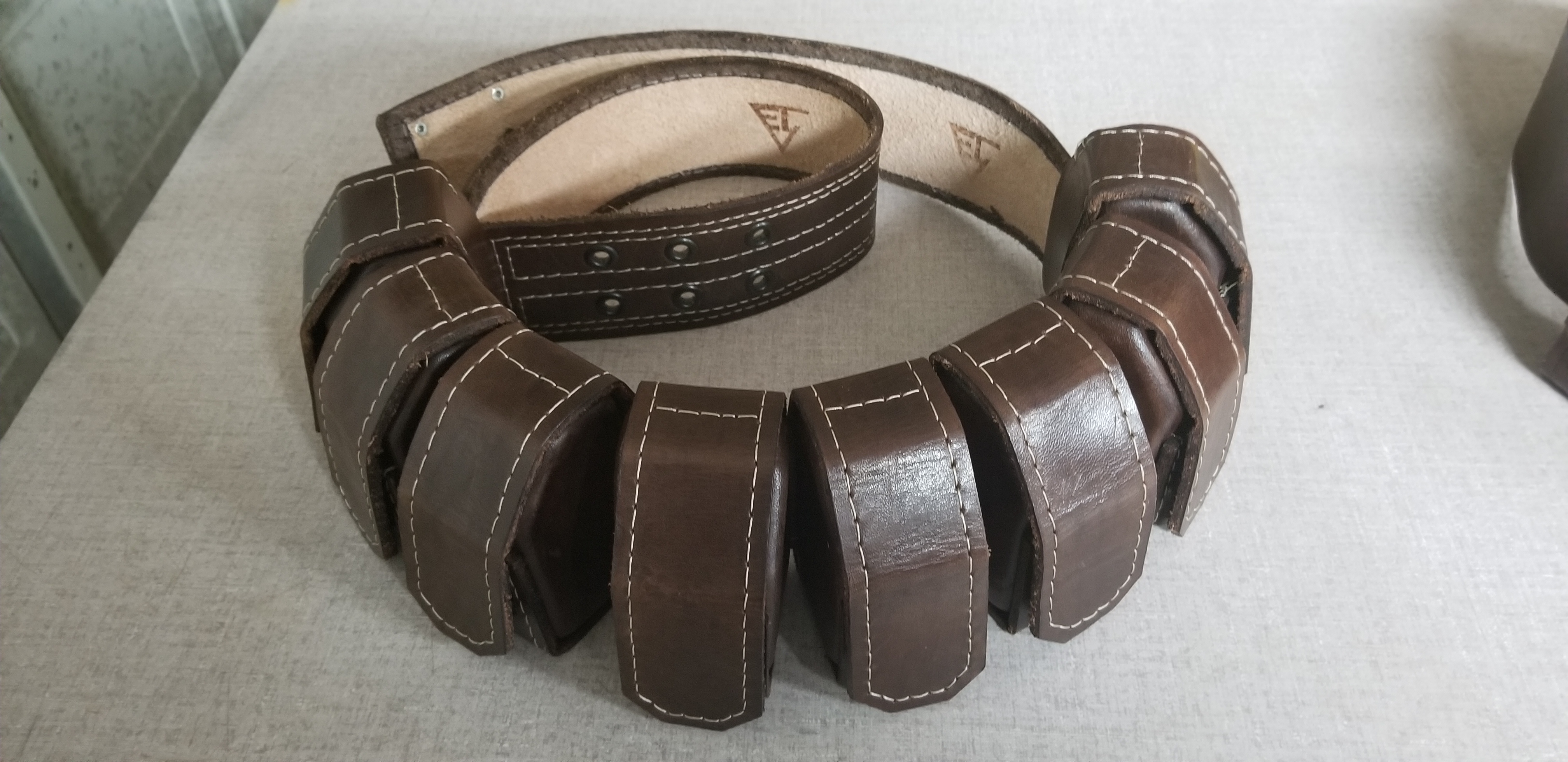

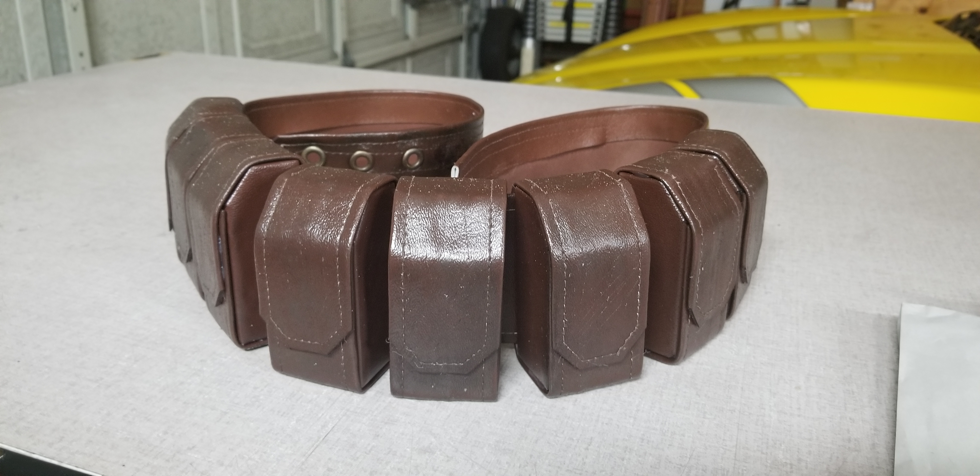

I built my own ammo belt a few weeks ago, but then saw the post from Emperor Fett wanting to sell his Delta Leather Works belt at a price too good to pass up. It's good to since the paint I used on the vinyl to weather it reacted and isn't drying. It's still tacky weeks later. That is why you see so much dust on it.
My scratch built belt.
Delta Leather Works belt from Emperor Fett.

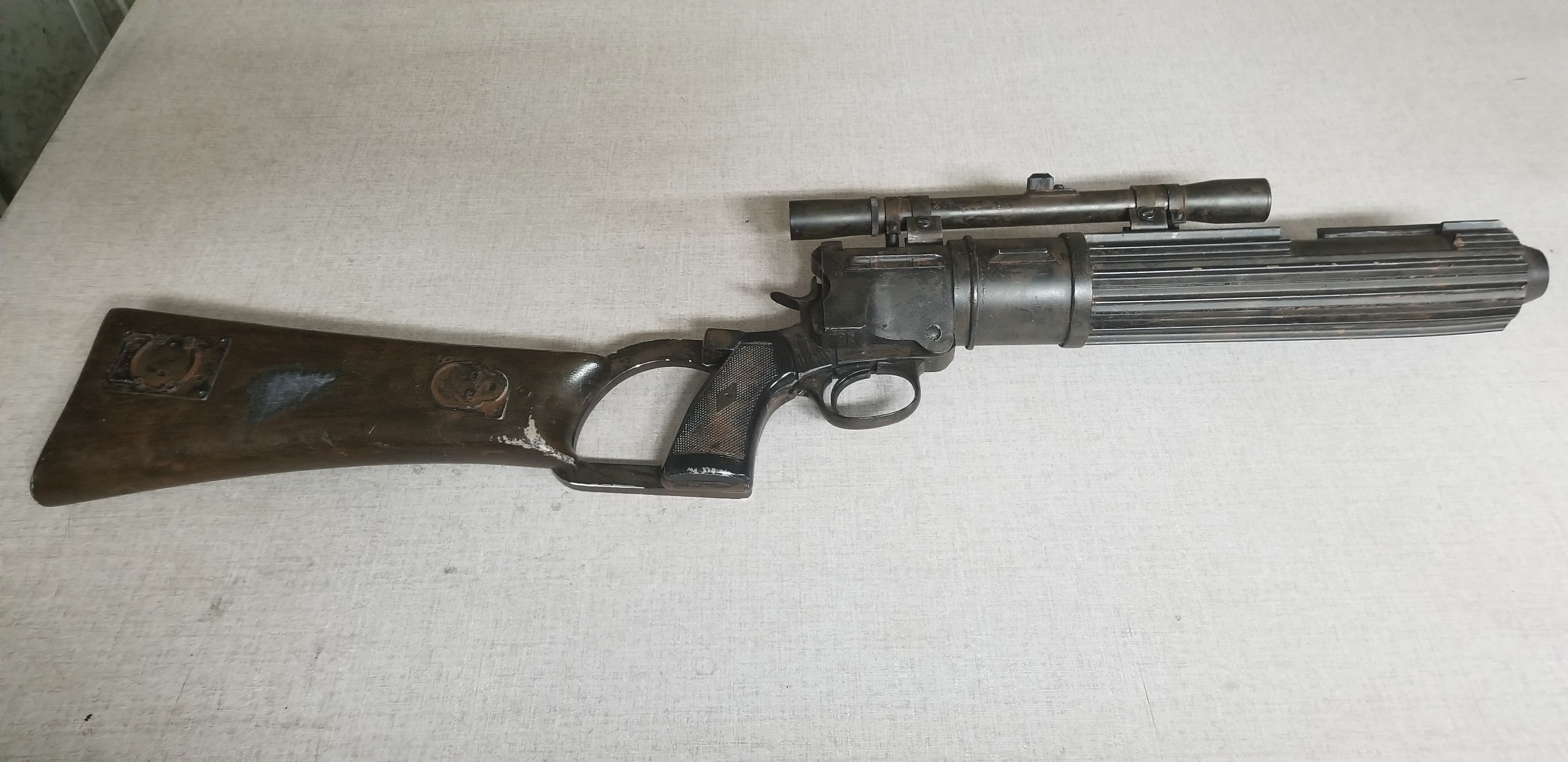

I also got Emperor Fett's EE-3. It needs a little bit of touch up here and there, but it looks great!

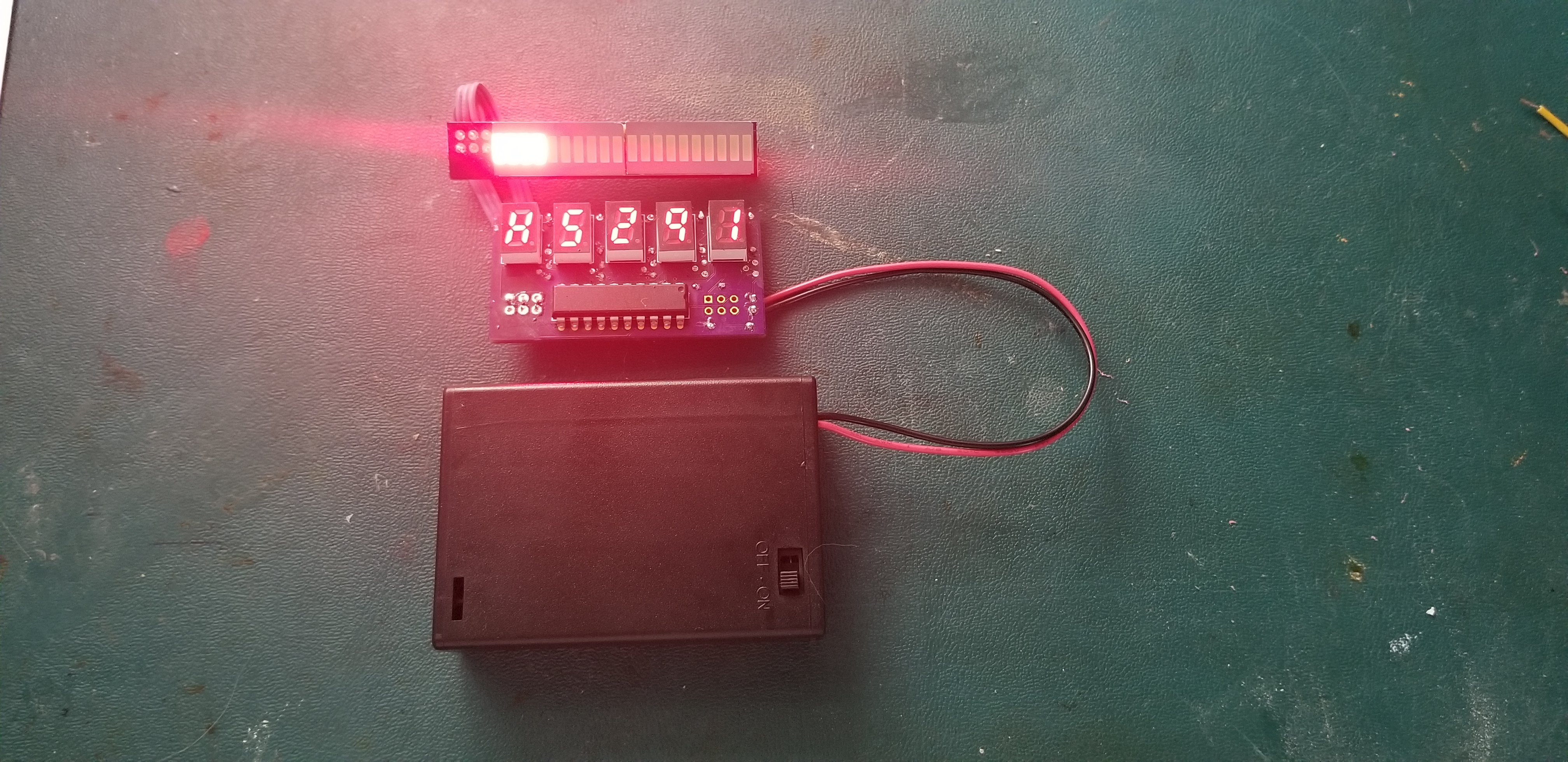

I found a guy on Etsy that sells a programmed Atmel Chip. It is used in the Chest LED's for the 'do it your self' electronics people. He provides the electronics parts list and circuit board layout. All that is needed is to solder it all together. It took me about 1 hour.

So it seems like I'm slowing buying all of Emperor Fetts stuff. The chest armor has a Fettronics board in it, so the kit I built is extra now.

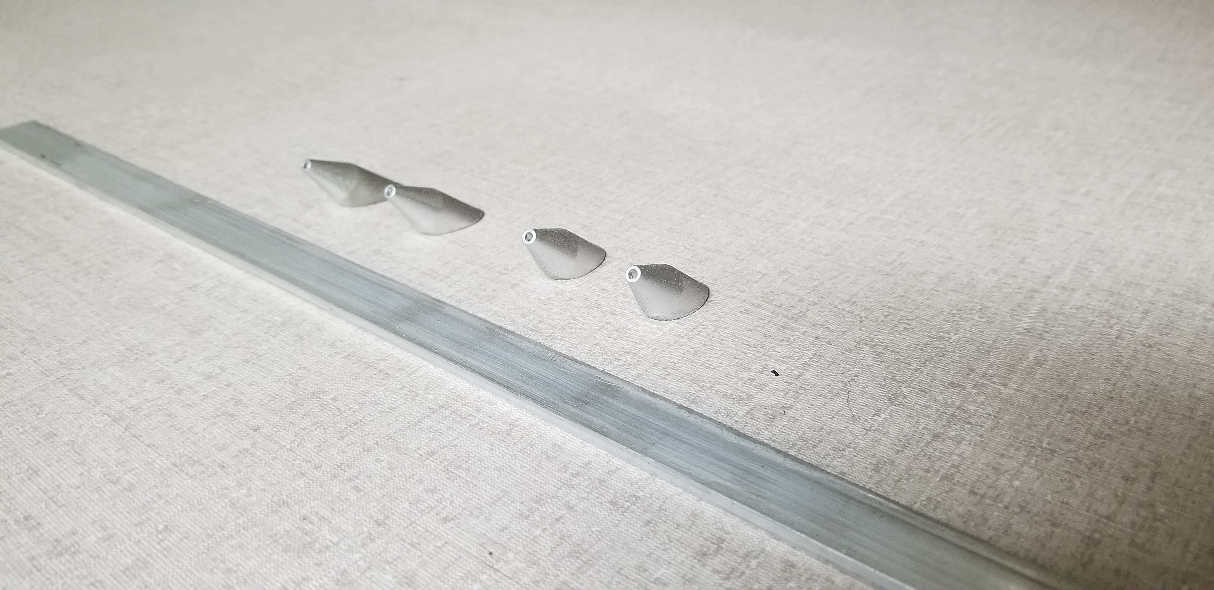

My boot spikes are scratch built. The spikes are 3D printed using my SLA resin printer and files from RafalFettt.
Just waiting on the boots from Imperial Boots to show up so I can make sure to bend in the right place.

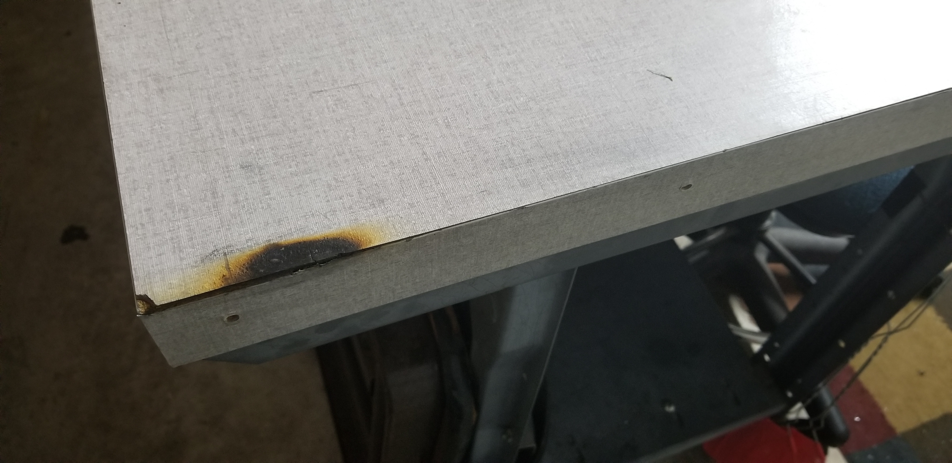

The flat Aluminum bar was originally 3/4" wide which is too much. I ended up setting up a rig on my work bench (a sort of table saw for metal) that used several clamps and a die grinder to cut it to the correct width. It worked great other that getting so hot I almost set the bench on fire. Thought I smelled something. Lol

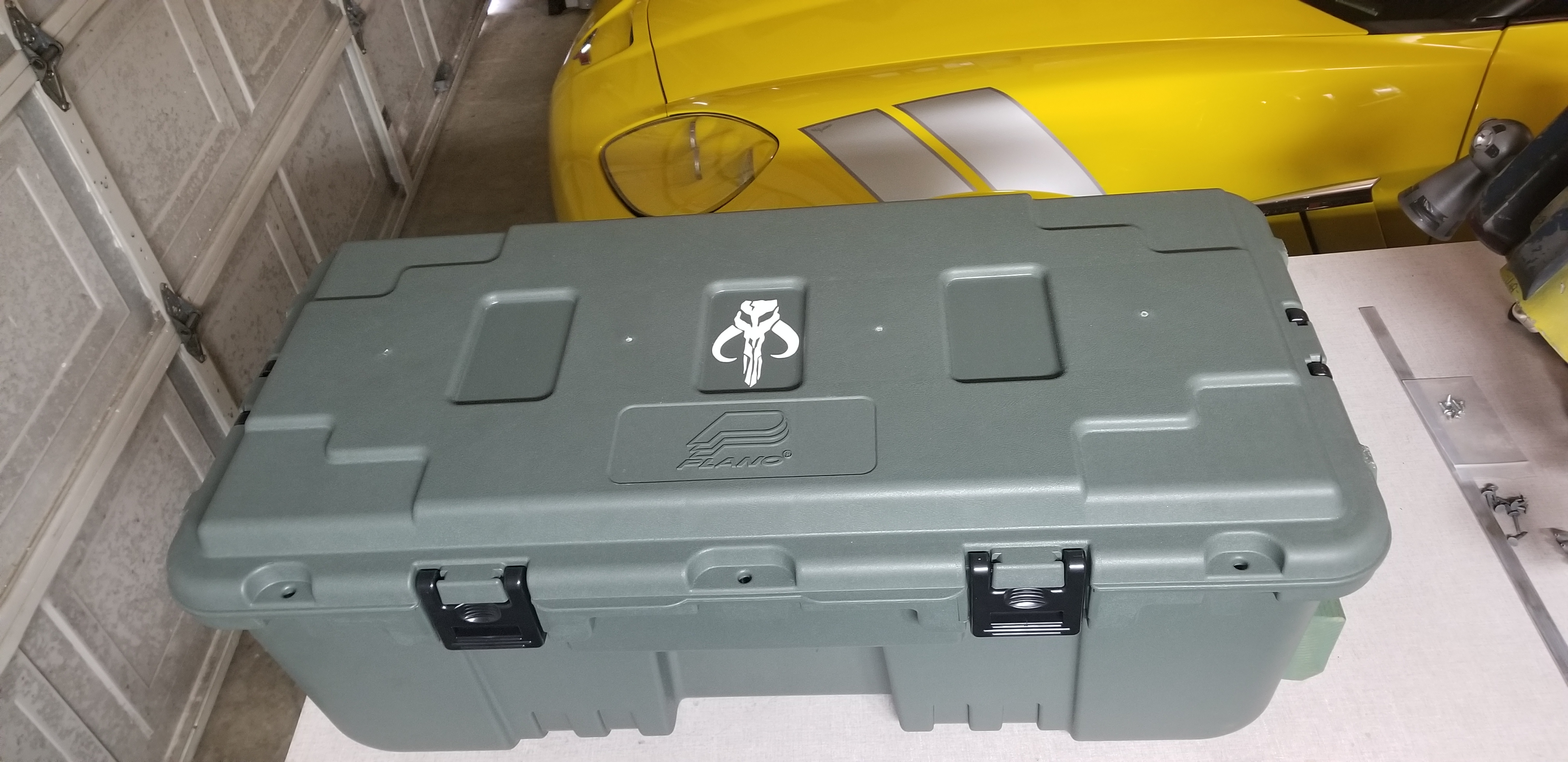

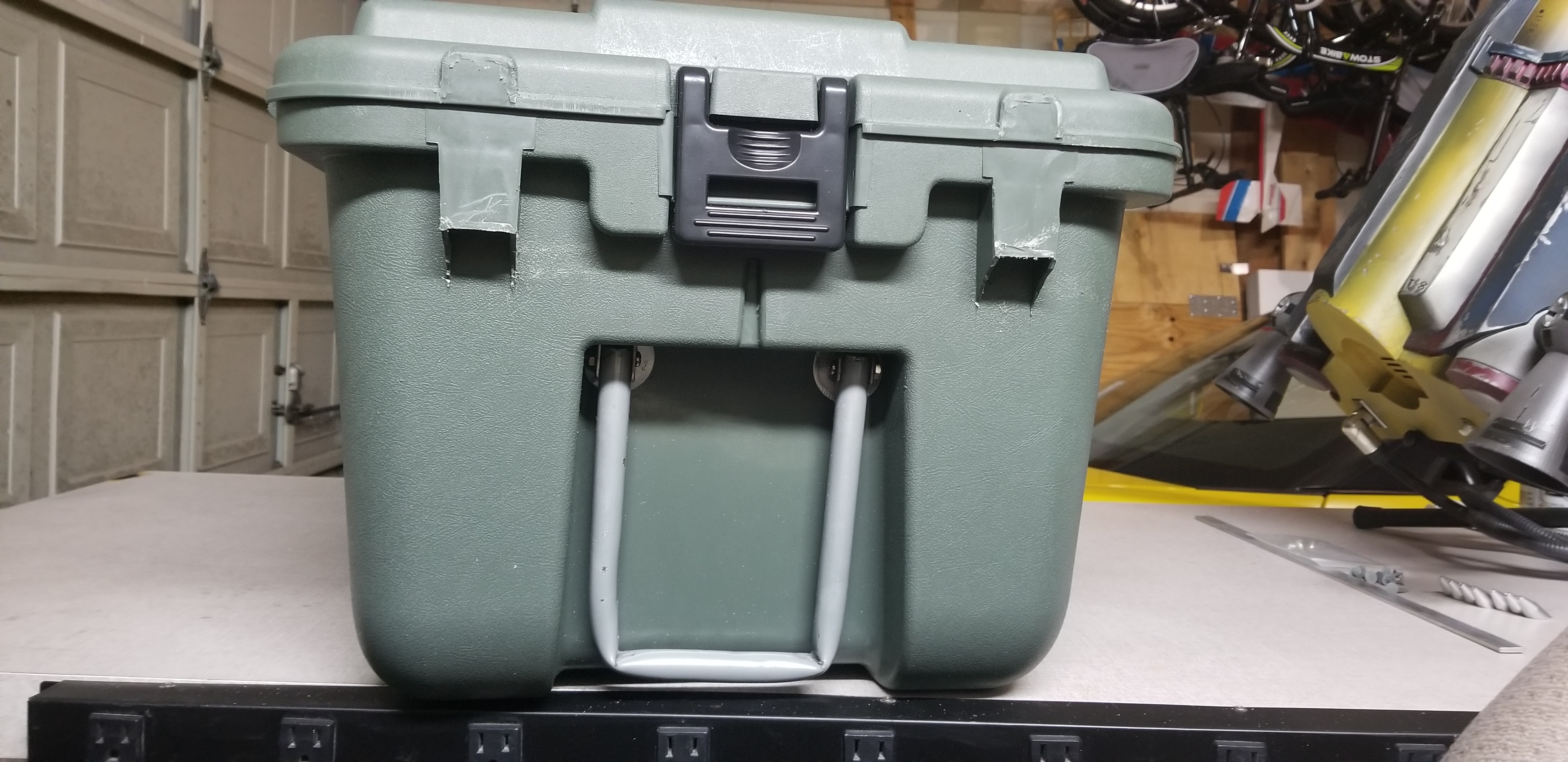

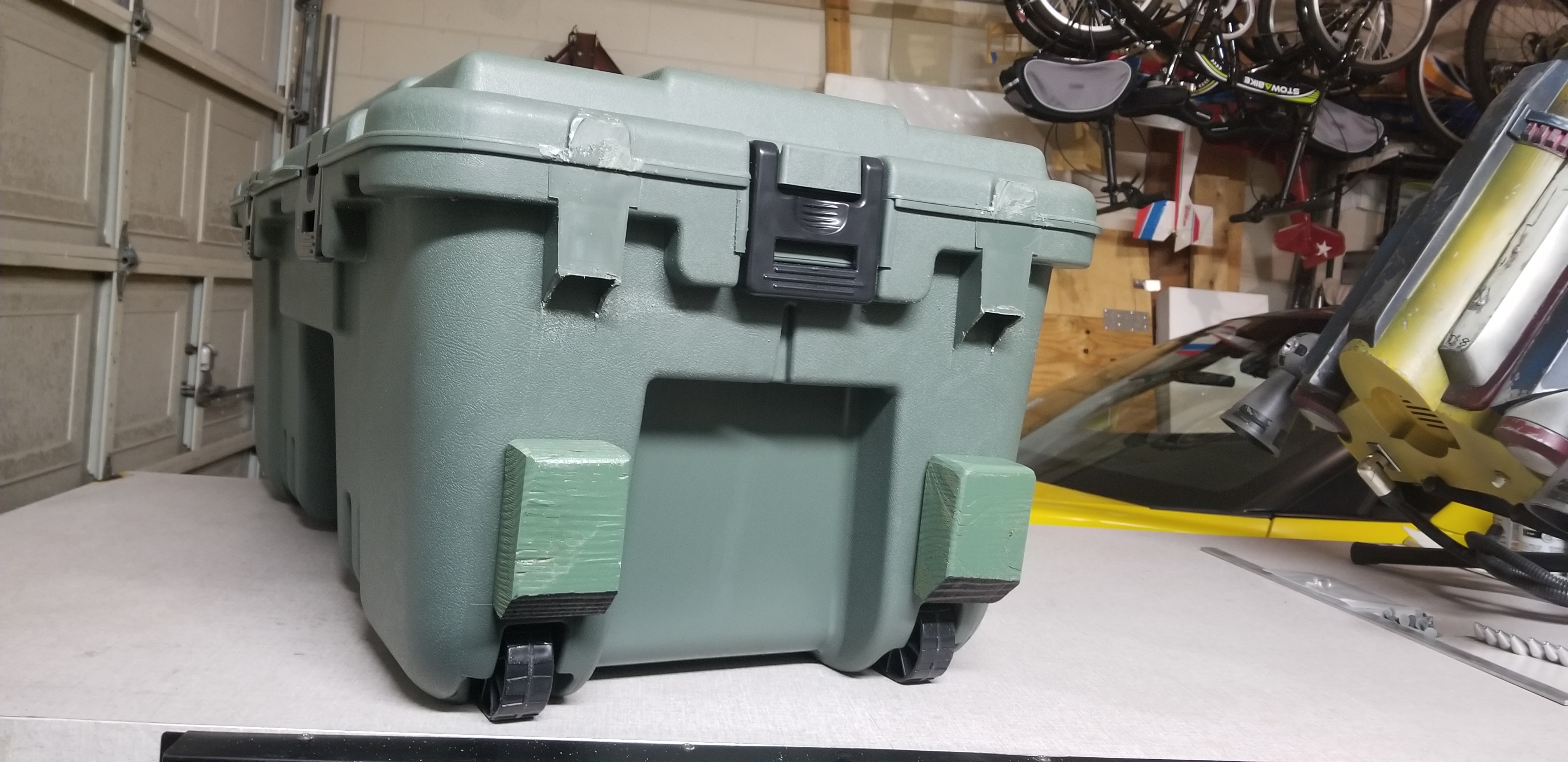

Here is my storage / travel case. I got it Academy Sports for $20.
I cut off the molded hooks on each end since they were just in the way and added feet to allow it to stand on end and not fall over.
I added a folding handle since the molded handle was too low, I would kick it with my heel when rolling. The folding handle gives just the right amount so not to kick it. I could have done better with the bends, but it works.

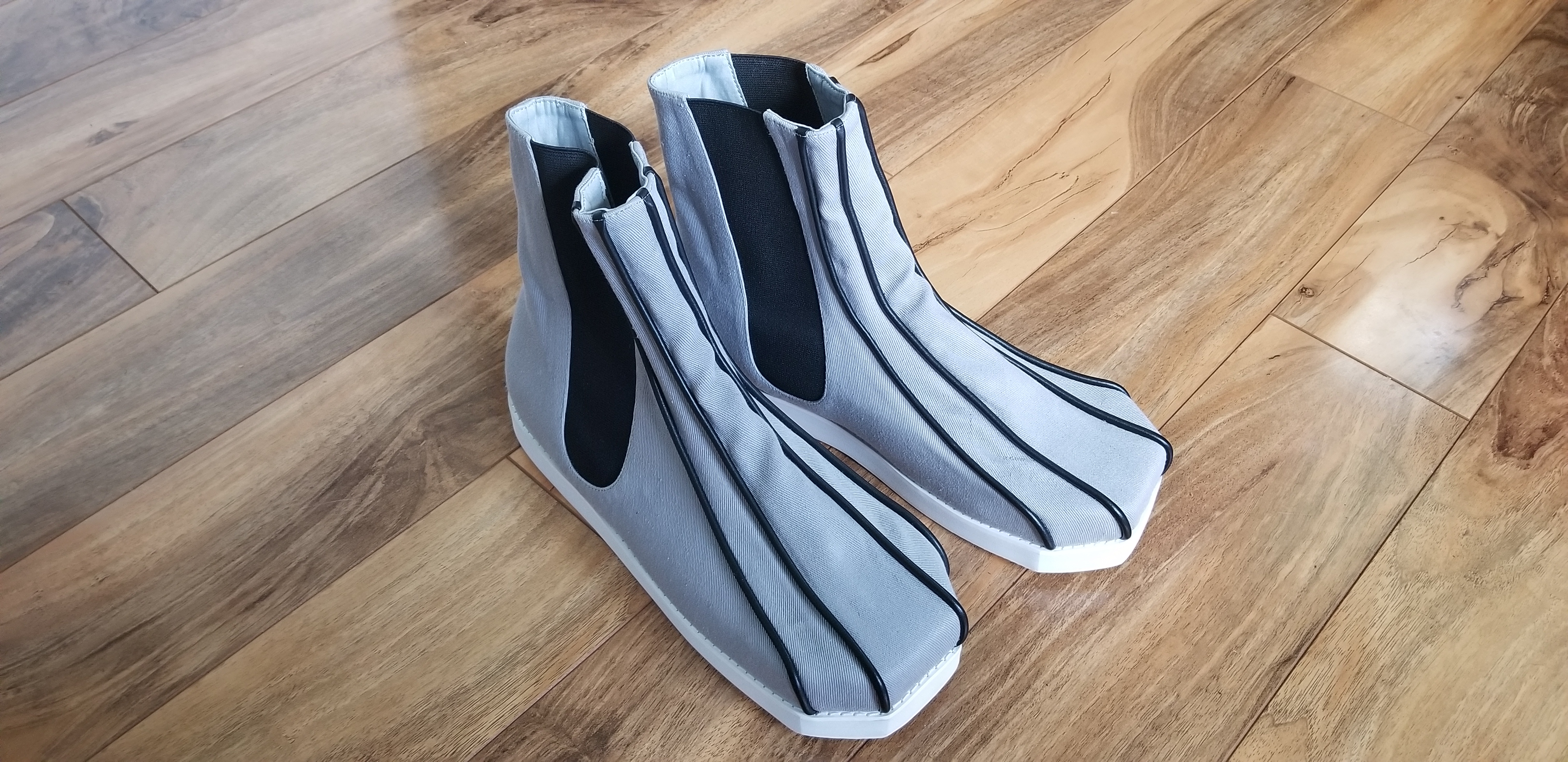

I forgot to mention that the boots came with a free gift.....Toe Spikes!
I won't be needing to 3D print them now (even though I already did). Face palm.
The spikes that came with the boots are stainless steel which is good, but they are glued to the plate. It looks like JB weld to me. No other hardware holding them.

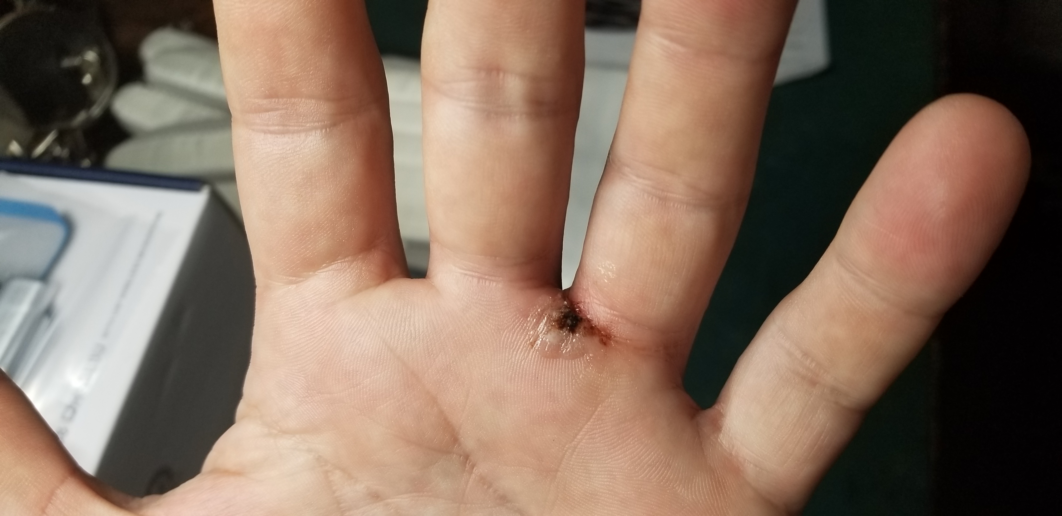

While adding a slight bend to the plate to make them fit the boots better 3 of the 4 spikes popped off. I have JB weld, but foresee them falling off during a troop and being lost. I decided to drill a hole in the plate and tap the spikes so I can bolt them on.
During the modification I slipped with a the Phillips screw driver and stabbed myself leaving a perfect + in my hand. A few cuss works later and some liquid bandage and I'm back to it.
