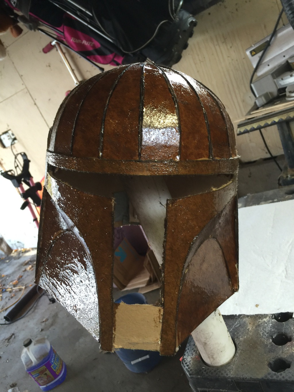

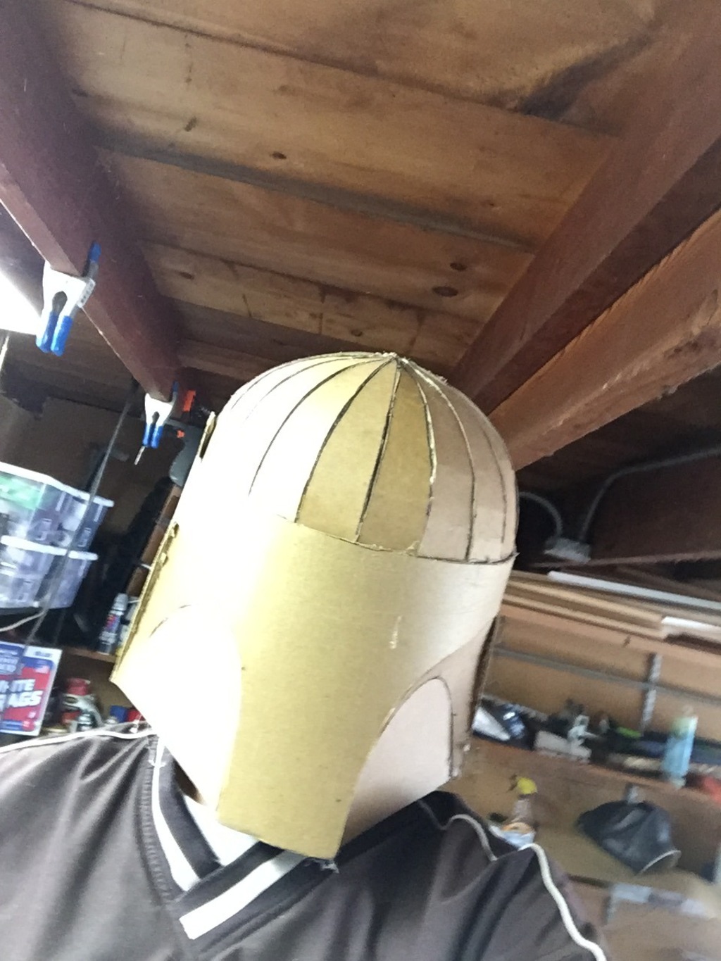

I made the helmet out of cardboard.
I then resined it and am waiting for it to harden to probably glass it before bondo.

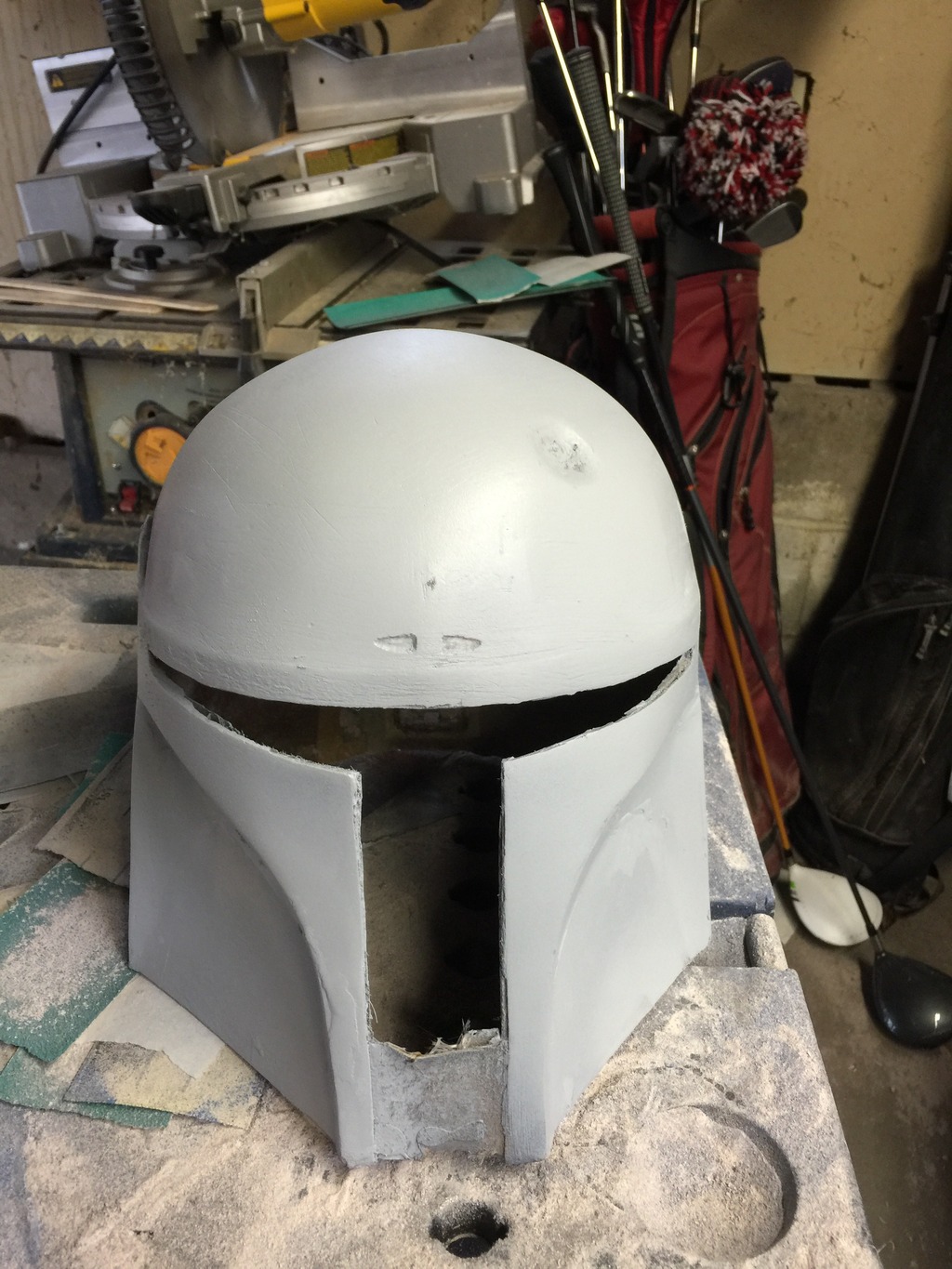

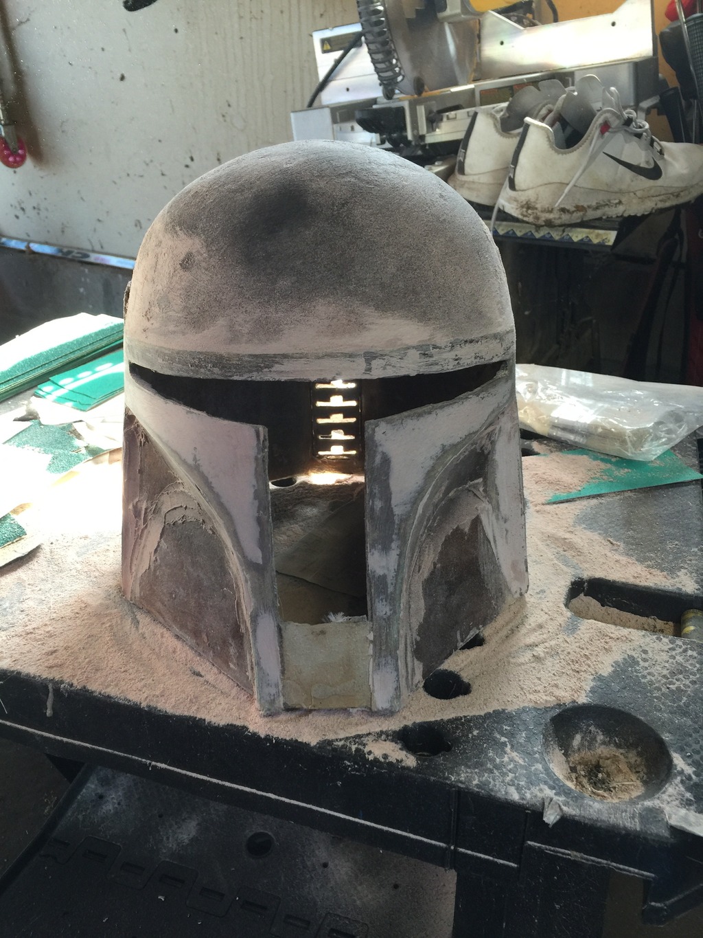

So after a whole lot of bondo and sanding I'm here with the helmet.
It really is a ridiculous amount of sanding.
If I were to scrap this at this point, who should I buy a resin/epoxy/fiberglass cast from around here? I see a few on eBay, but in my experience on the SLD, you really shouldn't buy almost anything off eBay. That is almost universally true for a Vader build.
For Fett I'm still a novice. Any suggestions on items appreciated. Like, where can I get good/decent cast ears for cheap? I really don't feel like building them and I'd like a working range finder.
Thanks for looking.

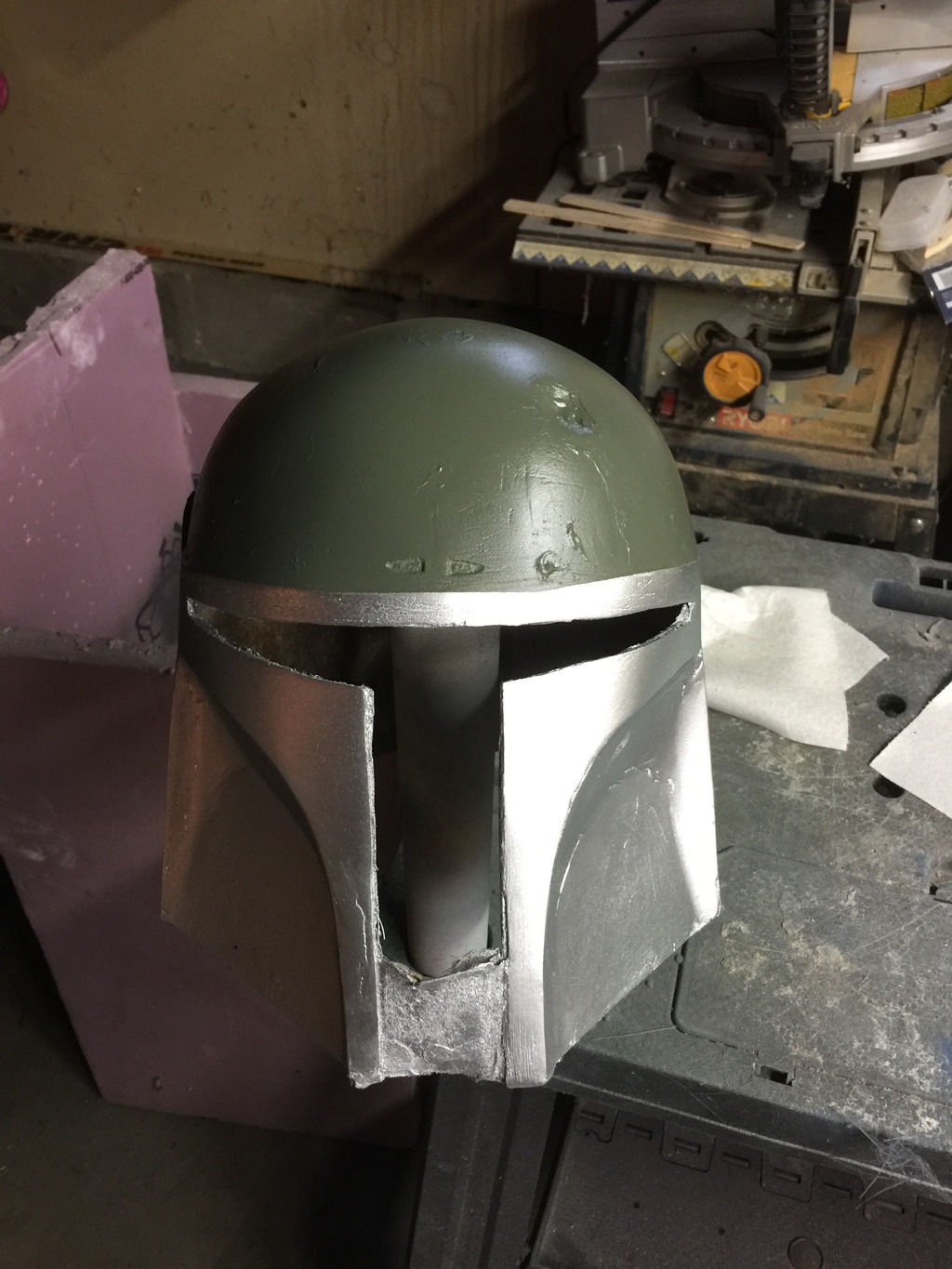

I'm getting closer. Too much sanding and messing the bondo up, I eventually just say to heck with it and move on.
I put in the arrows and the bump and primed the helmet:
Then I painted it a nice shiny silver:
Lastly, I painted the back and the top. The toothpaste is still on there until the paint hardens except for the spot where the stupid masking tape caught it and pulled it off.
I don't think I'm sold on these Krylon colors. I bought them one day when I was at WalMart as they didn't have the rust oleum colors I wanted there. But then I didn't paint anything for a week and saw at Home Depot they have all the rust oleum colors I wanted. So I went to return the Krylon stuff and I seem to have thrown my receipt away. I'm not going to take a $20 bath on the paints, so I'm making due with the Krylon stuff. I don't think their Hunter Green is dark enough, even with a black paint base.
So, as I asked before, where do I buy ears and range finder around here? I can't figure out WOF's template for the ears. Unless I did them in wood, which I may have to. But I'd really like a RF that folded down and up.
Any help would be appreciated. Thanks for looking.

I can never seem to get the bondo to work for me. Too many air bubbles? Too thick a coat? No idea.
On this build, even after having the shaping of the helmet done by a career body man, I still got down to the cardboard structure on the dome and those look furry. I've tried these helmet multiple times and I just don't get bondo.
So I'm still hunting for ears. I'll check Rafal's build.
Bondo can be tricky, and its rare you get it perfect the first time, but I sand it with my palm sander and then add a little more to fill the bubbles and such. Also I use polyurethane to seal the cardboard to eliminate the furriness for the most part, although I've found that reapplication can be necessary where you've sanded the cardboard. You just have to bondo and sand, bondo and sand, that's how it works with these helmets.
How I've always seen done is to resin the outside, then fiber the inside. Then bondo.
Unfortunately, I've sanded so much in places it went through the bondo, through the resin, to the cardboard. Not nice.
But, it is what it is. I'm almost done painting it. Boba's helmet is supposed to look beat to heck anyway.

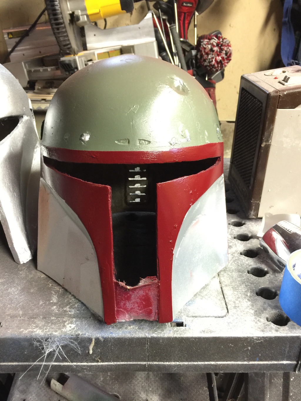

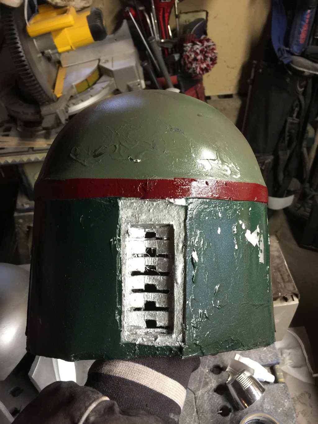

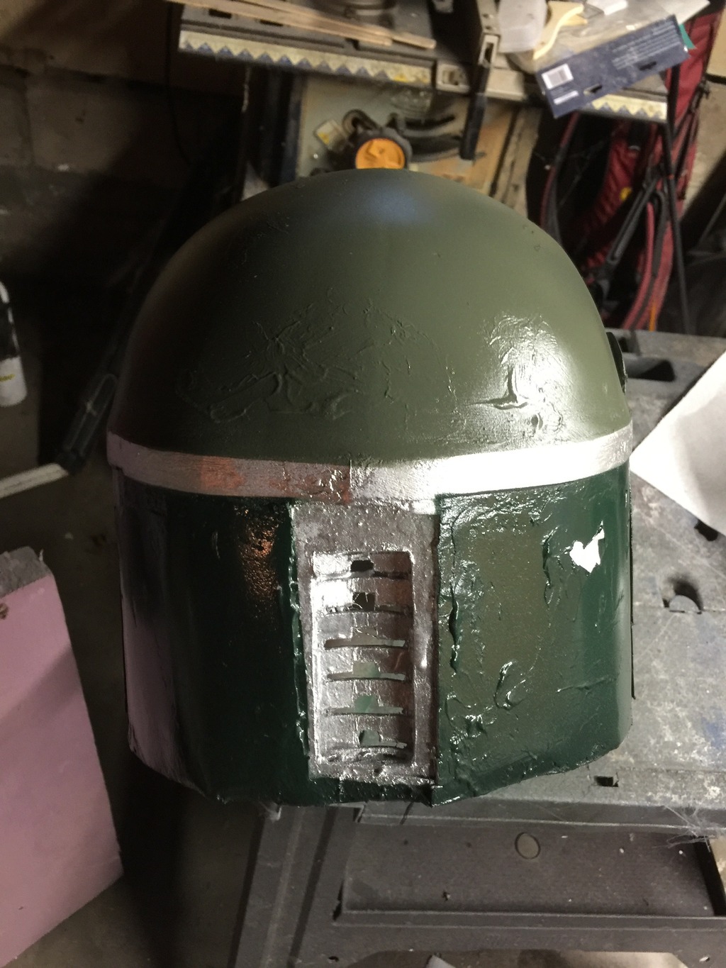

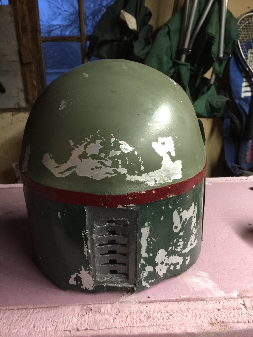

Another day, another day of painting. As I said earlier, I had some Krylon colors. It was time to do the red. I put on the first coat and it didn't seem very shiny. Cool. Put on coat 2, same kind of rusty red look. 3rd coat, the wet coat, it just isn't looking correct and I read the can. It's a rust red primer. Ugh. So I was off to Home Depot to pick up the Claret Wine by rustoleum. Here it is now.
and the back:

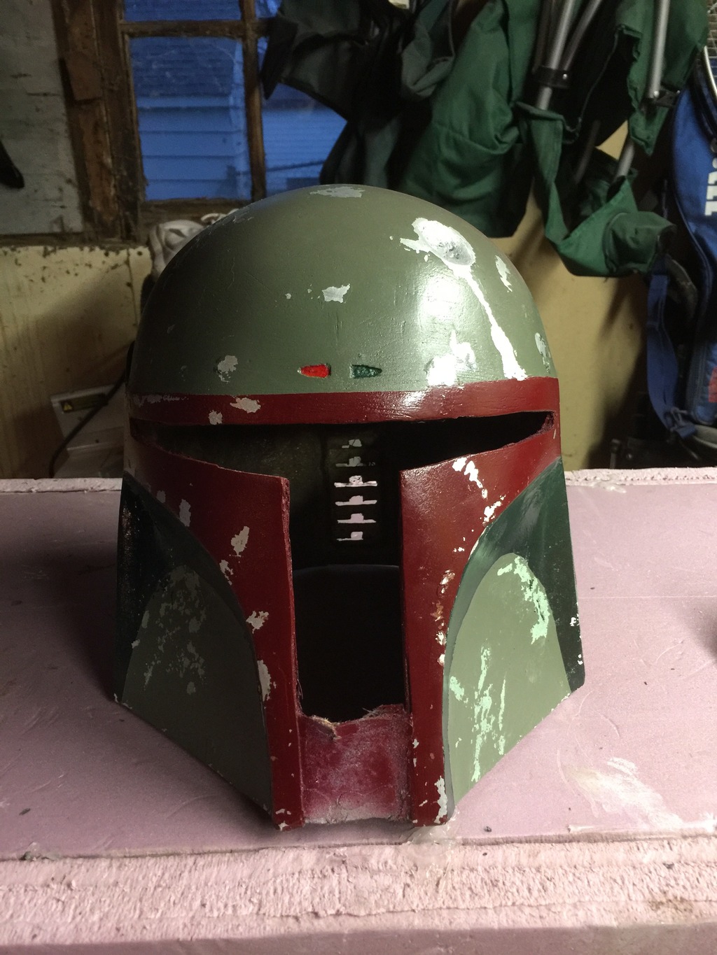

Some of the toothpaste has come off while pulling tape from masking. I think it's going to look pretty cool.
The hunter green on the back panels is also the green on the upper cheeks right? This green doesn't seem dark enough. I bought the rustoleum hunter green on my trip just in case I need to redo it.

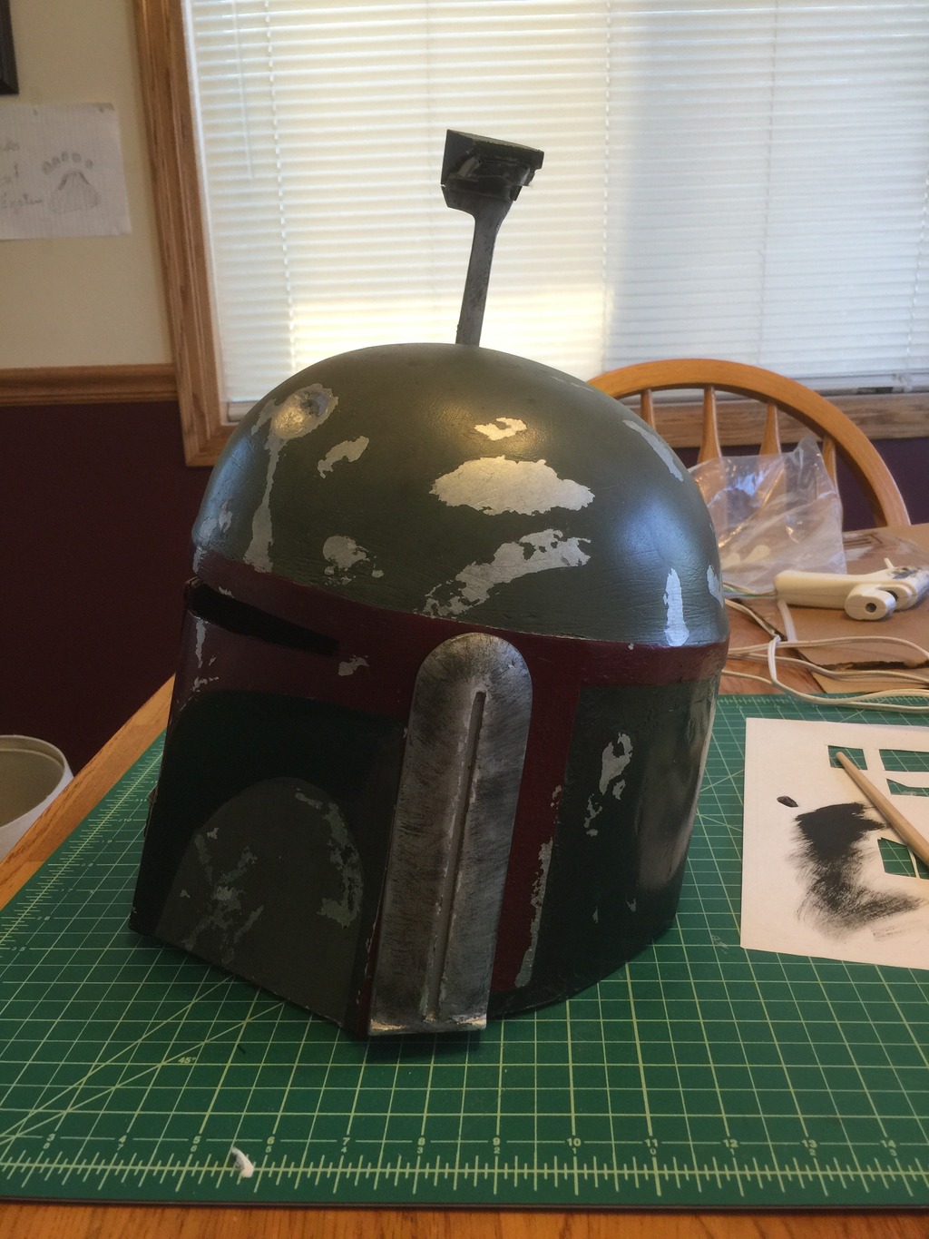

Finished the painting and took off some toothpaste. Just need a black wash and some ears. Anyone sell ears around here? I'm surprised there isn't an ongoing run in the cargo hold. Some pics:
I suppose I'll try to make the ears with Rafal's design. I can't figure out the WOF ears.

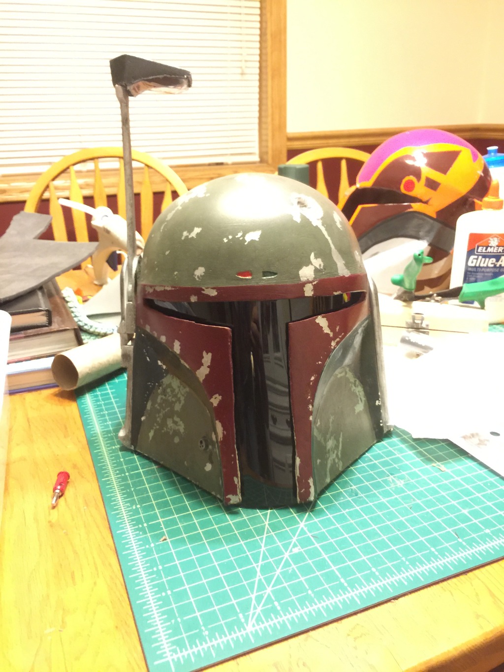

So, since nobody wanted to sell me any ears, I completed mine they aren't much good, but I made molds of them anyway as I never want to do that again. The molds took me extra time, but at least I never have to worry about ears again.

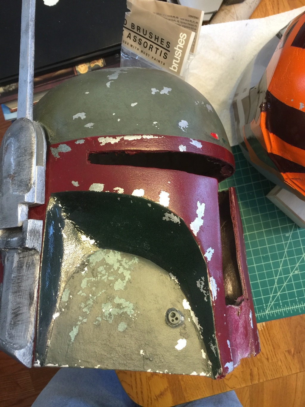

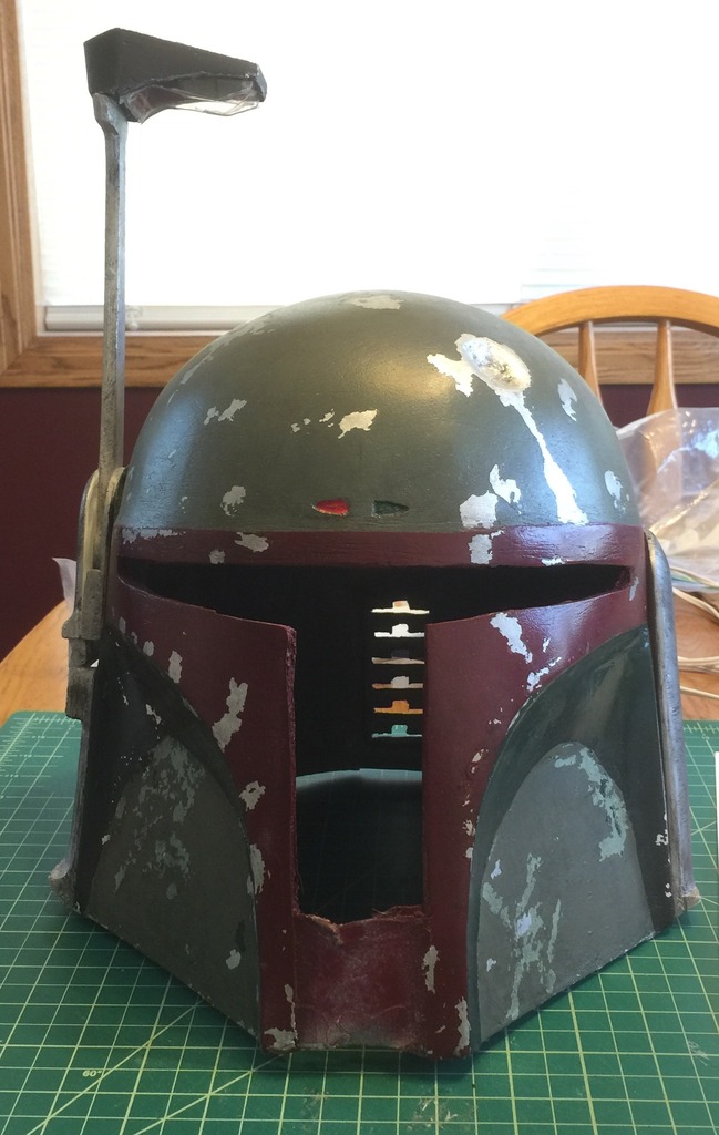

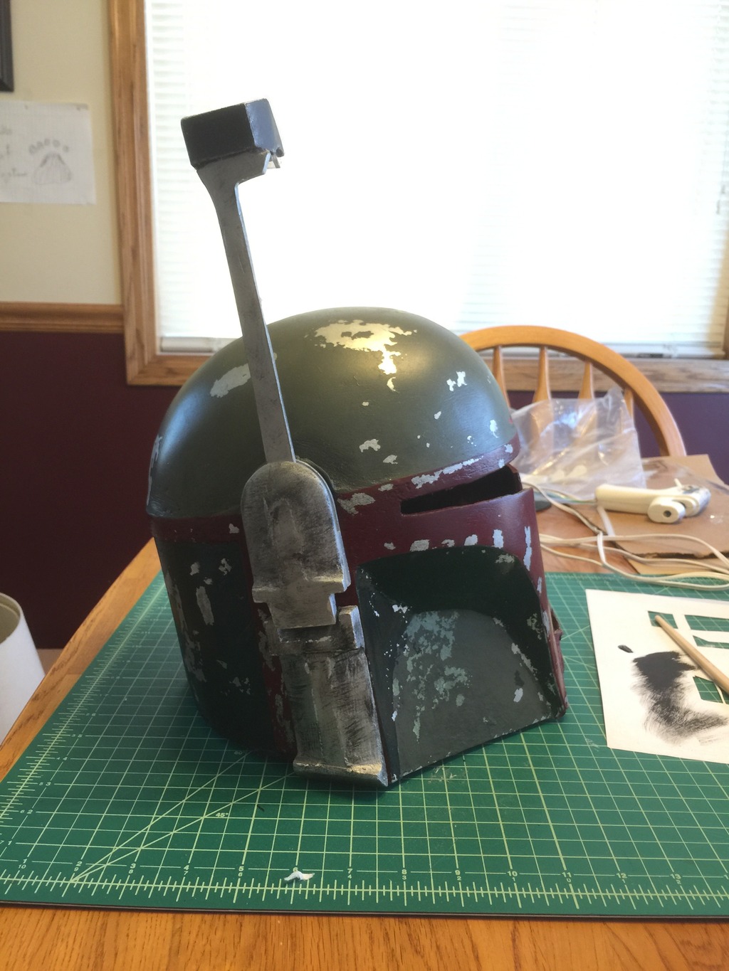

Anyway, I'm just about done with the helmet. A Borden connector, some dental files, a visor and some dull coat and I think I'm done. Here it is now:

I've still been working at it every day for the most part. I'm just about to a point where I can say "good enough" and move on. I'm just waiting for the kill stripe decals to get here, then I can dull coat it and be about done.

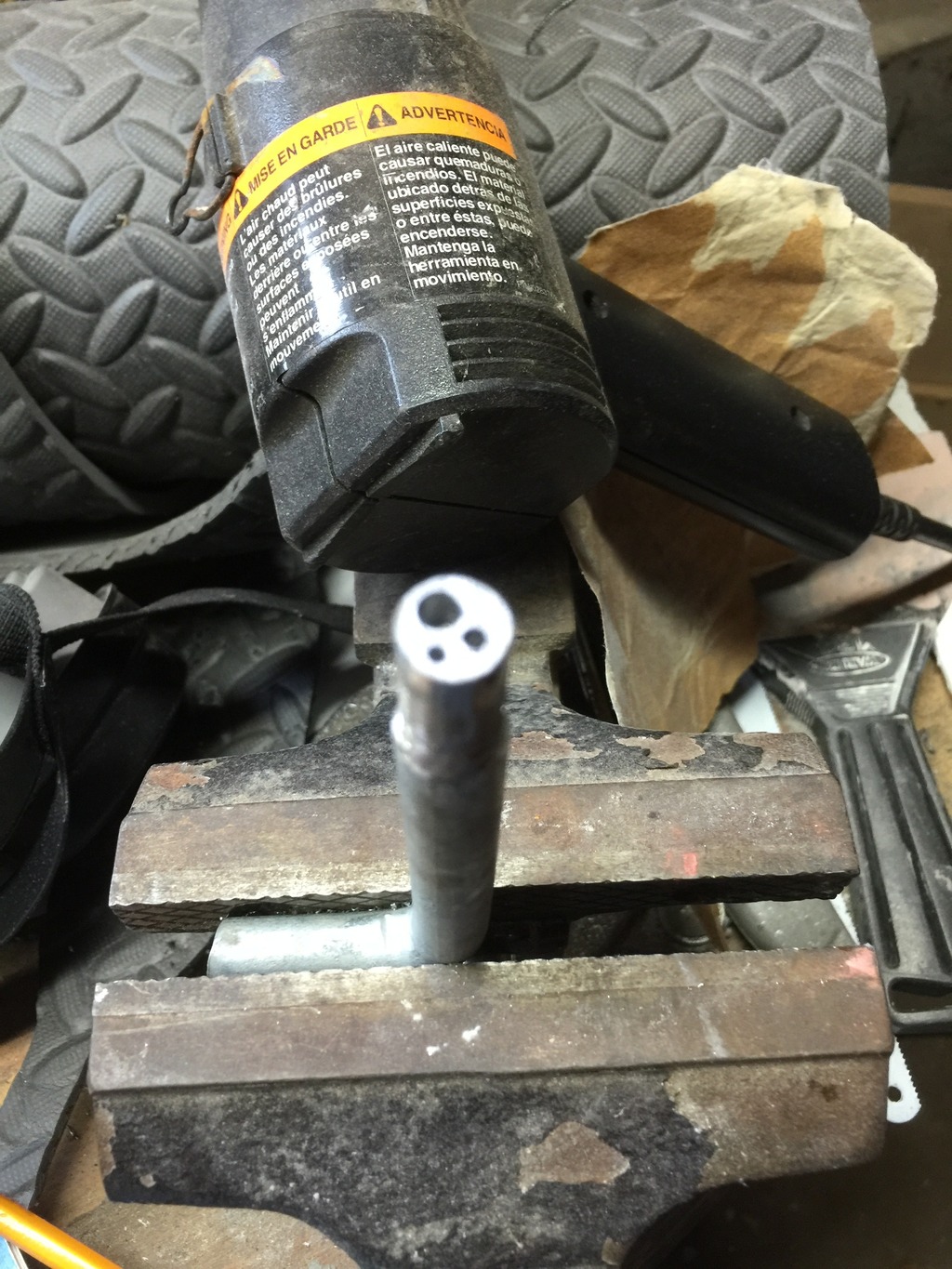

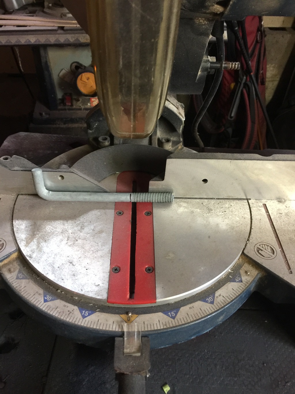

Yesterday I made a Borden connector out of cardboard and the results weren't very good. Last night I saw this thread: http://www.thedentedhelmet.com/f23/...n-connector-53673/?highlight=Borden+connector
And I said "I can do that." Here's that process. It certainly wasn't as easy as in the link.

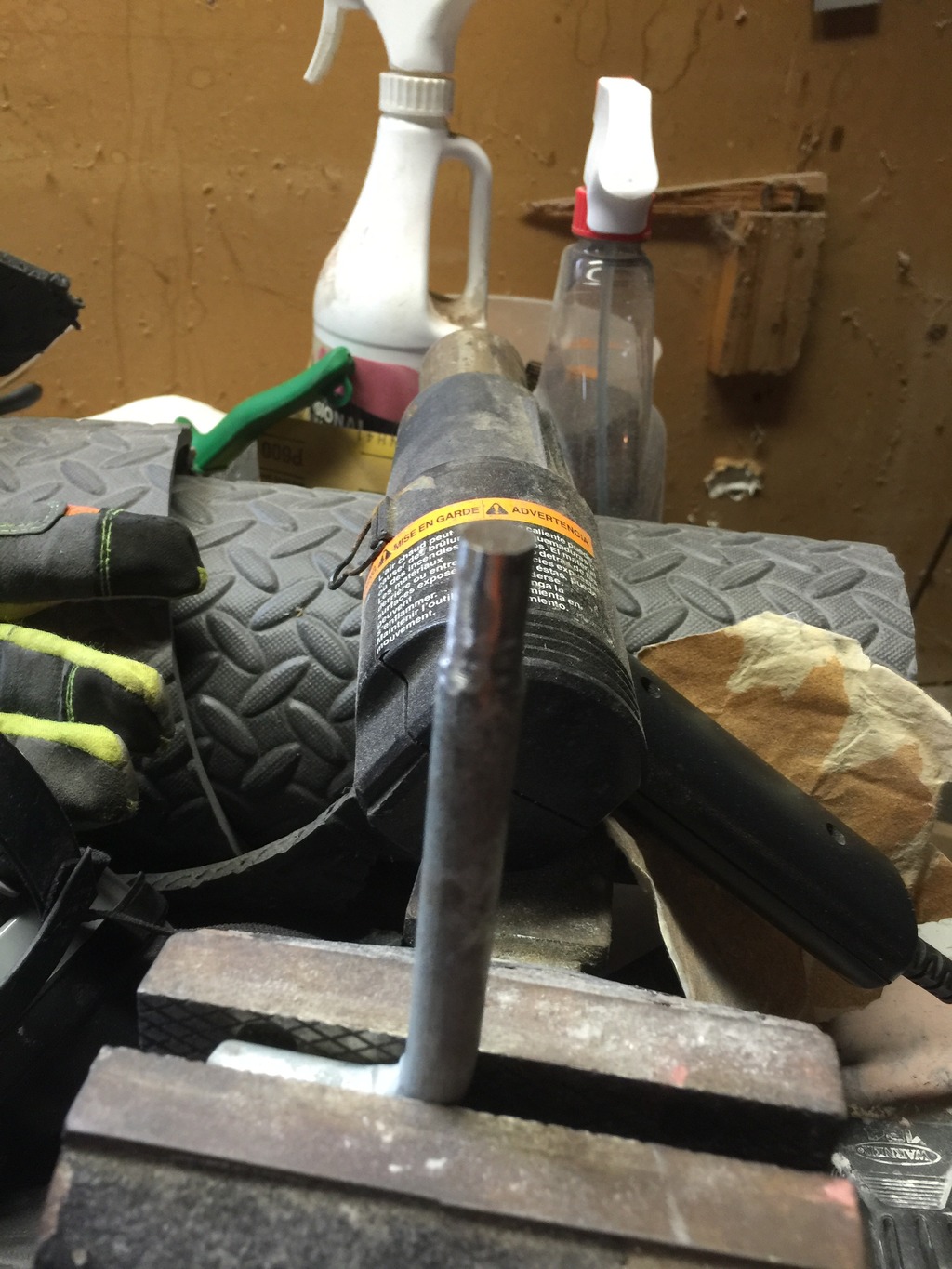

First mistake is I bought a 6" bolt instead of 8". It's more than enough, obviously, but it's way less to hold onto when turning it. Buy the 8". Also, I'm cutting the bolt with my chop saw metal cutting blade. 1/2" thick steel was not the target thickness for this blade. Took forever, got extremely hot etc. it worked, but I wouldn't do it again on here.

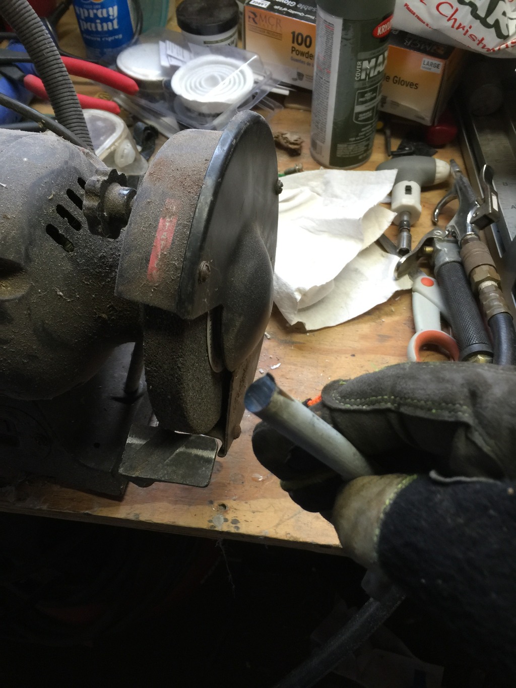

Next step is grinding. For a Borden to peak through the face, you don't need to go into the grind very deep. I was going about a wheel, which was an inch wide. WAY too wide. Do about 1/2 a wheel of turning. Goes very quickly.
and here it is after grinding.
No pics of the drilling, but here it is. Only broke one 1/16" bit.
I then had to cut it off again, which was horrible. I had to grind it way way down as it was way too long to go into the helmet. Finally I wooled, sanded, and primed. Then painted and weathered.
Here it is installed and the second pic is with a that is installed. #5 darkness visors are way too dark. Time to try something else.

Today I only had a little time so I spent it trying to get the mask to sit better and trying to pad out the inside to sit on the head correctly. There really isn't a lot of room in there for a fan system.
