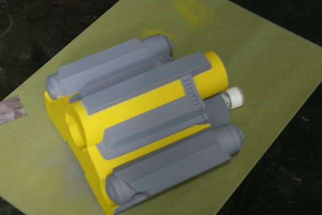

Hi all - what with all the projects and the old bread knife I have not had a great deal of time to up date this - sorry Phil.
So here are some updates.....more coming later.
Yellow first.
I used Revell SM310 for the yello in the end.

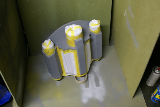

Masked ready for the blue.....
.which is almost done right now. Will get the next photo on in an hour or so.
In retro-spect... wouldn't it have been more prudent to dust your yellow areas with the orange before you masked it off to shoot the blue? It would save you having to re-mask that area.
Just a thought I had.
I concur with the yellow. The pic of my jet pack look funny, looks like it been edited in photoshop, must be me. lol
What with the white bits on the bottom of the blue spine Rob?
You painted the rocket and thrusters and the back of the jet pack?
