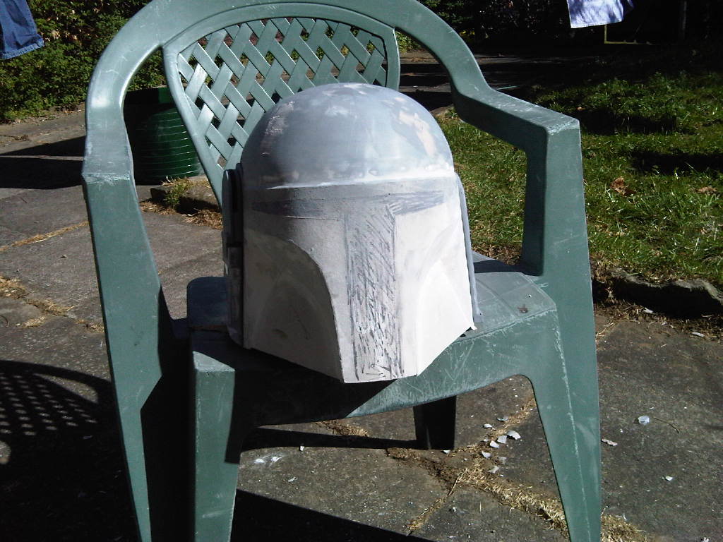

So, whilst I'm waiting for the filler to dry, (and having a well deserved beer, lol) I thought I'd register and show you guys the progress so far.

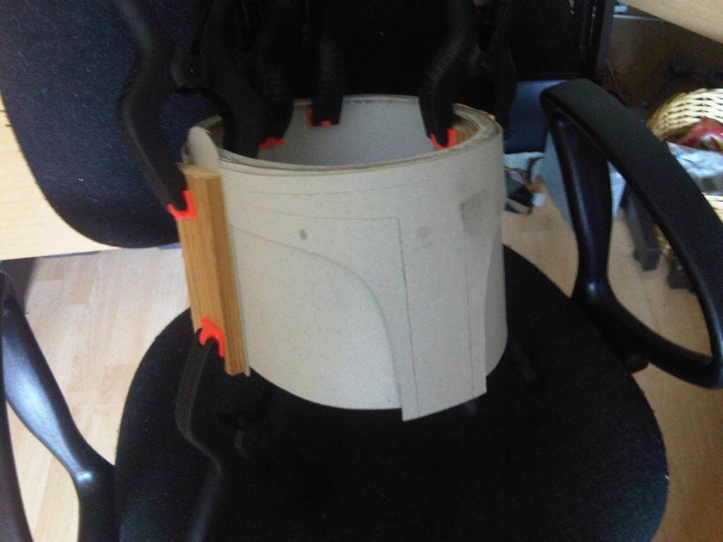

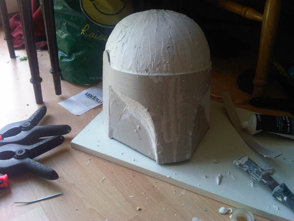

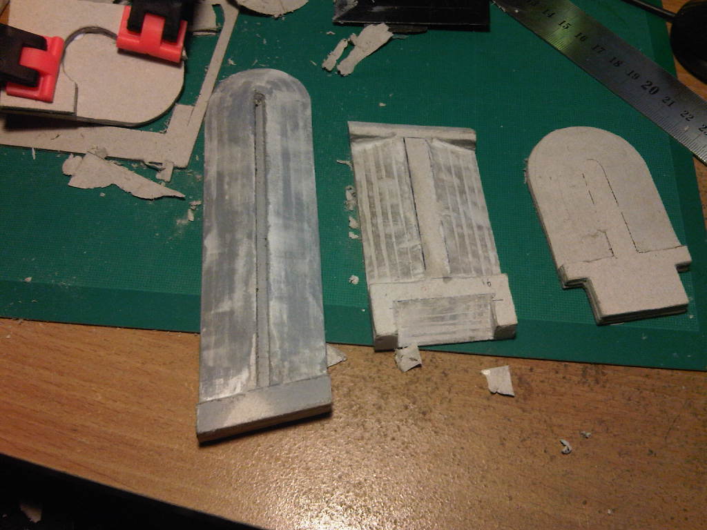

Thanks again, :-) I've been at it again today; again following in AntMan's steps... Hard to believe that these have taken the best part of all day.
bucketbuild

One thing I have noticed is that no matter what grade sandpaper I've used, it furs up the cardboard. I'm thinking of painting a thin coat of resin on the surface and letting it soak into the card after the pieces have been filled, sanded and shaped. Hopefully I can then sand to a smooth finish. I'll give it a go this evening after work.

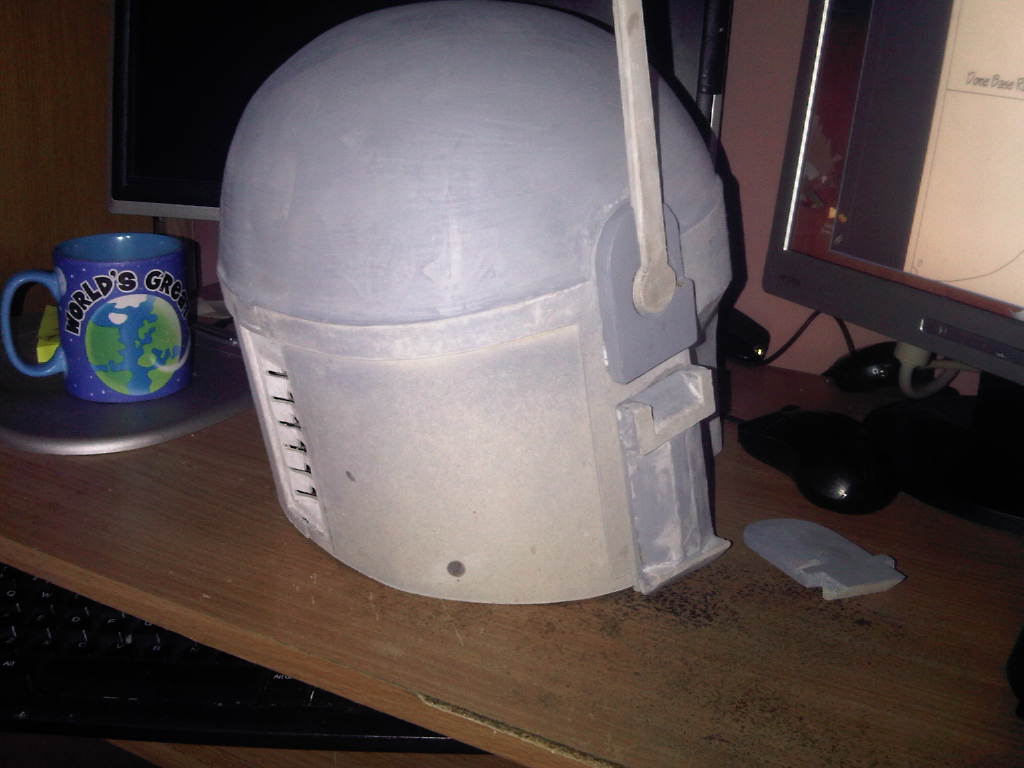

Well, I've been sanding, filling, sanding, priming, filling sanding... all day long, but it's beginning to take shape.
I've also put some fiberglass inside the dome and behind the cheek plates to help it keep it's shape during the sanding & filling.

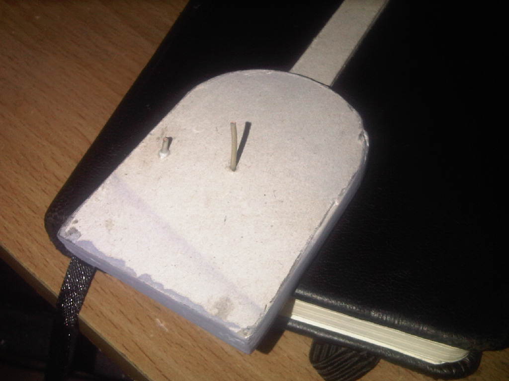

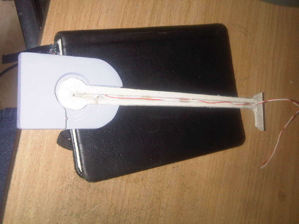

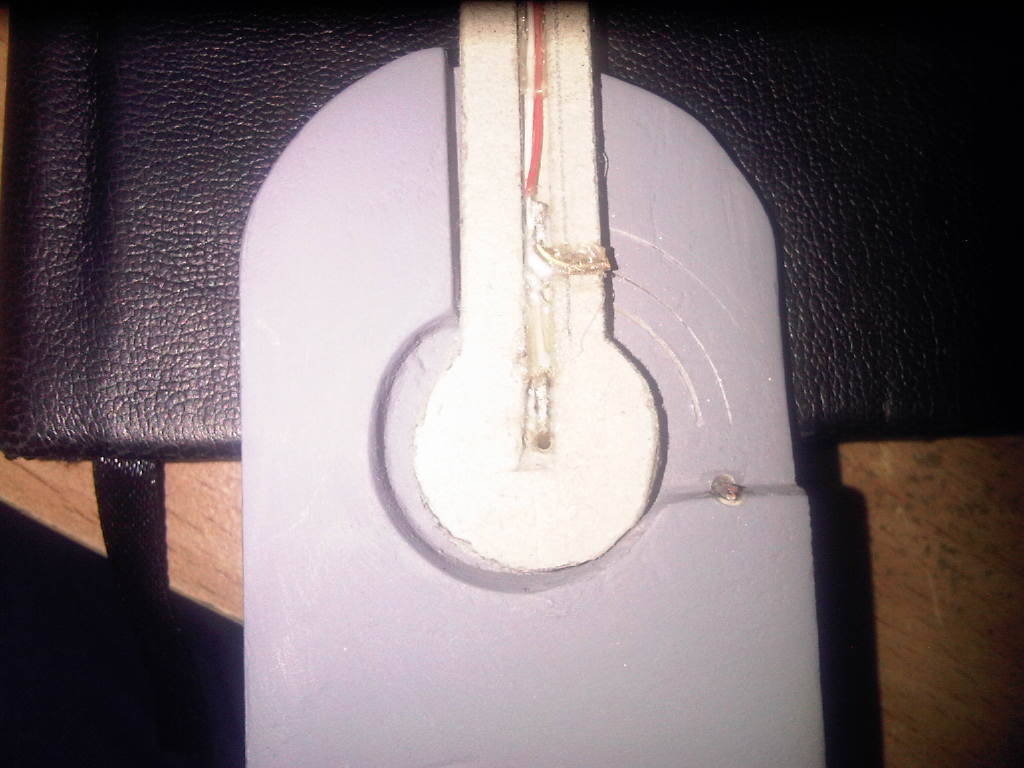

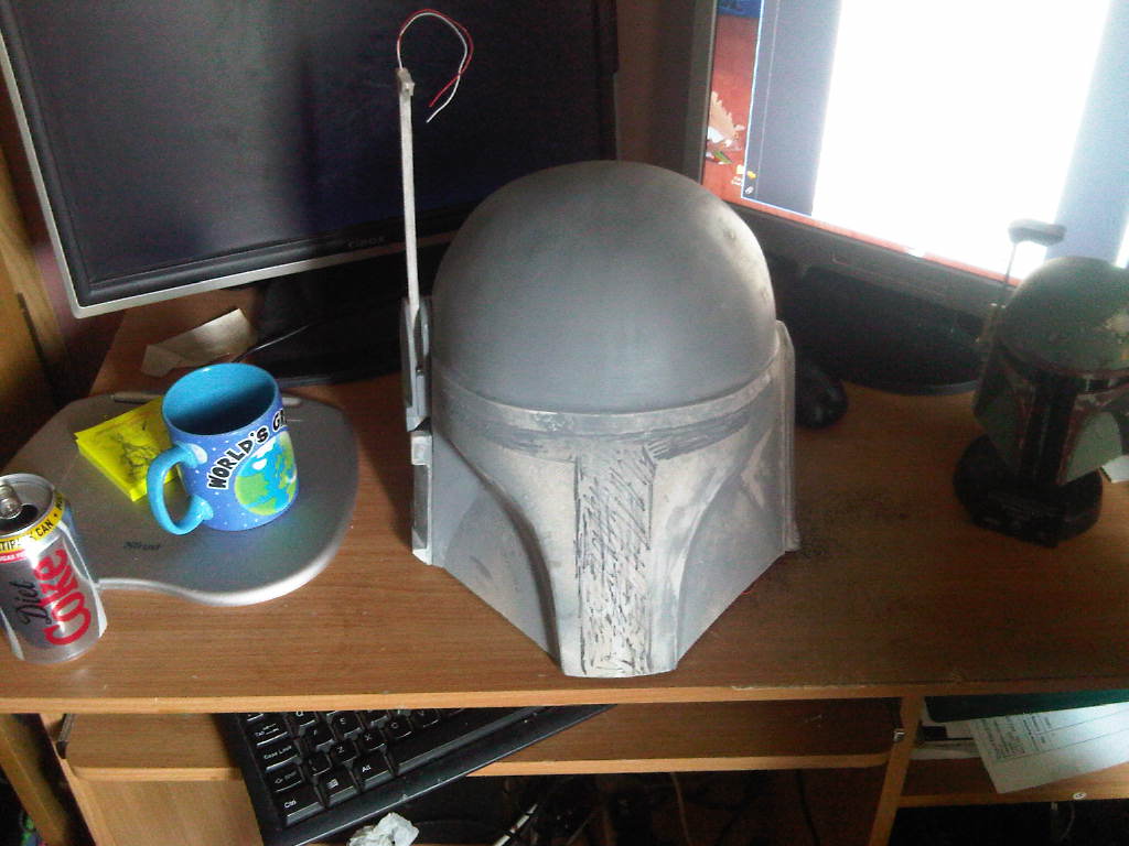

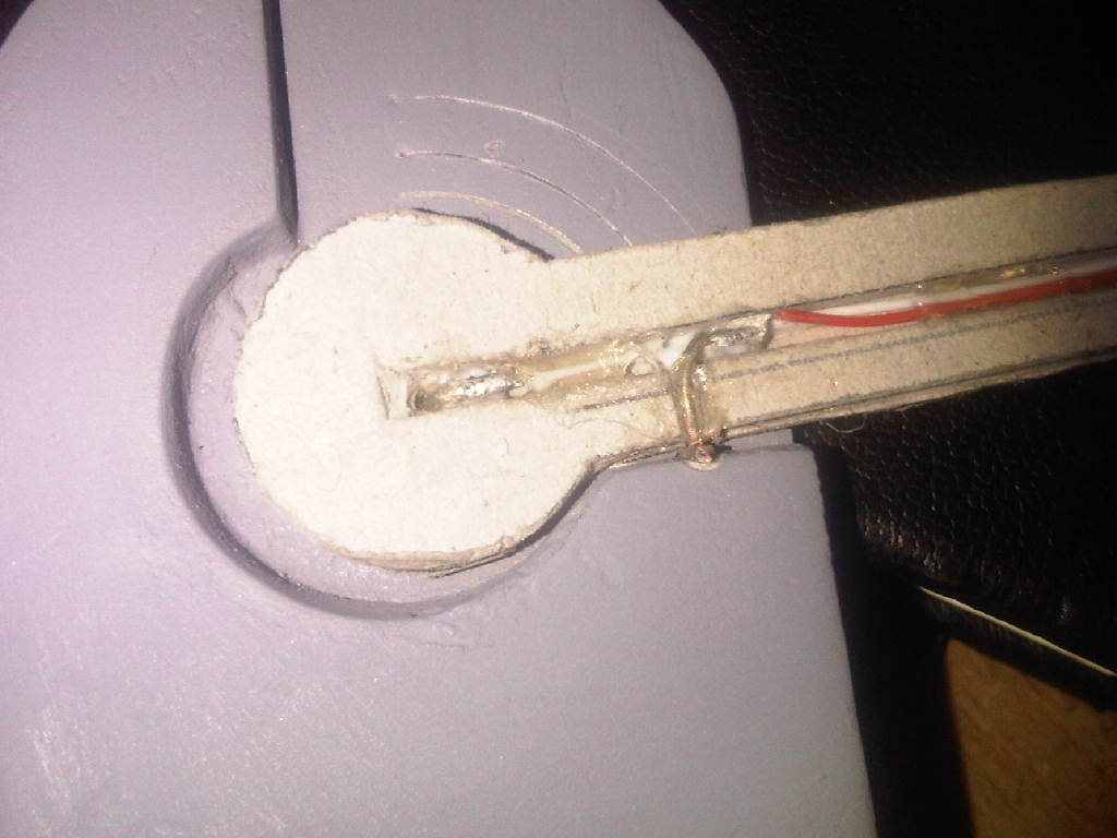

I got a little further today; Rangefinder Stalk & wiring and the keyhole slot cut and fitted in the back.
The switch I decided to do a little differently, with a single point of contact, only switching the +V line.
The pictures should explain better.
