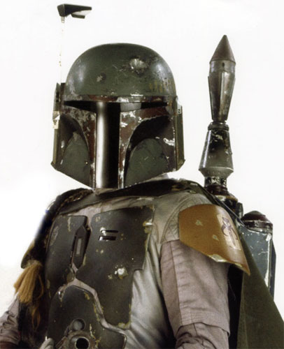

Here are a few studio photos that show the helmet color in more natural lighting:

The ESB helmet in the SE shots is the same helmet that was used in ESB. The helmet has not been repainted or reweathered. It does have some additional scratches, caused by peeling paint, and dirt and grime, caused by poor handling and storage. But the base colors remain the same as they were in 1978. Photographic stills taken on set are very deceiving. Trust me, you arent alone. I know many of us struggled to adjust our perception of the helmet after we had natural shots of the suit and helmet to contrast the flashed-out tour photos.

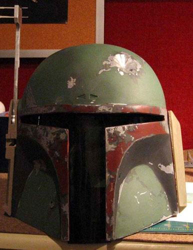

Below is a progress picture of one of the first, if not the first Fett helmet RS painted. Notice that it is a dark photo and Panzer Olive green looks pretty light and "right" in the photo.
