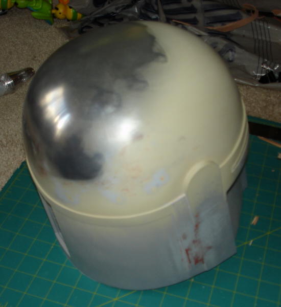

My BKBT required some sanding and a secomd primer layer before it was ready for a shine with R&B. I wet sanded the second primer coat with 600 grit and applied a test coat of R&B just to see if I missed and fine scratches left by my sander. Below is the results of the test application of R&B.
Although my helmets come with a sandable surface primer coat, to achieve the best results wetsand, prime, & wetsand again. If you use a sandable primer that builds up on the surface, any minor blemishes & low spots will be filled & the surface will be smooth.
