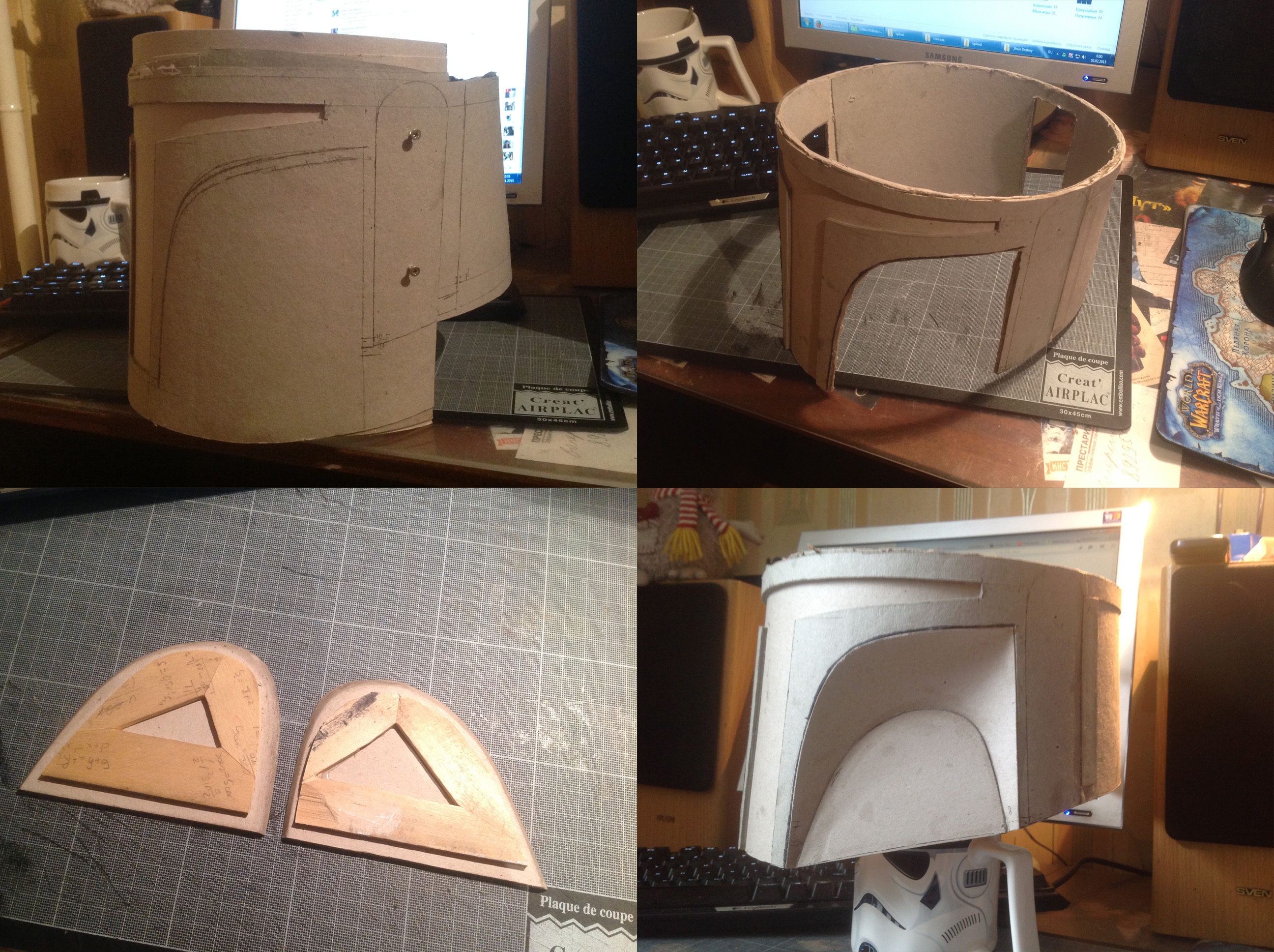

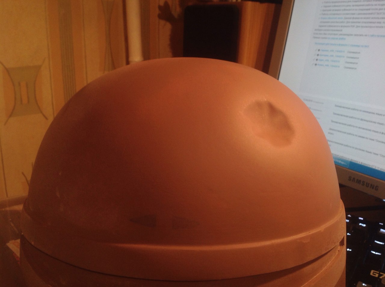

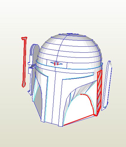

I really like the helmet of Boba Fett and in the process of working on the costume I made helmet based on Pepakura.
he111.jpg he112.jpg he1123.jpg he1125.jpg he1126.jpg View attachment he1127.jpg IMG_7235.jpg Фото0267.jpg gL9G83vX0mE.jpg

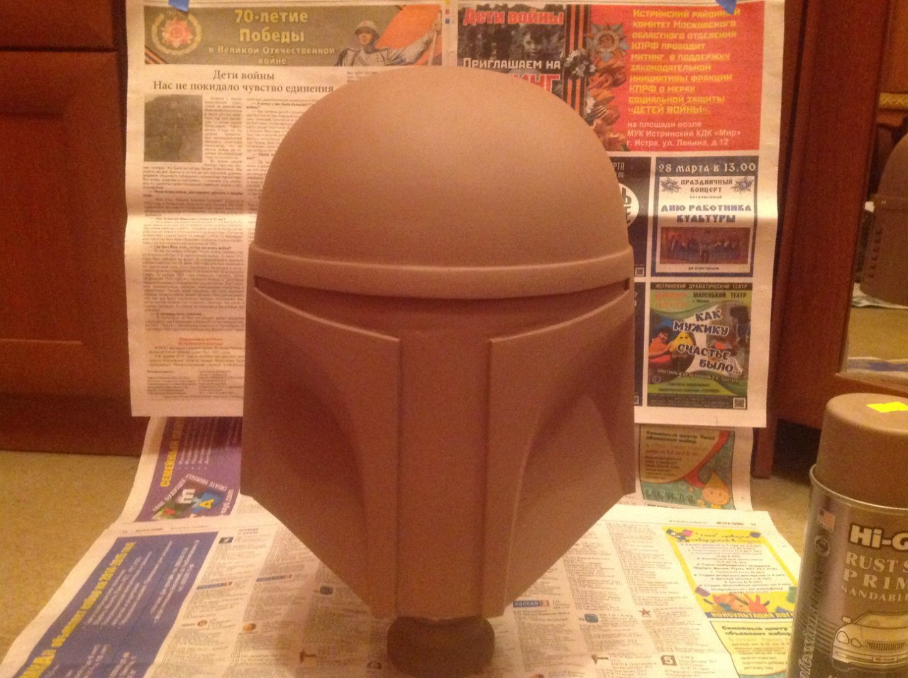

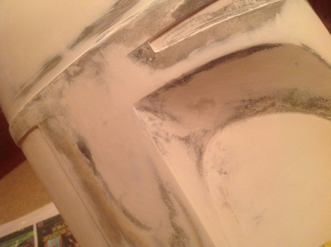

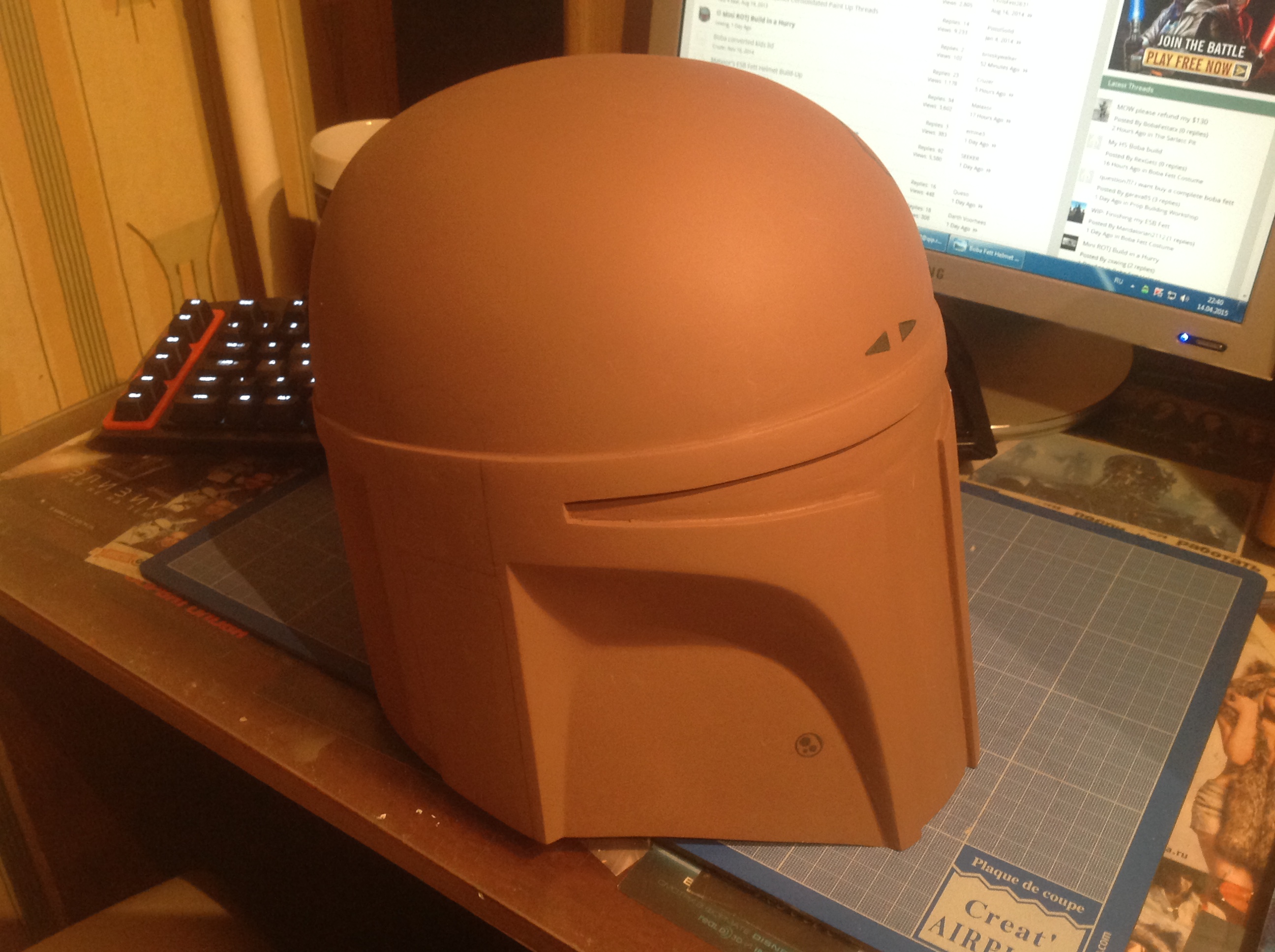

I made a lot of changes, but their was not enough, the helmet came not accurate and a small size, but I believed in themselves and began the second.

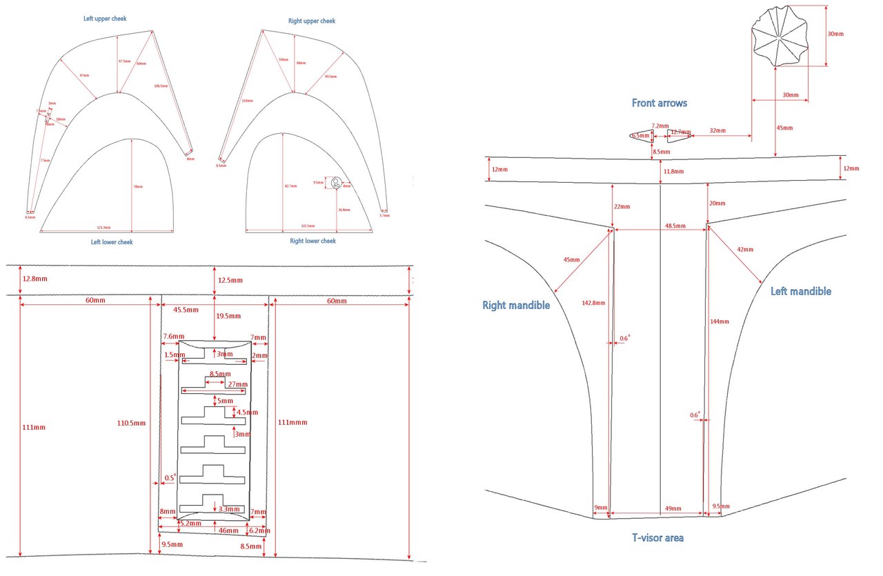

Second helmet doing in size and pictures found on this site +/- a few millimeters
IMG_0809.jpg IMG_0811.jpg IMG_0812.jpg IMG_0813.jpg IMG_0814.jpg IMG_0815.jpg IMG_0816.JPG
WIP )

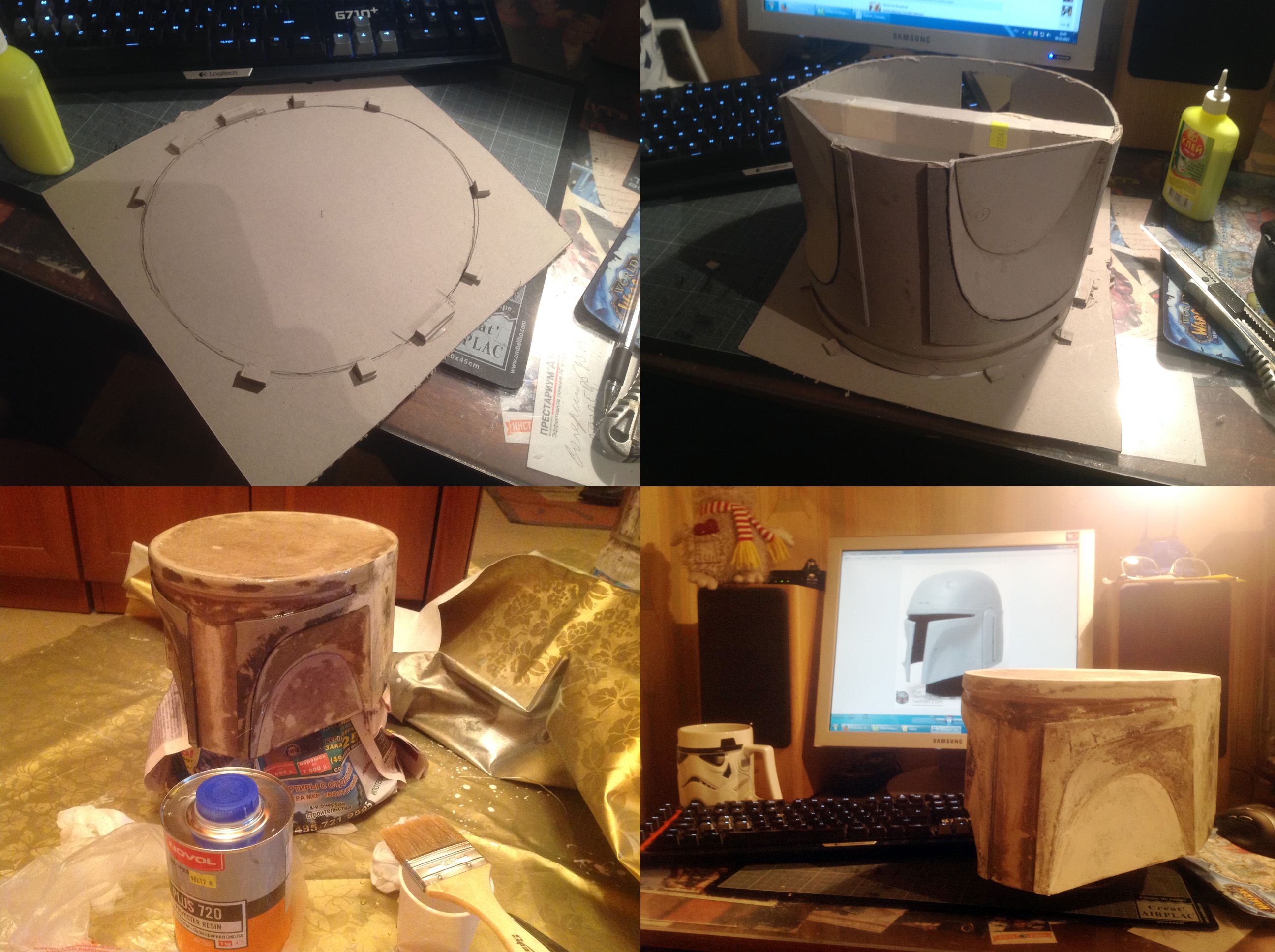

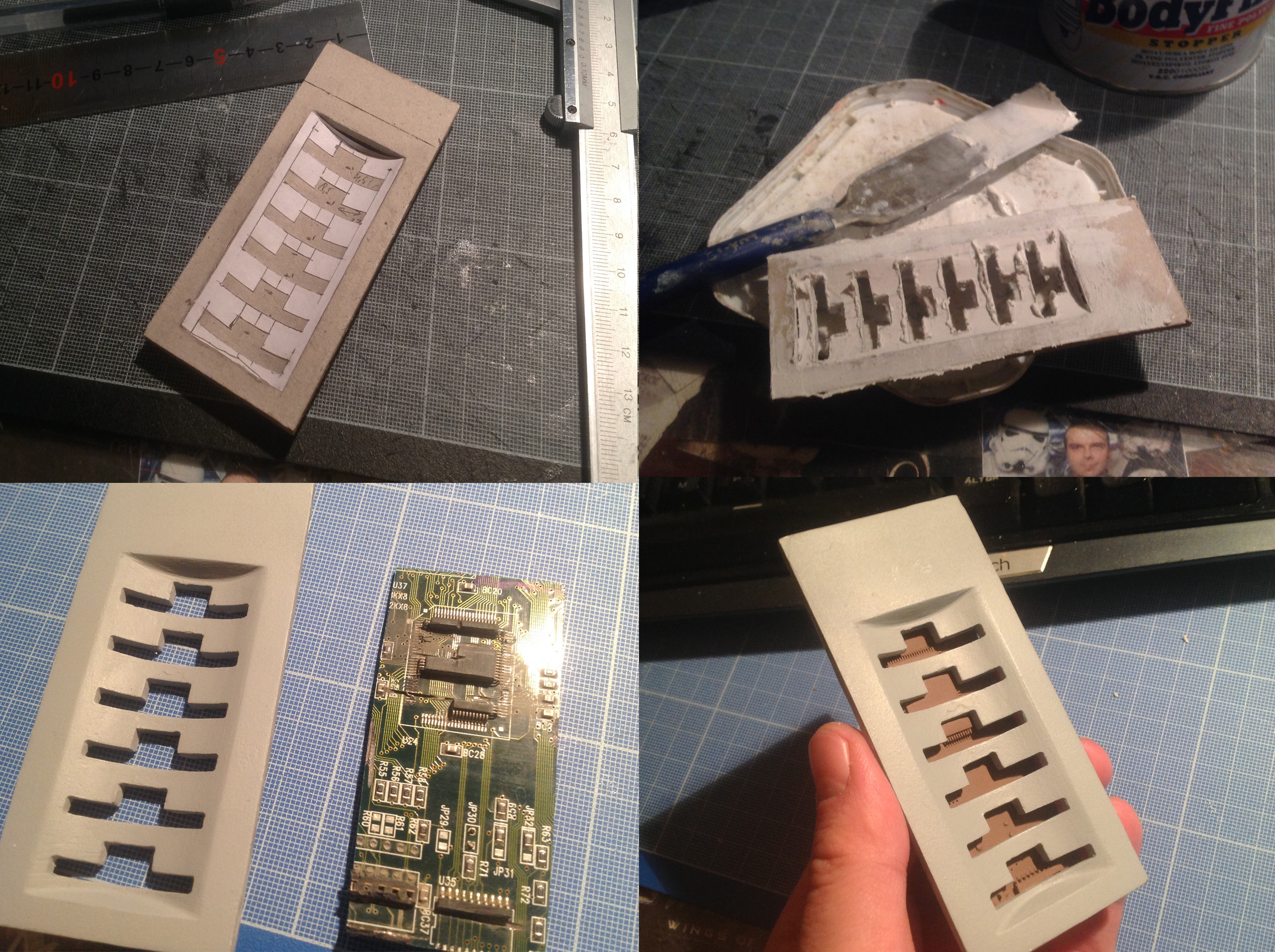

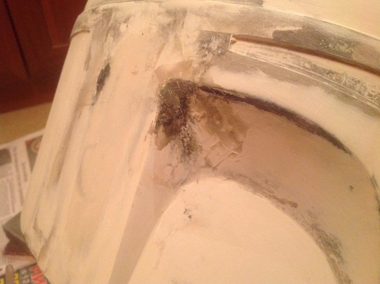

What did you use over to cardboard on your keyhole? And what did you use to sand it down? It looks so good, I'm struggling with mine lol
Uhbif

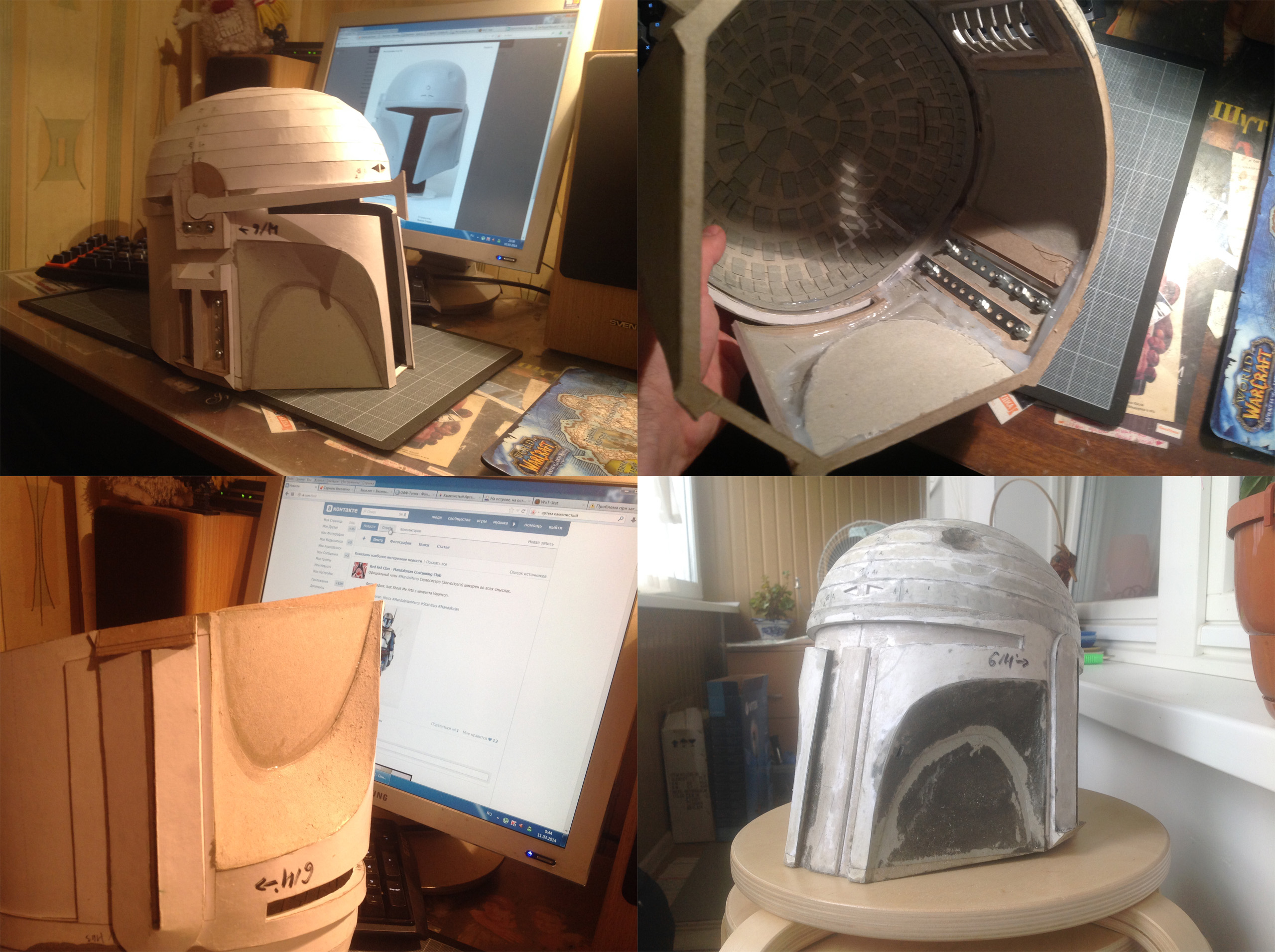

1 - paper model
cardboard 0.7mm x 3 layers and PVA glue
(this glue is absorbed in a cardboard and becomes very firm after drying and perfectly holds a form)
2 - polyester resin
(this thing is dangerous to health, I use it because I'm not going to wear a helmet on my head)
3 - polyester car body filler (I used bodyfine)

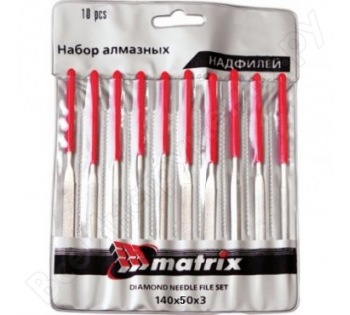

4 - grind before installation, because it is more convenient and better result
(diamond files can be washed in water!)

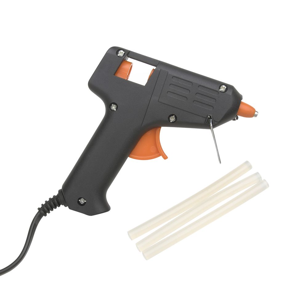

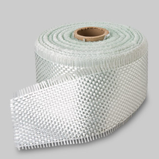

5 - install using hot glue and polyester resin with fiberglass
Uhbif

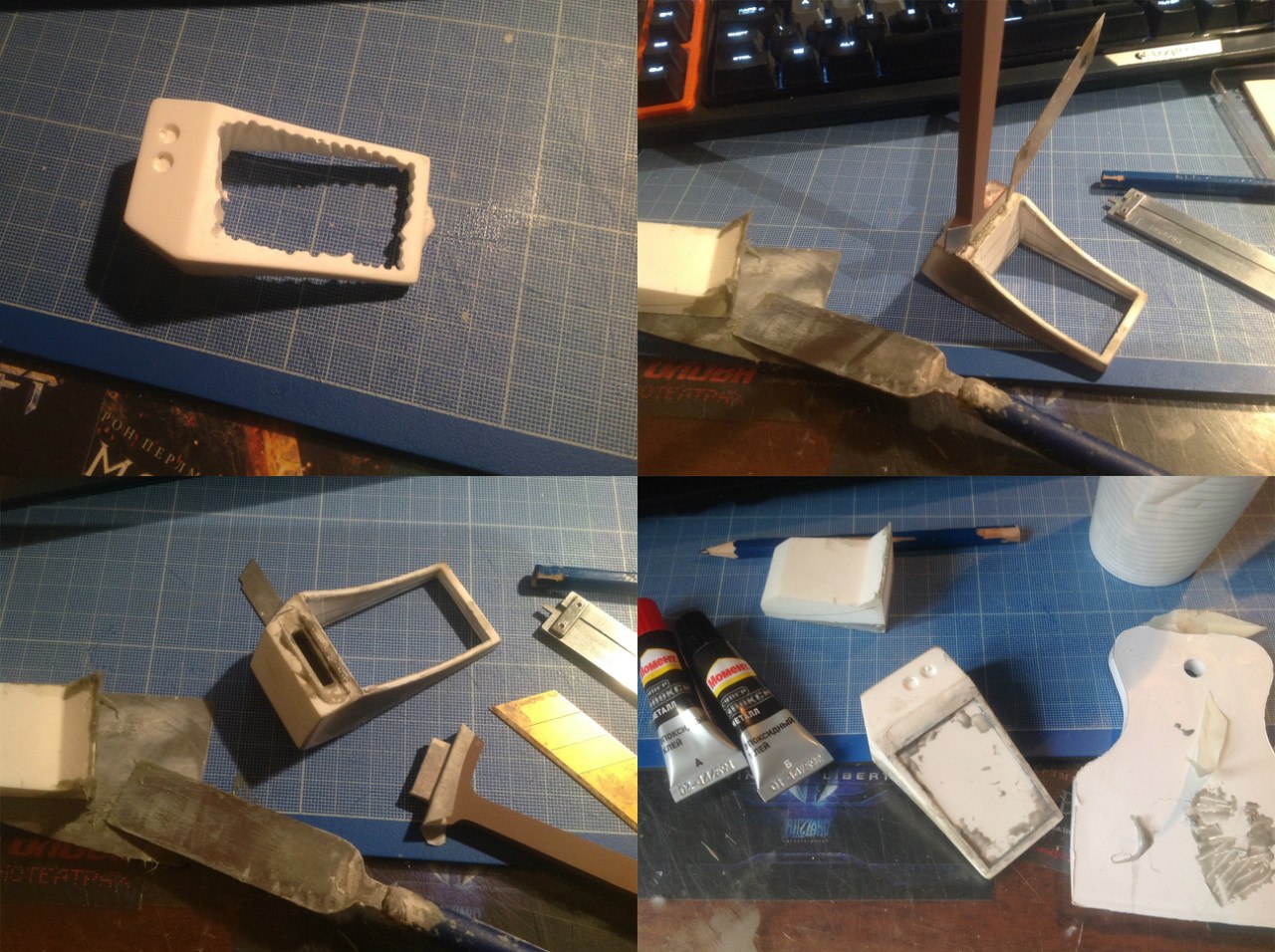

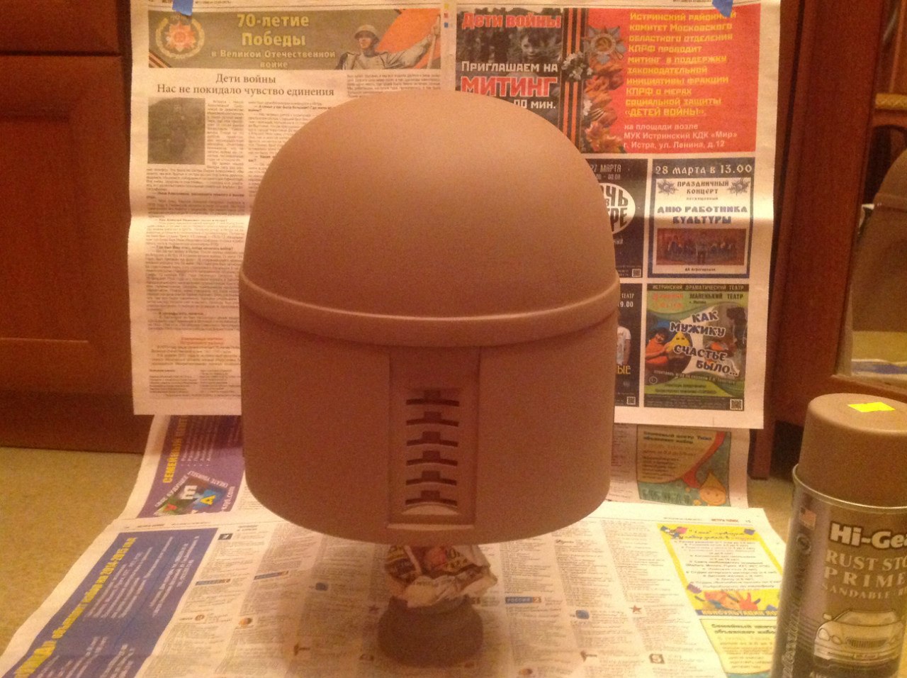

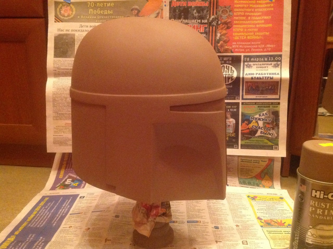

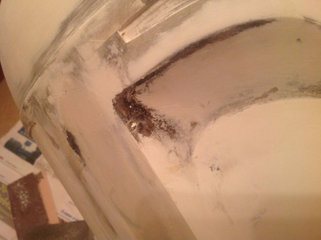

The devil is in the details....
cut the cardboard and polyester resin
automotive body filler with fiberglass
final putty and needle files

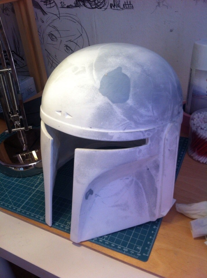

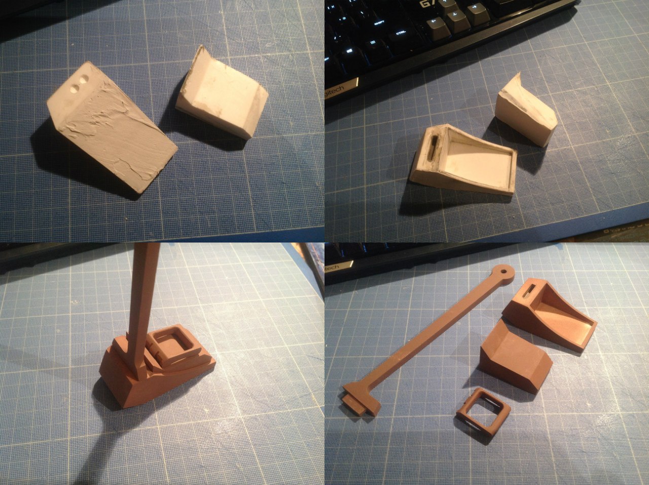

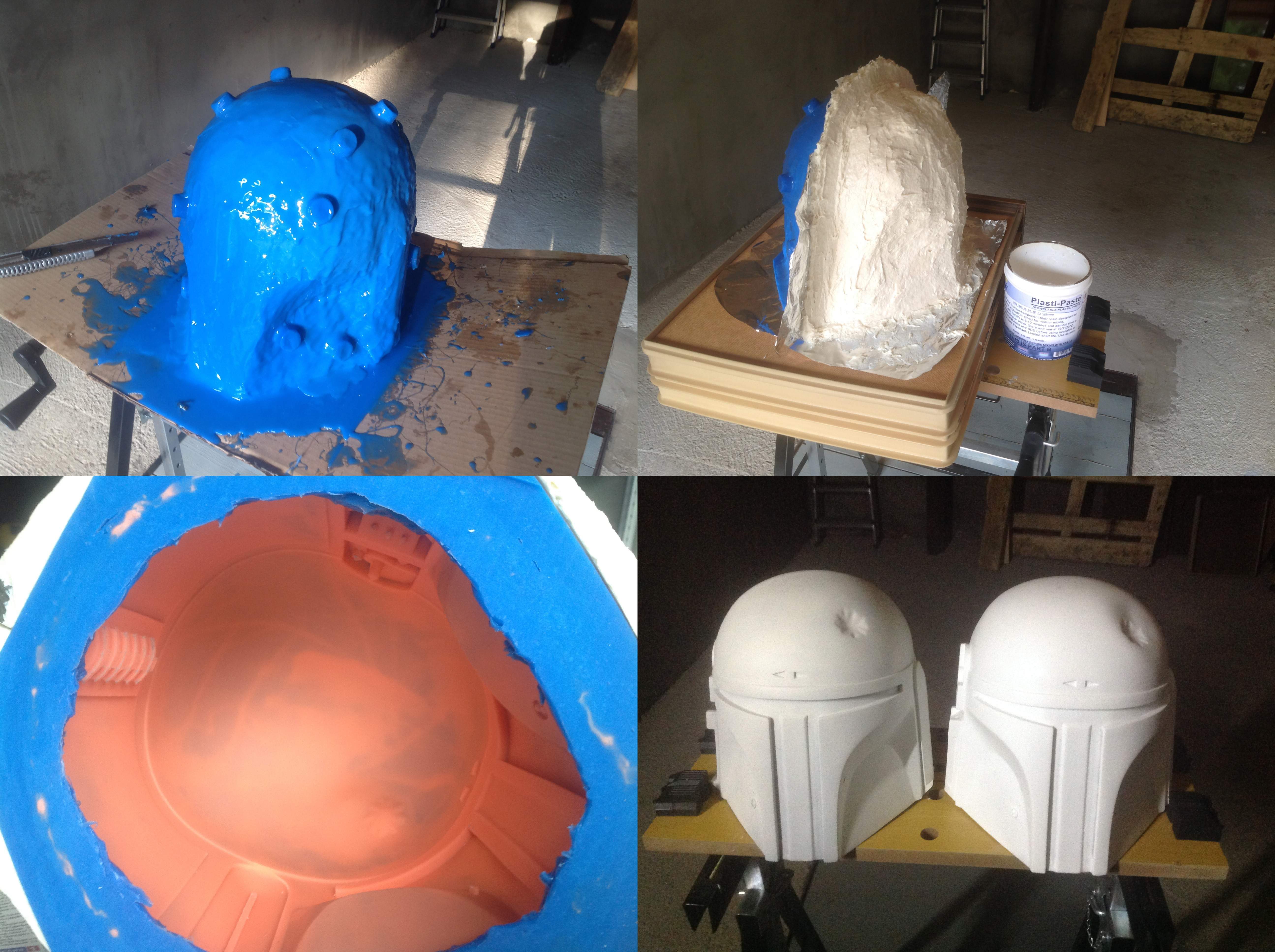

i mean how do you do the copy in plastic?? what is the product u use for make the mold ? :)
Uhbif
Oh, sorry
the first layer - Rebound 25
the second layer and the following - Mold Star 30 + THI-VEX
Frame for form - Plasti-Paste
Plastic - Smooth Cast 300

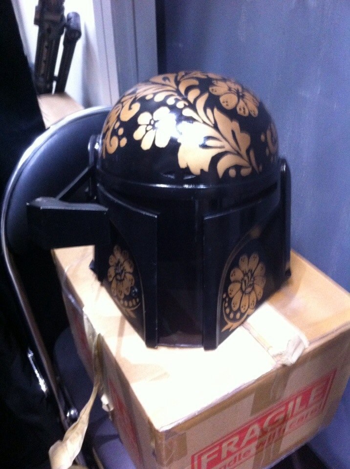

One of the first models of this helmet was made in special version for gift to a special guest at Comic-Con Russia 2014

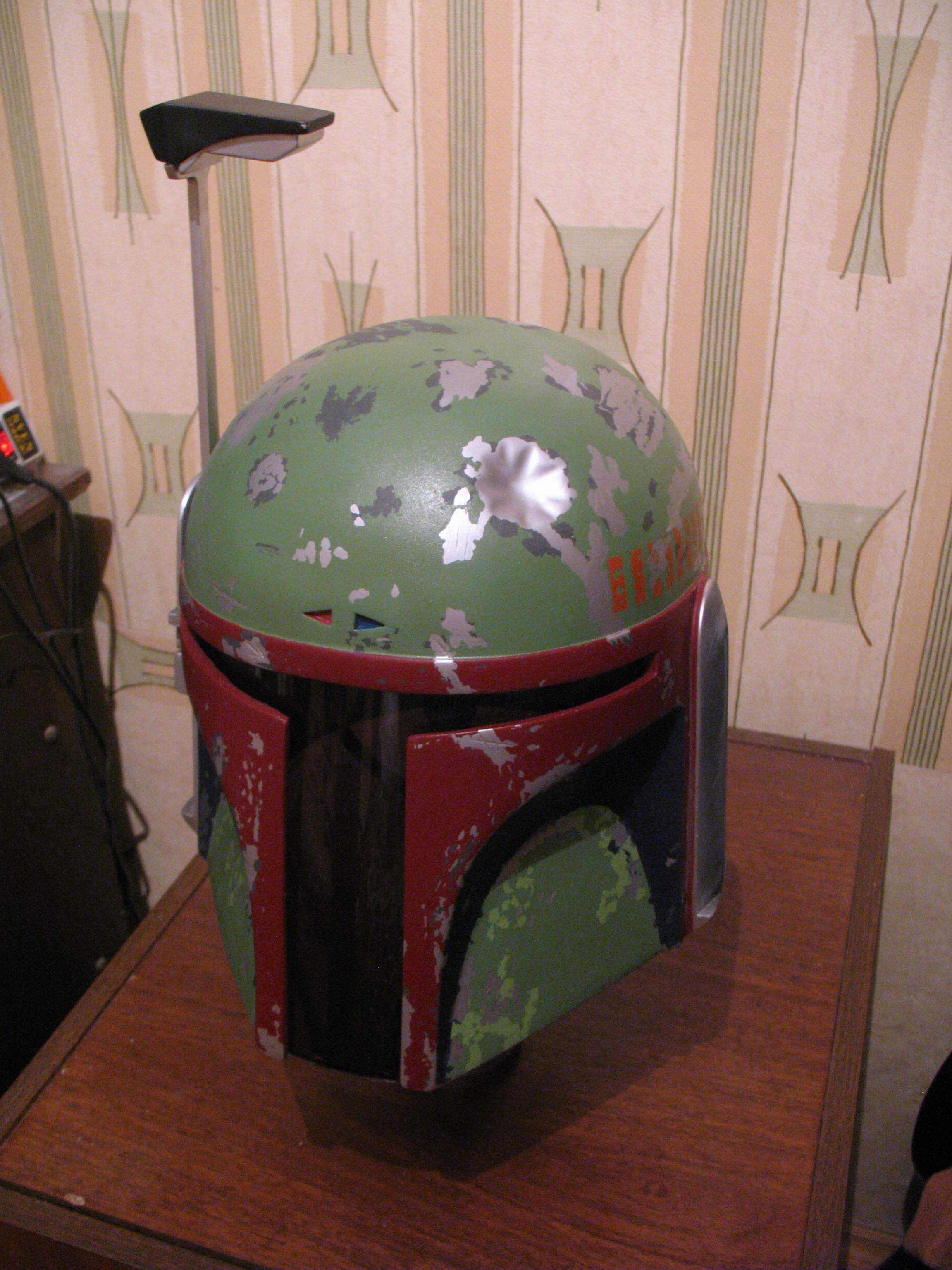

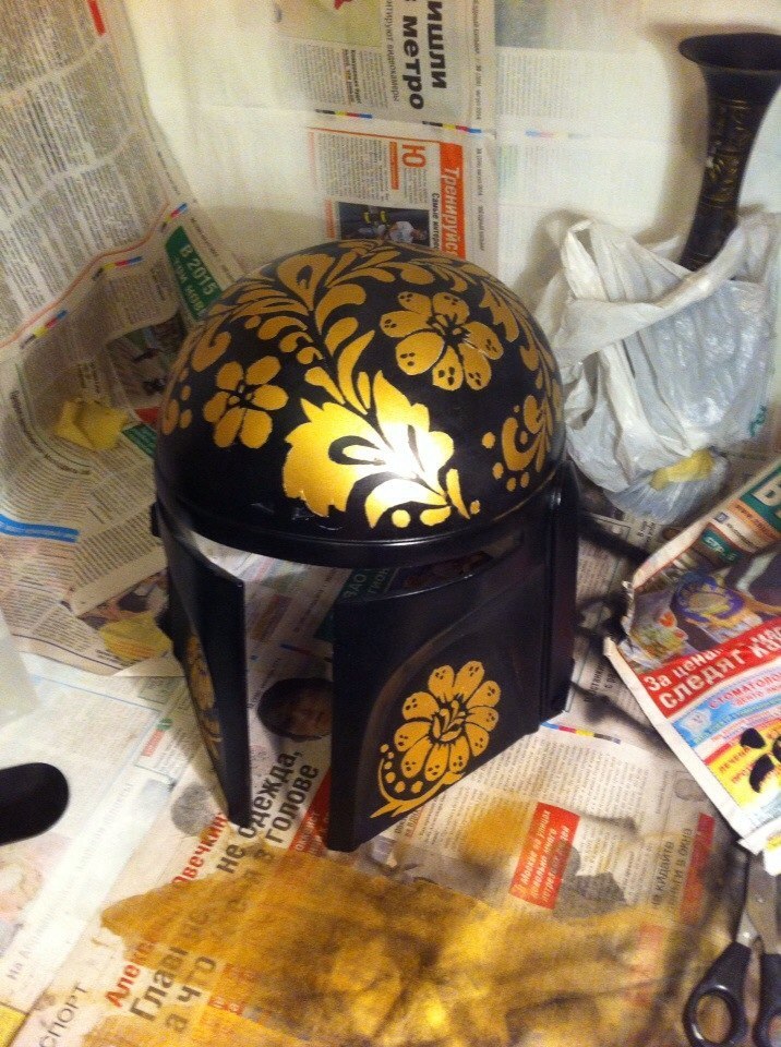

Painting made fighter 501st Legion Russia - CT 18889
(Boost pictured below)

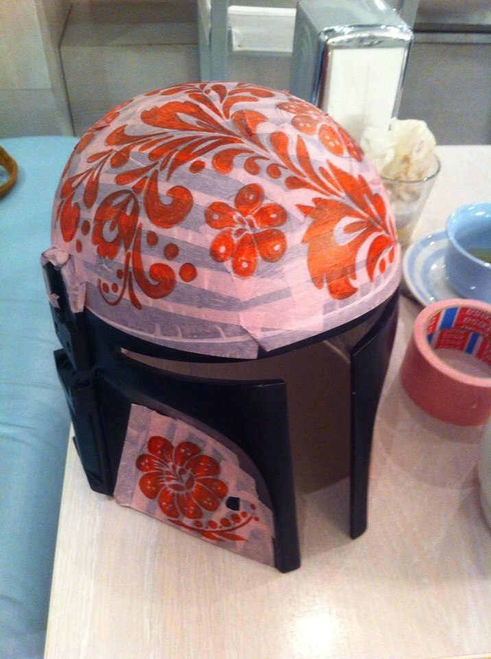

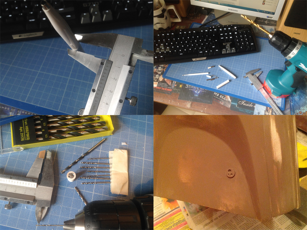

Marking parts of the helmet.
3-hole Borden connector is made of a pen.

Please tell me where I can find detailed images of small parts from Polaroid?
