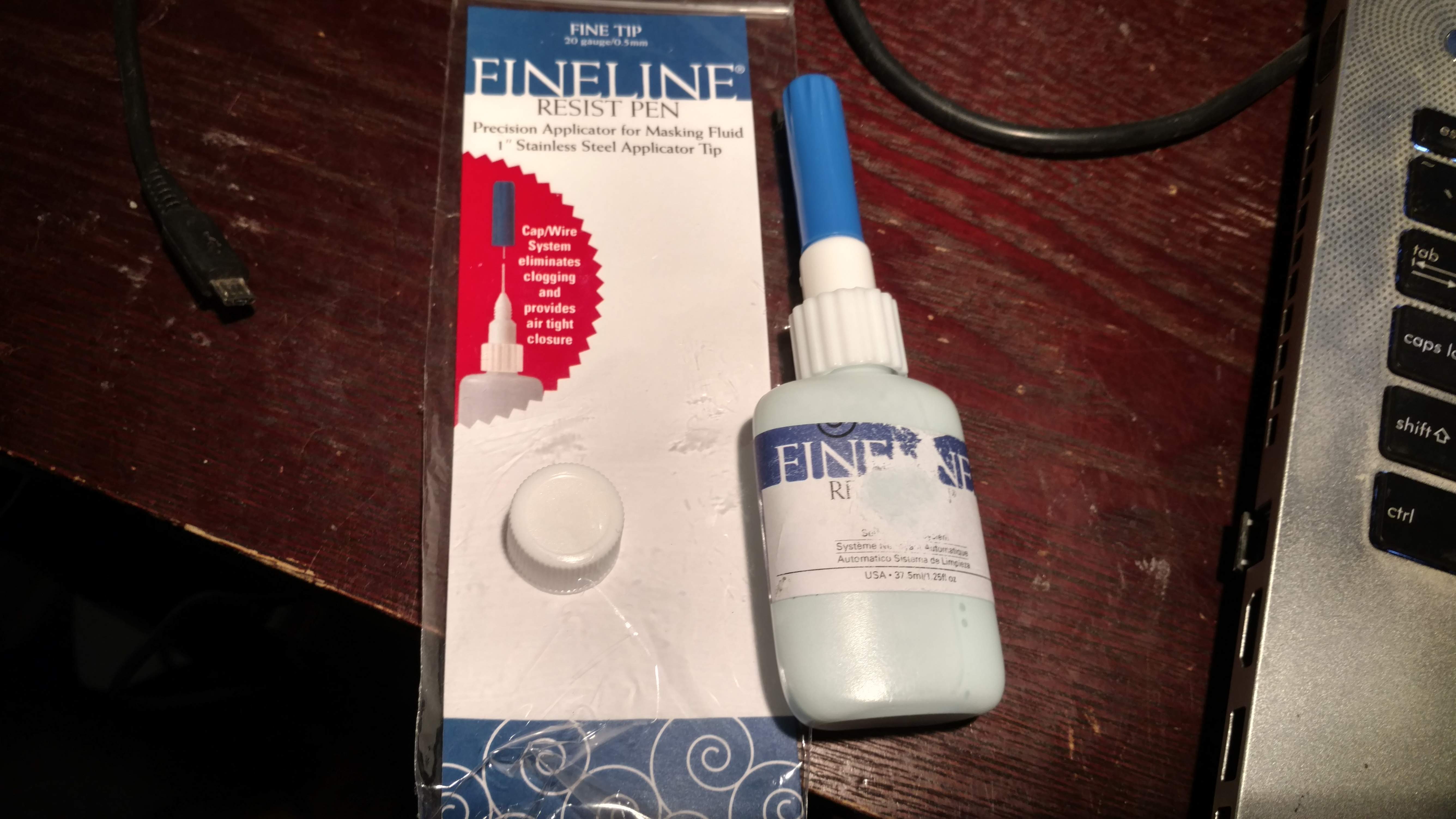

I picked up one of these at my local Michael's store. It's called a Fineline Resist pen...basically a syringe bottle filled with masking fluid. I'm getting really good results from it.
If you have a Michael's nearby (I think they have stores in Canada) they may have one. I couldn't find one online, but it was in the store in the artist paint section.

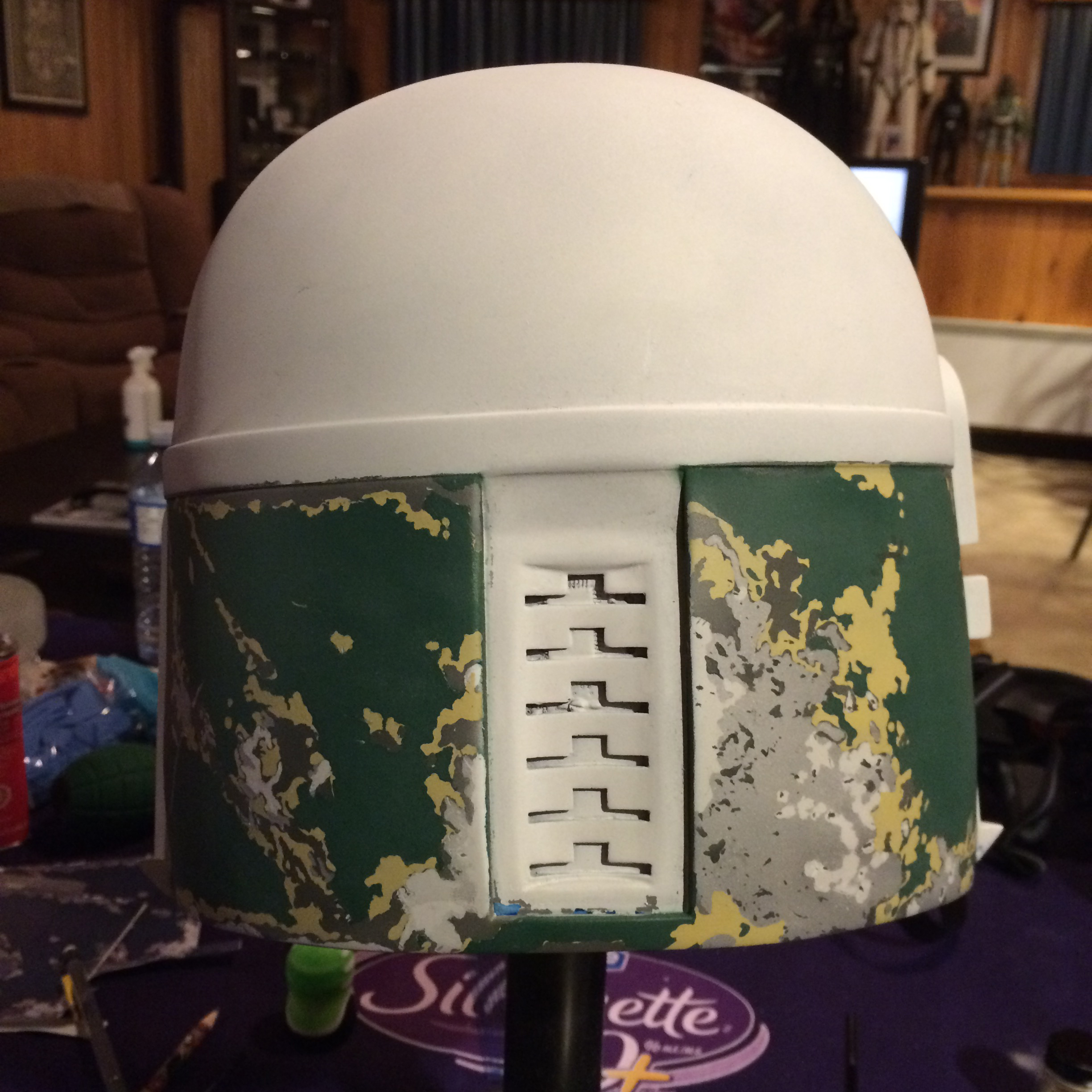

The Micro Mask works but you need to put it on thick,I am still on the hunt for Maskol for my next paint up since this is my first and it's good practice.

i found the micro mask very hard to come off. i did an experiment using micro mask on one side of my back panel. on the other side, i used some liquid latex (from my halloween bin) using both a brush and a coarse sponge to apply. surprisingly, the liquid latex was amazing! dried fast, and just rubbed off with my finger after the paint dried. the micro mask was terrible coming off.
