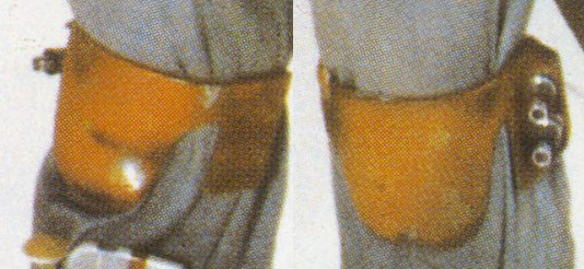

YOu know the screen used ROTJ suit. ITs left knee guard is broken into pieces and held together with elastic, I dont know if it was when the scene He fell down on the skiff and it broke or what, but its so badly damaged they replaced it with the ESB knee guard for the AoSW exhibit.

Cool pic cal, but those aren't ESB knees ;)

JFJ- hmmm prepro then? I dunno where they got them from but they sure are different.
