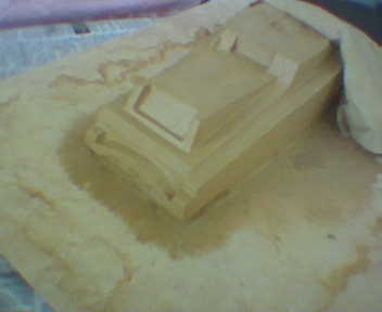

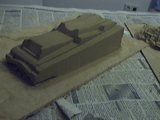

..well,
my girlfriend is useing clay 5 days ago. by looking all the photos, there are becoming much details to stand out as she want. sometimes she could scream :D but she have the better hands for working with clay than me.
in time she is still working on the left gauntlet upper half. i think not bad for a first step.
here r some pics from my webcam. its a v.1.0 build !!!

Wow nice wish I would have just made my own instead of buying them. Sure it would have been a lot of time and hard work but... it saves ya from a lot of headaches in another arena.
