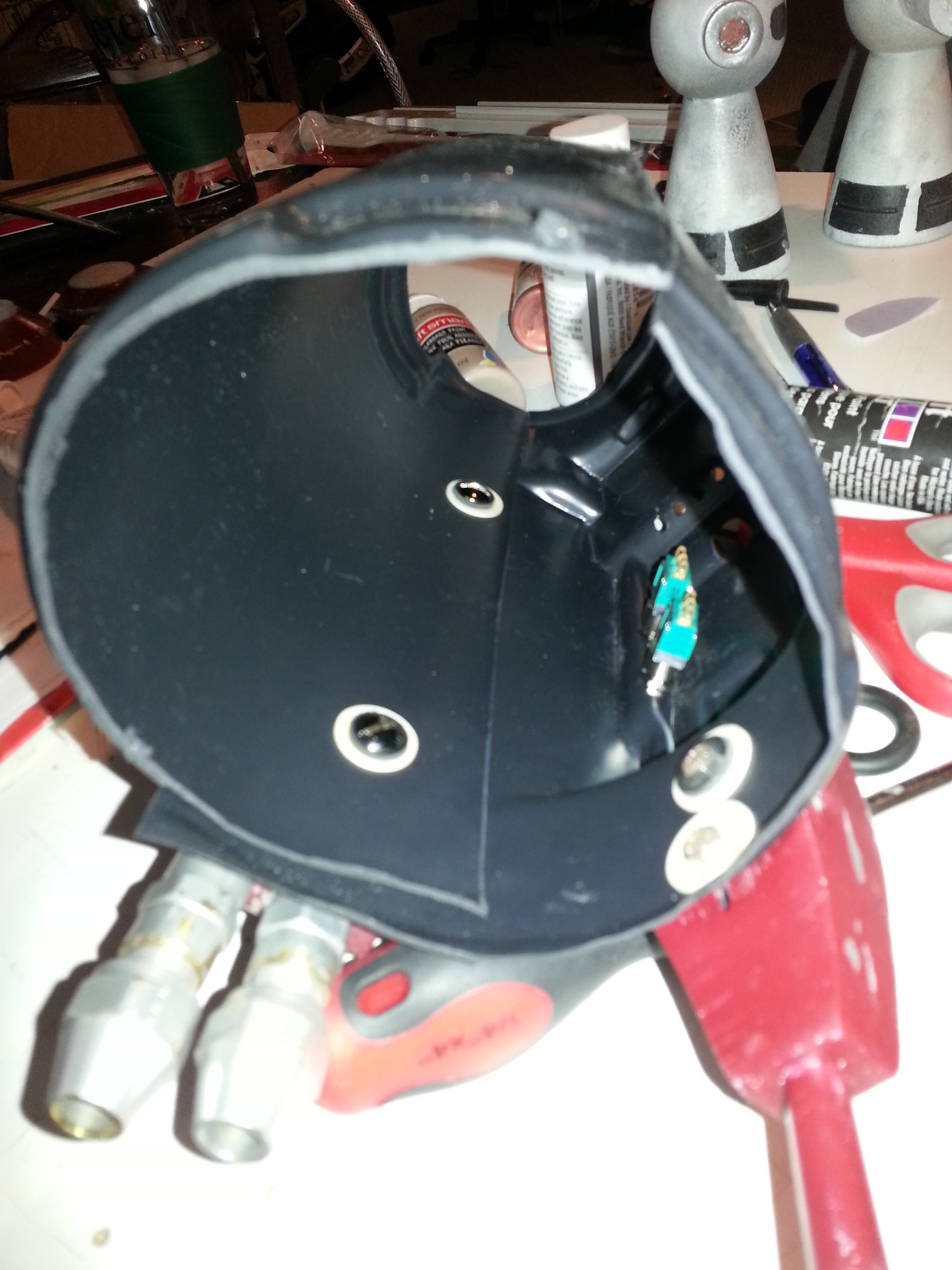

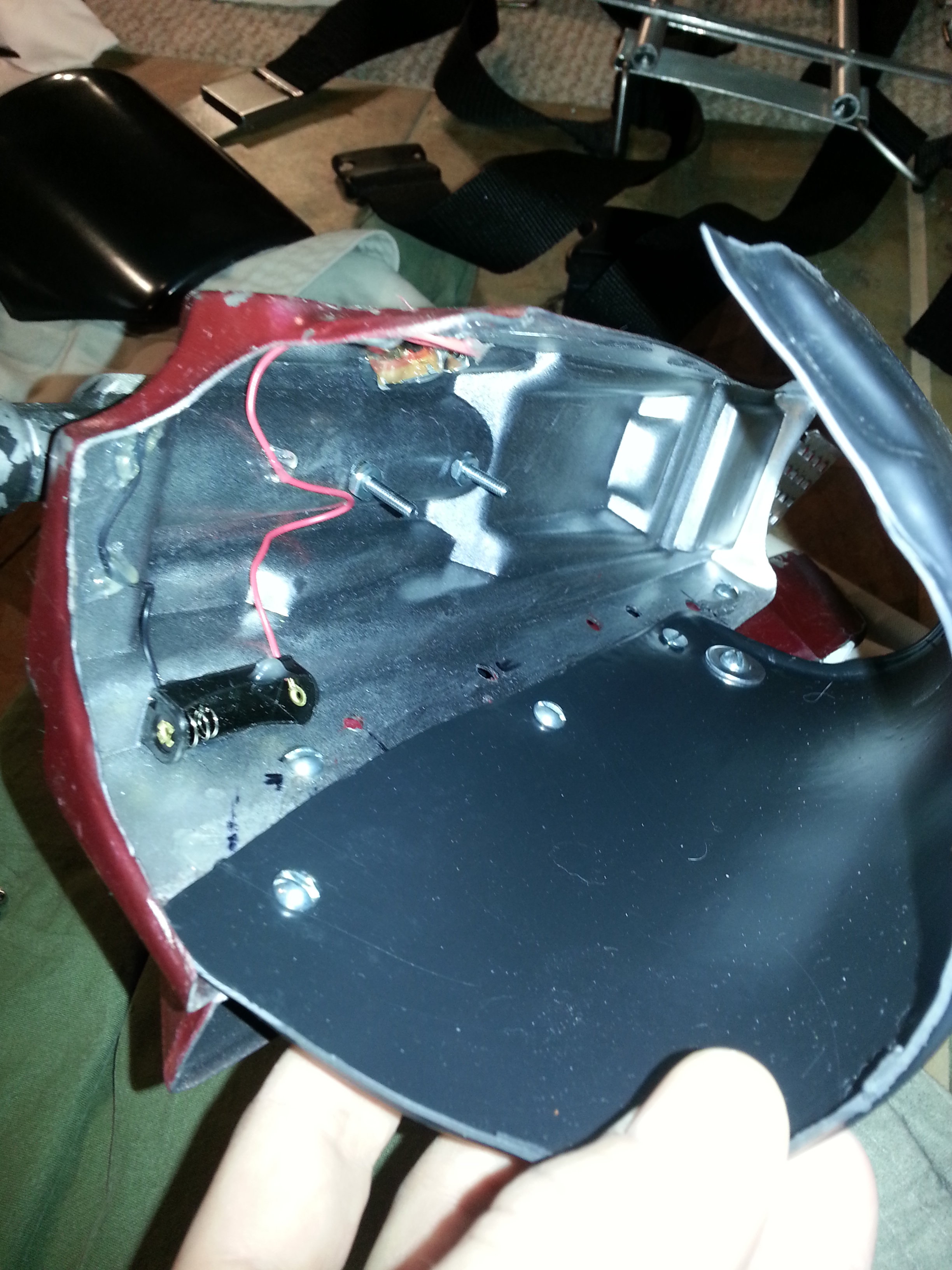

I 20140308_124118.jpg20140308_120141.jpghave a set of rkd gauntlets, and I used bolts and Chicago screws to permanently attach the outside and have industrial strength Velcro to keep the inside edges closed. I used the flamethrower box and whipcord box to hide the bolts. The nice thing about ABS is that with minimal heat the curve of the bottom clam can be altered to fit flush over the top shell, putting less stress on the Velcro.
The main issue here too is what the gauntlets are made from. If they are vac formed then really anything will hold them fine. If they are resin (mine are resin tops with vacformed bottom shells) then you need something sturdier. What I've done so that I never have to worry about mine is this. The resin tops have 2 straps glued into each one. That way I strap the top to my forearm nice and tight. The bottom plastic half is just held on with magnets since it doesn't have to do anything more than hold it on, and if the plastic half get's knocked off it's very unlikely to suffer any harm from a fall. Just my 2 cents.
