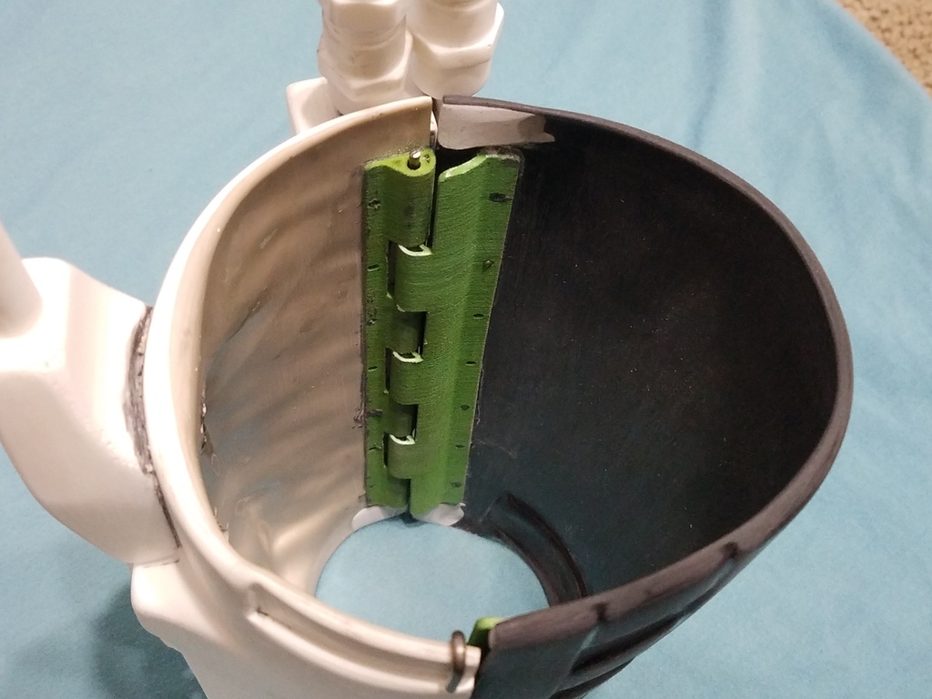

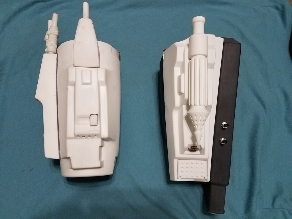

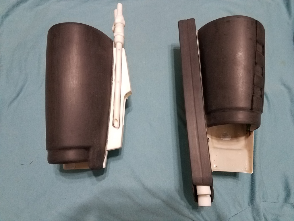

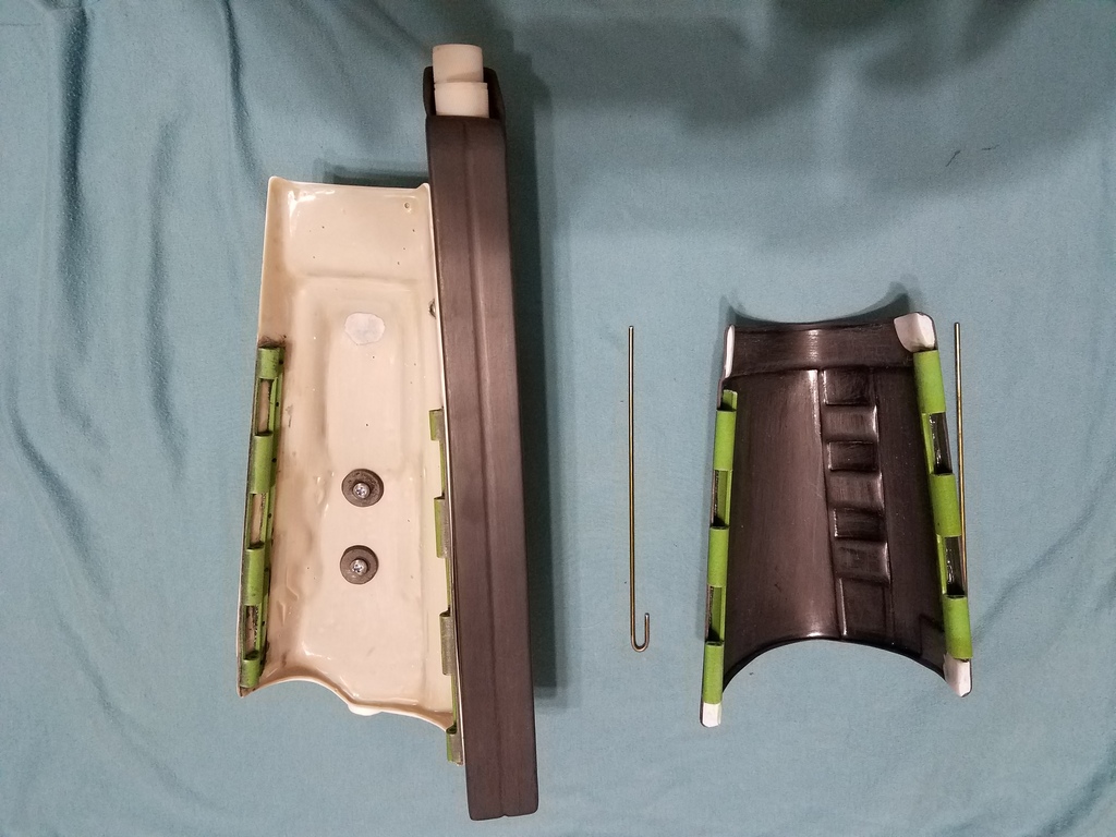

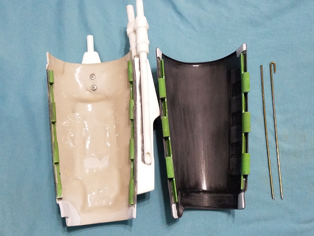

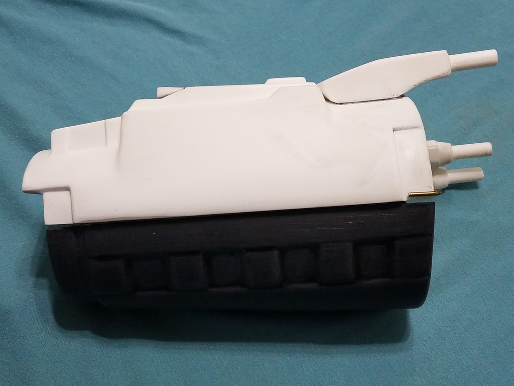

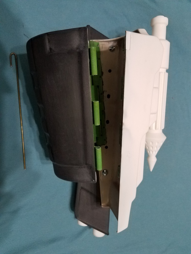

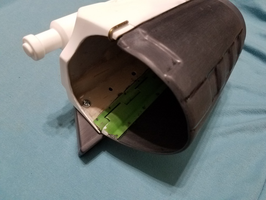

Here is something I did for RexFett with his RKD gauntlets. I designed a hinge with a swing out feature & had them 3D printed. There are 2 used on each gauntlet. The hinges are different lengths for the left & the right. Depending on the kit there may be some fitting involved. These were epoxied in & will give a hidden look. They open enough to slide your hand through then a rod is used to pin the halves together. Very secure method & is similar to using a piano hinge but this actually hides the hinge so it isn't seen.
These can be purchased here:
Gauntlet Right Hinge 7.25 Inch Long by toolguy301 on Shapeways
Gauntlet Left Hinge 6 Inch Long by toolguy301 on Shapeways
thanks for the photos i really appreciate your help :)
