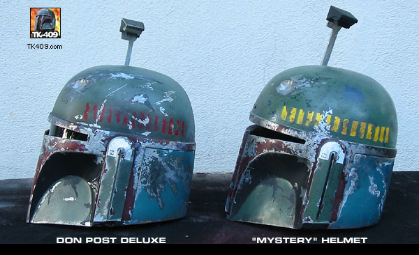

Here's a photo of how the kill marks template worked out on the Mystery Helmet. I was happy with it. I had to touch it up a little because of a tiny bit of "underspray" leaking through the template because I didn't have it taped down tight enough, but now it looks pretty good. I think the proportions turned out well too. What do you think?:
Wow, they really turned out great. They look much more accurate. Although, I seem to remember a discussion earlier about the stripes on the ESB helmet fading from yellow (front) to orange (back). I can't remember...
EDIT: Yeah, I can see it in this shot. The thickness of the stripes is spot on.
