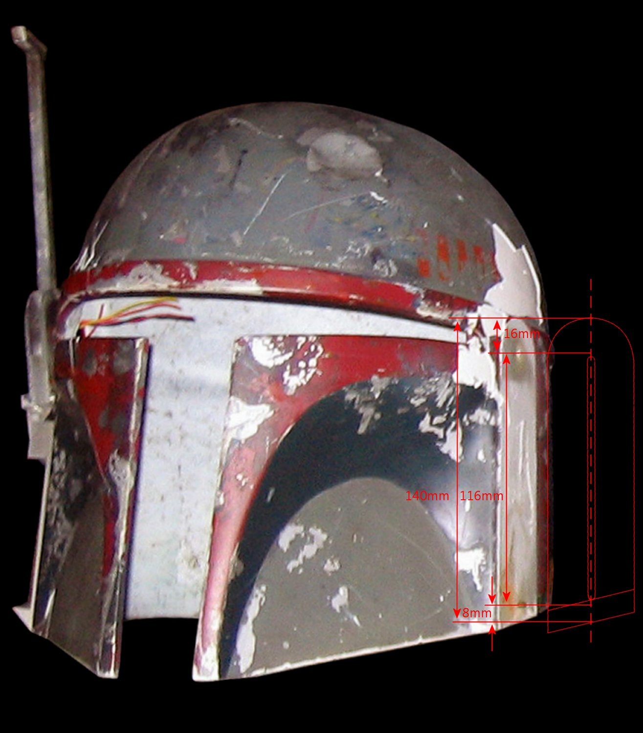

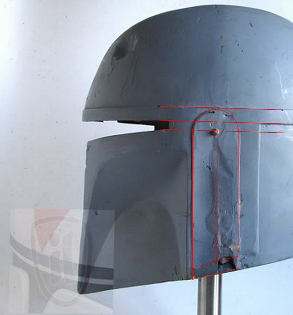

Sorry James, but I'm not agree with your theory! I searched the Gallery to see if the ESB and the ROTJ helmets shows the ends of the screws or not, but my search had negative results. In the last couple of days I did some measurements and comparisons of the left ears' attachments. I used mostly the damaged Sandy helmet because its left ear is missing and this is the only helmet that shows directly that particular area:

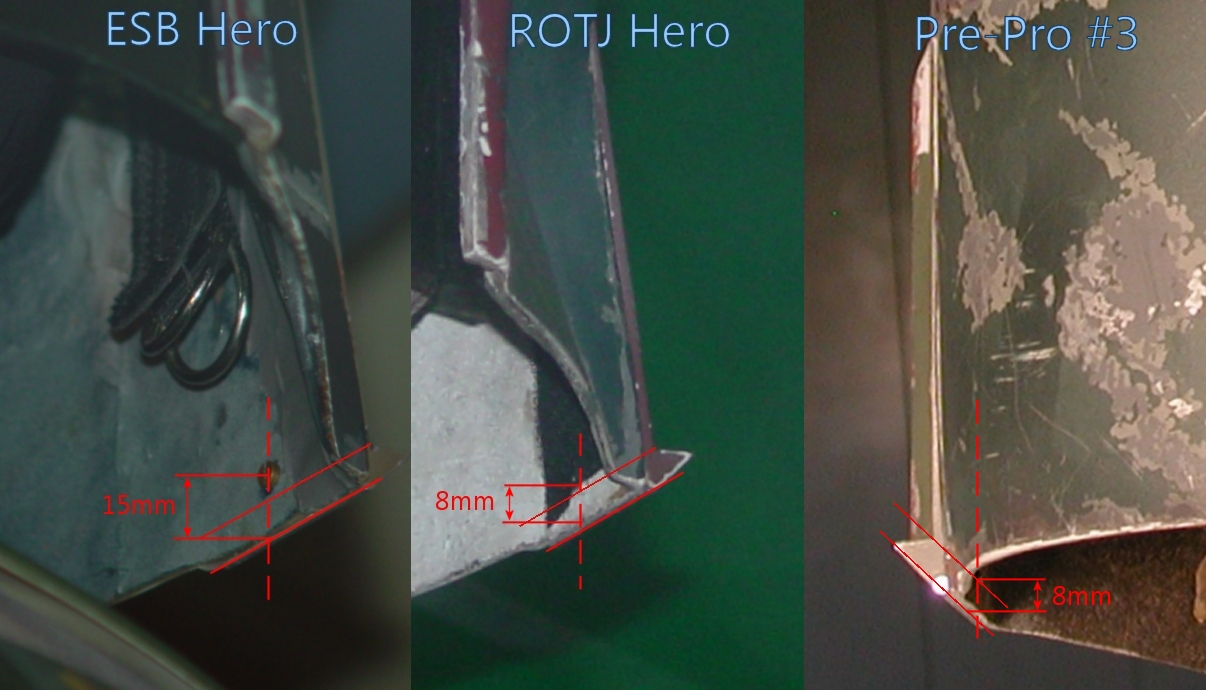

Here are the results of my measurements regarding the left ears' lower screw placement:

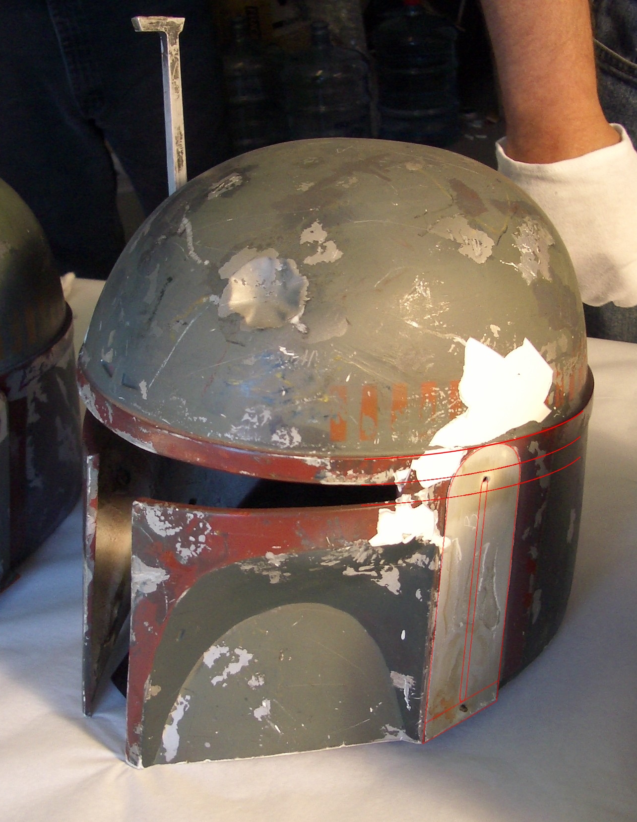

Looking at the Banzai helmet (which, if I'm not mistaking, is in some way related to the ESB Hero helmet), the upper screw seems to be in the upper end of the left ear's trench, but the lower screw hole is not visible and might be the same with the ESB Hero's placement, which is a bit above the lower end of the left ear's trench.
But because this helmet has fan made modifications (especially the missing right ear's dome platform) it's possible that the screw placements to be altered too.
If any thing your comps galvanize my theorie , the ESB hero screw is to high to go in to the wedge part,an we cant see were they are on the ROTJ ,
An the Banazi helmet isnt actuallly fan made, far from it, and the red lines you marked on it for the ear tend to slid to far back on the lower half of the ear,
Blow up the hielman pics,you can even see in the slot that the to suspect holes are bronze not silver, and there is any pics clear enough to show themthey are there ,
And mabey some better refrences, may come up soon,,
I didn't said that the Banzai helmet is fan made, but it was slightly altered in a way or other.

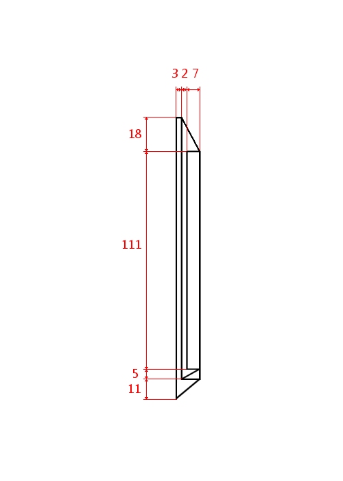

OK! Let me tell you the other way. If we look at the Sandy and the Banzai helmets, we can see the upper (Banzai) and the lower (Sandy) screw's presence, and with some help we got the following measurements for the visible end:
around 3mm. The left ear is 12mm wide and the trench is 7mm deep, so we got a 5mm thickness without the trench. If the screw's visible end is 3mm long, it still remains 2mm to be visible in the trench's end:
Edit: the image file was corrected because the trench is around 7mm deep and not 5mm as I stated.

Im all for theories and mine may not be right, , how ever were are you getting the mesurments for how deep the trench is,
on the ESB hero you said the screwis 15 high, if you measure almost any ear youl see that the trench ends at 15 ml, also what makes you think the screws are only that length, just because in the Sandy helmet its sticking out that far doesnt mean that is all the way through , as its clear the ear has come off mabey the screw was undone some of the way thus making it come of,,
I still see enough holes in your argument that you could be wrong, but that said you are proving there is good popssiblitiy Im wrong, either way you can see them in the Hielman pic,? and otherss
Im all for theories and mine may not be right, , were are you getting the mesurments for how deep the trench is,
More importanly what makes you think the screws are only that length, just because in the Sandy helmet its sticking out that far doesnt mean that is all the way through , as its clear the ear has come off mabey the screw was undone some of the way thus making it come of,,
Corrected the trench deep in post No. #68 from 5mm to 7mm.

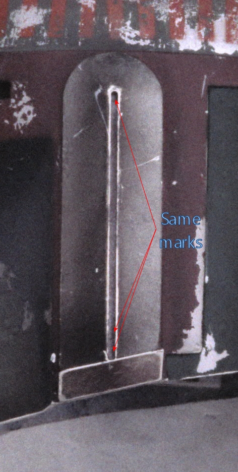

Yes, I can see something in the Heilman photo but there are at least 3 visible marks in that trench:
I can't prove or disprove what has been said here, but most of the facts lean to a negative result.
Yeah I see what you mean but the other doesnt look the same, any way this subject has derailed enough for now,
Ill be posting a cast from this helmet in a few days ,
You are right! This feature doesn't do major modifications to the left ear and the helmet, so we better focus on your helmet casting.

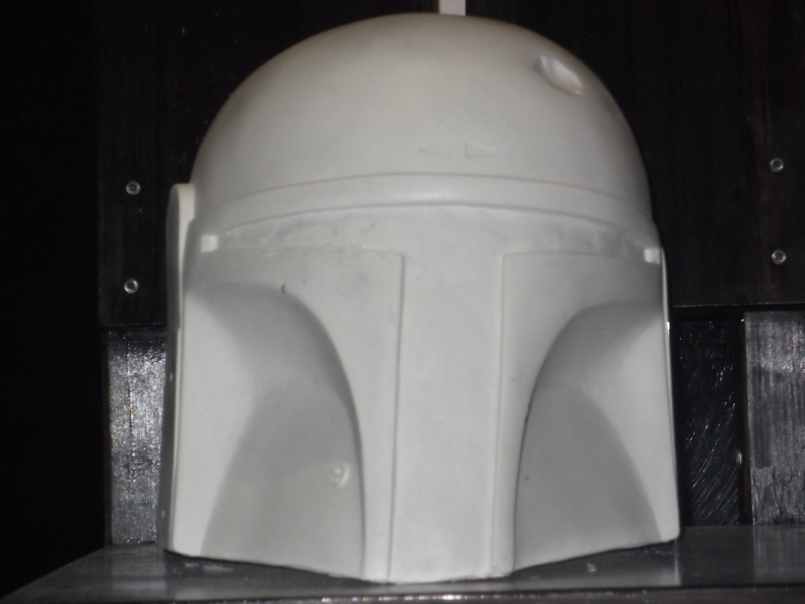

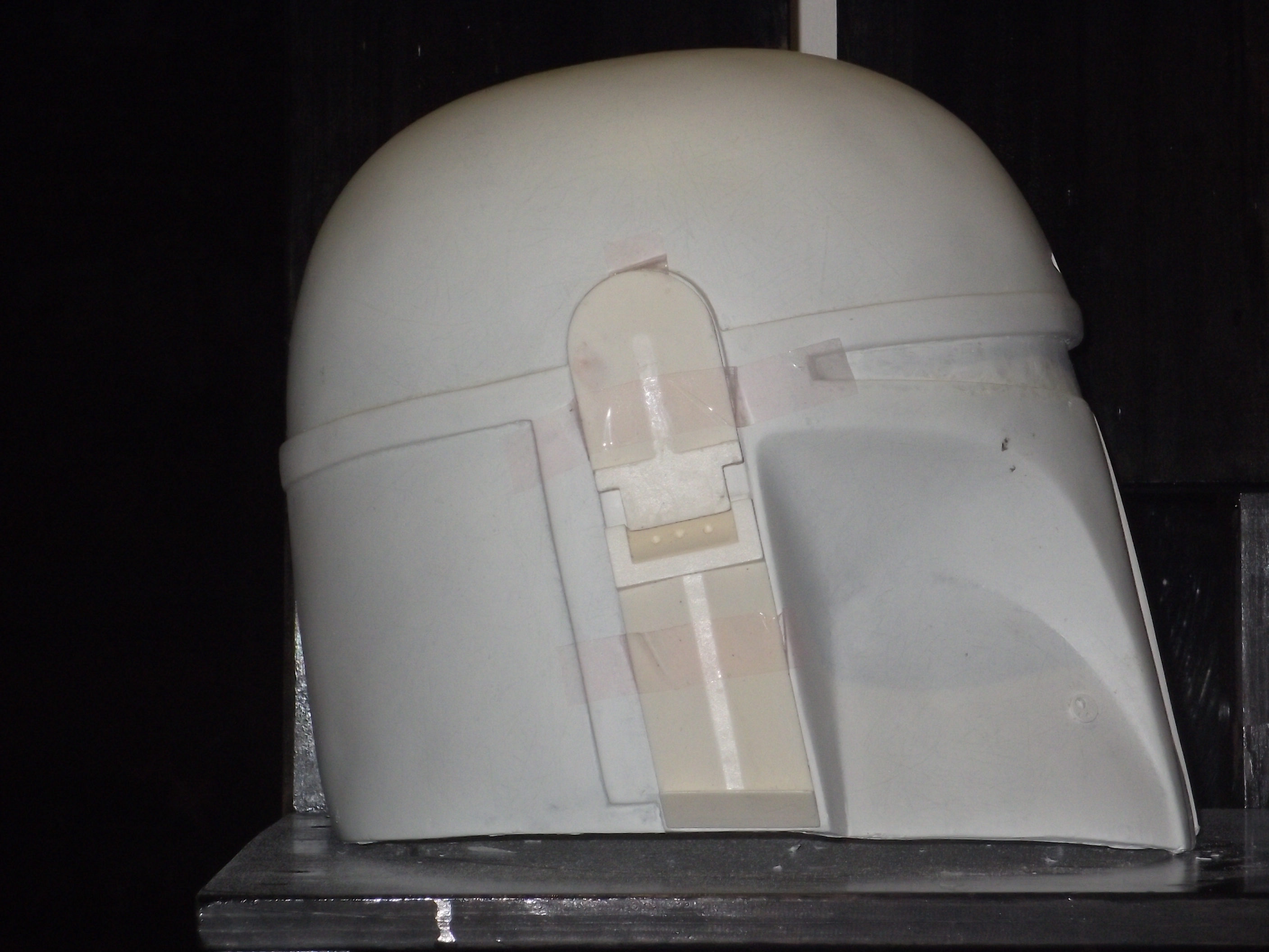

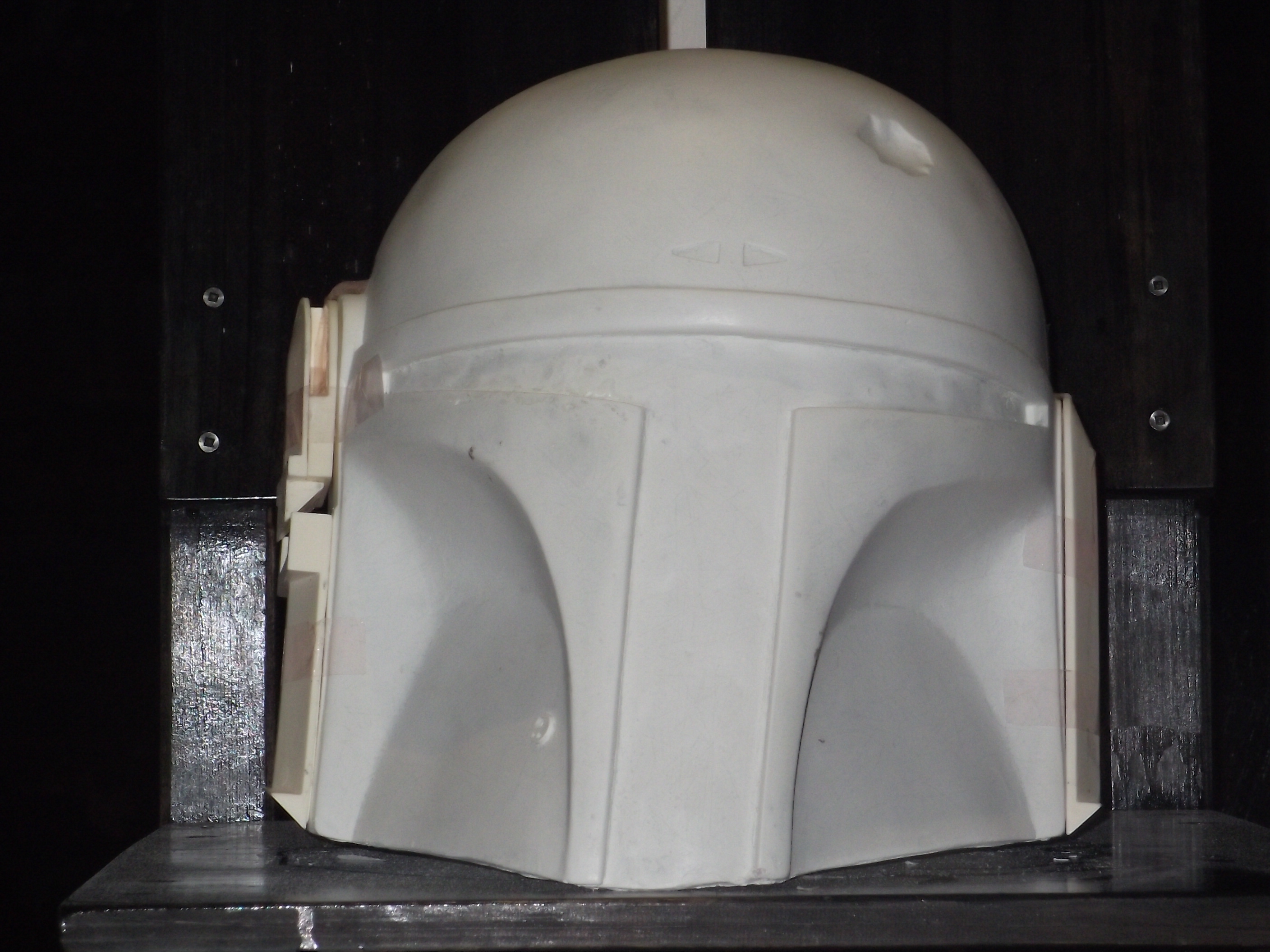

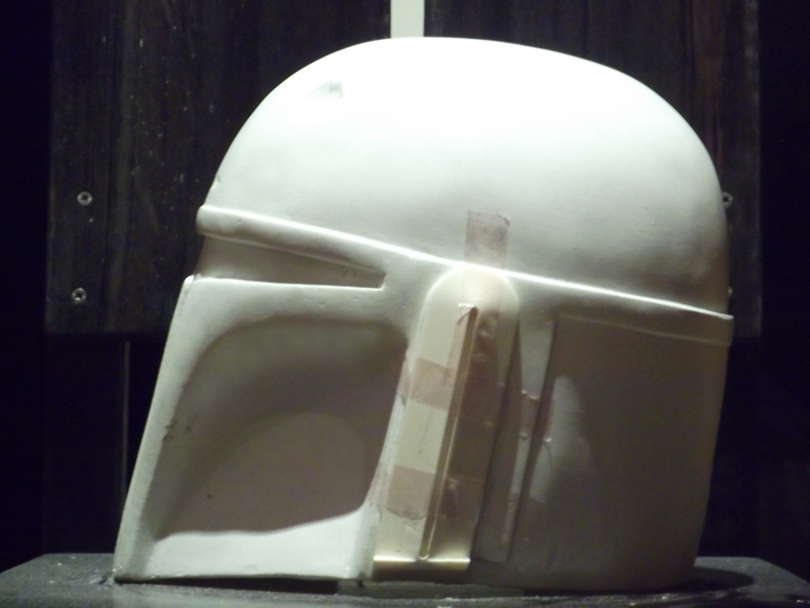

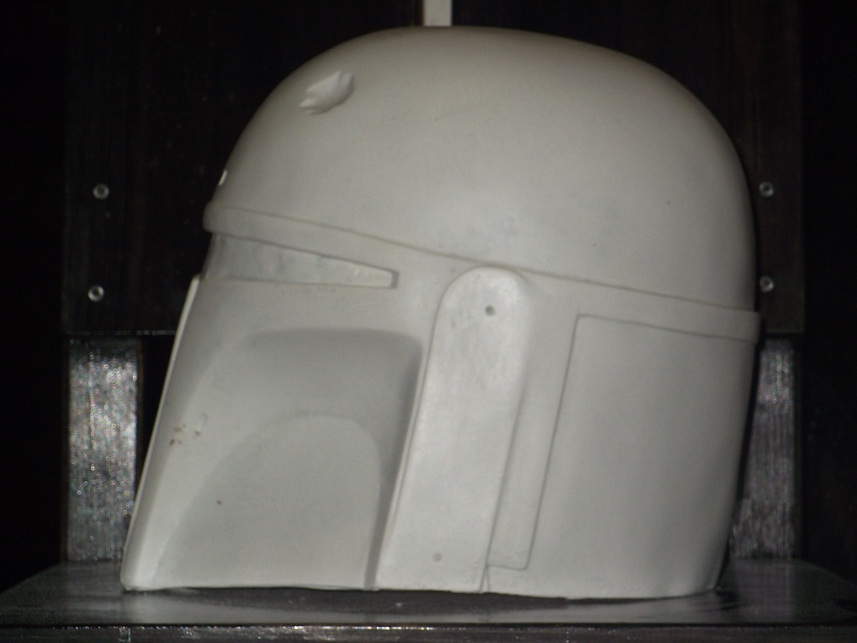

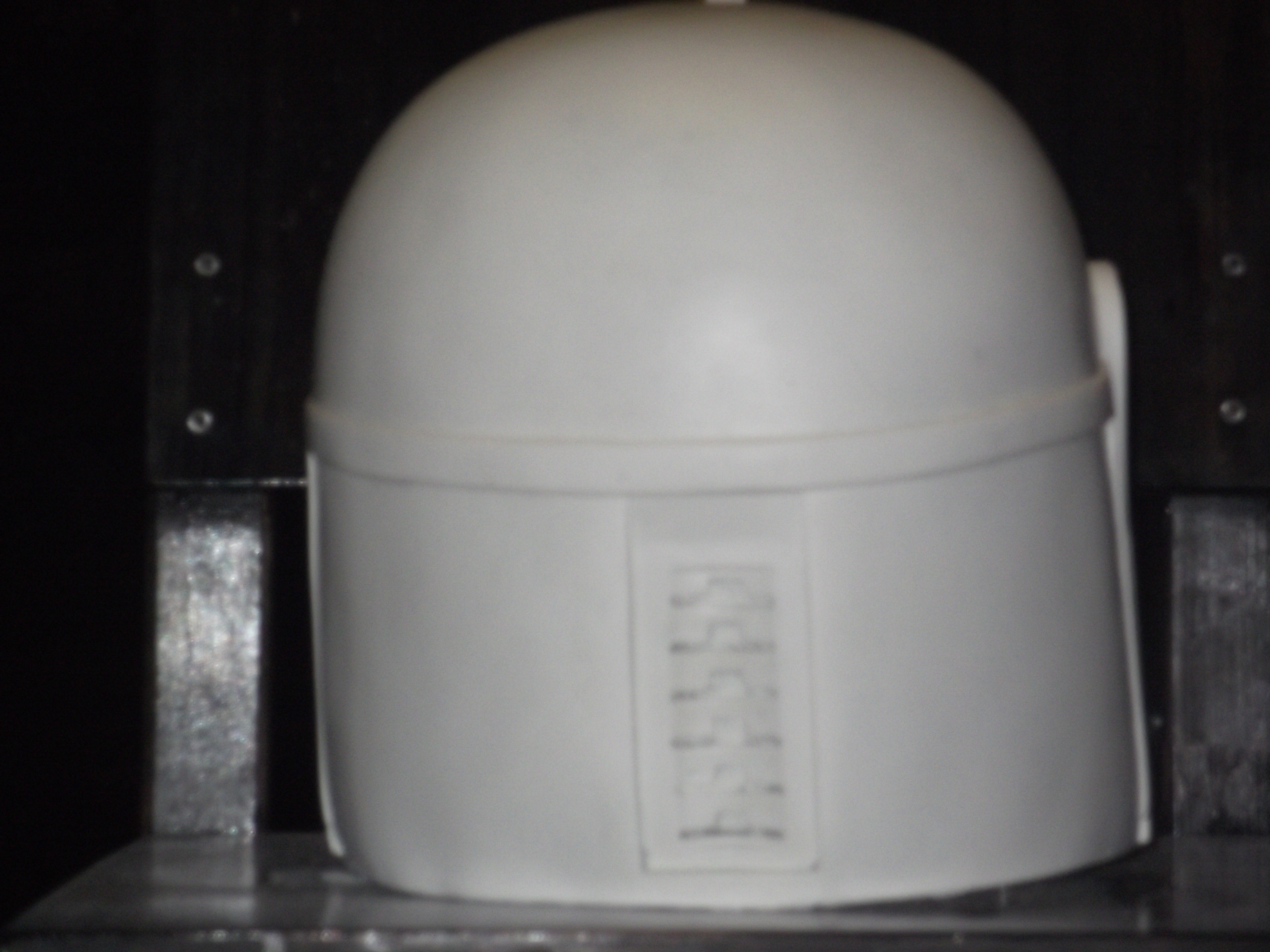

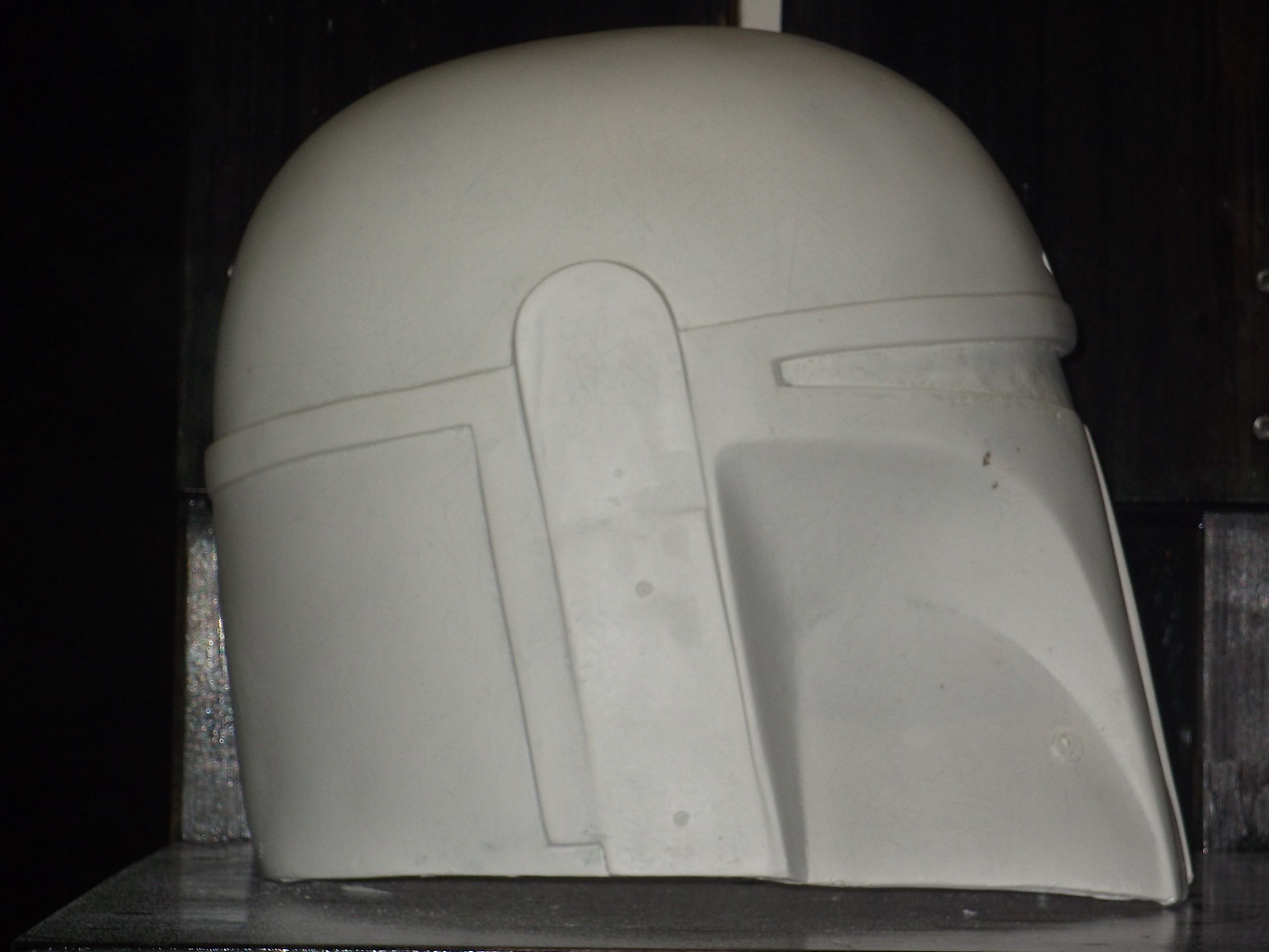

After a few mold stuff ups andone of which almost ruined the helmet sculpt,(note to self dont try doing molds on the cheap) I have the first cast from the new molds, Im quite happy with the way it looks, DSCF3968.JPGDSCF3970.JPGDSCF3972.JPGDSCF3974.JPG
Jimbo - your work just gets better and better. The fact that I will get the oppurtunity to paint one of these bad boys up is exciting and a privilege, so ill do my best not to balls it up! Beautiful, beautiful work my friend! :-D
Thank you mate, it really is much apreciated, as it happens that is your helmet in the pics:thumbsup:
*Jayvee does a celebration hammer dance, then goes back to trying to act very cool and suave.. ;-) *
Awesome m'man, cannot wait to recieve that absolute scorcher of a lid!
WOW James that lid turned out great and is a beautiful piece of work let me know when you are ready to offer these up for sale as i would love to get my hands on one.
