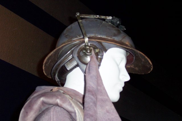

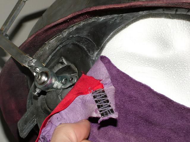

OK, Sablebadger was nice enough to let me post his Zam photos from FIDM. You can find the photos all here.
This is the image I'm referencing when I talk about leather lining on the earphones, a leather tab, and snaps (look at the left side. For some reason I don't see the silver snaps on the right).
(click on the image to view the high res pic and make out the earphone lining better)
Nice view of how thick the forehead part of the helmet is, and you can see it looks like a about a 2" strip of the maroon leather lining along the base of the front of the helmet.
And this shot kind of shows how the ear pieces appear to be somewhat hollow and are kind of filled with the leather lining.
That's the same color as the "lining" on the inside of the gauntlets I noticed on one of DCB's pics. They lined those with the same leather then... Hmmm...
And the brooch isn't black on inside part, just grimy like the rest of her costume... Hmmmm....
