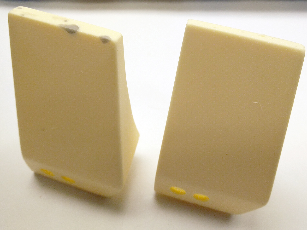

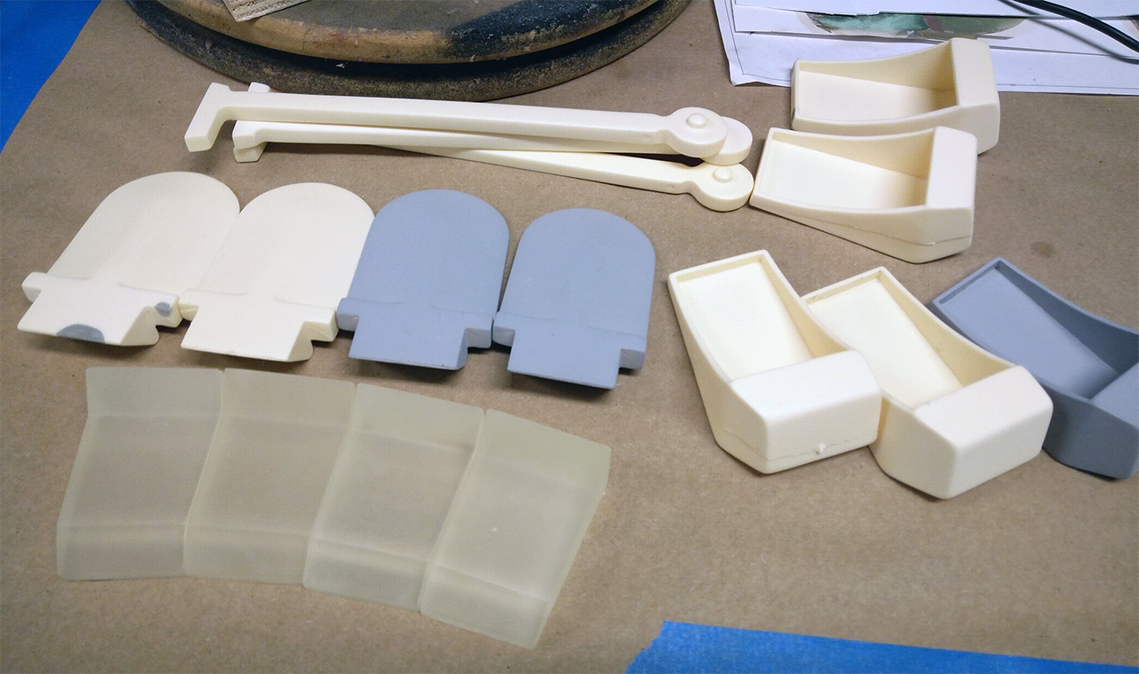

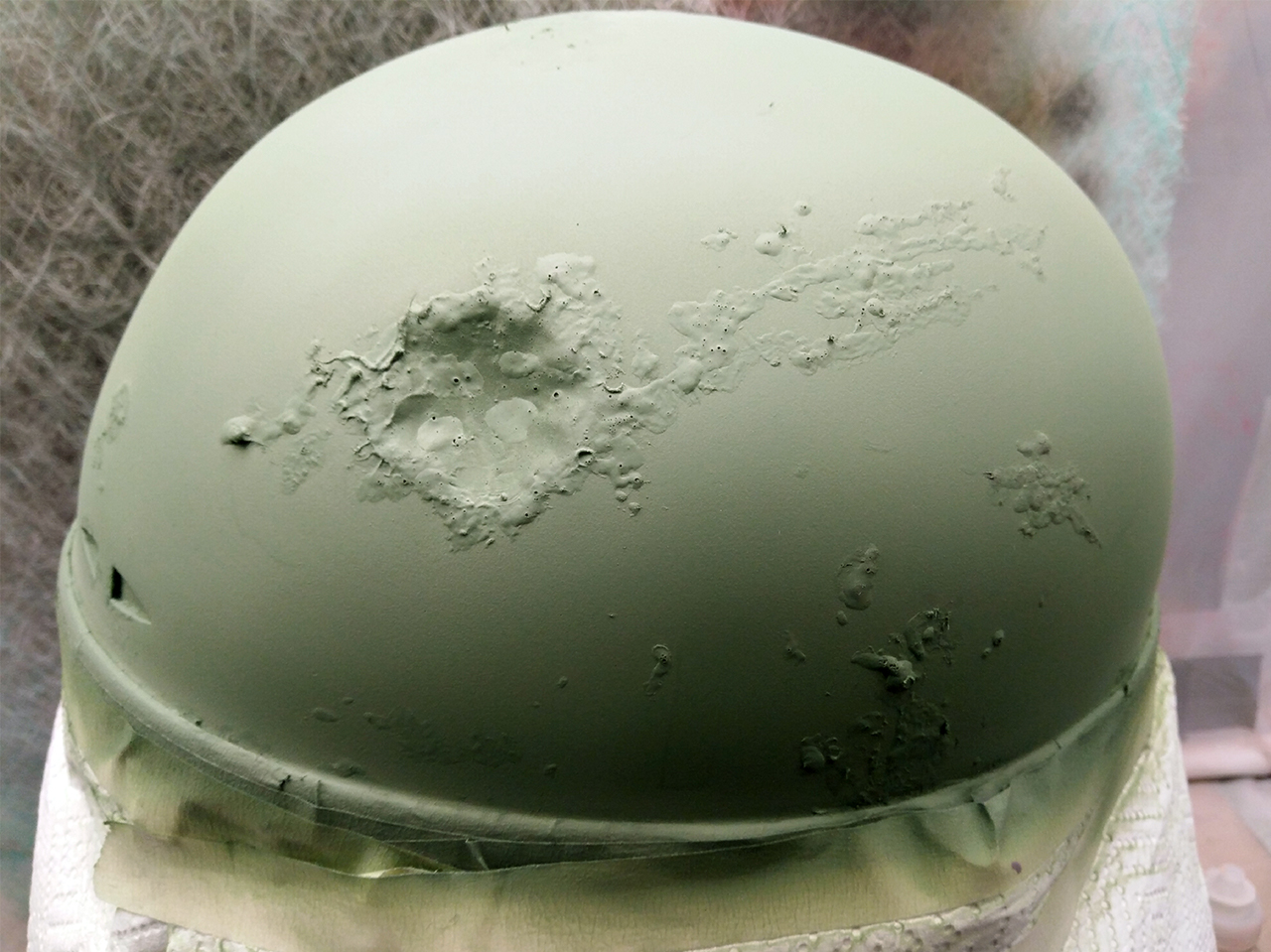

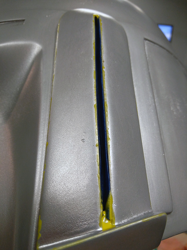

Been pumping out some rangefinder casts lately.
First few sets had some bubble issues from trapped air, easy enough to fix with some filler, but a few modifications to the air-channels on the molds and some improved casting techniques let them start coming out perfect.

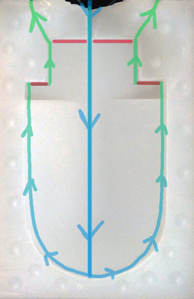

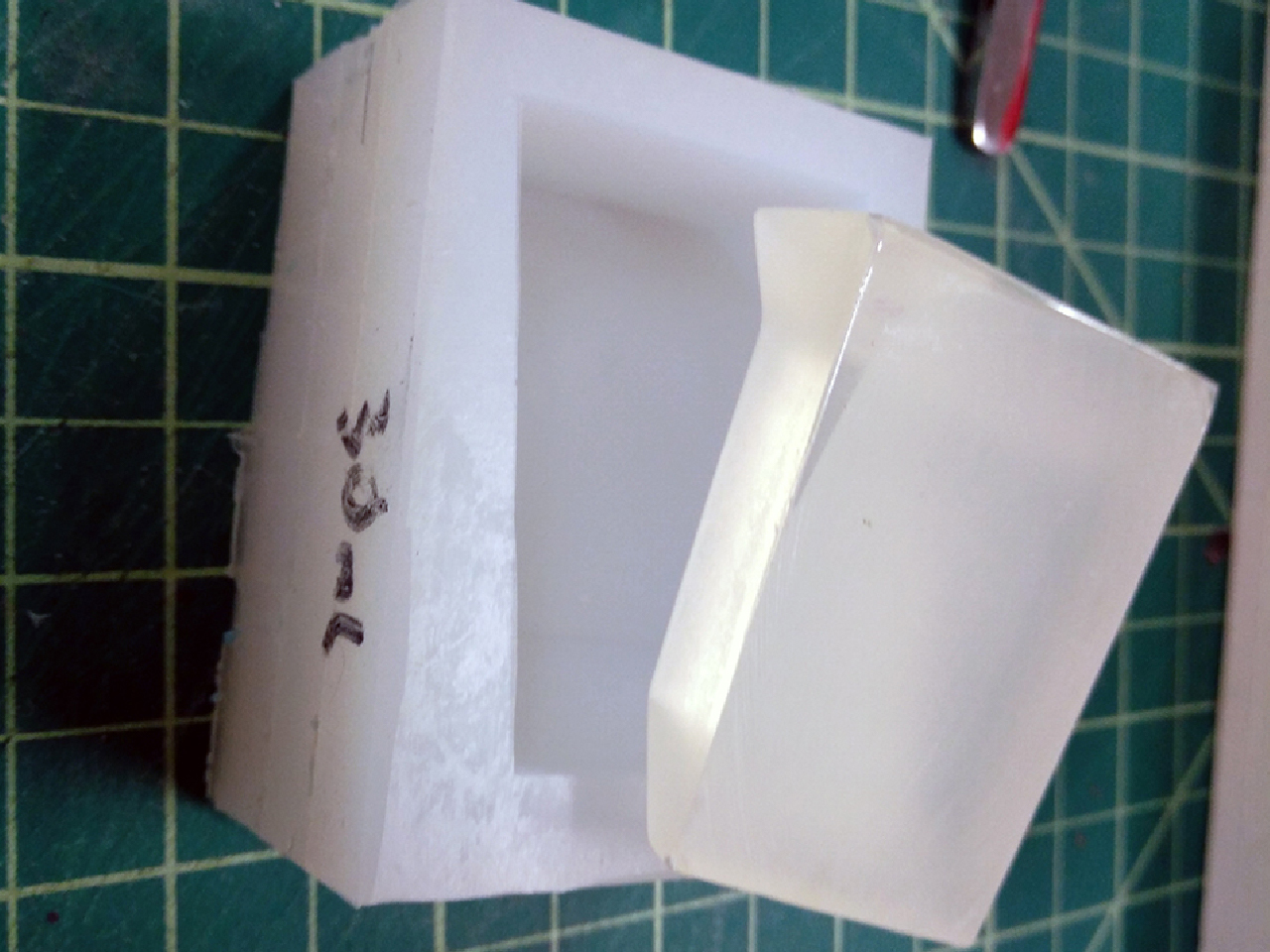

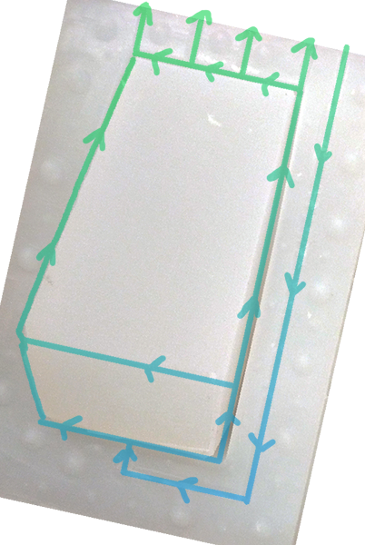

Pretty much when casting into block molds you want to think about the flow path that the urethane is going to make. Any little crevice that the urethane can't flow into or out of will create a void and capture bubbles in the casting. It's like filling an underground cave with water, anything that doesn't have an outflow for the air is going to create a pocket. Since the rangefinder stalk and ear cap are both sorta complex shapes that needed 2-part molds, I had to give some thought to how my resin would flow through them. Here's them both with their flow channels highlighted.
Each had their own little challenges that had to be overcome. The 1st image, the earcap, is pretty much a big hollow space so it didn't need any fancy inflow channels or anything like the 2nd did, the resin could just pool upwards. It's red highlighted 90degree sections towards the top create some air trap risk, but rocking the mold back and forth a little bit while injecting seems enough to escape them. The 2nd image, the rangefinder, was too tight and thin to really pour from the top, so instead I had to create an inflow channel that would allow the urethane to enter from the bottom and flow upwards. I also cast it at a slight angle so the bubbles don't get trapped in any of the flat 90degree sections.

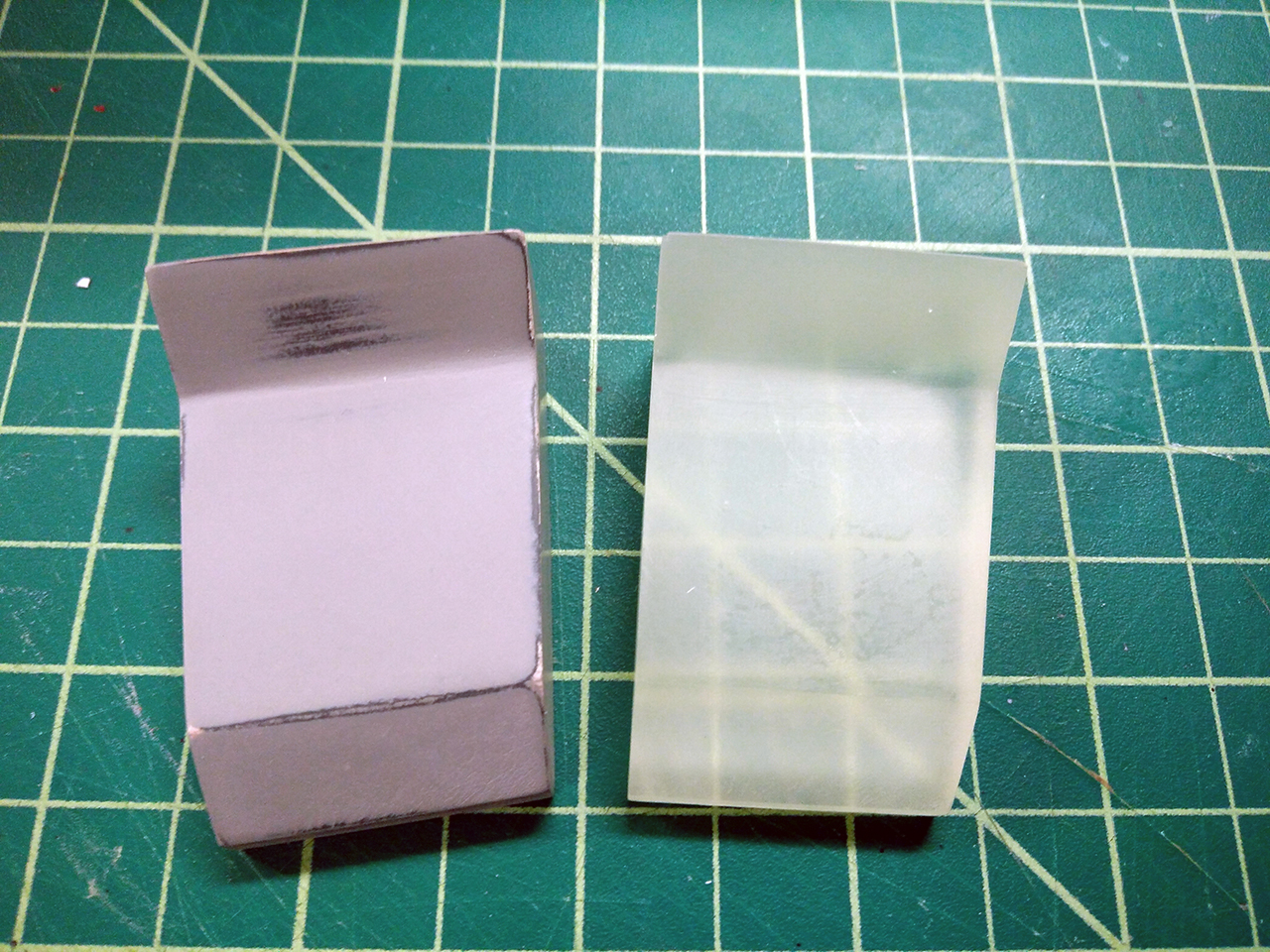

The perplex block is cast with a different resin than the others, Smooth-cast 325, which cures to a transparent slightly-yellowed look. The only problem though is that it cures incredibly fast with a 2.5 min pot life, which makes degassing it very difficult. In the future I'll use the longer-setting 326 instead.
The stalk's mold is a little long and wobbly, so I made a cheap little mothermold for it by casting some plaster around it.

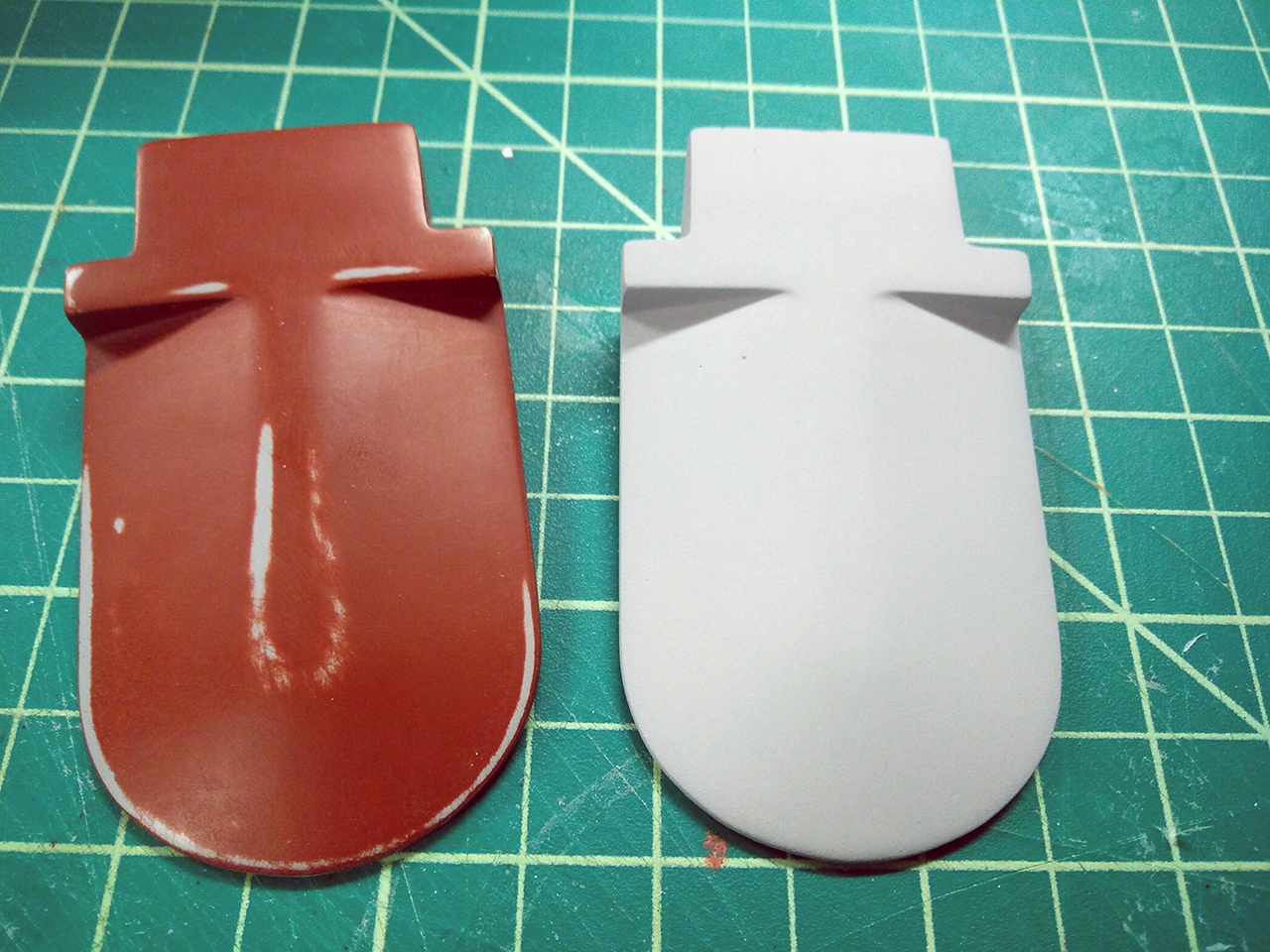

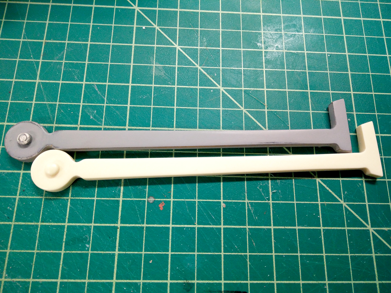

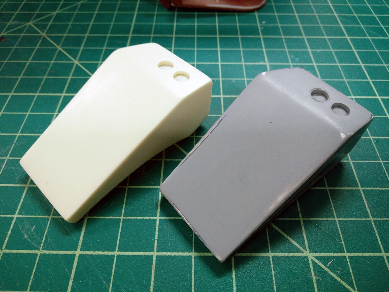

Some images of the masters next to their cast replicas:
IMG_20161122_181147.jpgIMG_20161122_181248.jpgIMG_20161122_181305.jpgIMG_20161122_181127.jpg

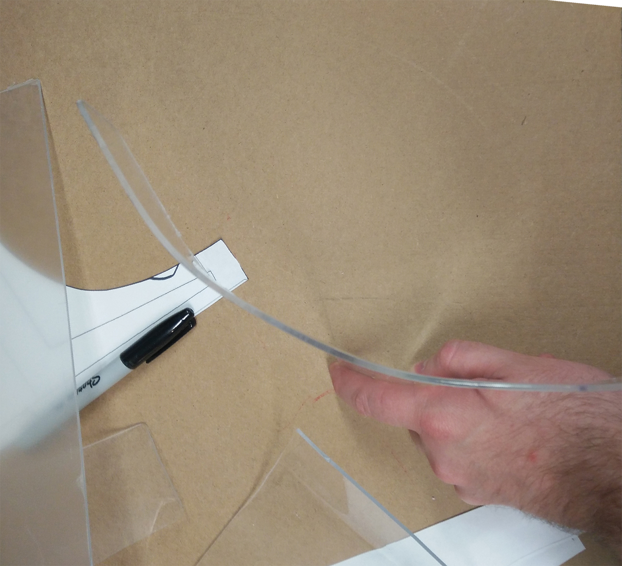

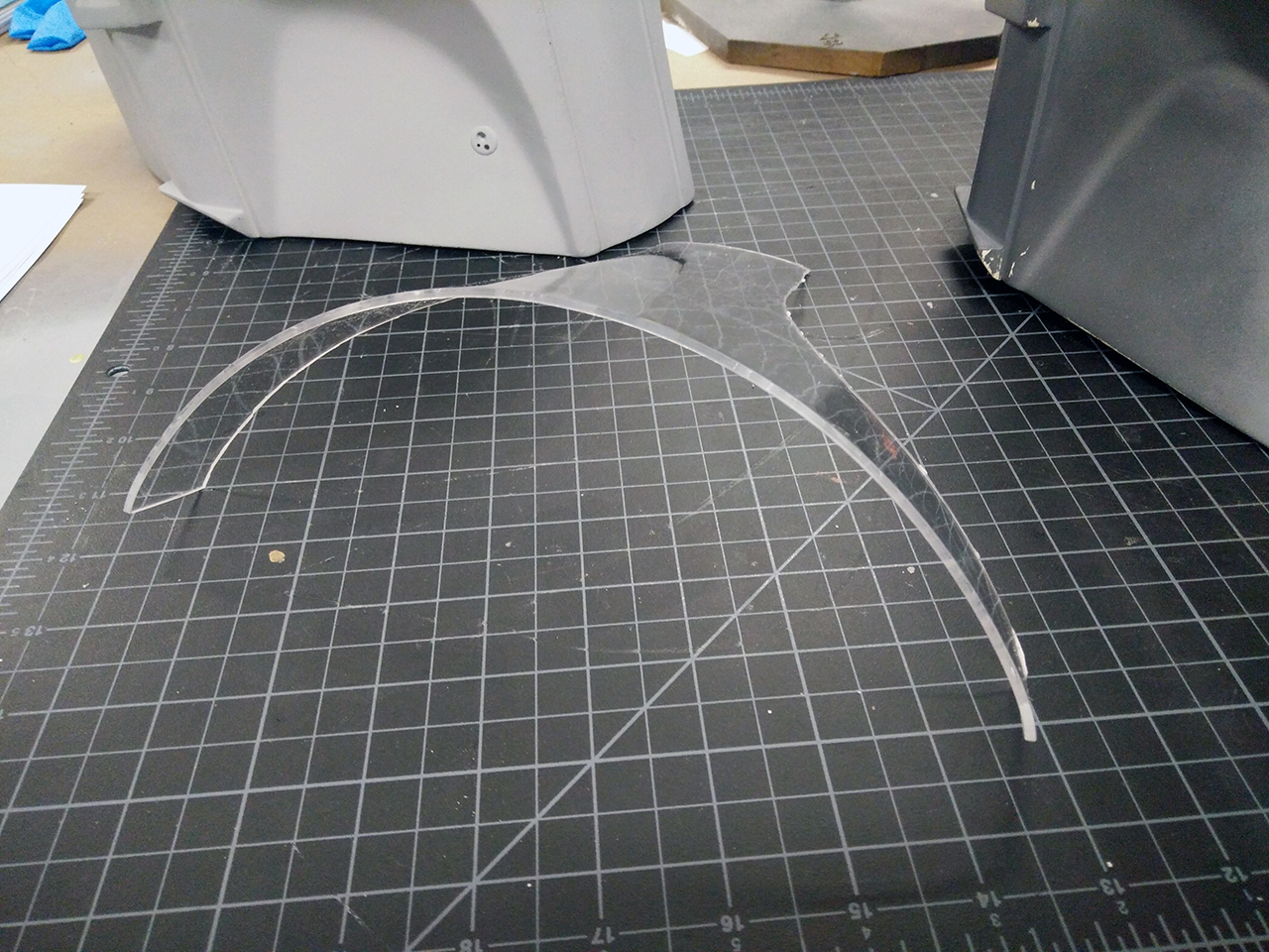

Also tried to make some visors, but it seems the 0.09 inch acrylic I got at Lowes is too thick to thermoform well. I just can't get enough heat to stay into it to evenly bend, so it comes out barely curved and kinda wavy.
I'll have to try to find something thinner I guess, but not so much it's paper-like. Suppose worse comes to worse I'll scavenge from some cheap face shields.
Ahh nevermind, when in doubt, apply more heat I guess.
Instead of the heat gun I tried using an oven instead, ~10 min @ 300 degrees, and it forms much much nicer. I'm generally very apprehensive about heat-forming any plastics indoors, let a lone in an oven, but it seems the fume danger of acrylic is more of a debatable worry rather than a critical one like heating something like PVC is, so hopefully it doesn't kill me.

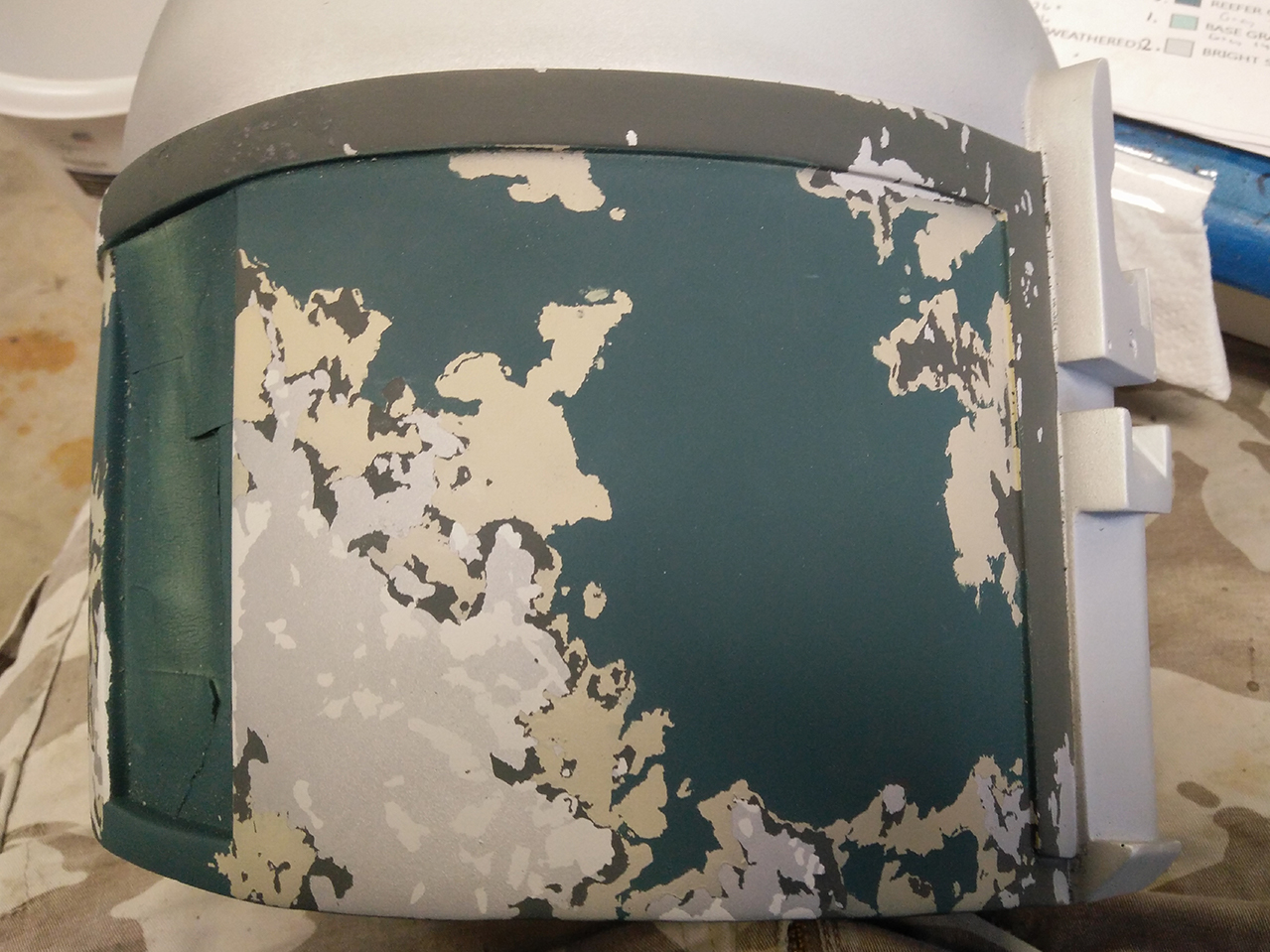

I'm pretty happy with all the under layers, but the final green there came out a little rough textured and splotchy though, and got a little mineral spirits splash on it, whoops. I'll prolly see if I can give it a light steel wooling without lifting the latex mask then give it another coat tommorow. I'm not completely sold on it's color anyway.

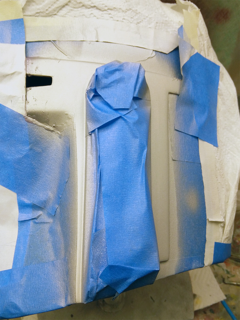

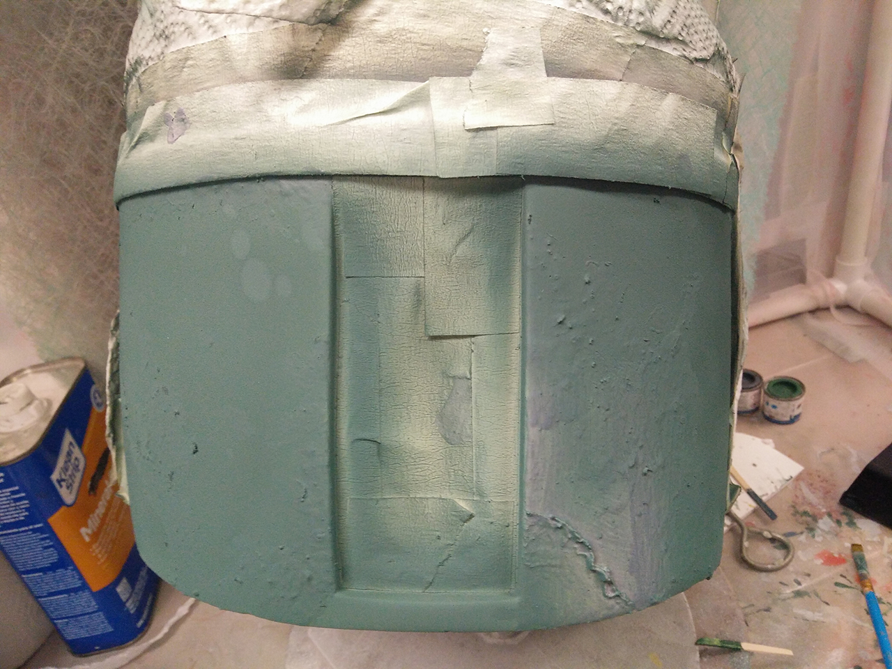

IMG_20170307_225108.jpgIMG_20170310_190919.jpgIMG_20170314_200700.jpgIMG_20170315_182559.jpgIMG_20170315_210737.jpg

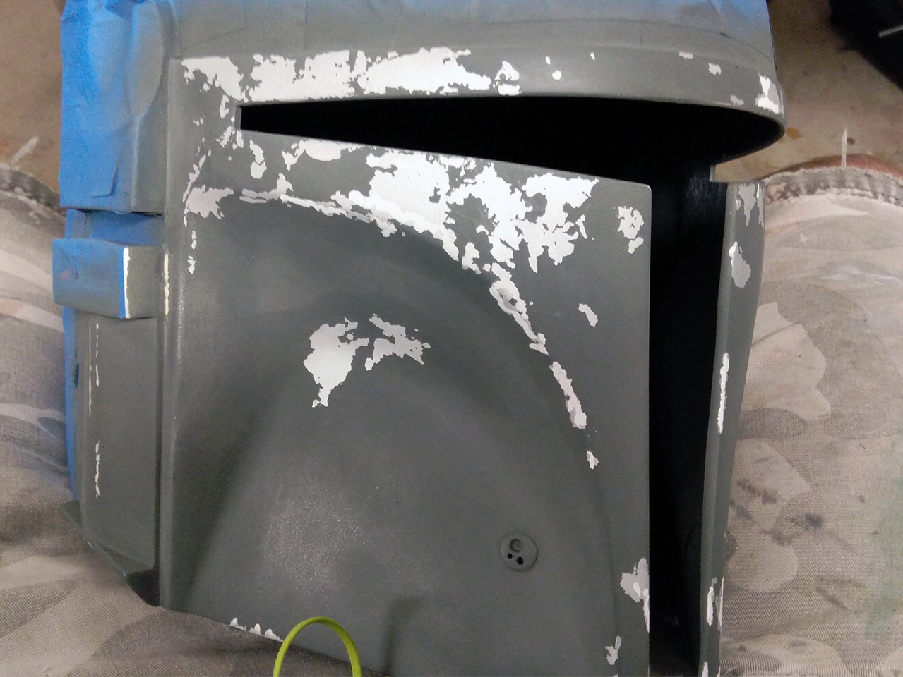

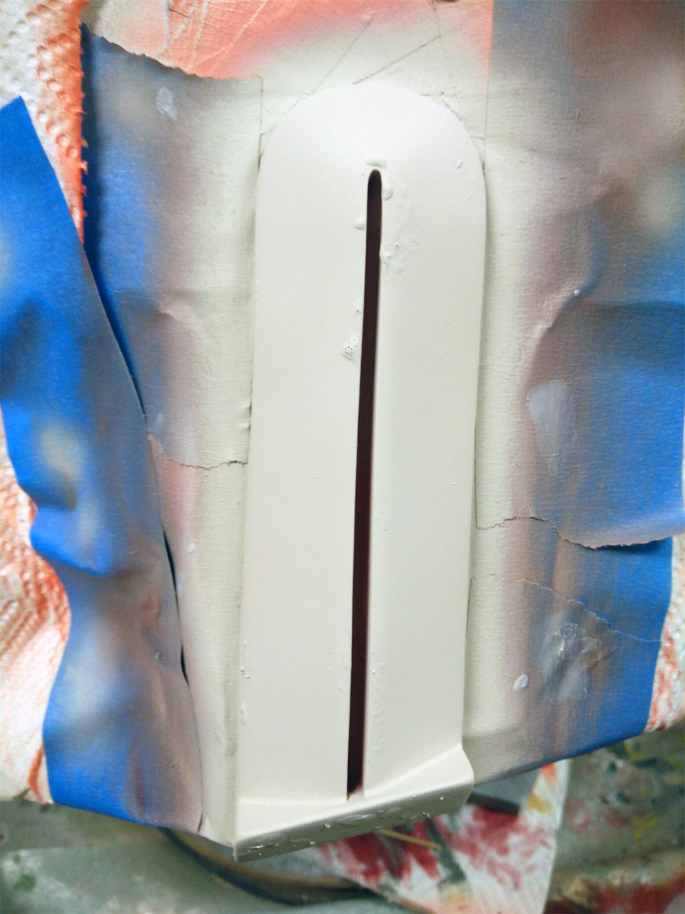

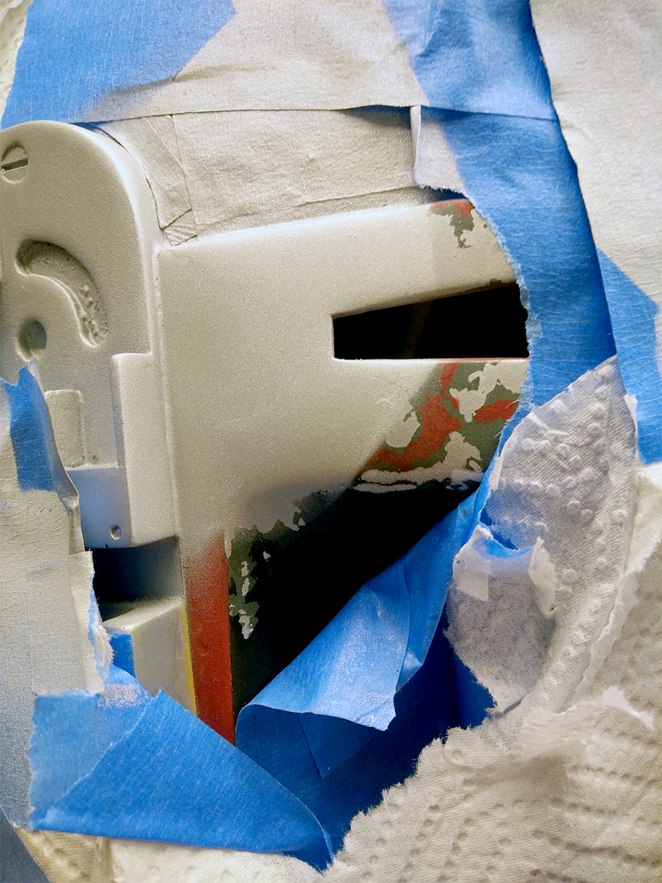

The initial grey layer came out a little rough due to Florida's humidity, so it got a steel wool pass too. After that on went the red, then the lower cheek's green. I figured it'll be best to do the upper cheek's black last as it'll cover the red and green much better than the other way around.

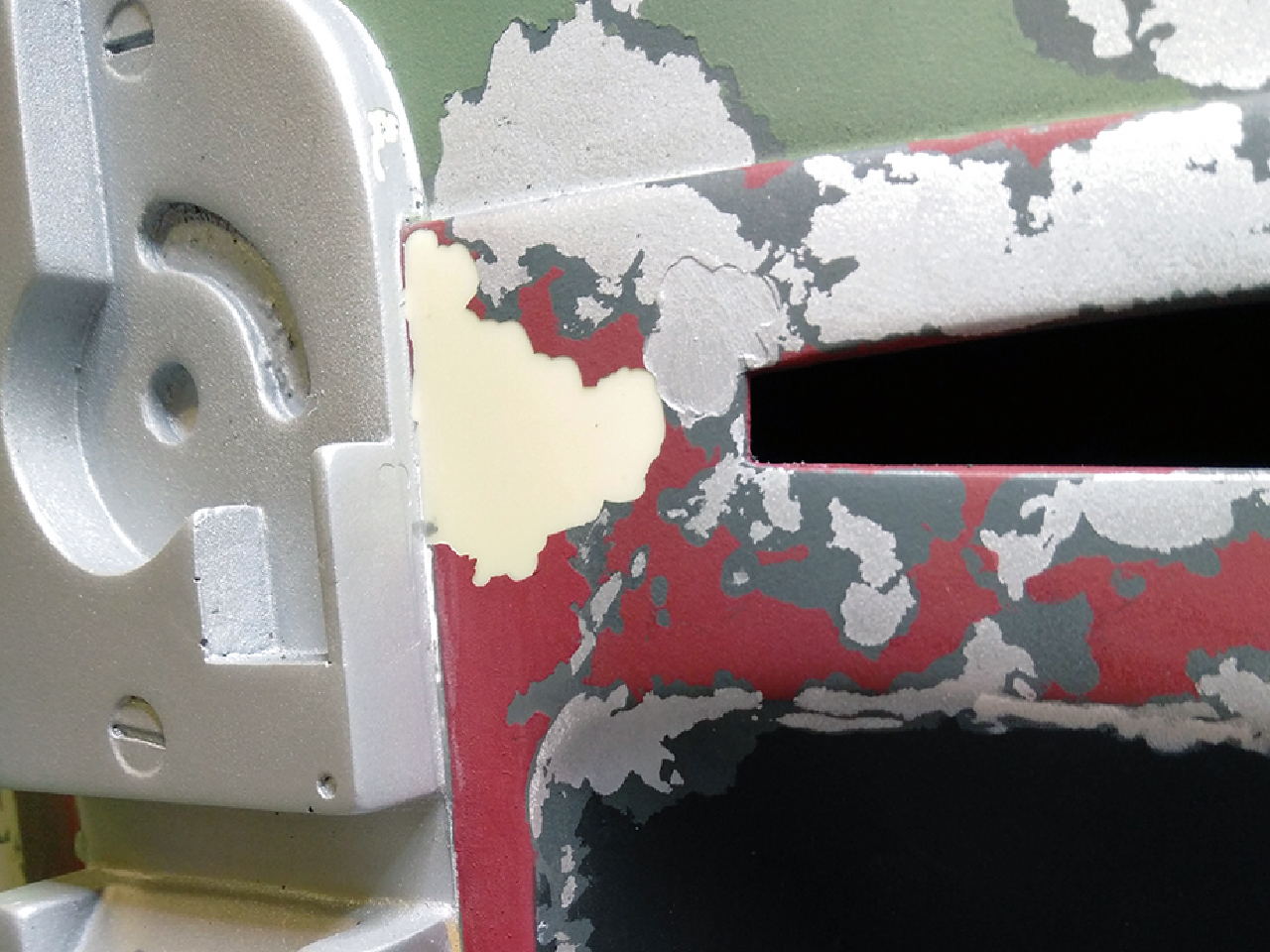

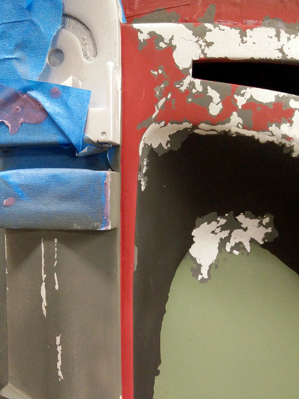

While starting to remove the masking to prepare for the black layer though I ran into a bit of a problem.. some paint chipping. It goes all the way down to the resin, so it seems the primer had a weak bond in this area. It's a bit of a crevice, so I guess I missed doing any prep here and it still had the release agent oils on it from the casting process. whoops.
For now I re-taped it and peeled it a few times to get it to fully-chip. I didn't wanna repaint it just for it to chip again. Tommorow I'm gonna try to sand down the surrounding red a little to flatten the layer ridge, then carefully repaint the area. Luckily it's only chipped in the red, and not the actual layered damage much, so it'll hopefully be an easy touchup.

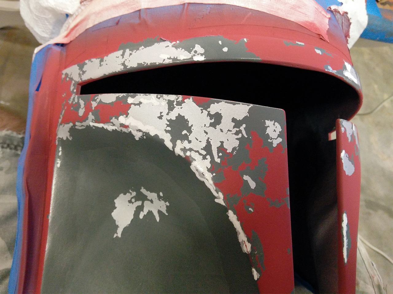

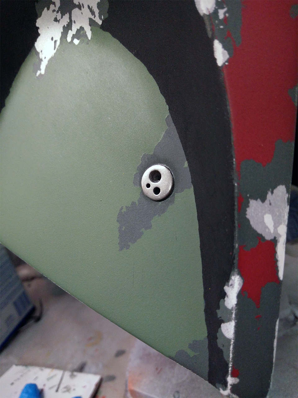

Some more bits done.
Repairing the lift-up:
I also got the upper cheeks blackened out, but didn't get any photos.
Finishing the back band:
I already had the silver and grays laid down from the earlier steps, so it just needed a quick red layer now. It looks a bit.. sparse after the peeling, but it's a really heavily weathered spot in the references, so I suspect that's a lot of the difference.

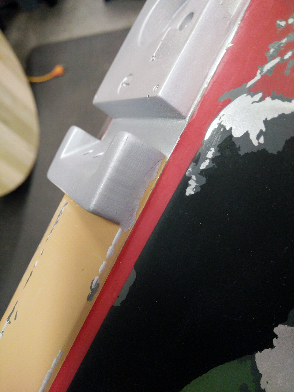

Lower Right Ear:
IMG_20170324_211513.jpgIMG_20170330_180718.jpgIMG_20170409_225754.jpgIMG_20170403_182649.jpg

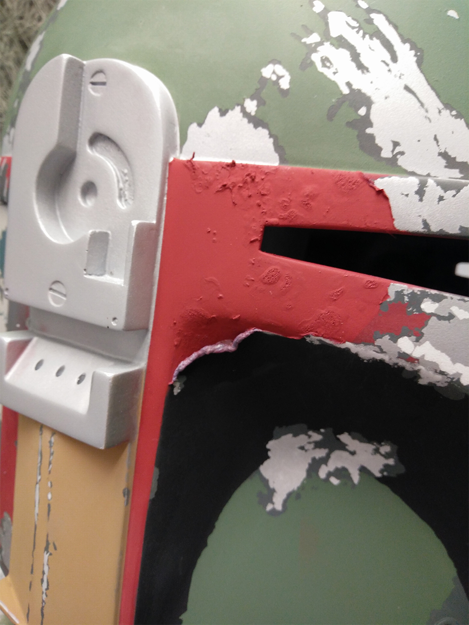

While prepping to get the right ear's sand color on, I got some more lifting on the back side, ugh. I sanded down the whole side and re-grey'd it. After that got on all solid, I masked out the grey and got the actual sand on.
It was only later that I discovered that the sides of the lower piece are actually silver instead of grey.. I don't know what reference I was using that lead me to believe otherwise. Instead of repainting it though, I just took a silver sharpie to it, which will get the job done without risk that trying to repaint just that bit would give.

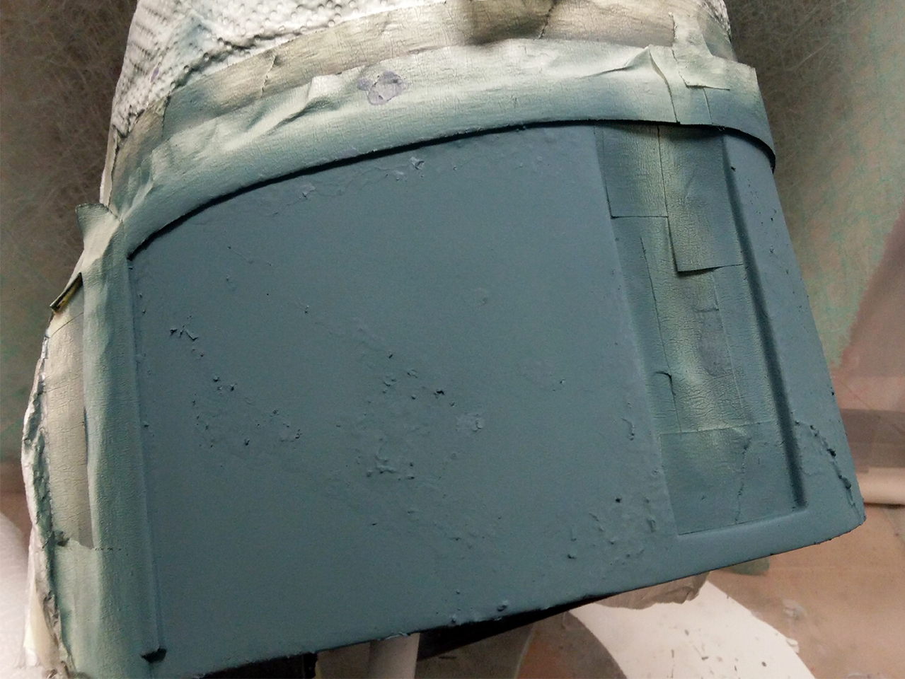

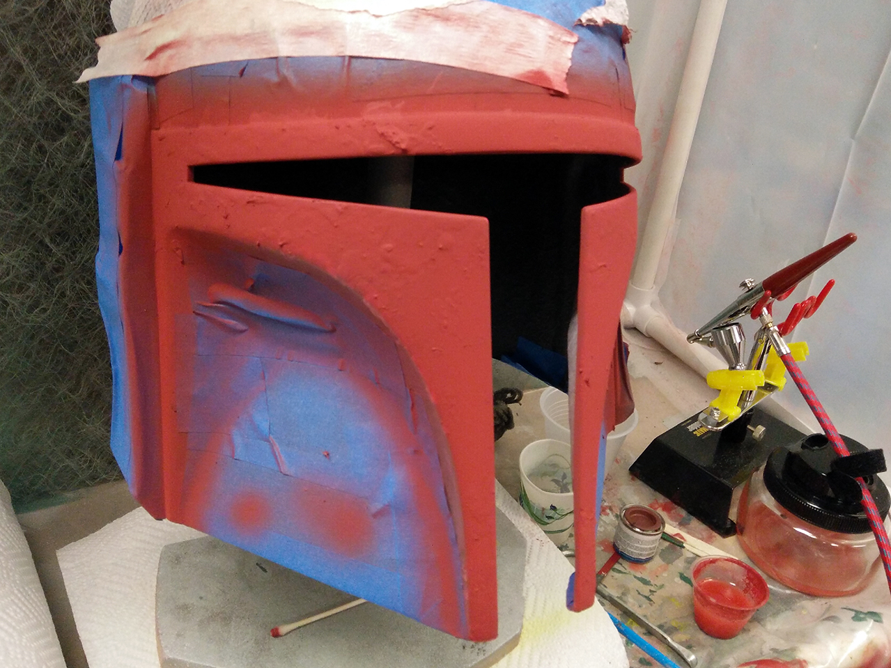

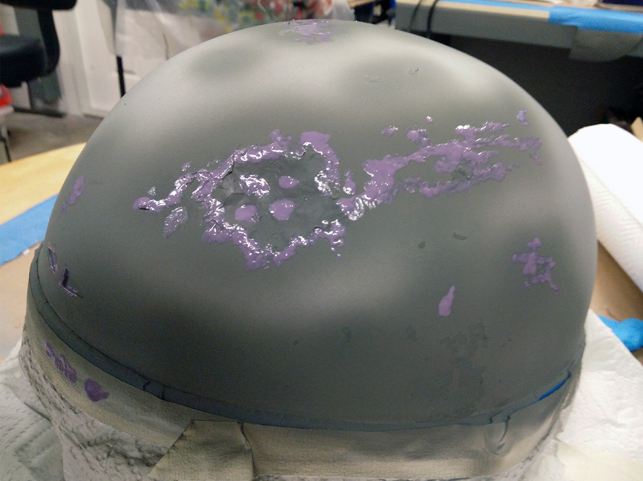

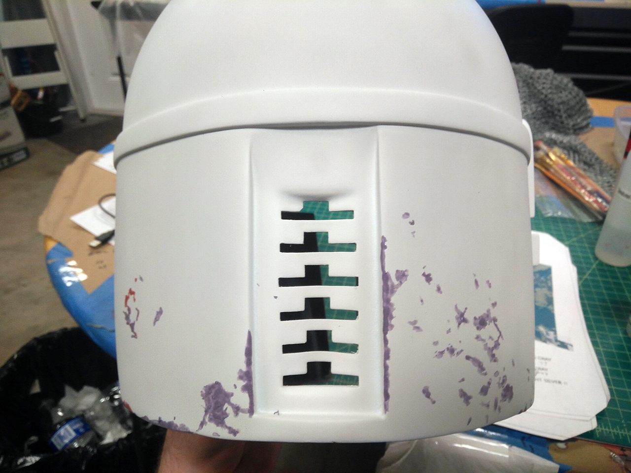

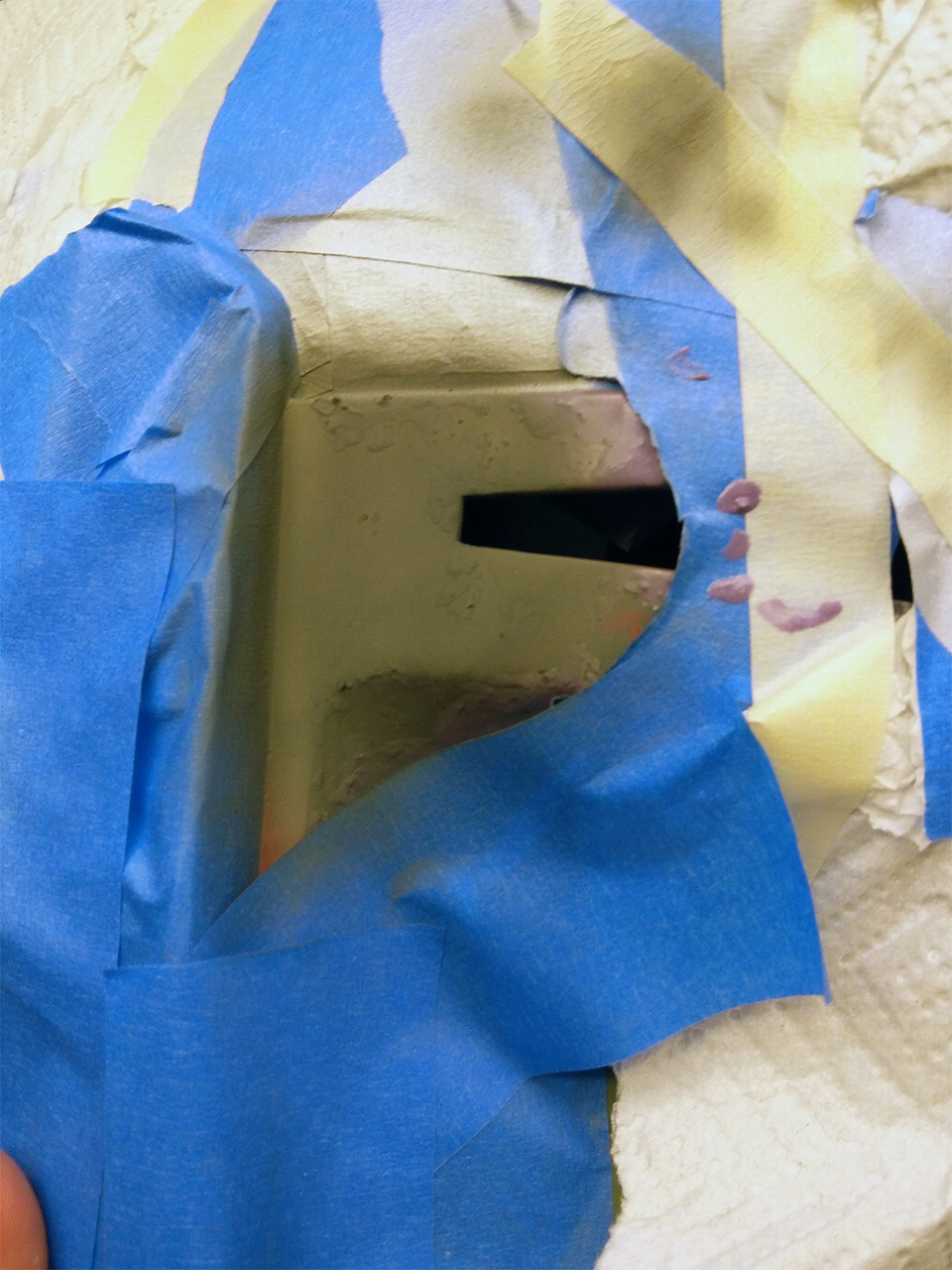

The dome went about pretty routinely. I'm starting to run low on my dark grey, so I tried to spray it conservatively in only the spots it'd show. I never peeled my masking fluid between the layers, so it was a bit tough to finally get off after the green was dried, you can see a few roughing marks from the process in the last shot. They cleared up after a quick steel wooling and soap bath though.
The masking fluid I'm using actually isn't Maskol despite the purple appearance, but rather just simple cheap liquid latex I watered down some and added purple acrylic to.

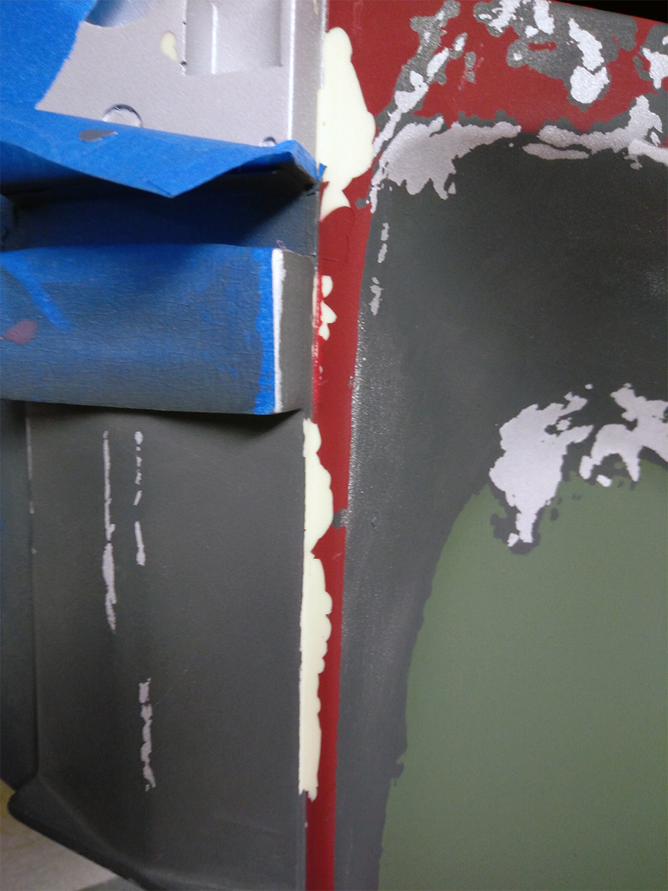

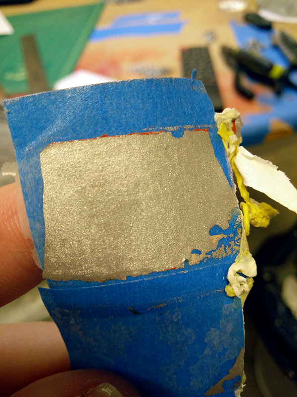

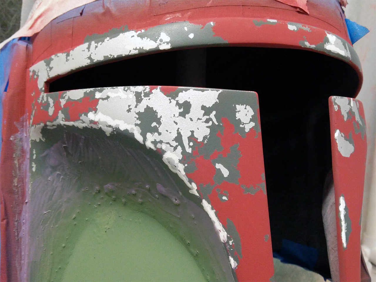

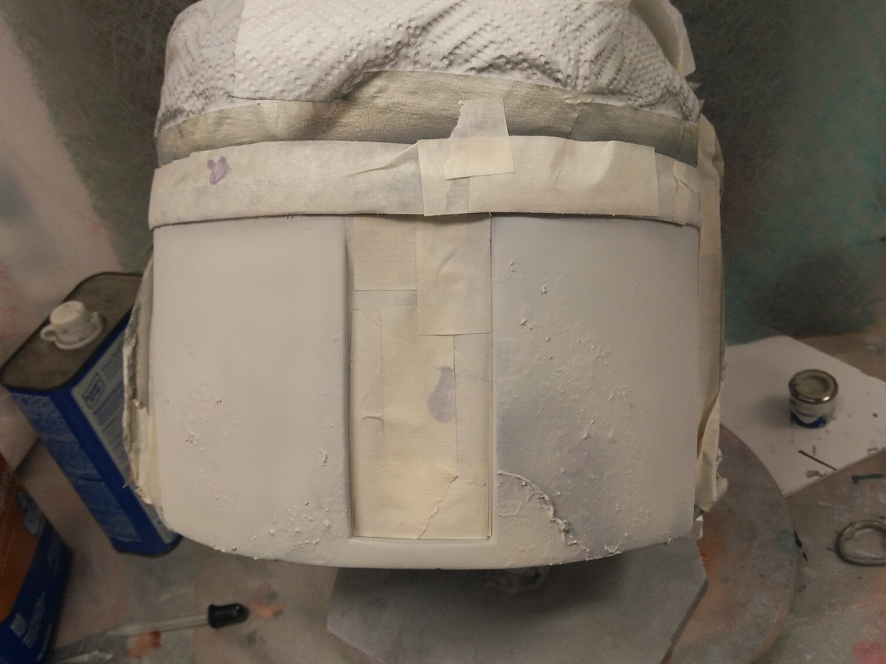

Welp, while taking off some more masking tape. I got some more lifting around the ears. :facepalm

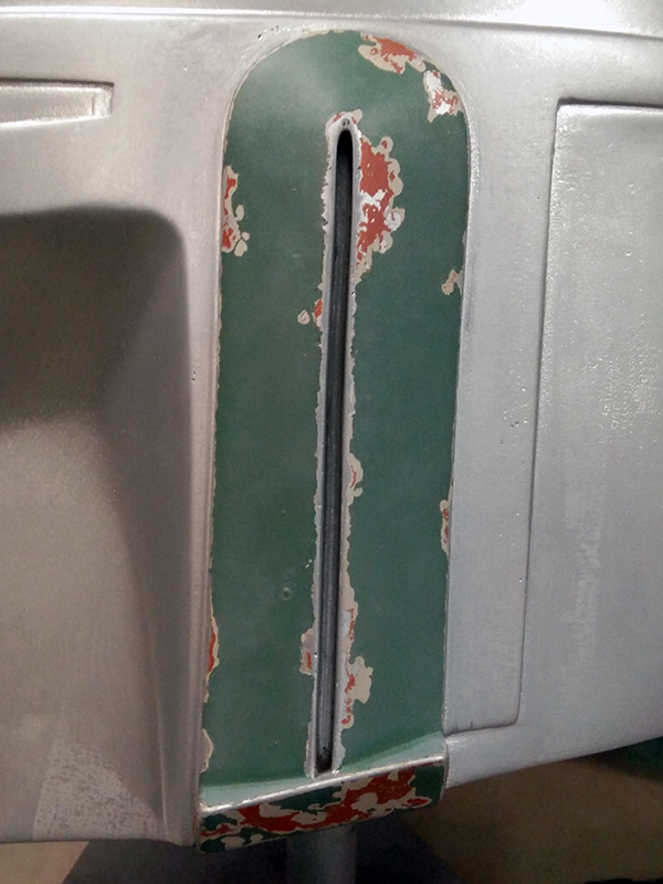

At this point, I got pretty fed up with dealing with this problem, so I decided to just completely sand the areas on both ears all the way down to the plastic, and properly re-prime and paint them. This time using some high-stick primer.
IMG_20170106_212148.jpgIMG_20170409_185712.jpgIMG_20170410_192847.jpgIMG_20170412_203700.jpgIMG_20170412_204910.jpg
IMG_20170409_220704.jpgIMG_20170410_174347.jpgIMG_20170410_192837.jpgIMG_20170412_203645.jpgIMG_20170412_204918.jpg
Re-doing all that was a pretty big setback timewise, but hopefully it solves these lifting issues once and for all.

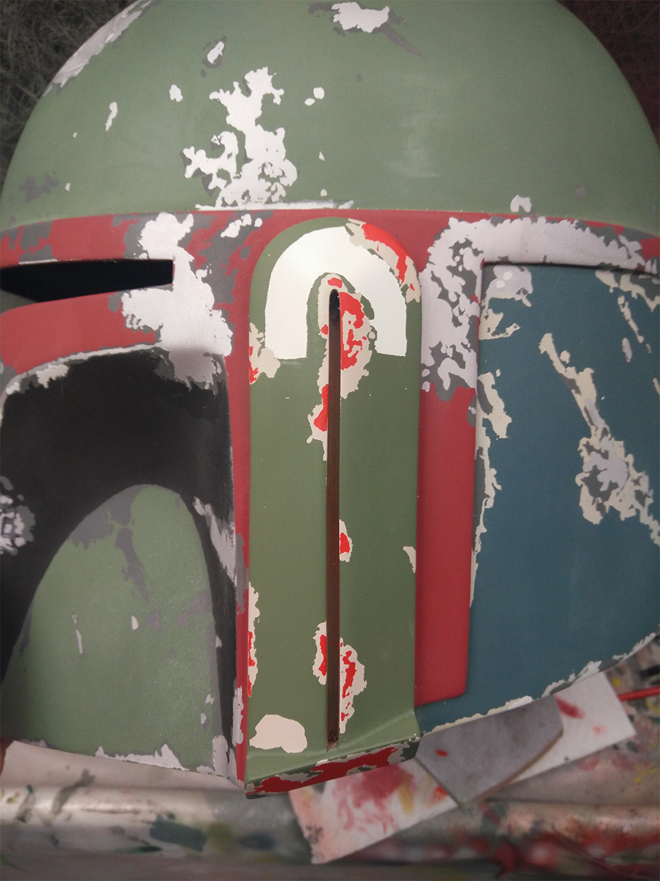

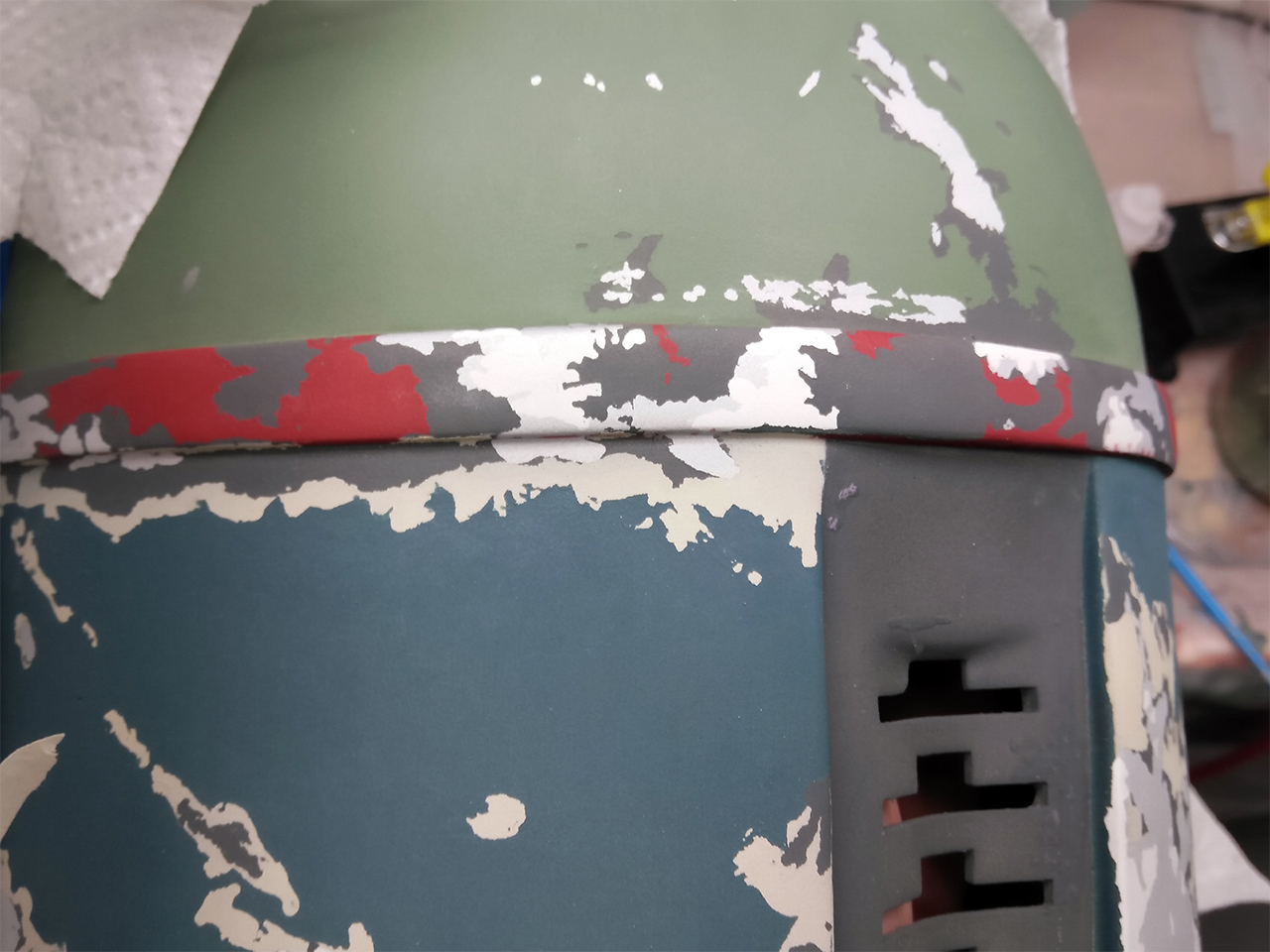

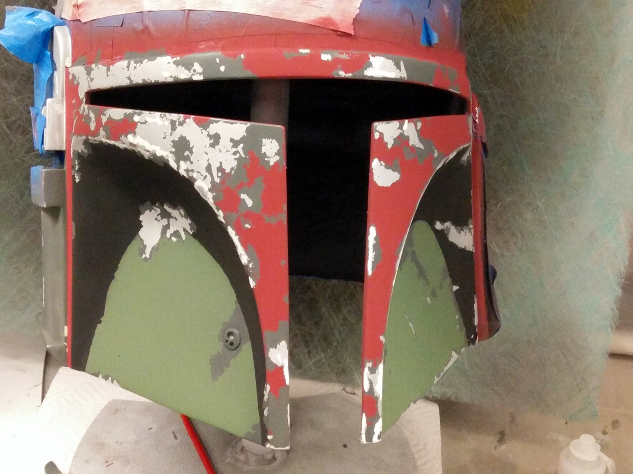

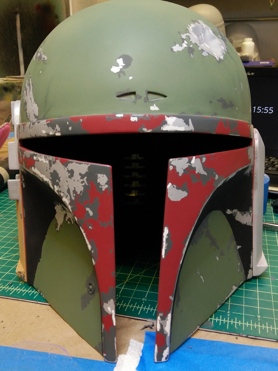

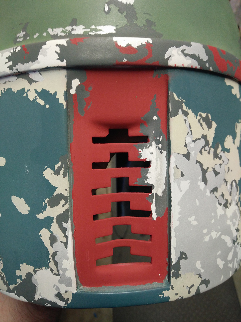

From there I got that left ear done up so I could finally have all the major sections painted up,
IMG_20170414_221905.jpgIMG_20170413_213355.jpgIMG_20170415_212547.jpgIMG_20170416_214805.jpgIMG_20170419_231659.jpg
The white decal is kinda rough looking, the liquid mask didn't do too good for masking straight lines. I might touch up the edges with some proper masking tape stencils instead. For now though, it's nice to just have everything on.

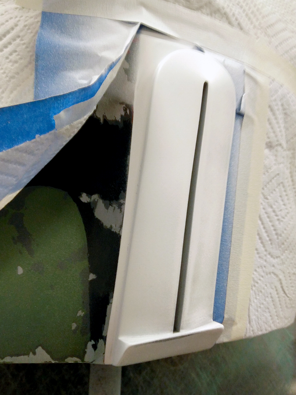

From here I just have to paint the rear keyholes, the maroon on the red parts, the rangefinder and earcap, and then do some detail passes. Then we'll finally be ready to weather it and get the visor in.

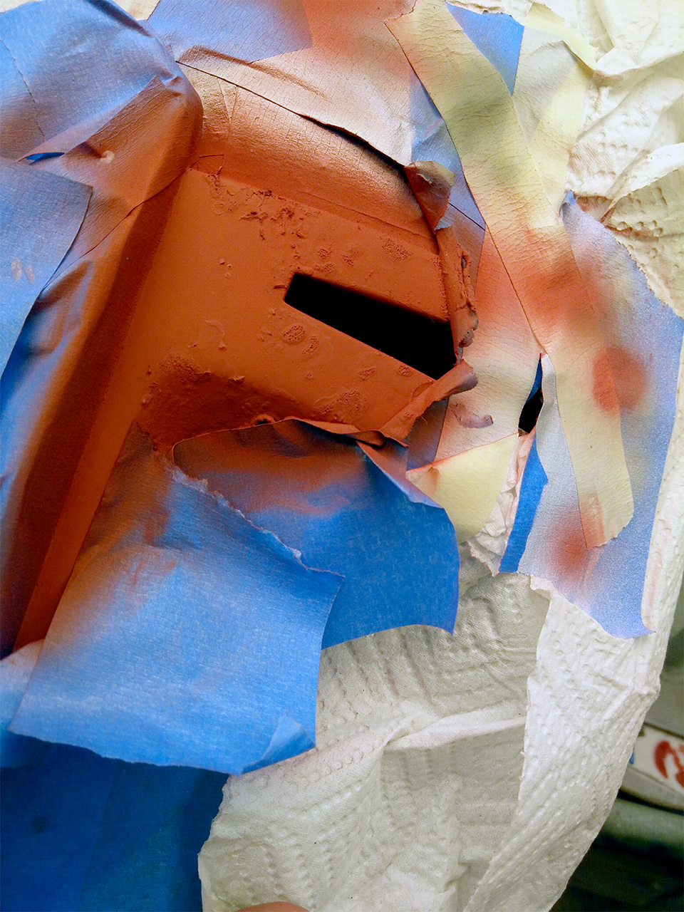

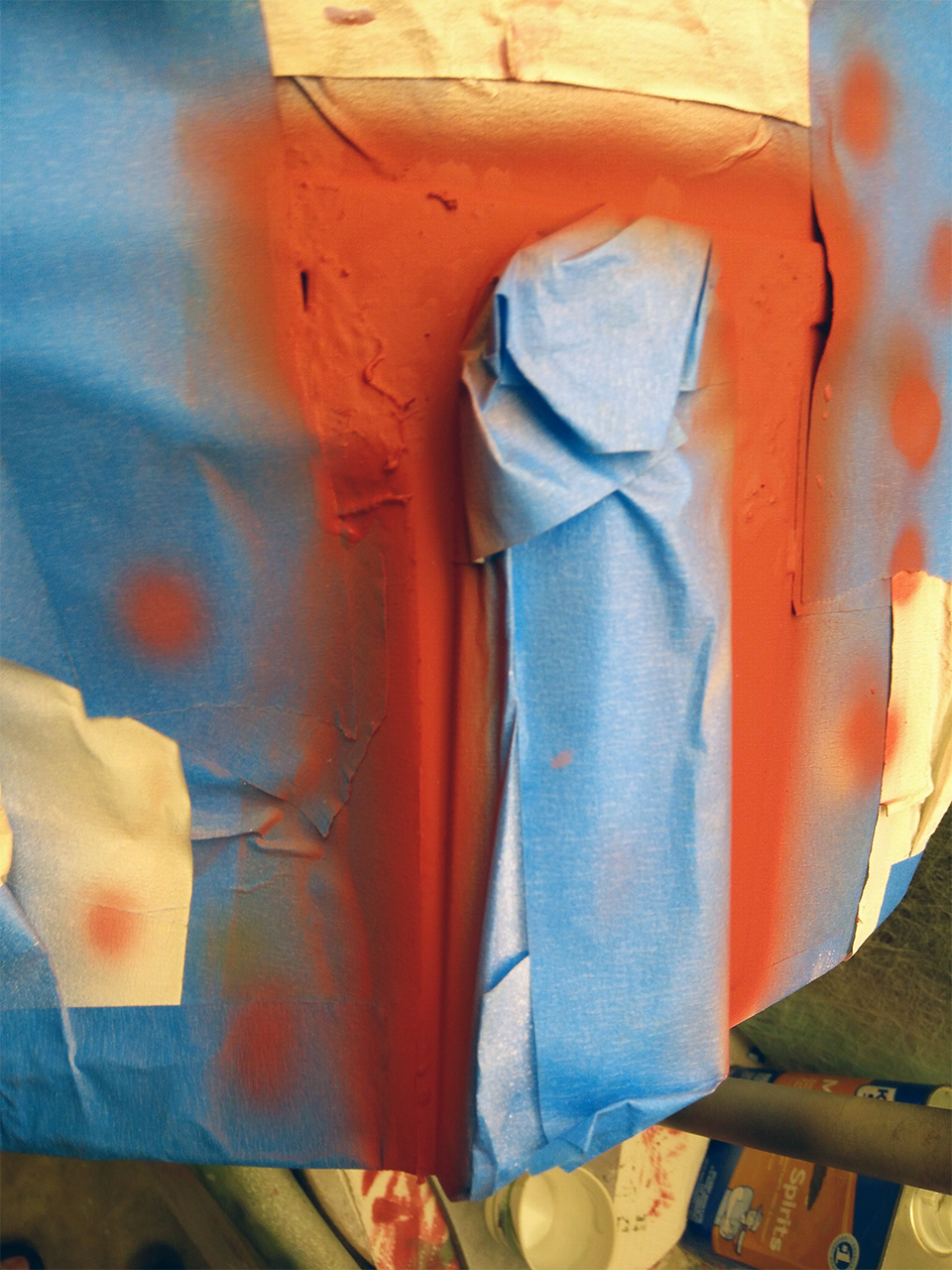

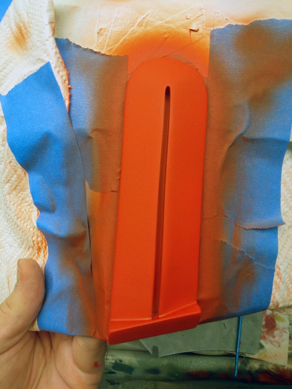

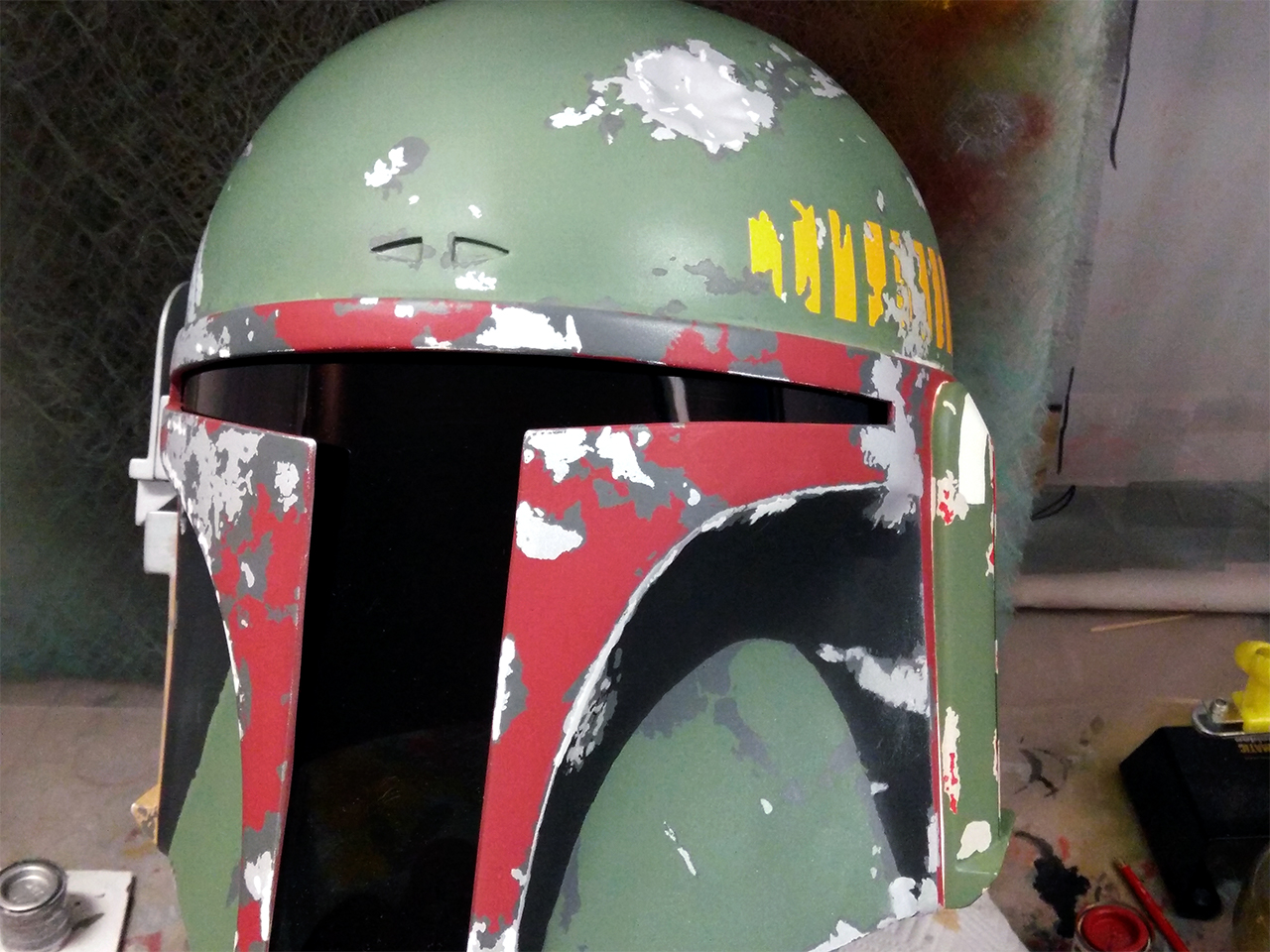

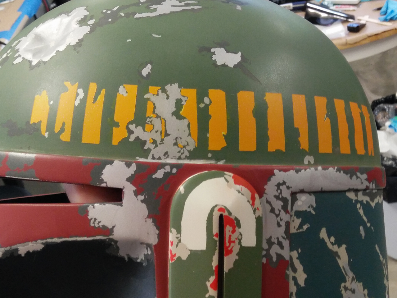

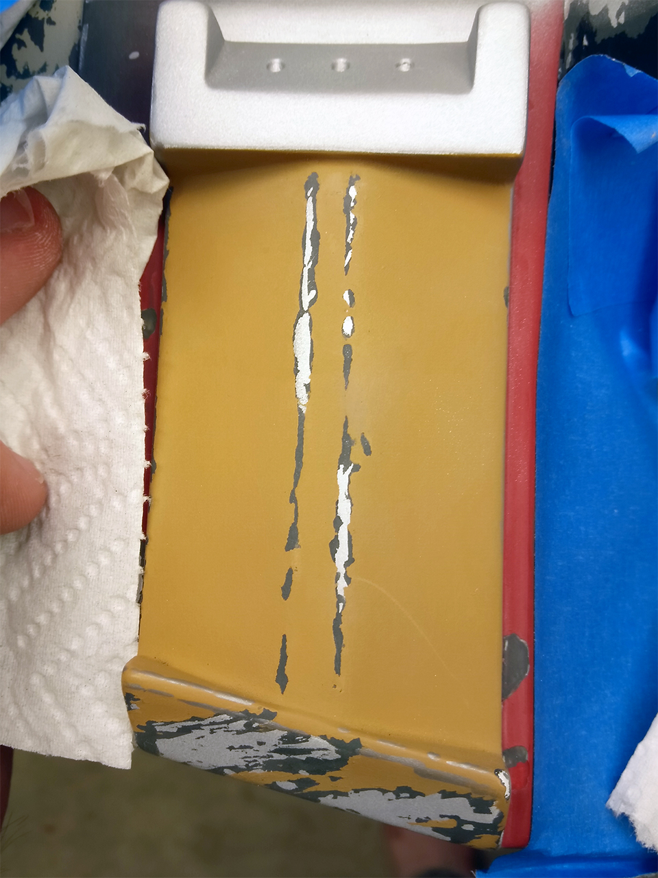

Also, some more lil updates. Got the final red layer on the rear keyholes done, also the killstripes.
The old grey that was on there from the original painting of that area was a little rough textured, so I steel wooled it a bit. Doing so made the layers spot through each other a little more than I like though, but it's probably not worth the bother and risk of messing things up to try to micro-mask and repaint them. This is intended to be a pretty economy paint-up, so a few smaller issues like that are ok as long as the general aesthetic isn't hurt.
The killstripes were a challenge to get masked up. I ended up getting a little two stripe template card made up which made things easier.
The white layer was a primer layer as I didn't want to have to do 100 layers of yellow to keep the green from showing through. For the yellow/orange gradient I tried to keep it pretty subtle, as it seems that way in most references. I'm pretty sure for the actual original prop they only used 1 color for the stripes, and the gradient comes from how thickly they painted it over the green, but it's a challenge to replicate an effect like that without knowing the exact colors and weathering they used. Also, I'm still a pretty inexperienced painter, so simple is better.
There's a few chips of bright yellow showing through the orange, due to me de-masking the stripes before the orange layer had dried and bonded properly. Not really any way to fix them unfortunatly as that's now a unique mixed orange/yellow shade that I'll never be able to approximate. Bob Ross would call it a happy accident though, as it fits alright with the chipped damage theme.

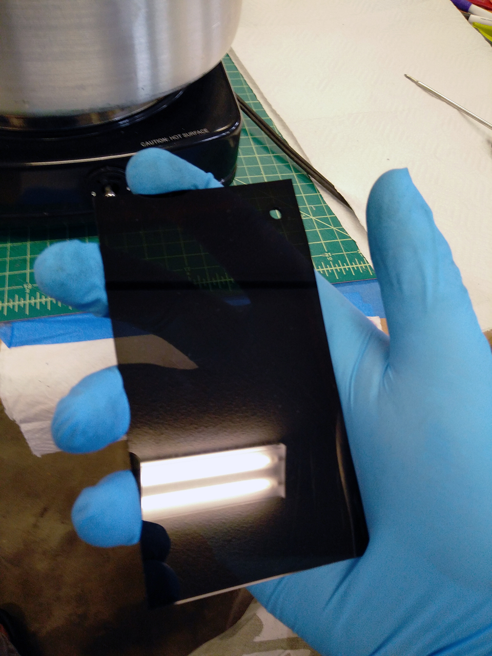

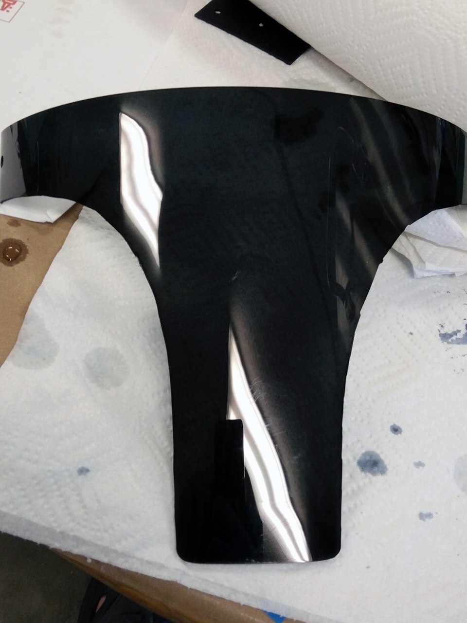

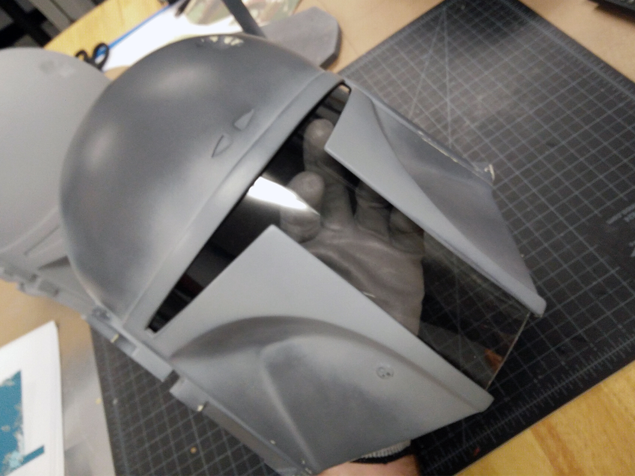

Time for some visor dying.
For this, I used the very popular product iDye Poly. I got mine from a lady on ebay who attached a comically insane amount of stamps on the envelope.
There's a few video guides on how to use this stuff on visors, plus I'm sure plenty of guides around here and mandomercs;
The general gist though is to heat up some water, add dye, stir it, let it cool to 140-150F, then dunk your plastic for ~5 mins.
I suspect my thick acrylic visors probably could have handled higher heat than the thin PETG in those videos, but I didn't wanna risk it.
This was a pretty interesting and fun process. You feel sorta like an early century oil worker.
IMG_20170504_135419.jpgIMG_20170504_142915.jpgIMG_20170504_162824.jpgIMG_20170504_163748.jpg
I did a few test sheets like you can see in the second image. I found about 2-3 dunks gave a good solid tint. The last image is a pretty good approximation of what it's like to look through it, if your eye was a camera sensor at least.
I few things I learned for the next time I do this ever:
  1. Probably use 2 packets instead of just the 1 I used, dunkings were getting less effective towards the end and it was getting a little grainy. My initial test piece came out better than my final visor.
  2. Get very cold water for the quenching step, and don't touch any of the dyed part until after a solid minute or so in there. Otherwise you can smear and fingerprint the dye.
  3. Don't use a thermometer with a plastic clip, as it'll get dyed too.
Overall though, I'm pretty impressed I didn't make a huge mess. I'll probably just buy pre-tinted plastic in the future, but this was fun.
Now to just get it actually mounted in, instead of me holding it there for the photo.
